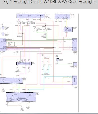

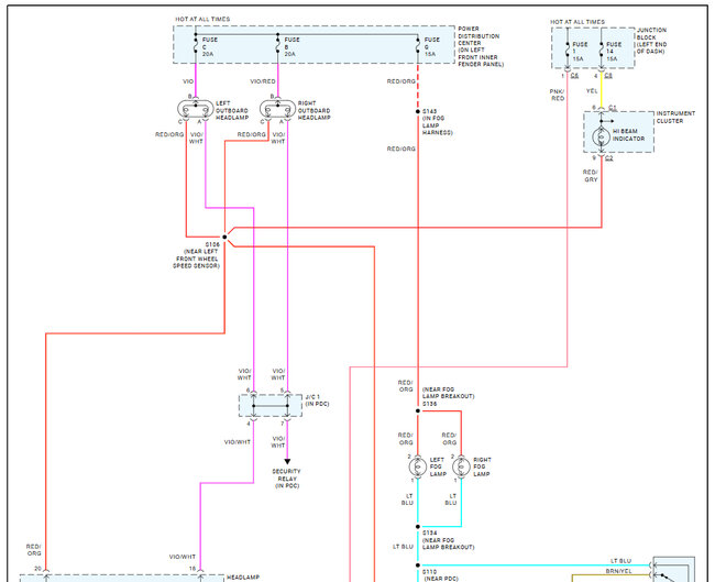

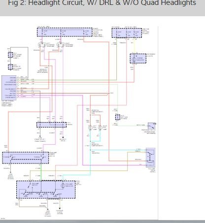

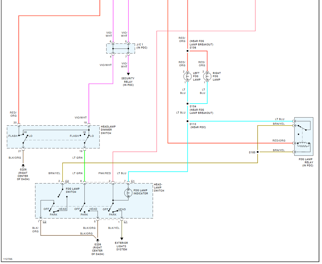

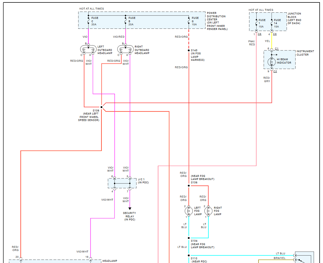

I am looking for a wire diagram for the head light switch that will show me both the head lights and dome /cargo light thanks. I have no fog lights no DRL's and no dual beam.

Here is a wiring diagram for you. Hope this helps and feel free to ask any question if needed. Thanks for using 2CarPros.com. Danny- Check out the images (below).
Jul 6, 2018 at 2:12 PM
  • 110,240 POSTS
I have attached two wiring schematics for your review. One is for quad headlights and the other without quad headlights. Let me know if they help or if you need something different.

Thanks that is what I was looking for.
