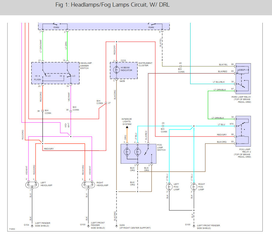

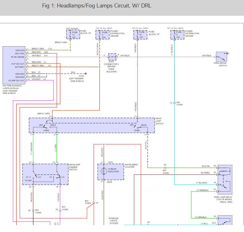

Installed new head light switch electrical housing. Now the dash lights do not work unless I turn the knob for the interior lights.
Dec 3, 2018 at 1:41 AM
  • 55,649 POSTS
Was the switch a OEM replacement? Aftermarket switch cannot work right FYI. Here is a guide to help you test the circuits and the wiring diagrams below so you can confirm the issue:
