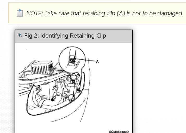

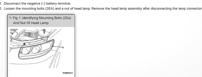

I need to replace the driver side headlight is there any way that I can take the whole assembly out and replace it that way? I have looked online but it only shows a 2006.

see pictures, once headlight is out you can remove bulbs. The installation is reverse of removal.
