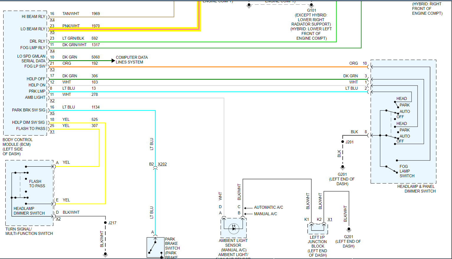

During the day my low beams work my high beams work but when it gets dark at night my driver side low beam cuts off. so I have to drive with my high beams. this problem only occurs at night on my driver side low beams. I have check the fuses fuses are good and ground is good.

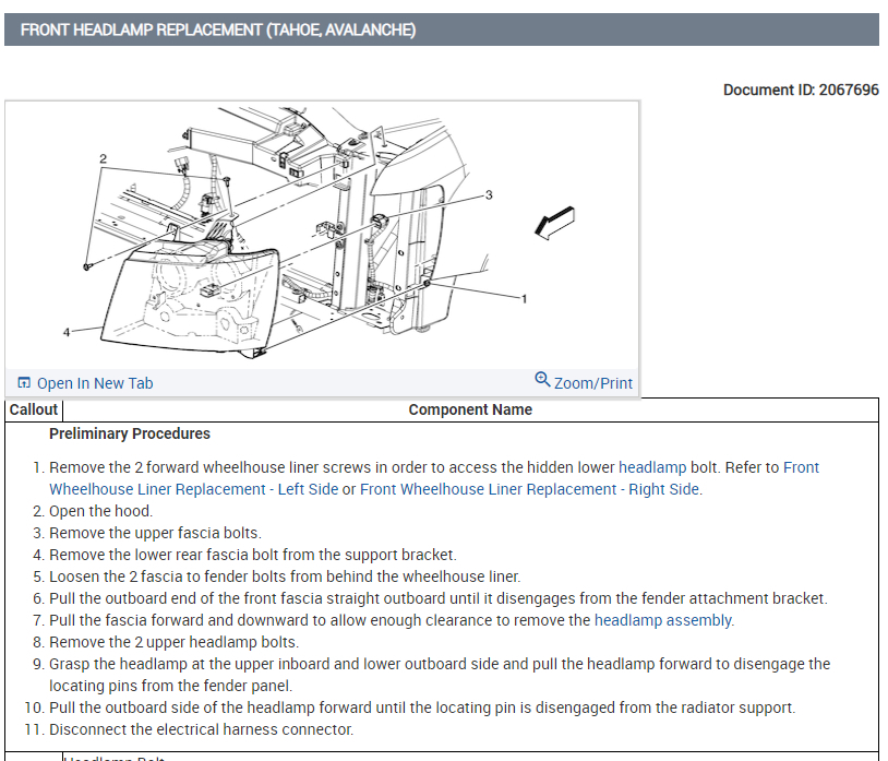

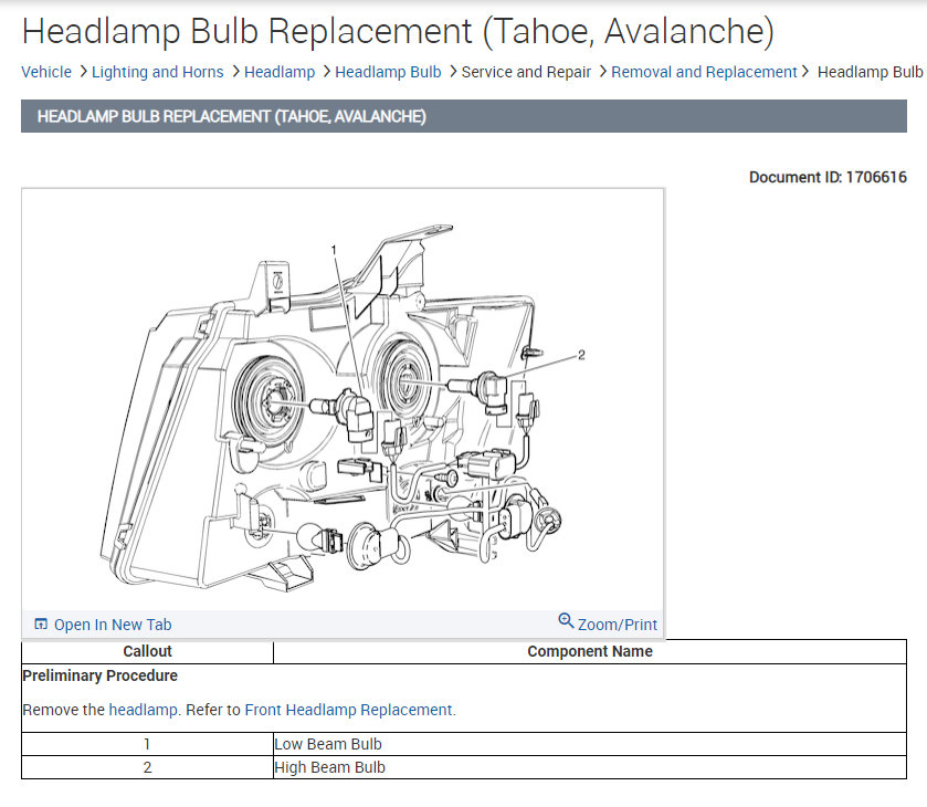

Sounds interesting, the vehicle has daytime running lamps. These bulbs are different then the low beam bulbs. make sure you are not confusing the two. You may just have a bad low beam bulb. would recommend removing the bulb and simple swapping with the other side to see if it works or not. Easy and fast way to diagnose and no parts required. :) Here is procedure for changing bulbs. If vehicle has HID headlamps then be careful to not touch the known good bulb.

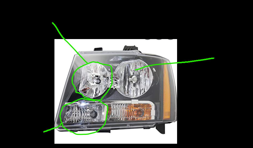

Does your head lamp assembly look like this? If so I labeled it for you. I want to make sure we are on the same page. Also don't want you to get the low beam and DRL daytime running lights mixed up. So let me know if the low beam is not working all the time and it's the DRL that has you thinking its the low beam. You can just turn the headlights on and walk out front of the vehicle and see if that low beam is coming on. If this healight is different then yours let me know or try putting an image of yours with the problem hopping on here.
Thanks,
Colby

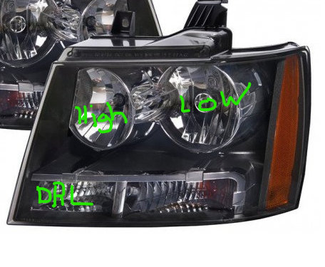

Sorry my image is not showing what I wrote here is another one.

Oh, i see and i completely understand so your right my DRL have been on, but i have replace the low beam and also switch with the passenger side low beam. could the DRL effect the low beam driver side at night?

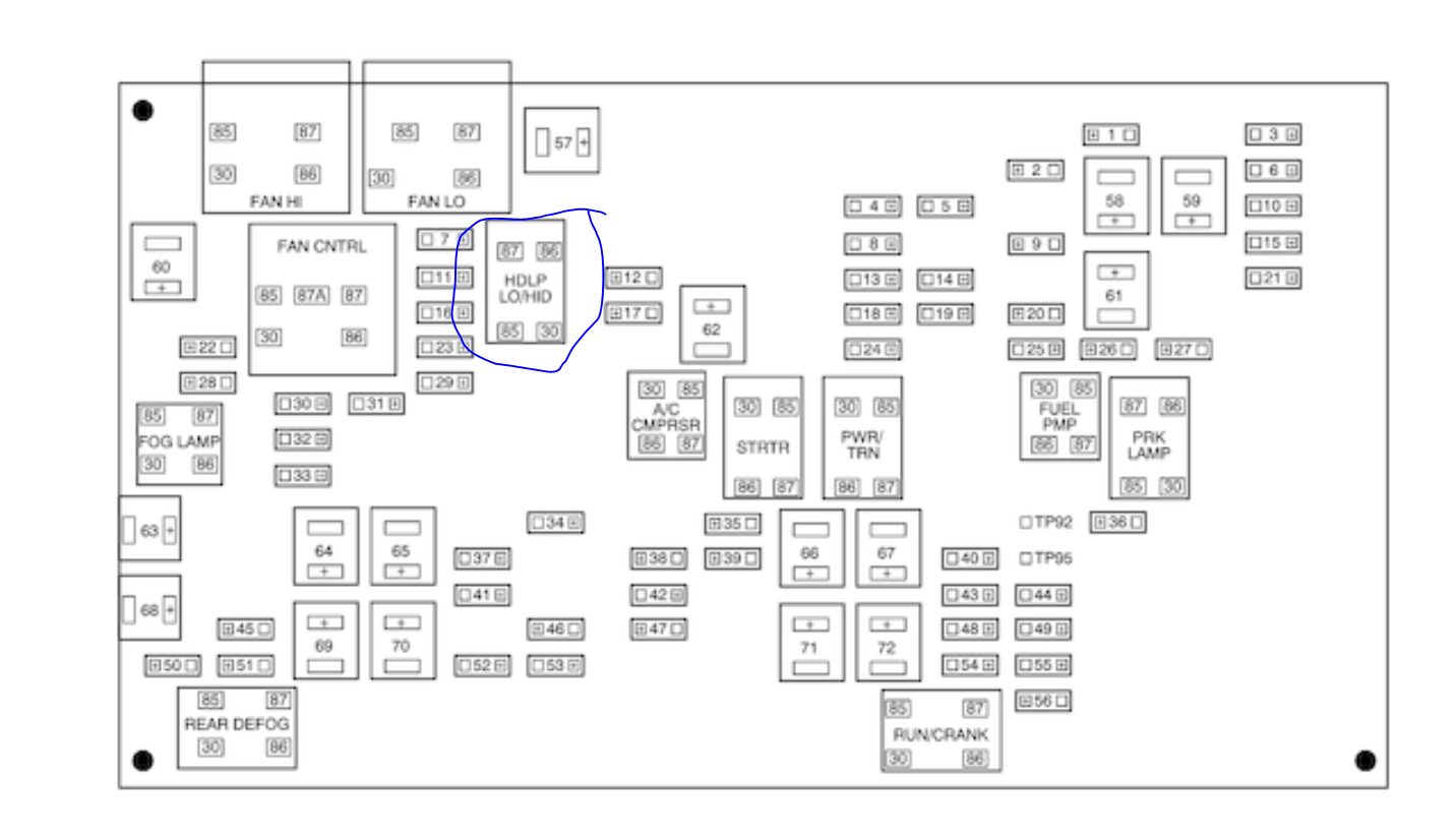

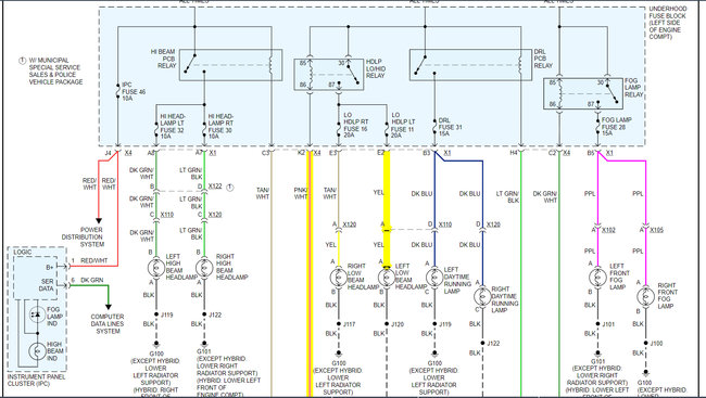

Good morning,
The left front is controlled by a relay in the fuse block. The body control module is what controls the relay to pass power to the connector.
I attached wiring diagrams for you to view the system. The yellow wire is what goes to the headlight. Check the relay for any corroded terminals.
If you have a scan tool, you should be able to view the headlight application. The body control module is what controls the control portion of the relay.
