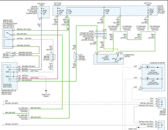

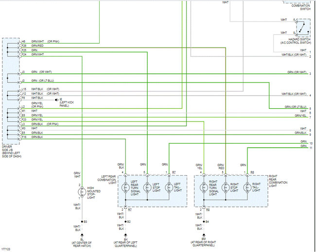

Hello, the vehicle left rear tail light and the front right head light not functioning. I have checked the fuses and relay they are fine. I have tested the bulbs separately they are functioning but there's no power at the connector. Could you help me the circuit diagram
Mar 5, 2021 at 2:19 AM
  • 110,240 POSTS

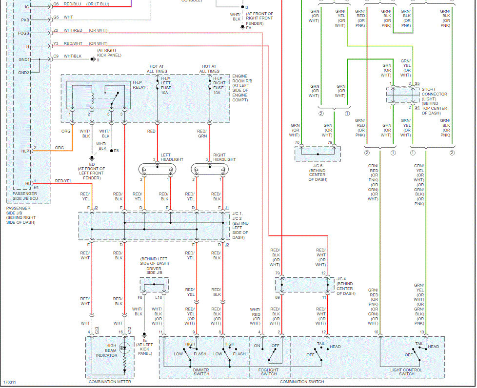

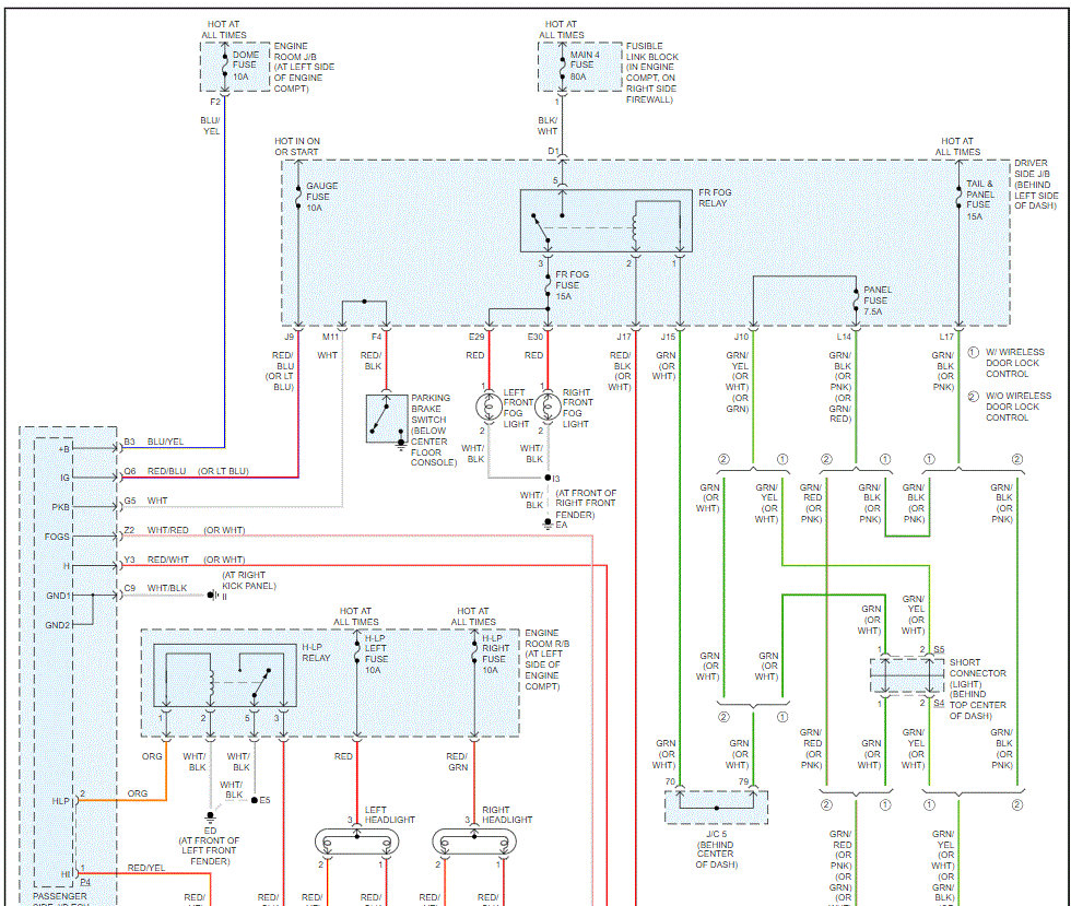

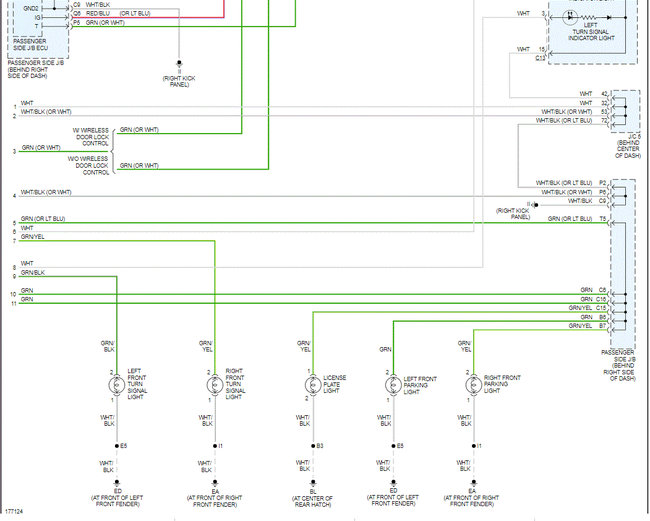

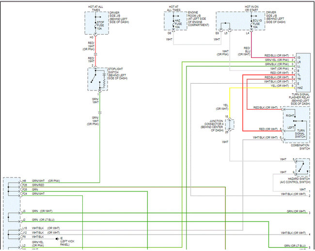

The wiring schematics are broken into two sections, headlamps and exterior lighting. The rear tail lamp issue will be under exterior lighting. The headlamp will be under headlamp.
_______________
Pics 1 and 2 are for the headlamp. I cut the pic in half to make it more readable. I did, however, overlap them so you can follow it.
Pics 3, 4, 5, and 6 are the exterior lighting schematics. Again, I cut them in half to make it more readable, and I overlapped them as well.

Sir, considering the 2nd diagram, it seems that the H-LP relay has no function since the circuit is ground by switch, am I right? If I am what is the function of the relay?
Mar 12, 2021 at 5:04 AM
BLESSING EWOBOR
  • 753 POSTS
How does the high beam indicator work since it is connected to the ground of both switch?
Mar 12, 2021 at 5:08 AM
  • 110,240 POSTS
The relay gets ground at the left front fender.
Mar 12, 2021 at 10:38 AM
BLESSING EWOBOR
  • 753 POSTS
What I am saying is that the whether the relay ground or not it won't stop the headlights from coming on.
Mar 12, 2021 at 1:10 PM
  • 110,240 POSTS
If the relay doesn't have ground, it will prevent the light from working. No power will be transmitted through the relay.
Mar 12, 2021 at 2:57 PM
