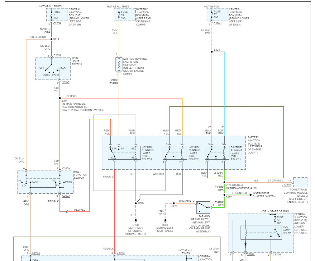

This truck is a Diesel Ford F550 super duty, the problem is the headlights work just on the passenger side but not the driver side. I checked all fuses and are good just I can't find which relay is feeding the headlight also the wiring looks.

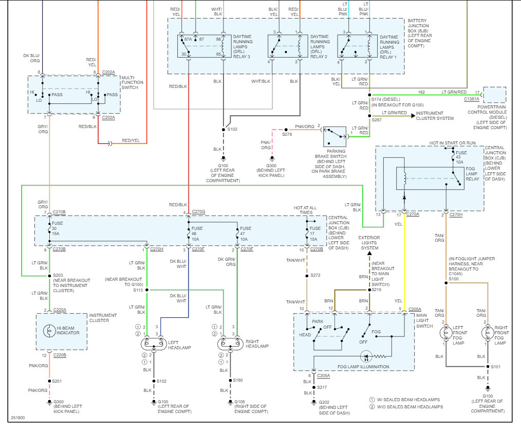

Did you change the bulb out? Is there power at fuse # 17 - 15 amp, also check #46 and 47?
This guide can help:
If the fuse is okay here is a guide to help you check for power and ground at the headlamp and the headlamp wiring diagrams so you can see how the system works and which wires to test for power.
