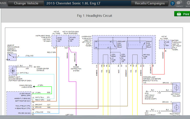

Passenger side dim headlamp is out
2015 CHEVROLET SONIC
23,000 MILES • 1.8L • 4 CYL • 2WD • MANUAL
MEAGANSNOW03
The passenger side dim headlamp is out. We have checked all the fuses and replaced the bulb. I've read that it could be a relay problem or reining, but I can not find a wiring diagram. Can you help me please?
Apr 27, 2019 at 4:31 AM
SCGRANTURISMO
  • 4,897 POSTS

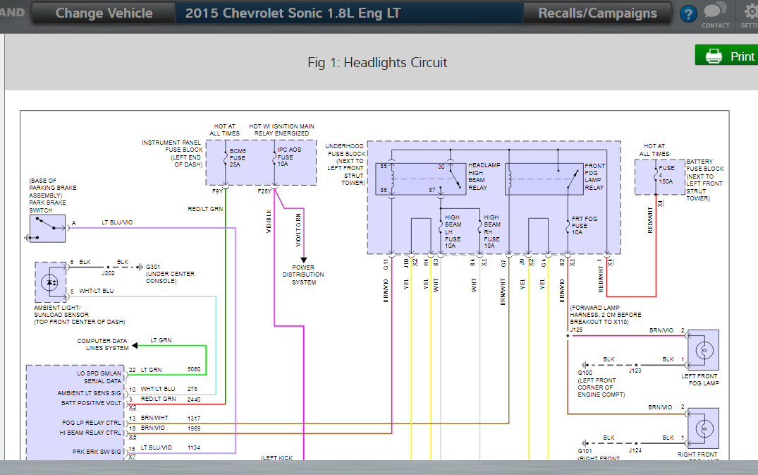

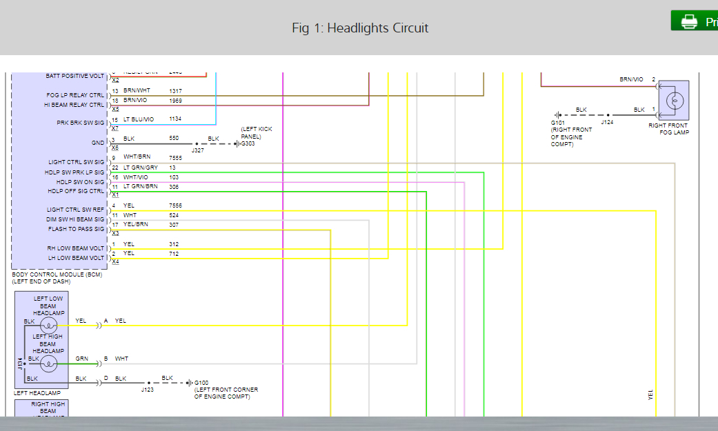

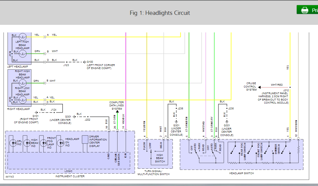

I have included the Headlight Circuit Wiring Diagram for you in the diagrams down below. Please, if you should have any other vehicle related questions, feel free to ask. It's why we are here.
