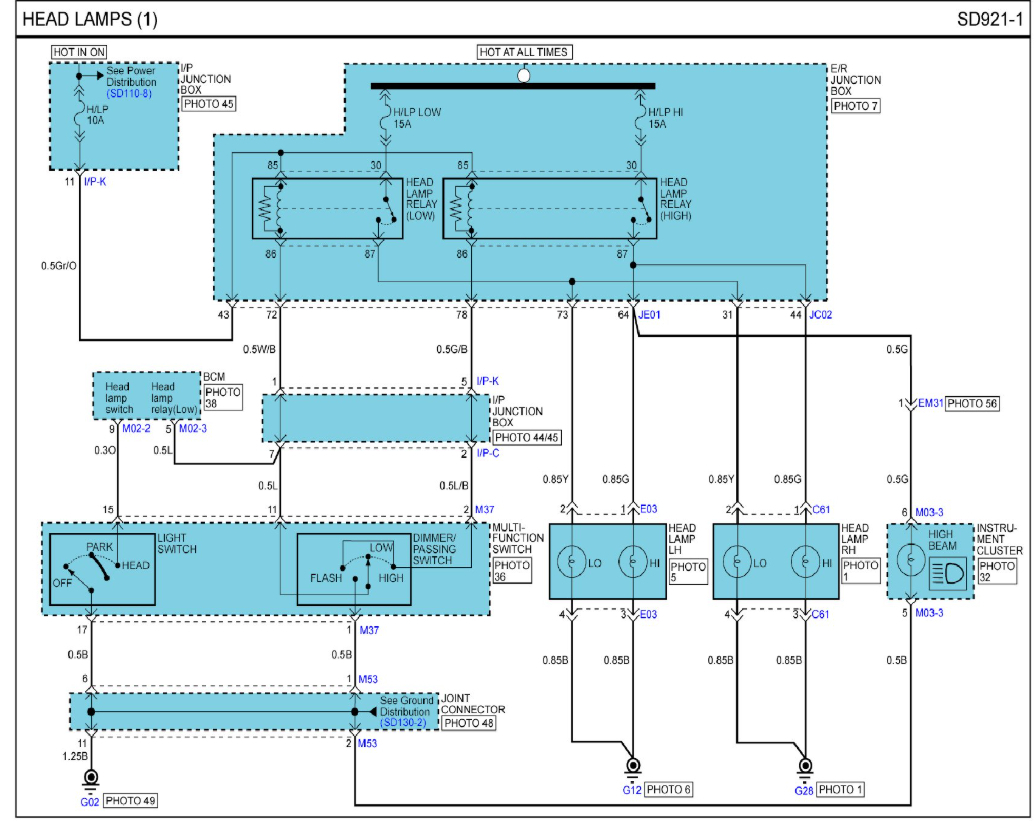

The vehicle headlights are not functioning at all, could I get the circuit diagram for the light?

I would check the H/LP fuse in the fuse panel inside the car. Then the headlights are run by relays in the fuse panel under the hood, here are the headlamp wiring diagrams as requested. This guide can help:
Check out the images (below). Let us know how it goes.
