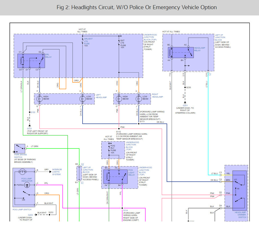

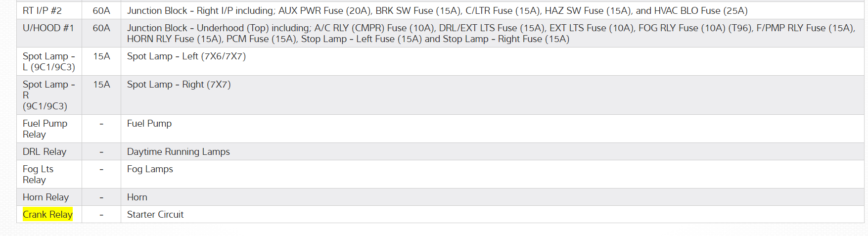

Left side headlights are dim?
2004 CHEVROLET IMPALA
150,000 MILES
BENNY B
Aug 31, 2022 at 8:19 AM
  • 54,832 POSTS

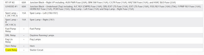

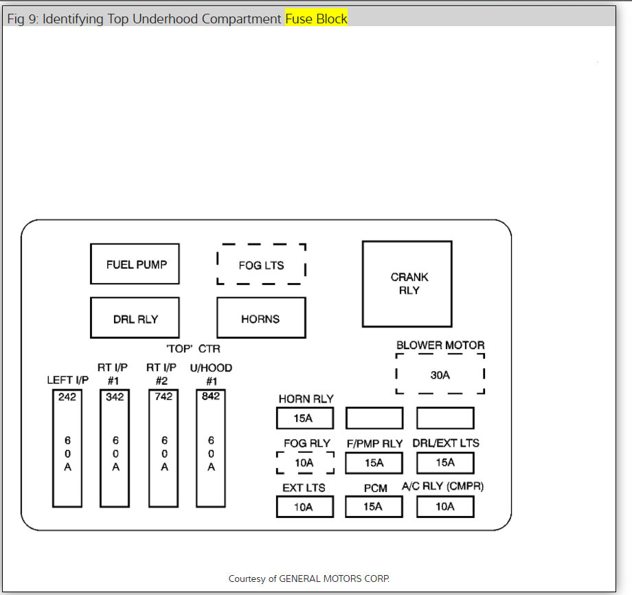

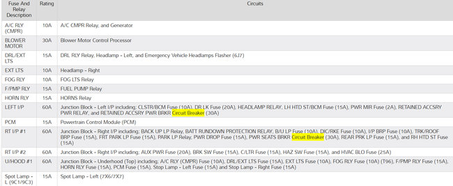

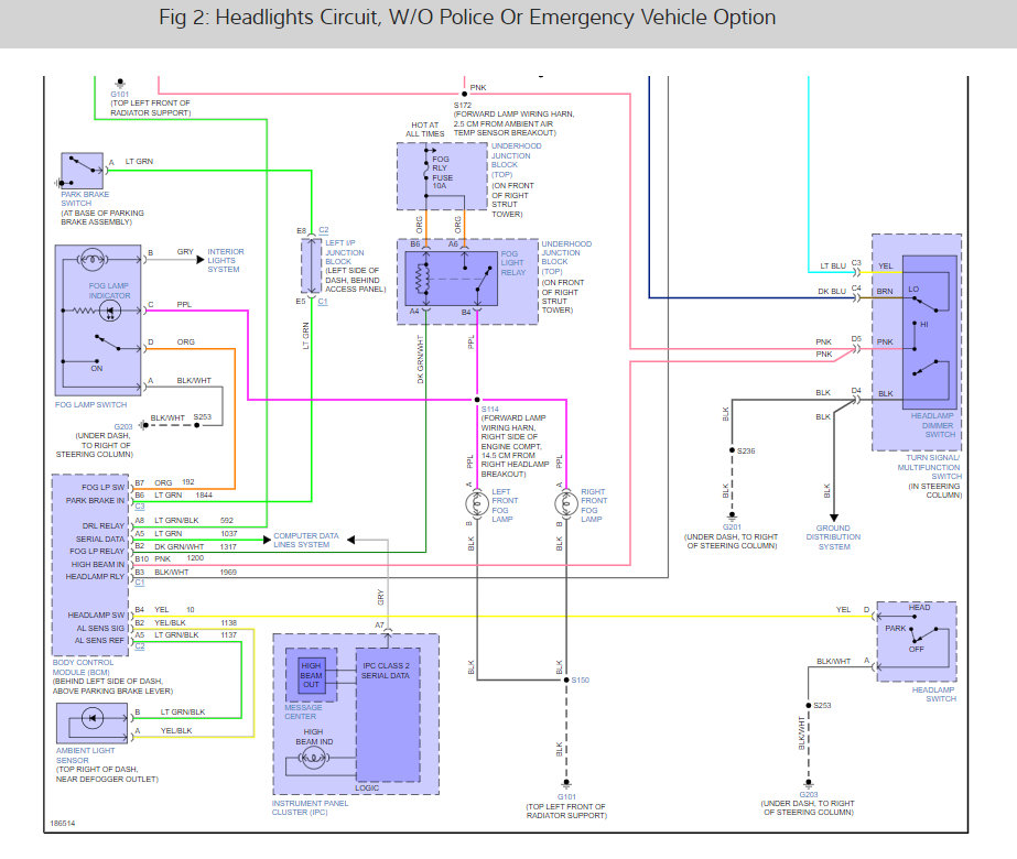

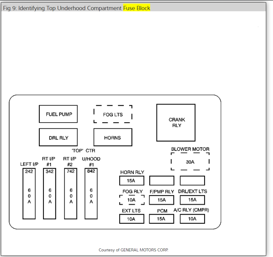

Let's start by checking the fuse DRL/EXT LTS 15-amp fuse which is located by the left front shock tower under the hood. Here is a guide to help you with the fuse locations in the diagrams below. Also, i have included the headlight wiring diagrams so you can see how the system works.
