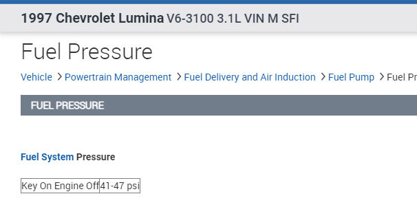

Have you checked the fuel pressure to see if it is within spec? It sounds like the pressure is low, but it can idle, but when it's under a load, the pump can't keep up.
If you haven't, that is where I recommend starting. Here is a link that explains how to check the pressure:
If you look below, I attached the manufacturer's pressure specifications.
Let me know what you find.
See pic below.
