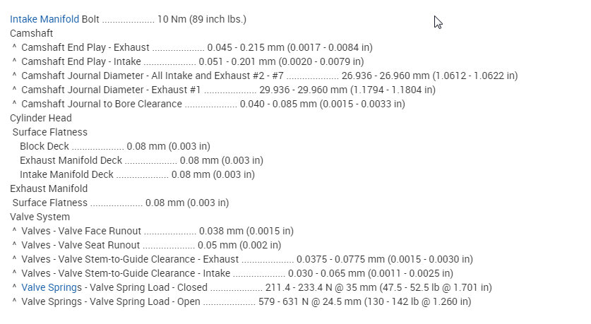

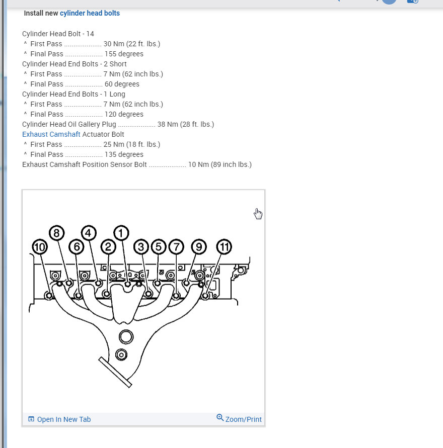

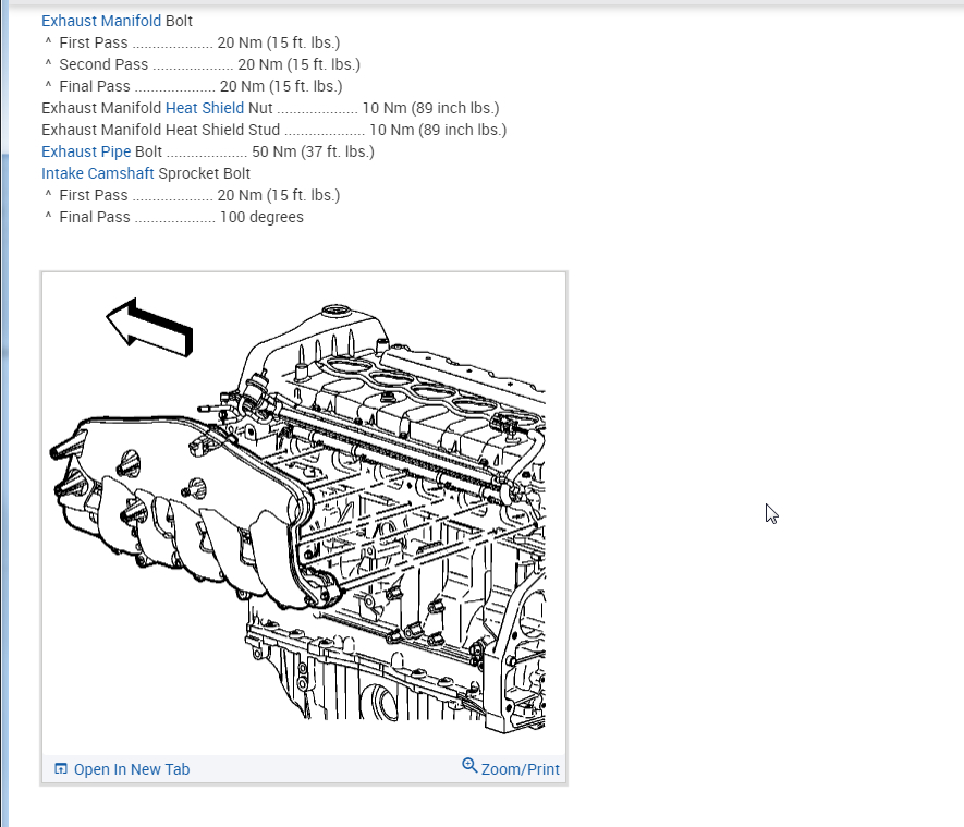

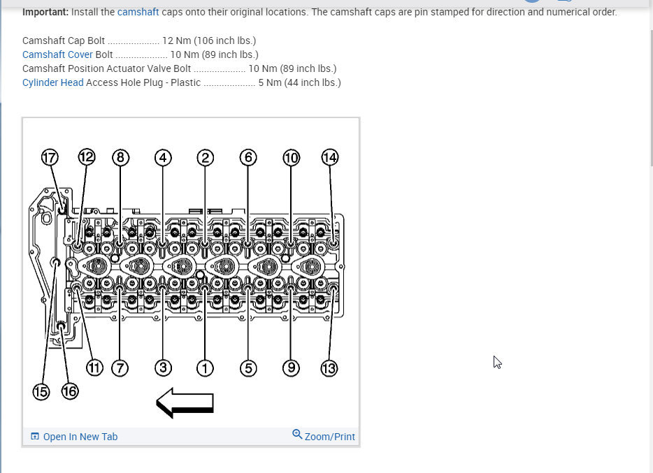

Can you tell me the order and torque to be used when replacing the head gasket and tightening the new TTY bolts?
Jun 27, 2020 at 10:19 AM
I attached the specs for the head. Let us know if you have other questions. Thanks.

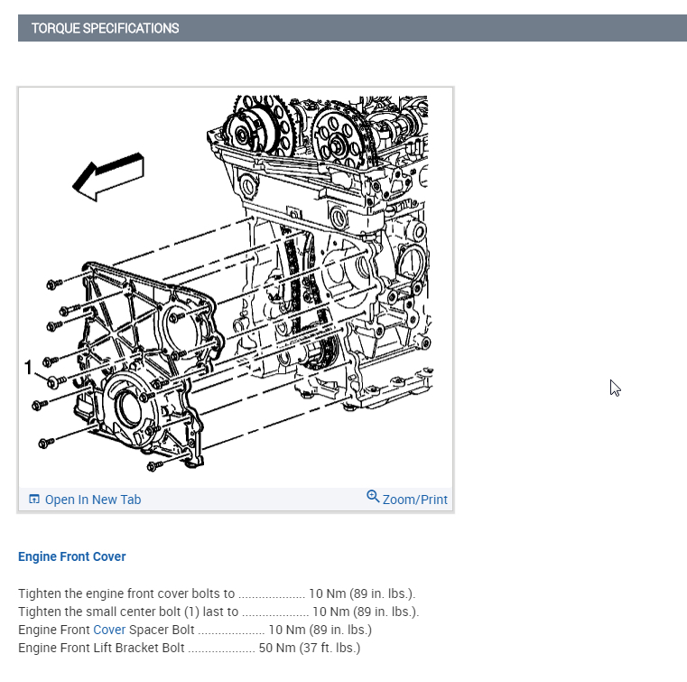

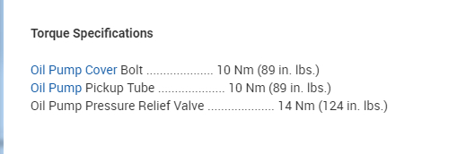

Thank you so much. Same car listed above; do you know the bolt pattern and torque specs for the oil pump/timing chain cover?
Jun 30, 2020 at 3:37 AM
You are welcome. I attached the requested info. Thanks again for using 2CarPros.
