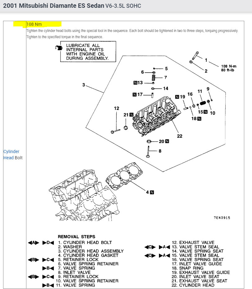

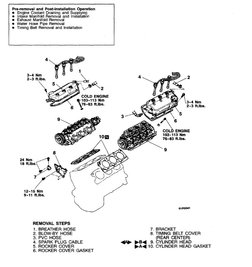

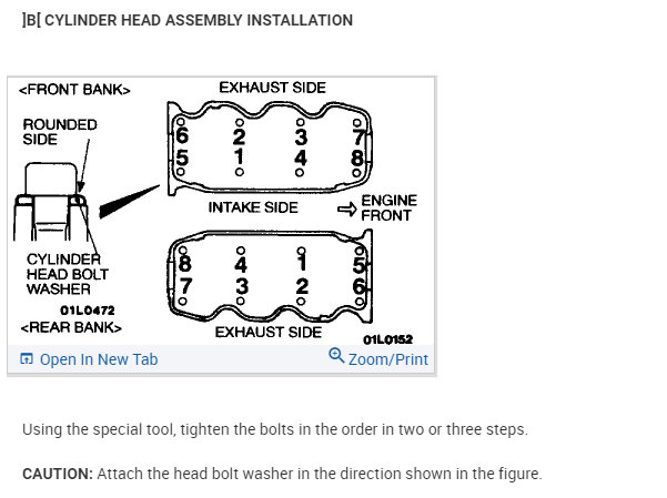

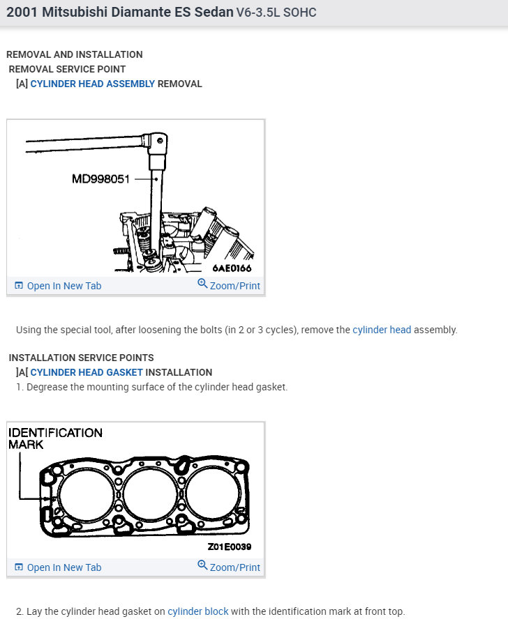

Follow up to the manifold questions...if you could provide any diagrams, advice, torque specs etc. for the rest of the project. I'm down to the exhaust manifolds and ready to remove them. It was just too hot to work on it yesterday so I will be working on it at night due to the heat. Anything you can provide would be greatly appreciated. I really wish I had found you guys sooner lol, I'm sure you would've saved me some time, money and headaches. While I'm decent at working on cars I'm not a master at it and have my moments of what the heck man! Thank you again for providing an invaluable service. Every other place you ask a question they send you to a credit card reader for pay. Thank you again. You guys' rock!!
Aug 17, 2022 at 8:46 AM
SQM
  • 6,383 POSTS
We are very glad that you have found our services to be helpful.
See attached for the cylinder head procedure including the torque specification and sequence.
Let me know of any questions.

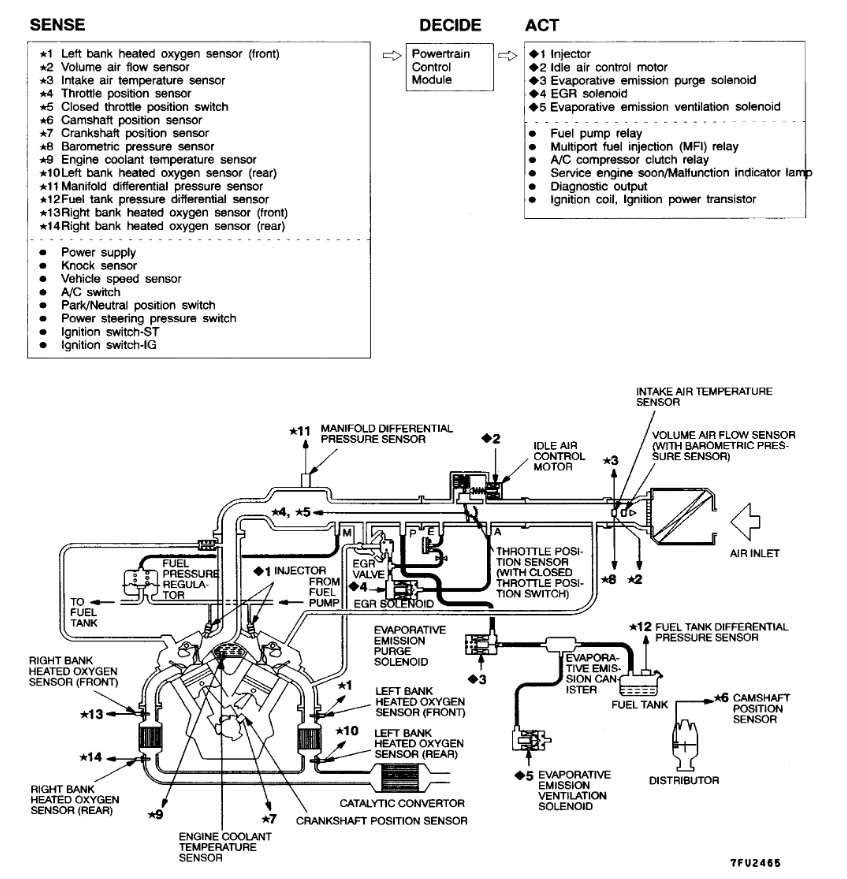

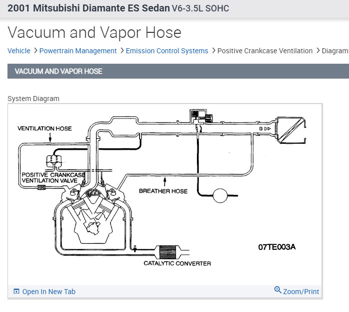

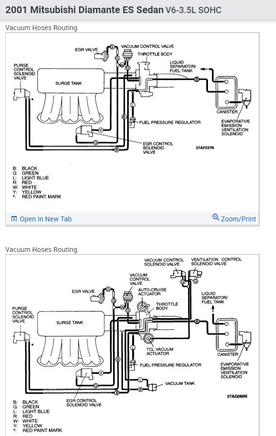

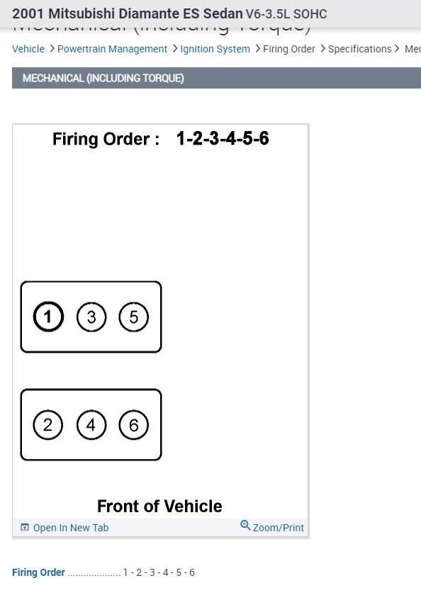

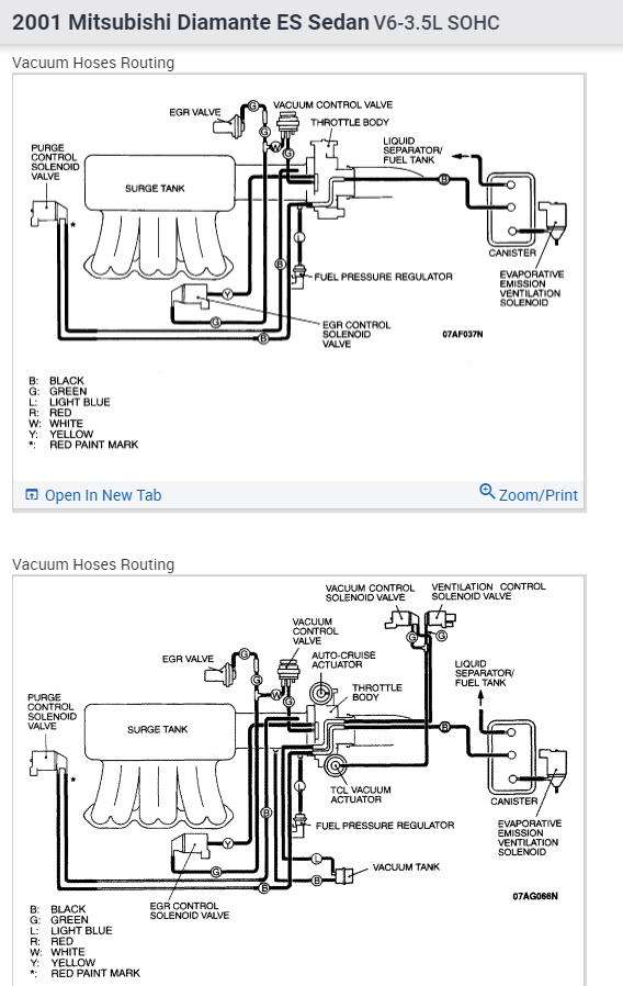

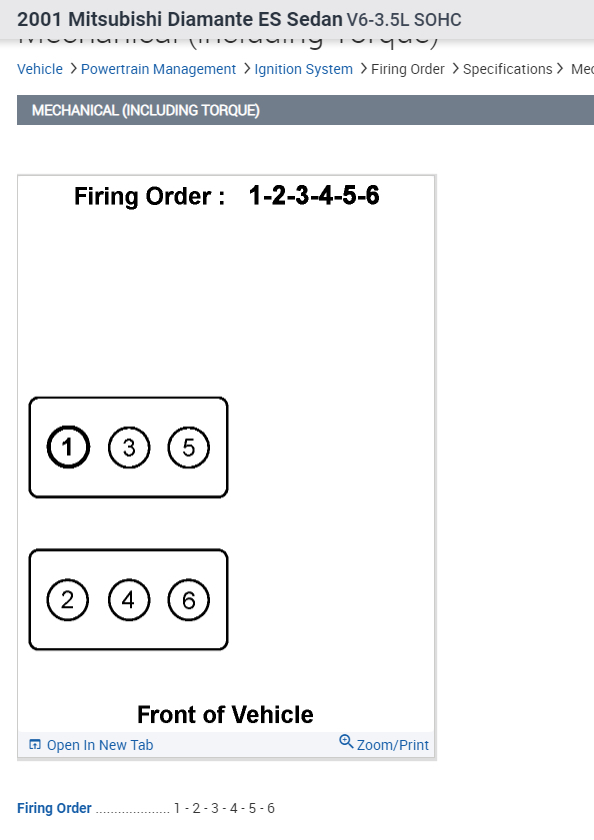

Hi guys, heads are off and waiting to get them shaved, in the meantime I could use a diagram of firing order and if possible, all vacuum lines and assorted hoses or lines. Some have broken due to old age and cracking. Once again thank you so much for all your help!!
Aug 20, 2022 at 7:56 PM
SQM
  • 6,383 POSTS
See attached for the firing order and vacuum diagrams.
