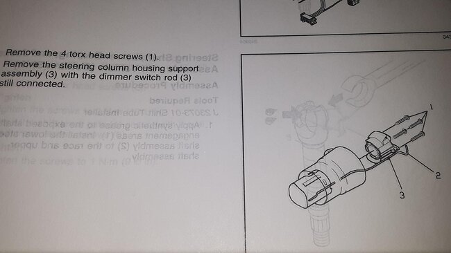

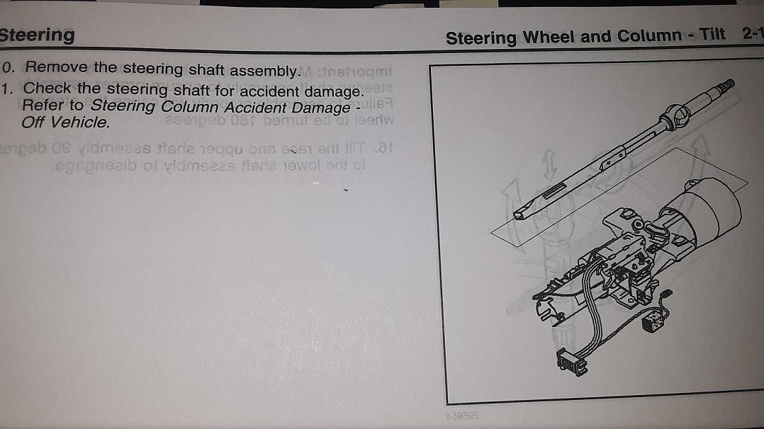

Here is an interesting question which you probably never have run across. About one year ago, I bought the GM shop manuals for the car, all three as a set, but suspect there may be a problem with the manual set. Attached are photos which may help understand my question.
1. Left photo
The GM Buick 1998 LeSabre manual, Volume 2 of 3, second edition
2. Middle photo (from this manual)
For example, this diagram is unlabeled, with only its numbers referring to text in the left side column. In that photo, you see the number 2 has no supporting text, while number 3 is represented twice in the diagram, as well as in text on the left column.
3. Right photo (from this manual)
In this photo, only the cryptic instruction, "Remove steering shaft assembly". To somebody who has done the procedure, this is a ho-hum checkpoint, but a DIY person does not know what is involved.
Since you probably are familiar with how the Buick OEM shop manual should look, do the two photos (middle and right) look as they should? It seemed odd not to find text labels beside parts displayed in a diagram. I may have been sold a manual misprint, which is normally discarded by the publisher, but sometimes can be unloaded in the aftermarket to people who do not know what the manual should provide.

I've seen manuals that way. The OE supplier for the GM manuals in that era was Helm Inc. Normally there were 3 or 4 volumes with one being the basic vehicle platform, another being in depth on assemblies and the others for unit repair (engines, transmissions). The thing is that most service information isn't written for a DIYer, it is written for a shop that does the work a lot and just points to the way the factory thinks things should come apart, with the tech reading it and filling in the blanks based on their training and experience. That is why you also don't see sections on how to use tools (other than specialty tools) and other "common" things. The tech is usually going to know these things (or should) before they get into the work. That is why there are different job skill levels as well. A-B-C being the common ones. A C level should be able to do any of the basic maintenance like oil changes, tire rotations and such. B level gets into lower-level diagnostics and things like replacing window actuators, steering work, alignments and such. The A level folks can do all that as well as high level diagnostics, transmission, engine and more at teardown, inspection and rebuild levels as well as being the ones who usually mentor the lower level folks.
In the ASE world it would sort of be, no or only one ASE - C level, Most of the ASE modules and 2-3 years' experience - B level. Full ASE master technician certification and 5 or more years on the line would be an A level tech. But don't take those as the gospel truth, I've seen and known folks without a single piece of paper who can work miracles on vehicles that made others cry, and I have seen people with every cert. they could get that I wouldn't trust to put the license plate on correctly!
