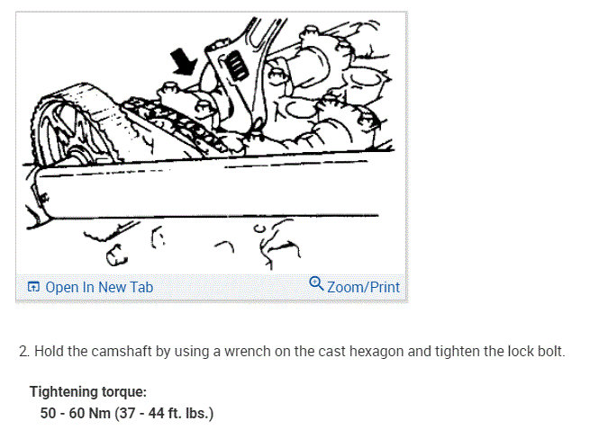

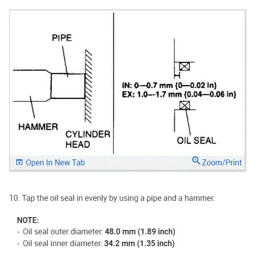

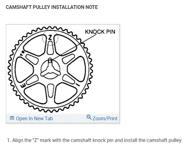

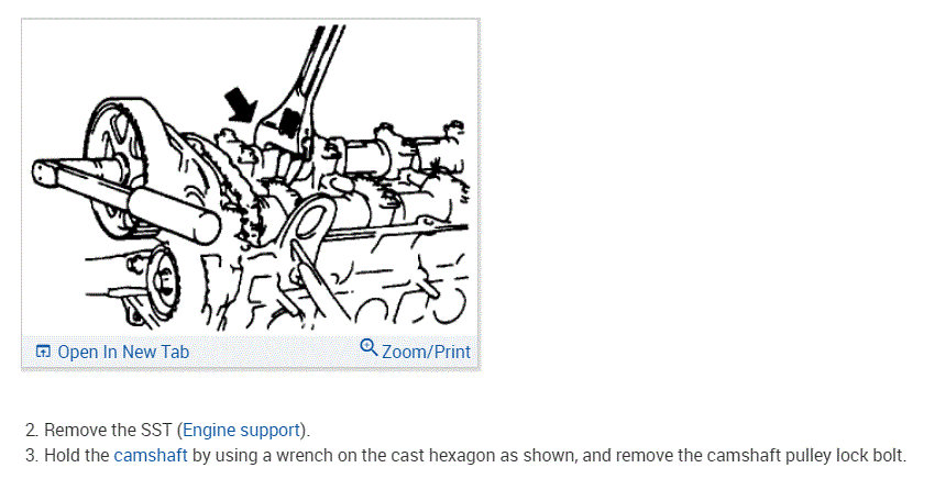

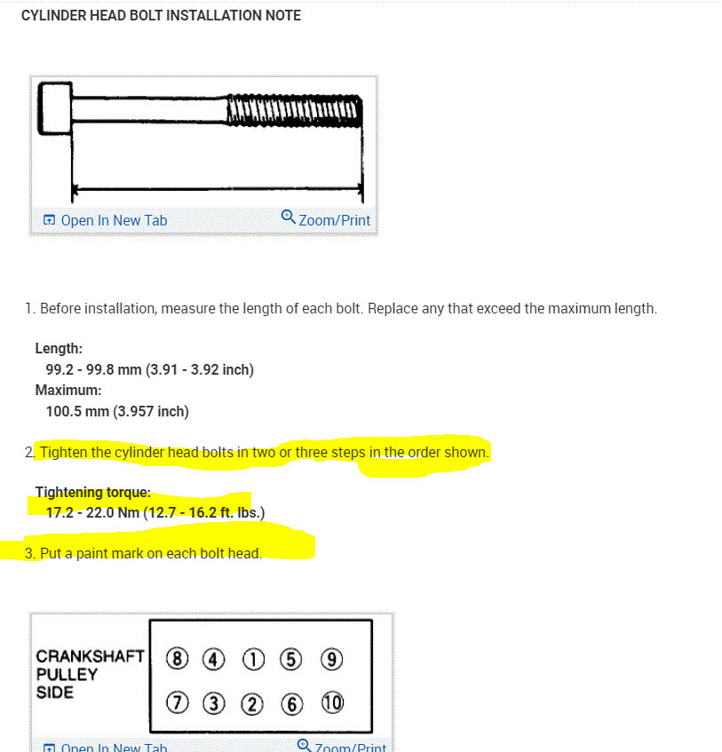

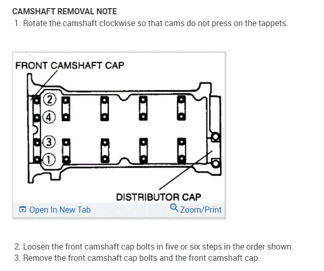

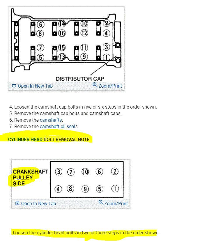

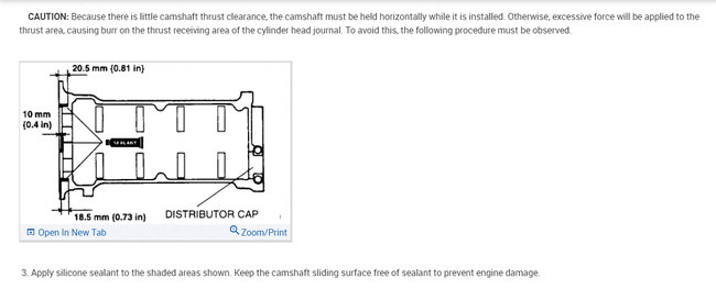

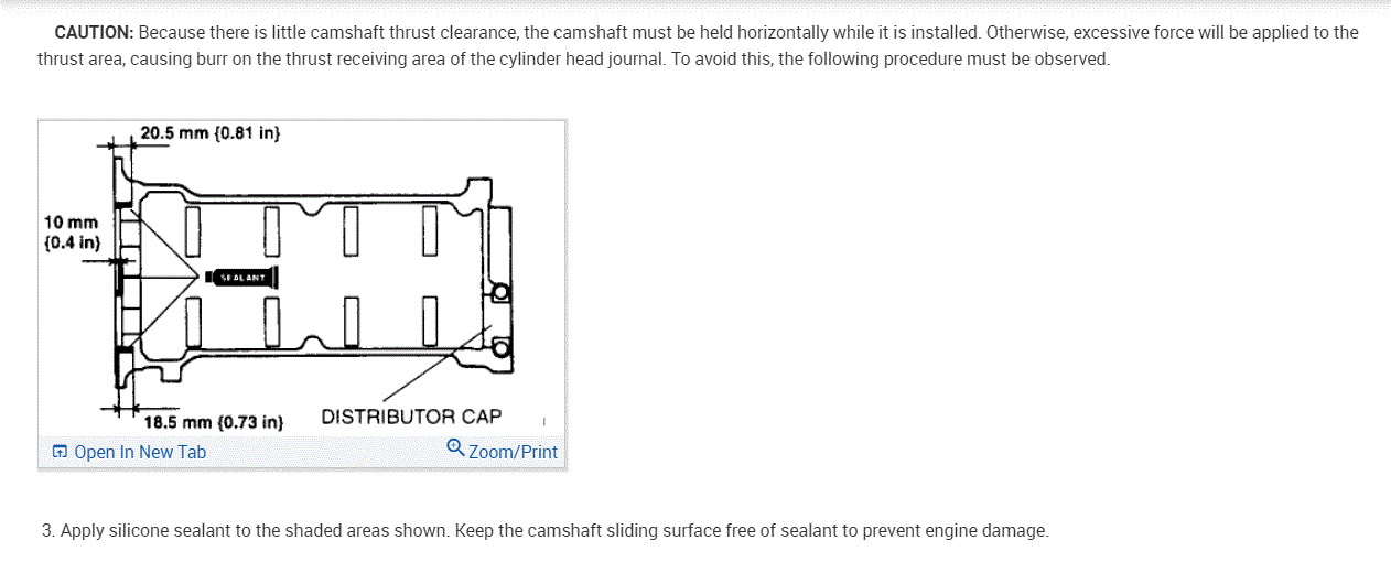

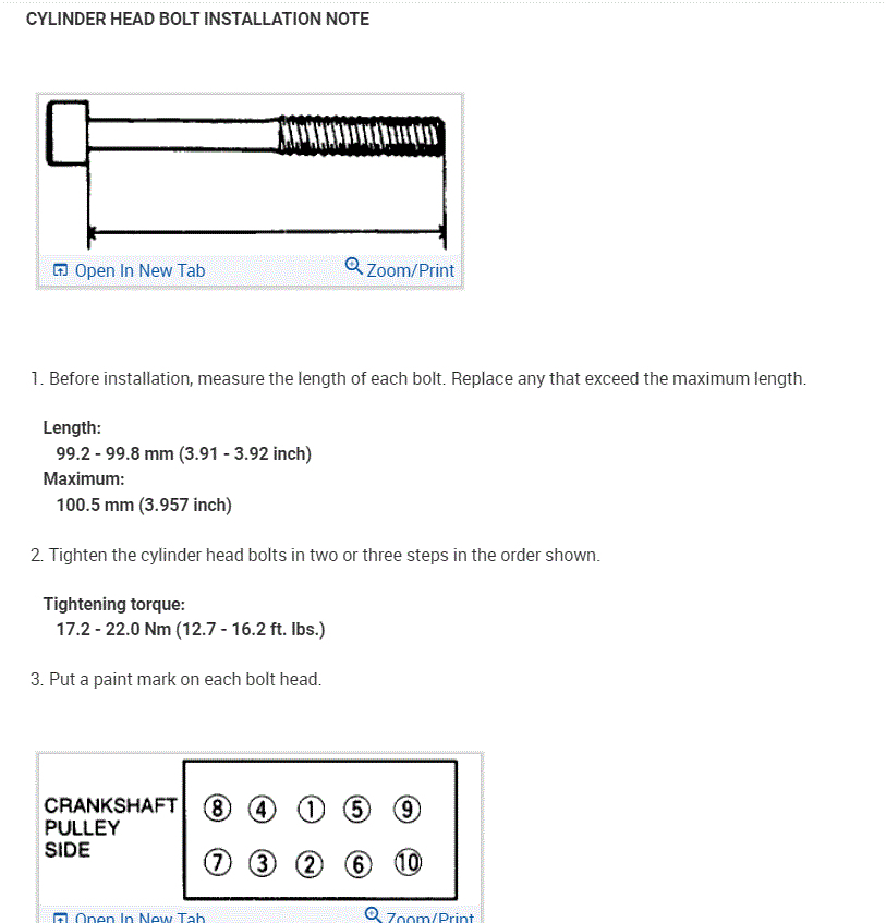

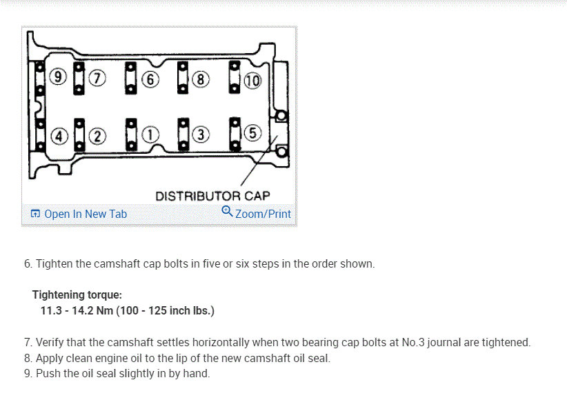

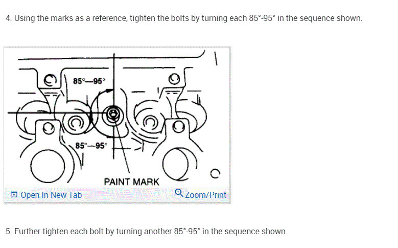

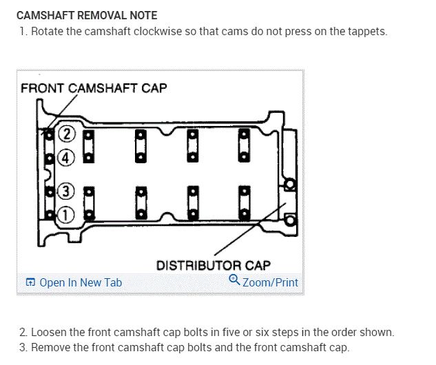

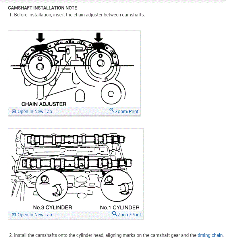

I am having to replace my head gasket and do not know torque specs nor what pattern to loosen or tighten the bolts in.
May 19, 2022 at 8:08 AM
  • 110,244 POSTS

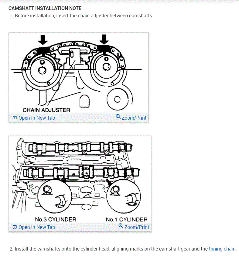

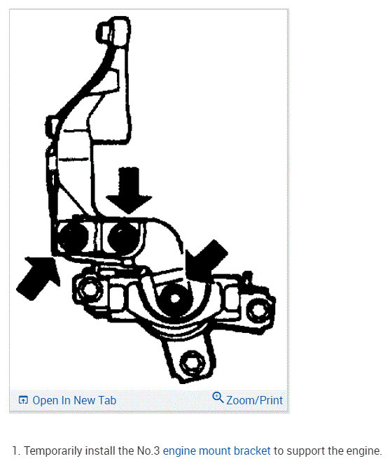

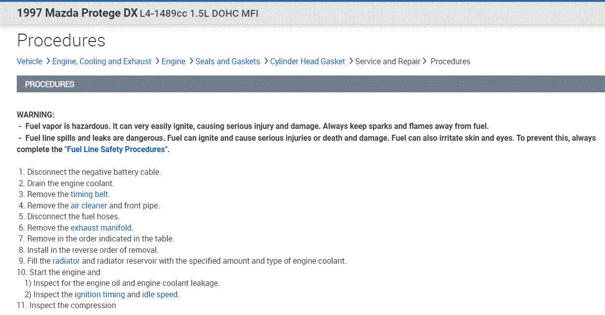

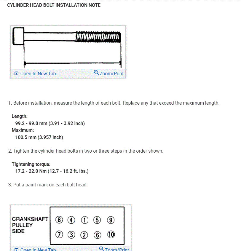

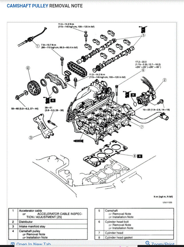

The removal and replacement of the head bolts does require a specific procedure. If you look below, I provided the directions for replacing the head gasket. The directions explain the timing procedure, bolt sequence loosening and tightening, torque specs, and so on.
Take a look through them and let me know if you have questions or if I can help.

I was wondering if the last four images are in order, i'm a little confused by the last ones.
May 31, 2022 at 7:09 AM
  • 110,244 POSTS
Yes, they are in order. They are explaining the procedures for installing the cam, the cam seal, and then the last one shows how to tighten the cam gear.
Let me know if that helps.
