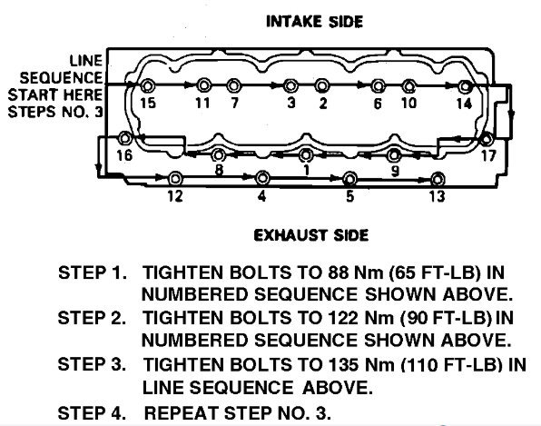

Clean bolt holes in the block (chase threads if needed). Lightly oil the bolt threads and underside of bolt heads.
Here are the torque specs and sequence to install the heads. Let me know if you need more instructions. Check out the images (below). Ken

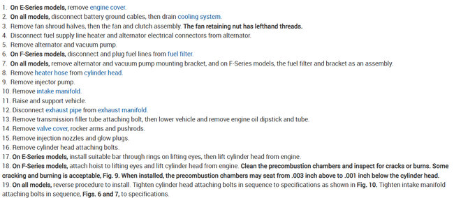

Here is a link so you can get the full instructions step by step if you need it.
https://www.alldata.com/diy-us/en
Let us know how it goes

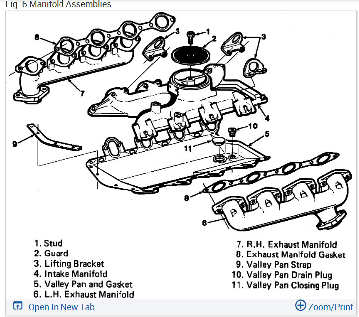

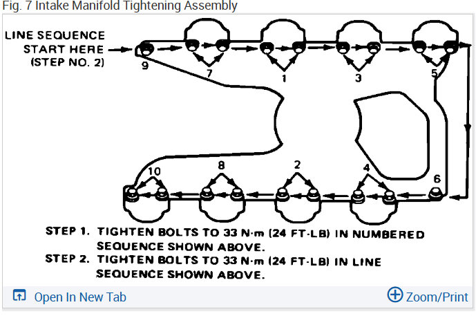

Is there any place I can get help that doesn't cost me money? I'm literally stuck was just in an accident and totaled my Buick and insurance company sucks so no help there and I'm down to scraping just to get stuff to get this truck on the road mainly just need to know about this tray underneath the intake on how to get it off and what it should look like because it looks broke to me and that might be the problem it the head gaskets.
Mar 3, 2026 at 6:38 AM
  • 55,433 POSTS
No worries, here are the instructions on how to do the cylinder head gaskets. Please upload an image a short video of any problems you have so I can help walk you through the job. Check out the images (below).
