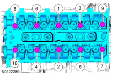

I need to obtain the torque settings and sequence for the cylinder head bolts, please.

You will need new cylinder head bolts (10) because there are torque to yield which can only be used one time.
Install the cylinder head gasket, cylinder head and 10 new bolts. Tighten the bolts in the sequence shown in 4 stages:
Stage 1: Tighten to 5 Nm (44 lb-in).
Stage 2: Tighten to 15 Nm (133 lb-in).
Stage 3: Tighten to 35 Nm (26 lb-ft).
Stage 4: Tighten an additional 75 degrees.
Check out the images (below). Let us know if you need anything else.
