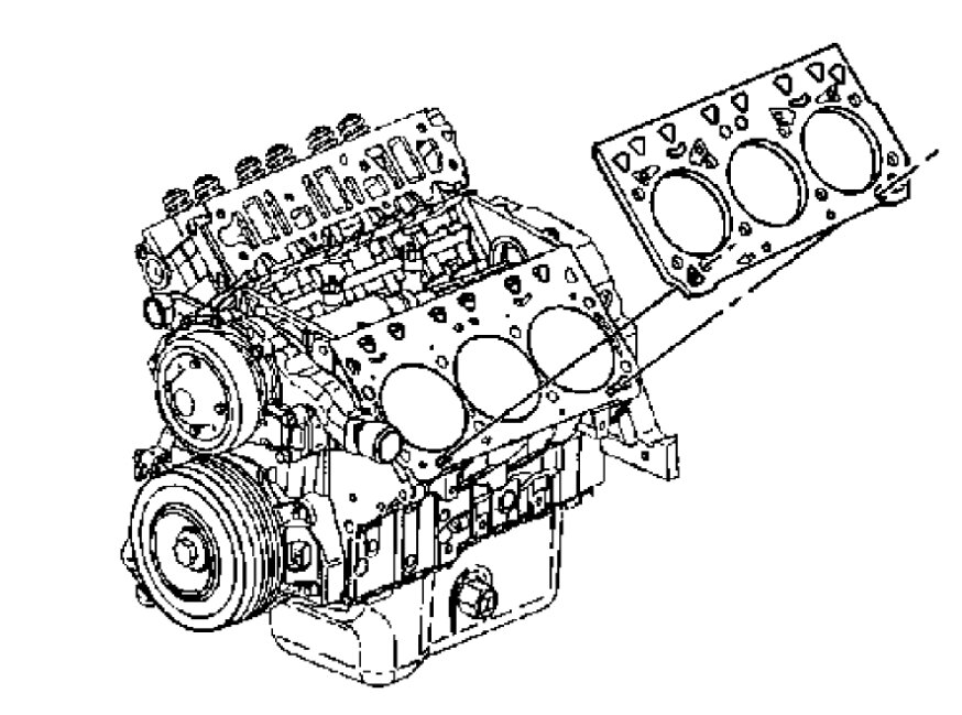

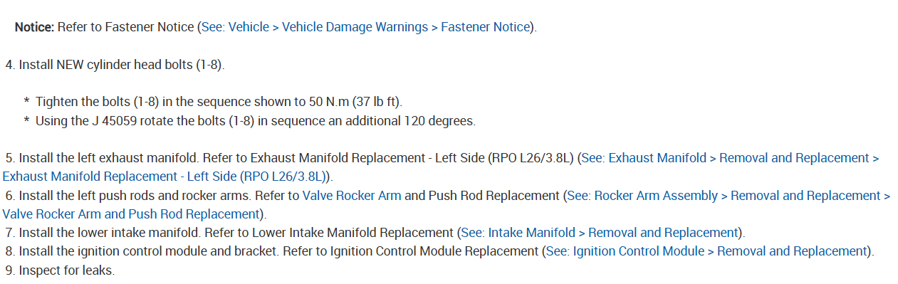

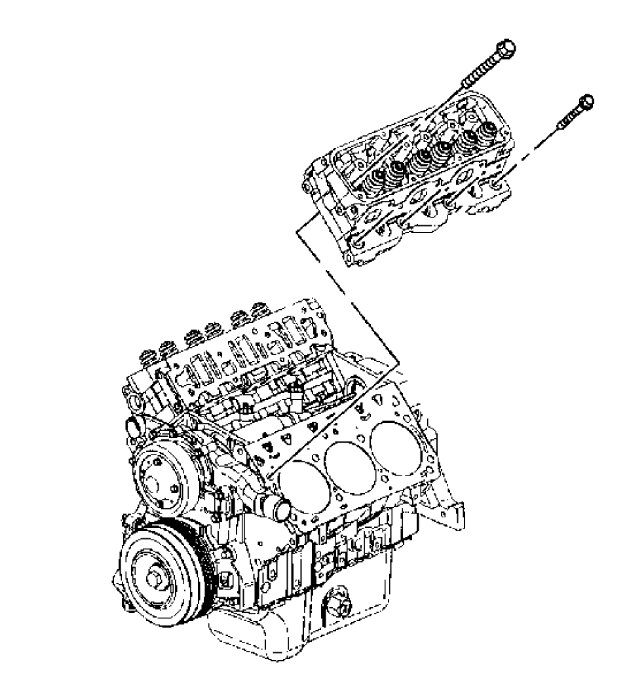

How do I change the head gaskets step by step?
2008 BUICK LUCERNE
73,000 MILES • 3.8L • AUTOMATIC
ARIANADANIELLE5345
  • 402 POSTS

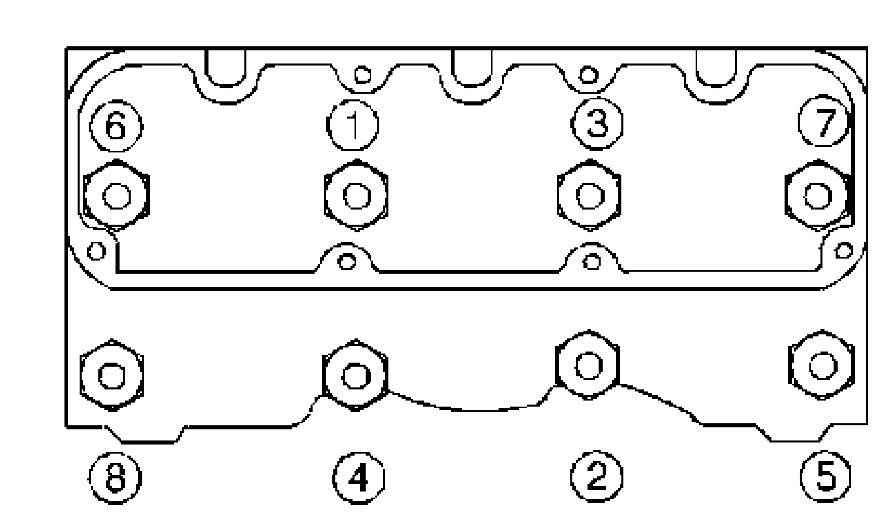

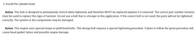

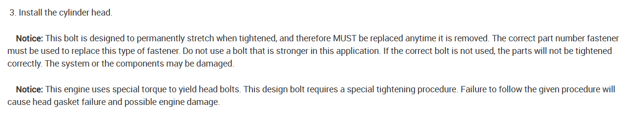

Also, are the head bolts torque to yield?
Nov 10, 2024 at 5:02 AM
  • 55,423 POSTS

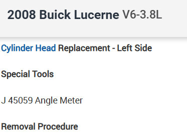

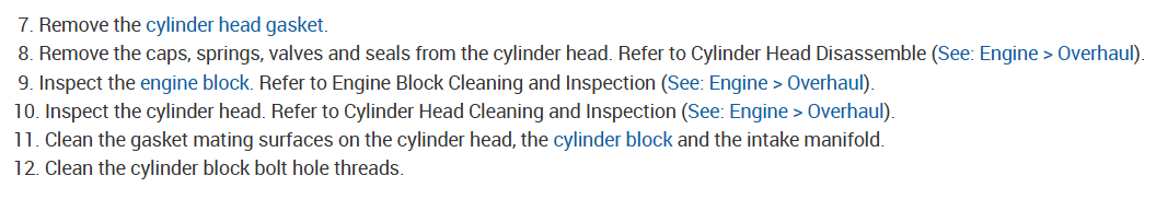

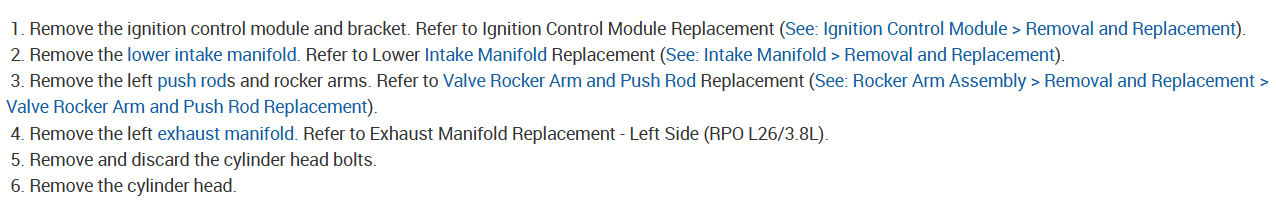

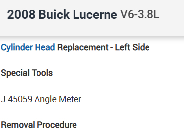

Yes, these head bolts are torque to yield and must be replaced. You will need to remove the intake manifold, and valve covers along with the valve train, start by disconnecting the battery and draining the coolant and change the engine oil once the job is completed. Also, clean all gasket surfaces completely before the reassembly. Here are the remainder of the cylinder head replacement instructions that include torque specs and tightening sequence. Check out the images (below). Let us know if you need anything else.
