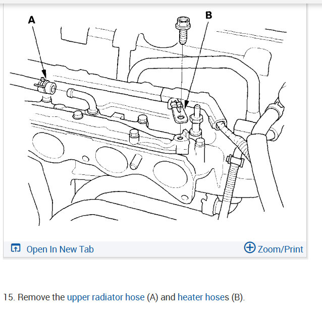

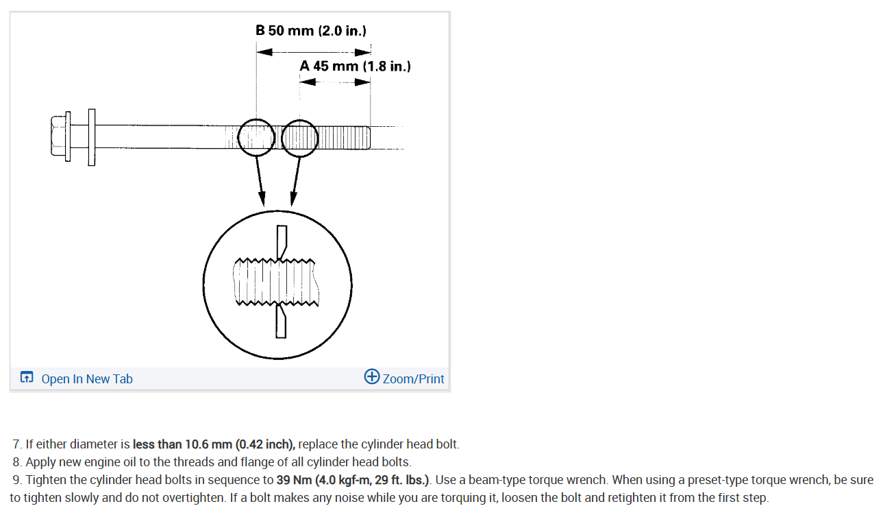

What all needs to be replaced when changing head gaskets?
2003 HONDA ACCORD
200,000 MILES • 4 CYL • AUTOMATIC
ARIANADANIELLE5345
  • 402 POSTS

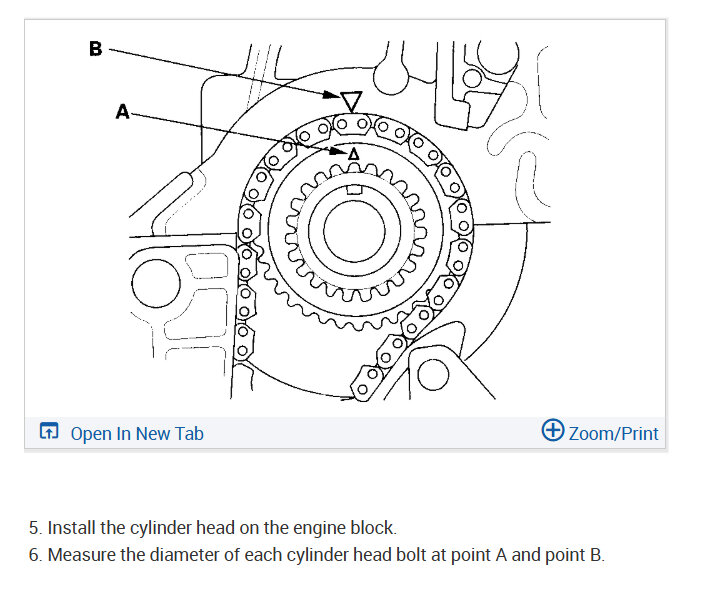

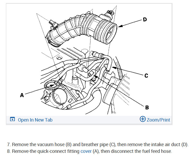

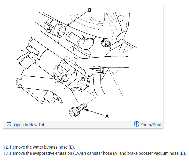

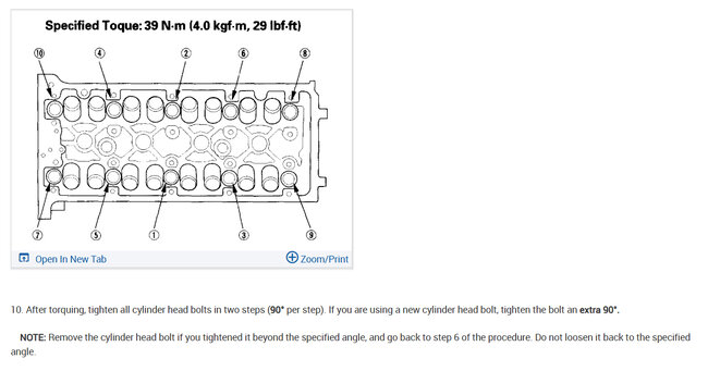

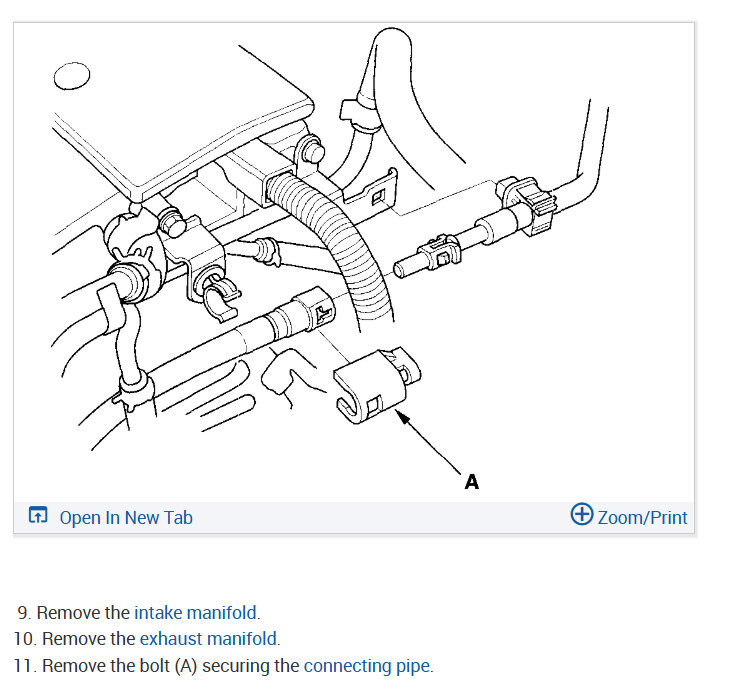

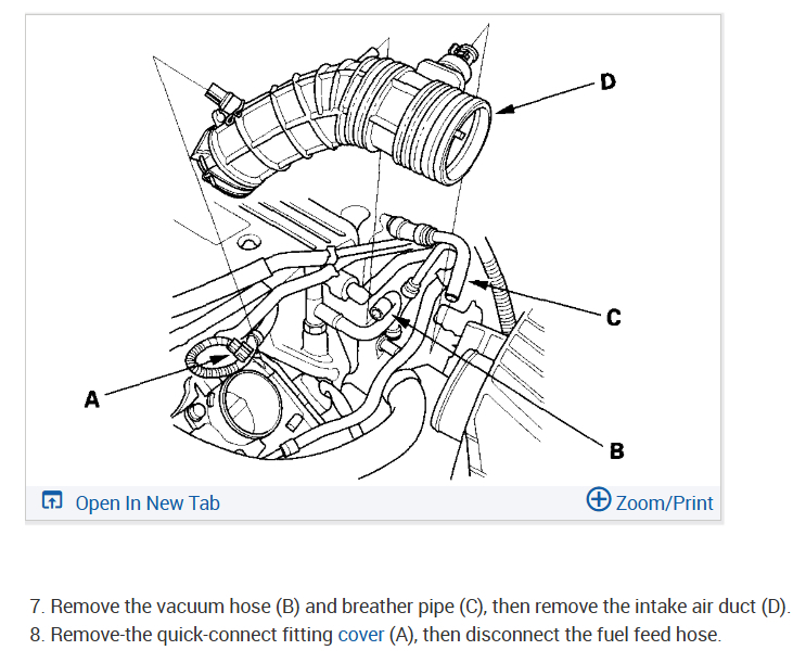

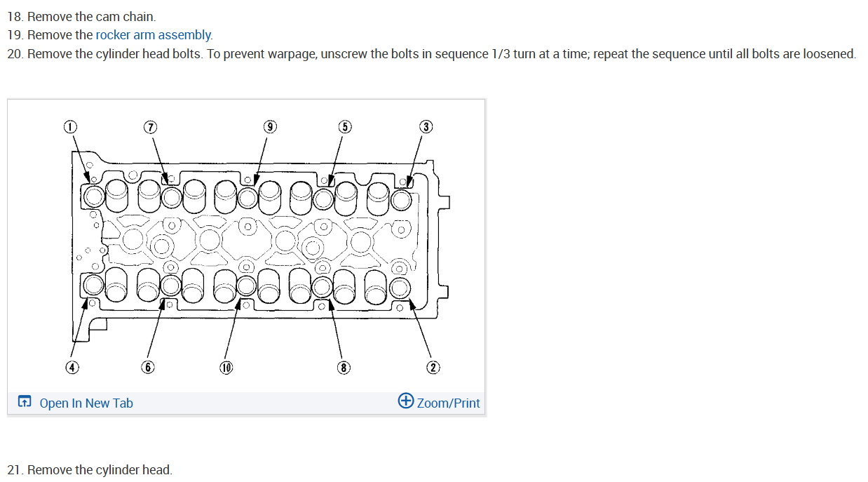

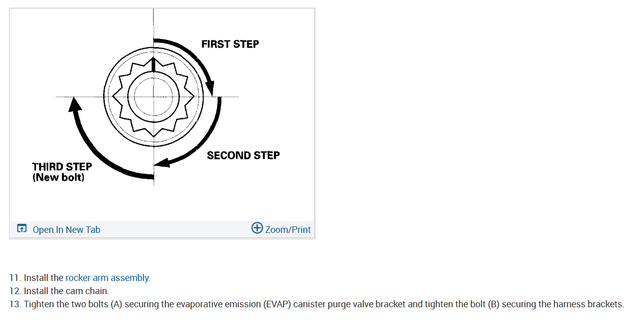

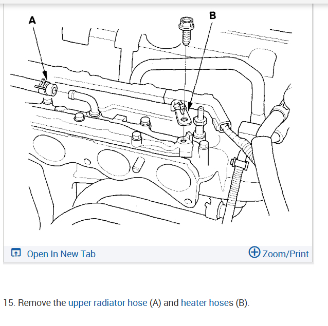

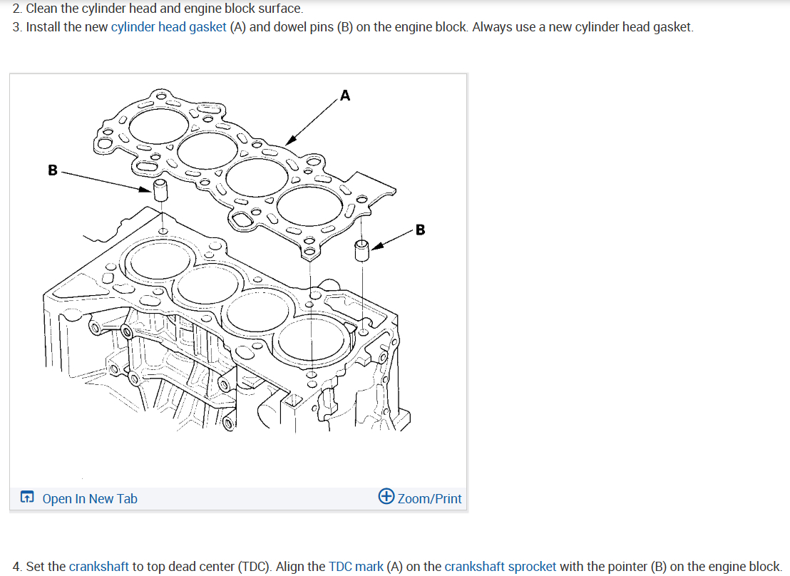

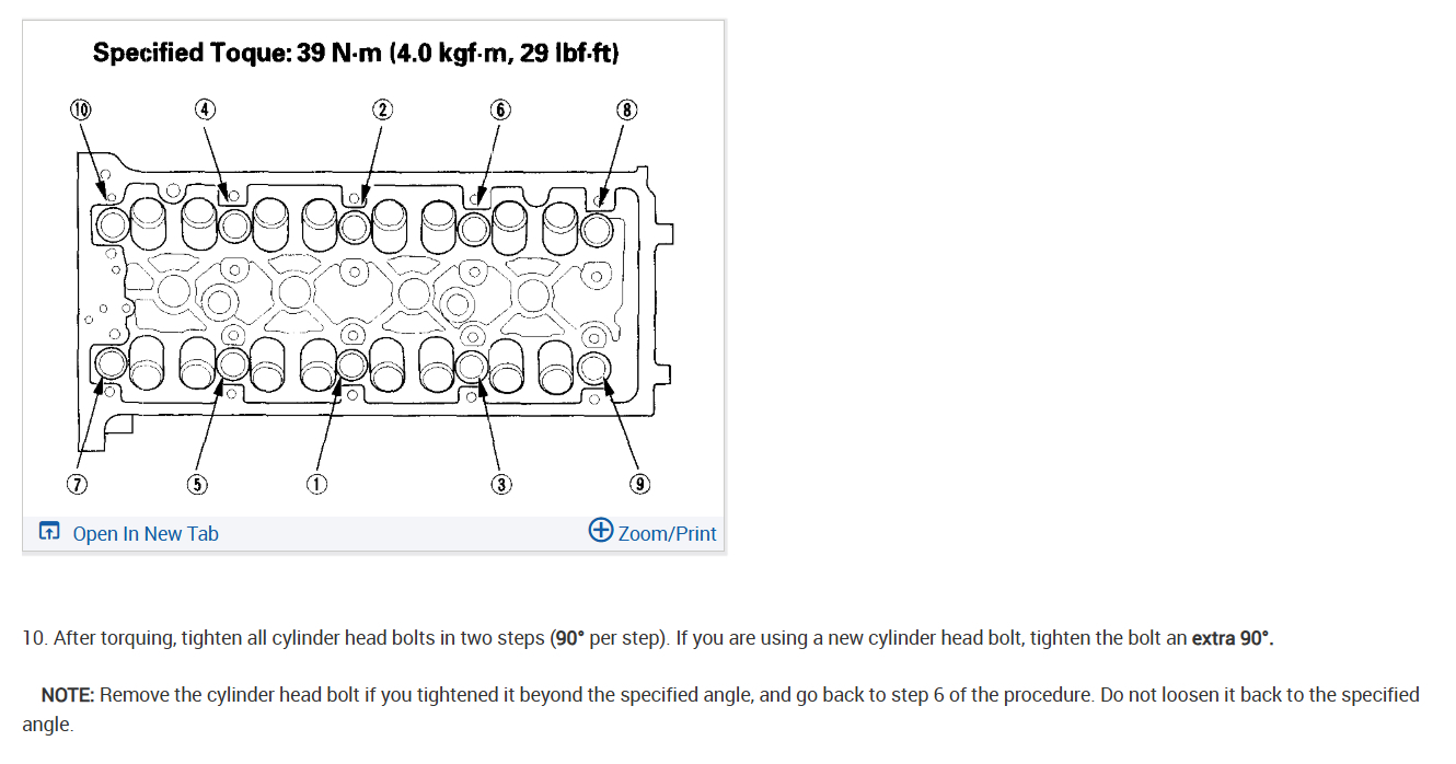

Like what parts do I need to get? I got the head gasket kit with all the seals and gaskets I’ll need, but are the bolts torque to yield? Do I need to replace the timing or water pump?
Feb 1, 2025 at 2:03 AM
  • 55,224 POSTS

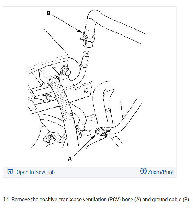

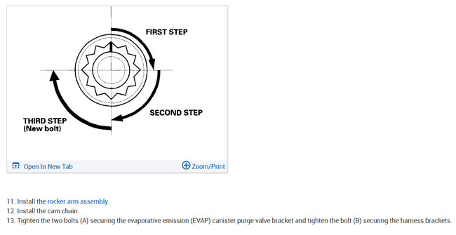

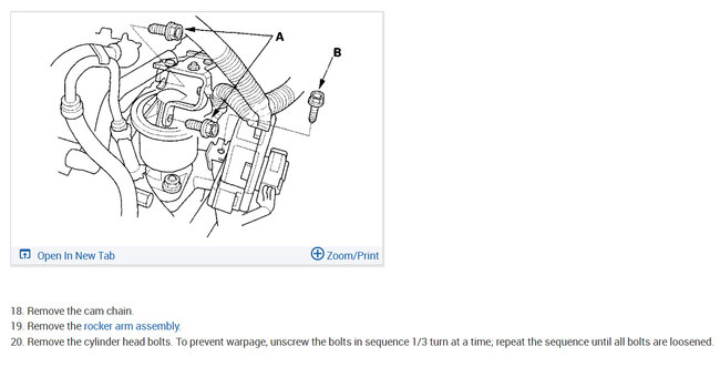

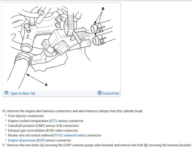

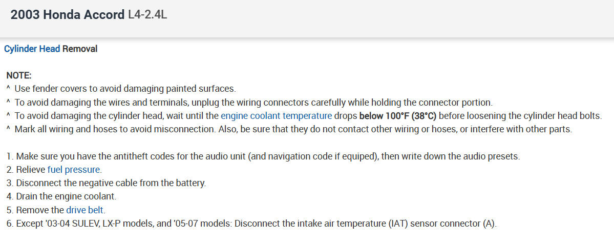

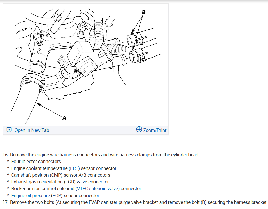

Yes, I would replace the timing chain/guides, and water pump, these are torque to yield, I would resurface the cylinder head as well. Here is a guide to help walk you through the steps with instructions for you can in the images below. Let us know if you need anything else.
