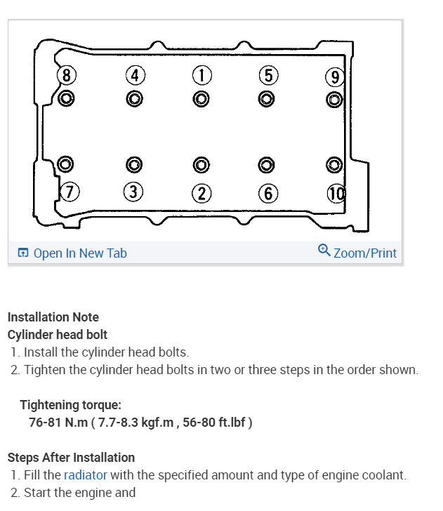

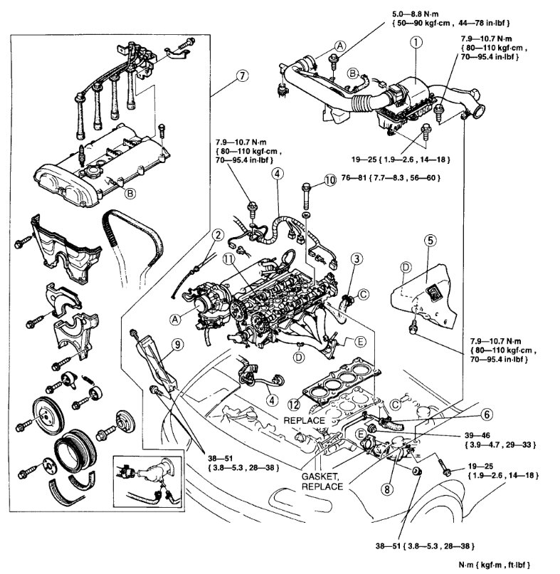

Replacing head gasket. It is blown out in front oil galley going to camshaft. Losing compression in front cylinder and oil fouling the alternator. Specifically need torque specs for head bolts, are they torque to yield, and timing belt alignment procedure, but as usual, step by step instructions are appreciated. Thank you, Alex.

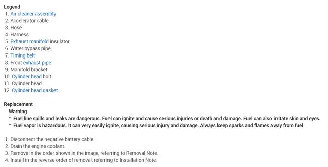

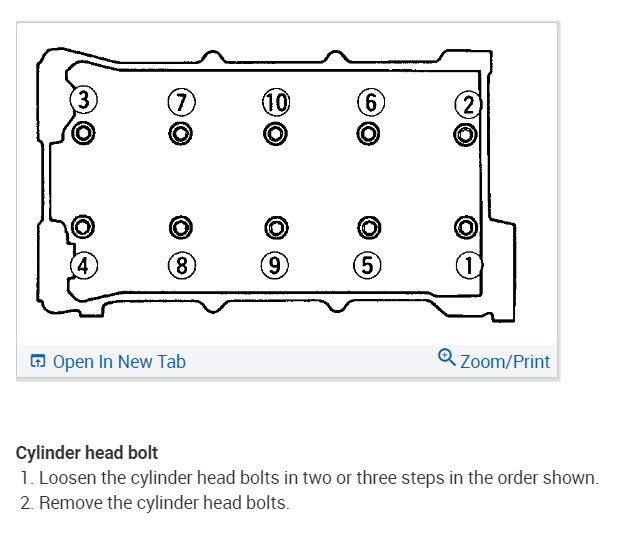

I would start by disconnecting the battery and draining the coolant. This guide can help us get started as well:
https://www.2carpros.com/articles/how-to-replace-a-car-engine-head-gasket-a-step-by-step-guide

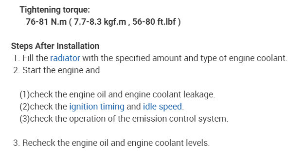

Here are the steps and cylinder head torque specs as requested. Cylinder head bolt
1. Install the cylinder head bolts.
2. Tighten the cylinder head bolts in two or three steps in the order shown.
Tightening torque:
76-81 N.m ( 7.7-8.3 kgf.m , 56-80 ft.lbf )
Check out the images (below). Please let us know if you need anything else to get the problem fixed.
