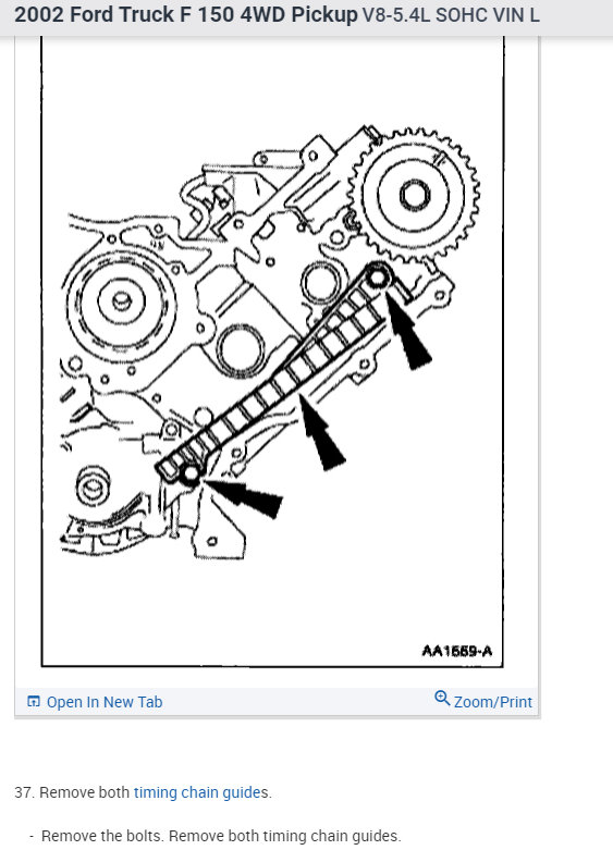

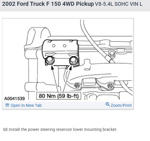

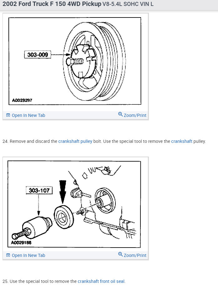

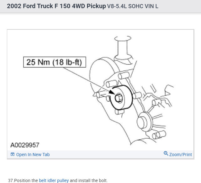

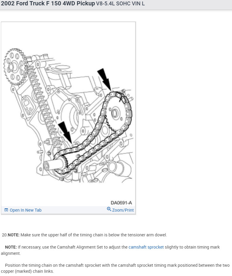

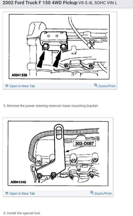

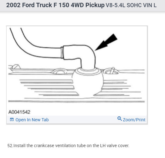

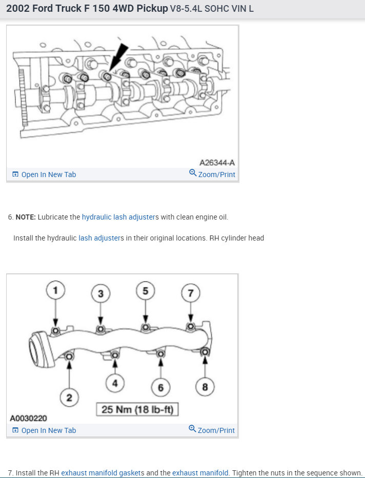

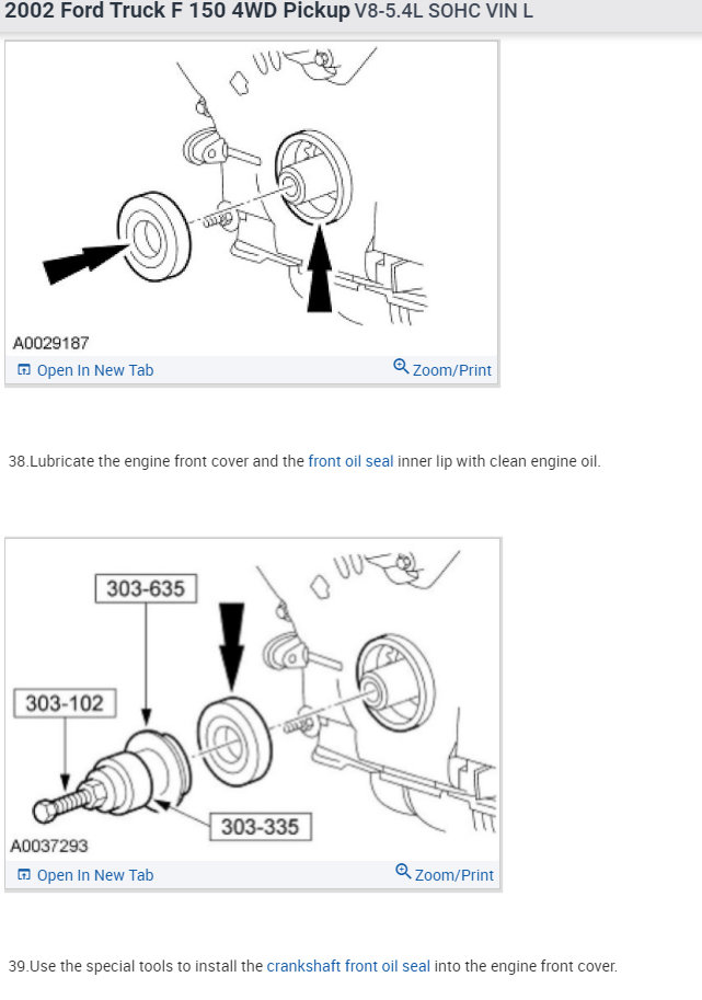

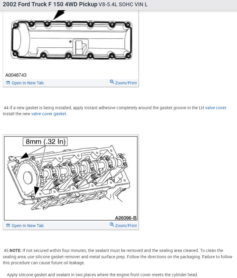

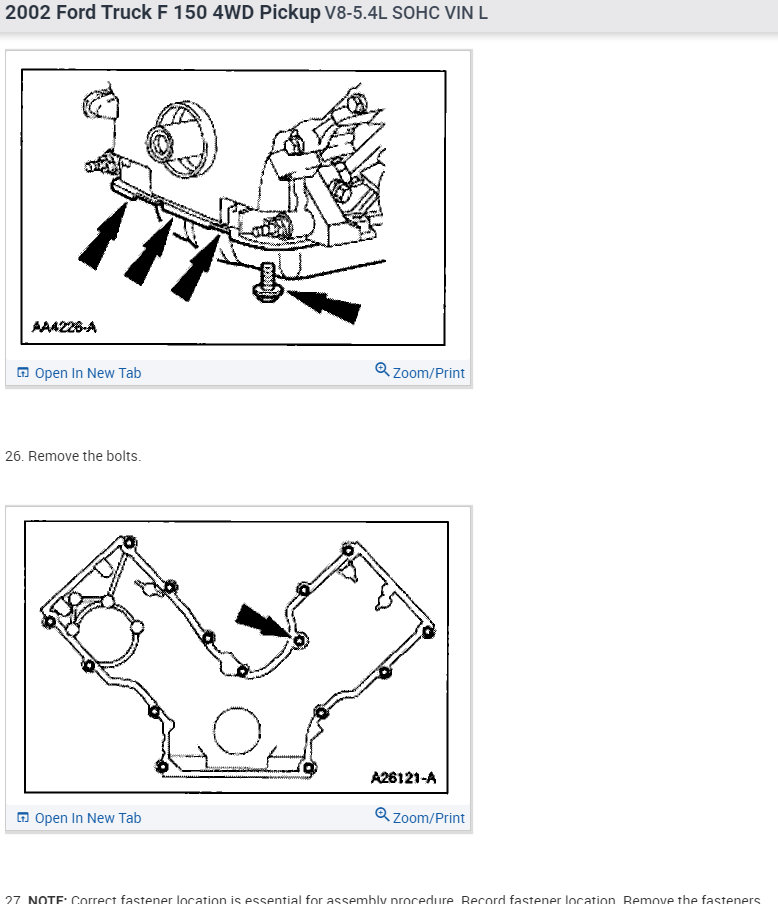

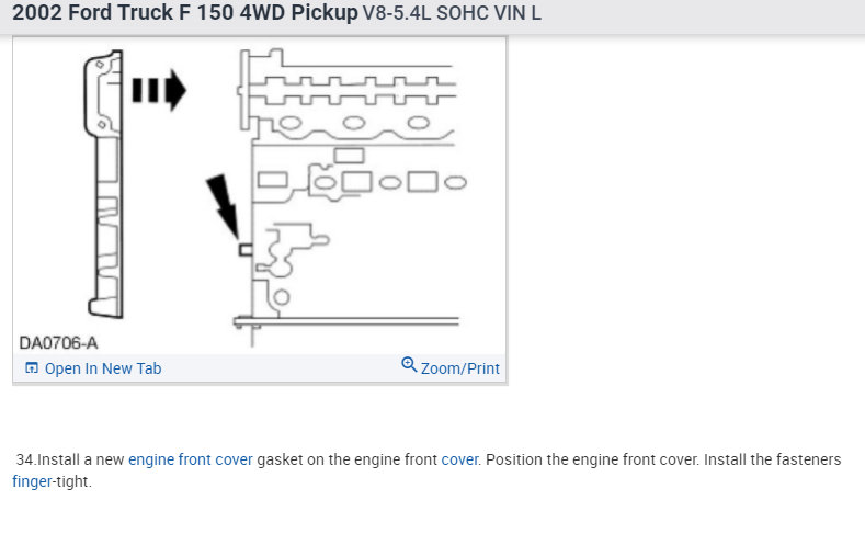

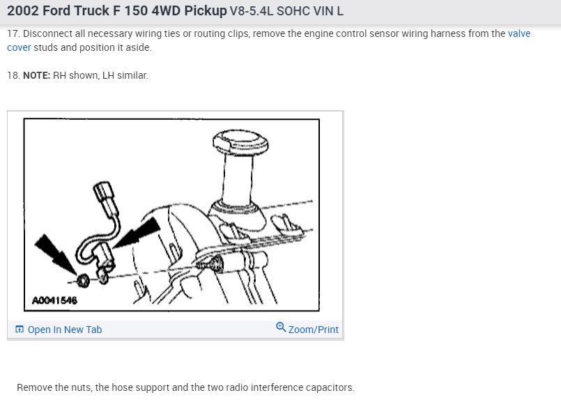

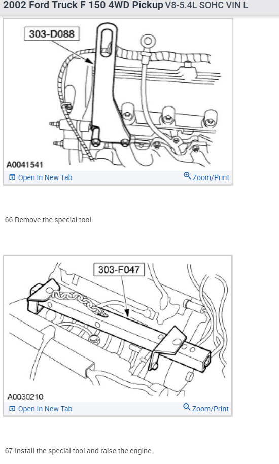

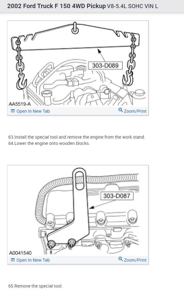

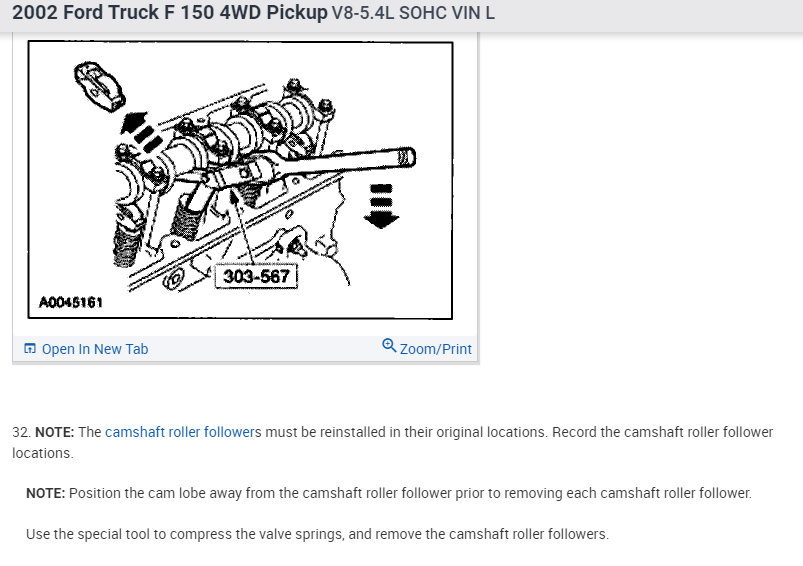

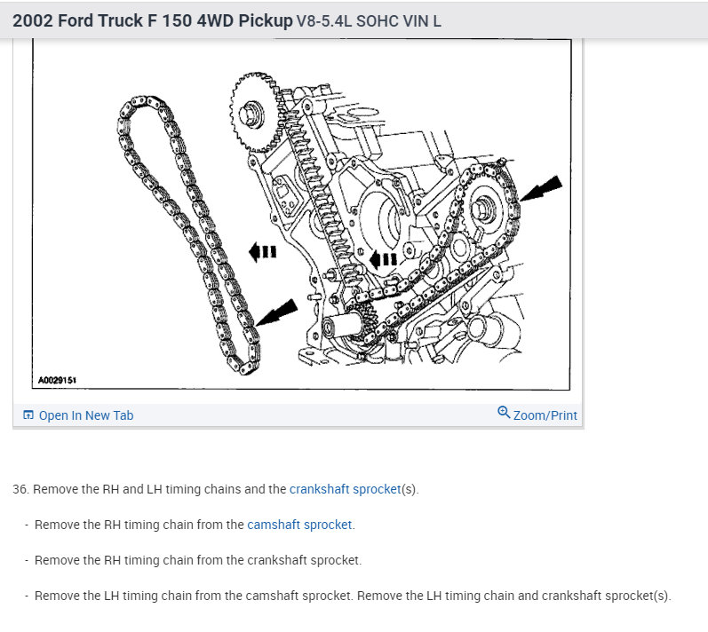

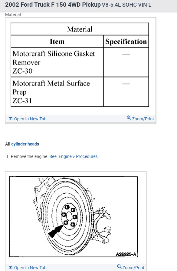

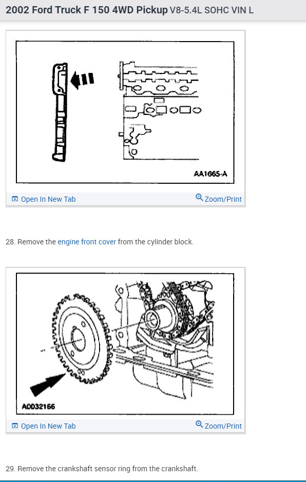

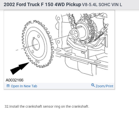

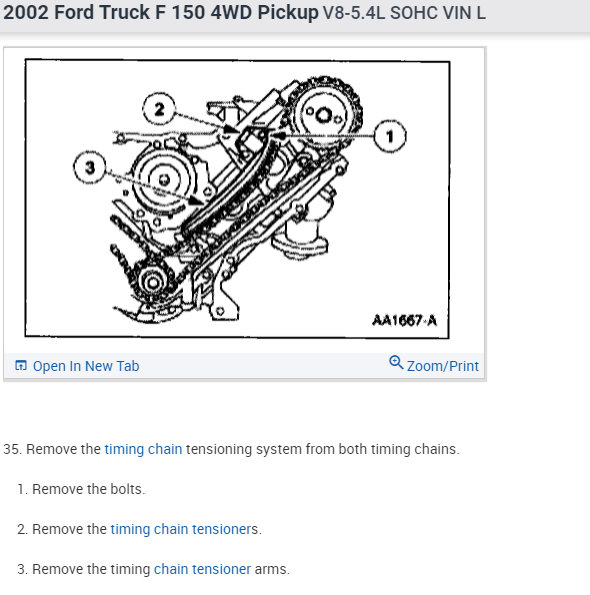

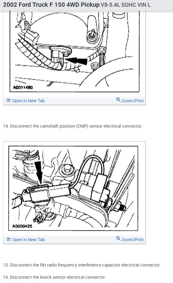

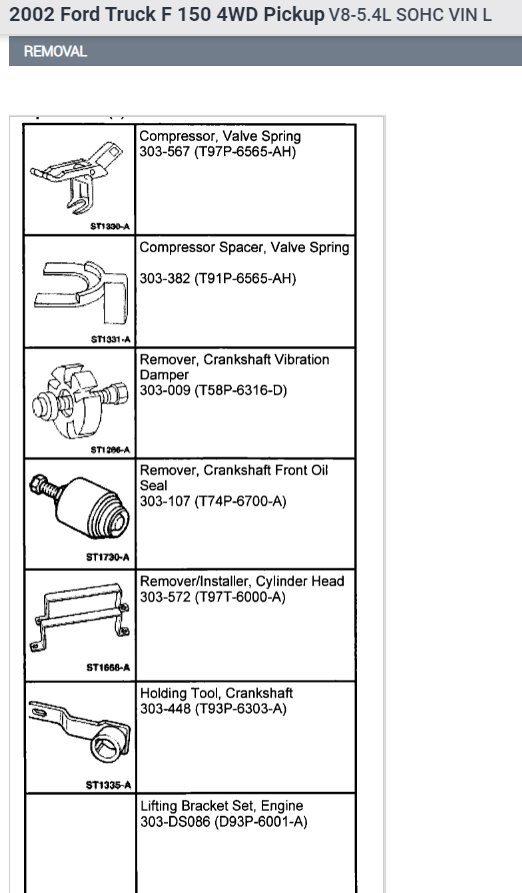

Hey guys, I'm on for a big job. This vehicle belongs to me, bought it with a blown head. Well, I've never done a v8 Ford f150. If possible, would you guys happen to have a step by step on this motor? If not that's fine but rather use your steps to reflect on this project. Thank you, gentlemen,
By the way it came out of shop confirmed blown head. I checked the coolant reservoir and it got mixed oil and coolant. Dirty. I'm also just going to change out the water pump radiator and thermostats while I'm in the motor. Note: I will not be removing motor from truck. I will also have the heads shaved once I get it out
This is going to be one of my biggest accomplishments by far if I get this right. Thanks to 2CarPros.

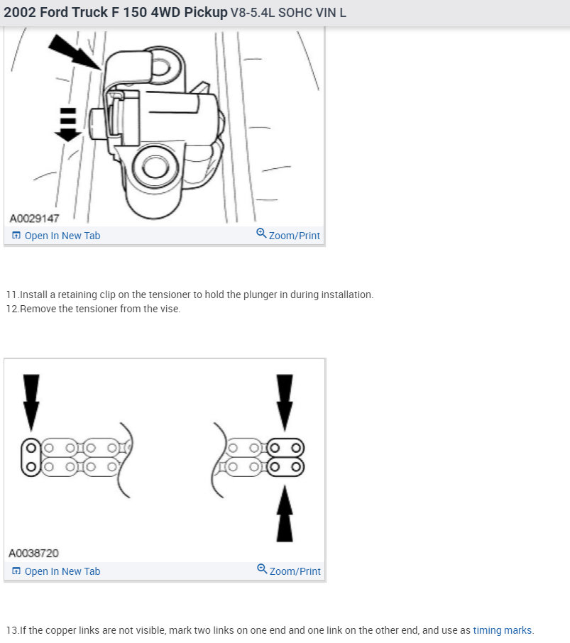

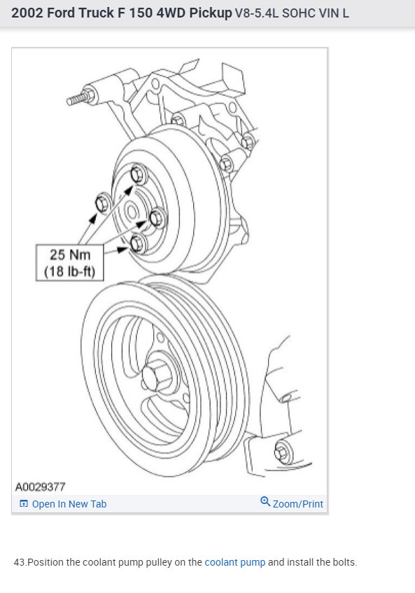

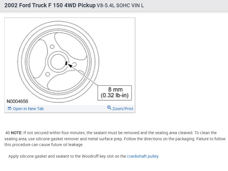

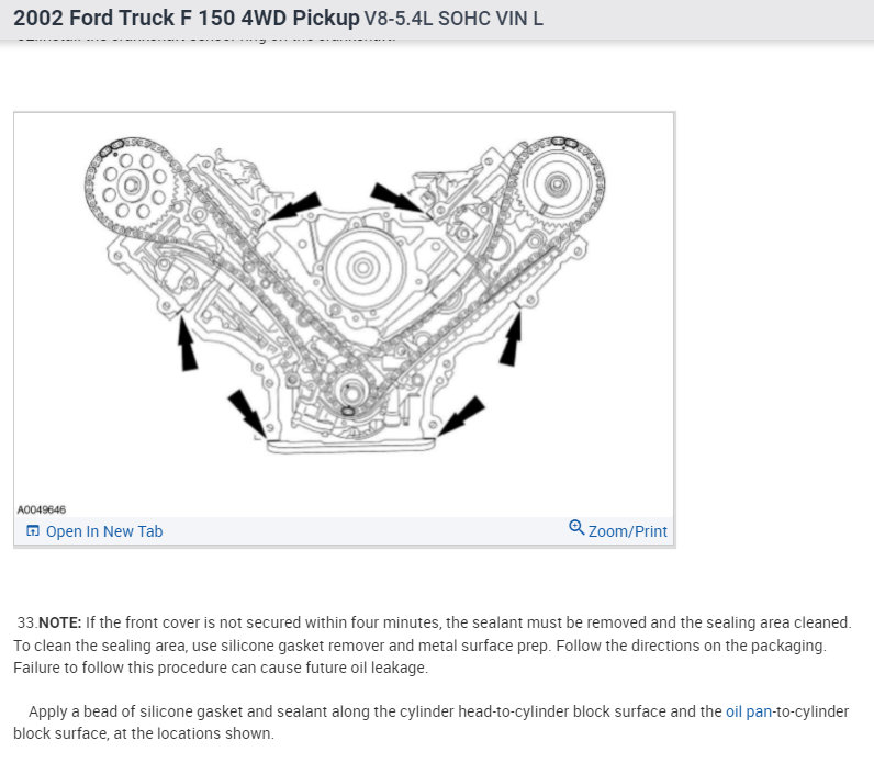

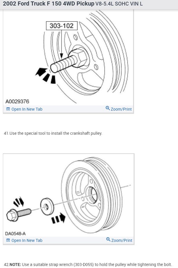

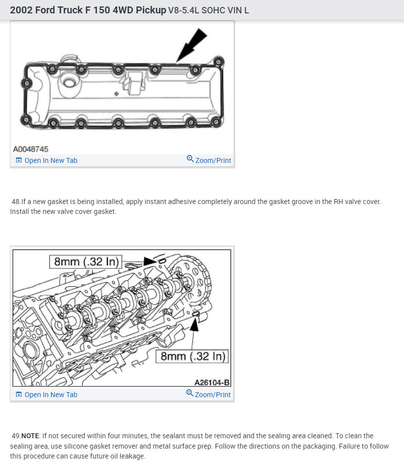

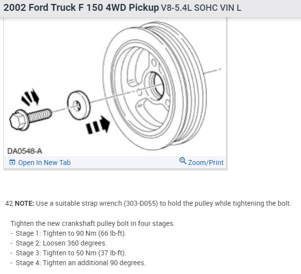

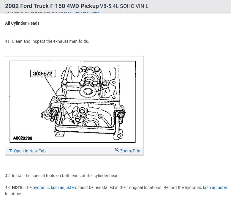

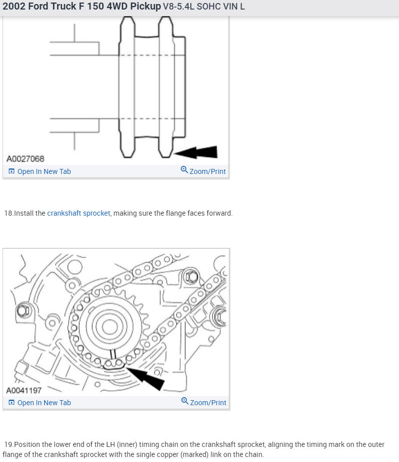

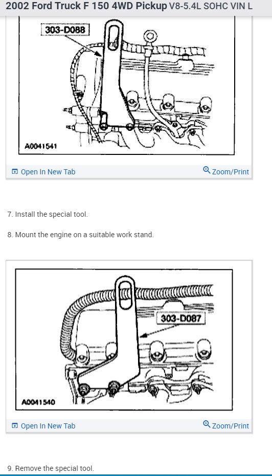

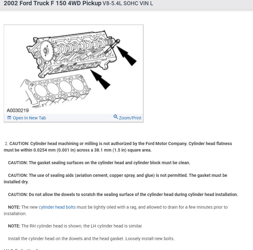

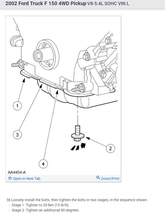

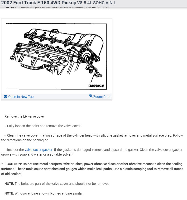

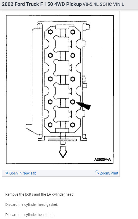

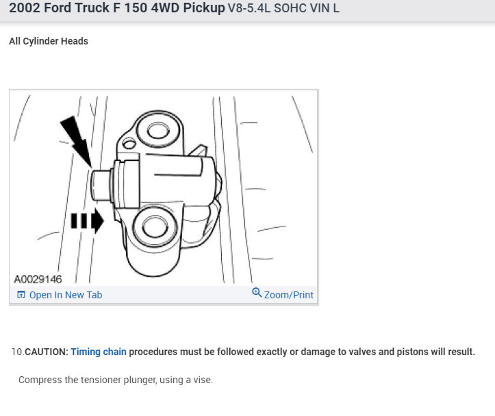

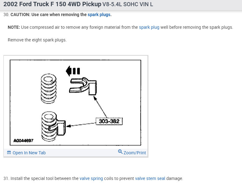

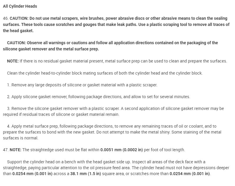

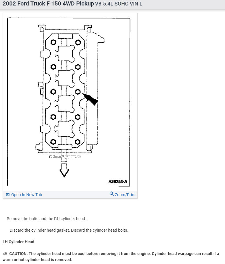

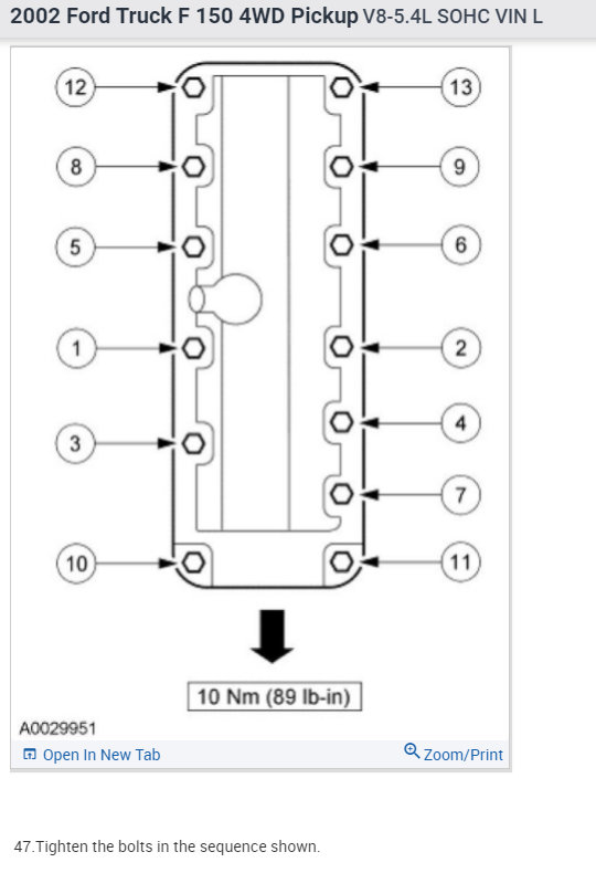

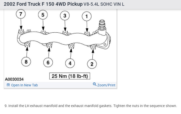

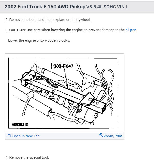

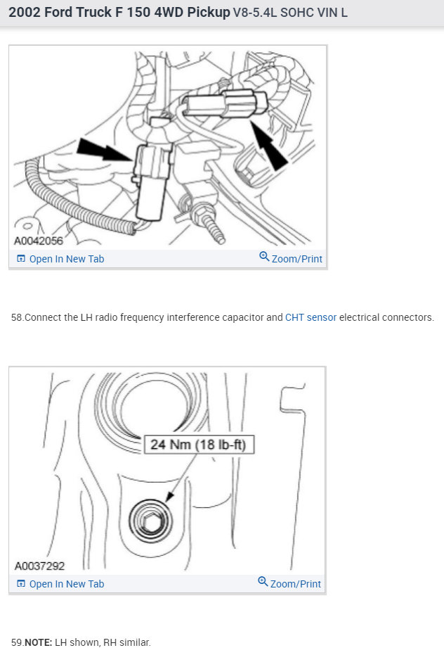

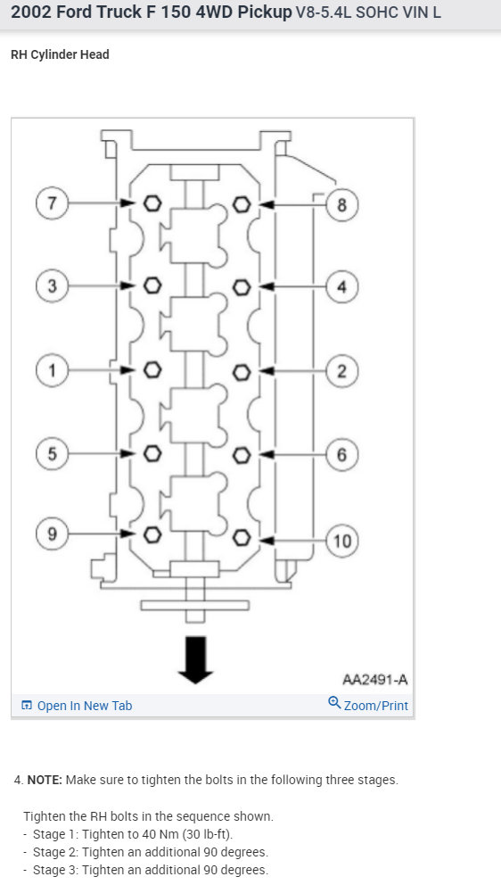

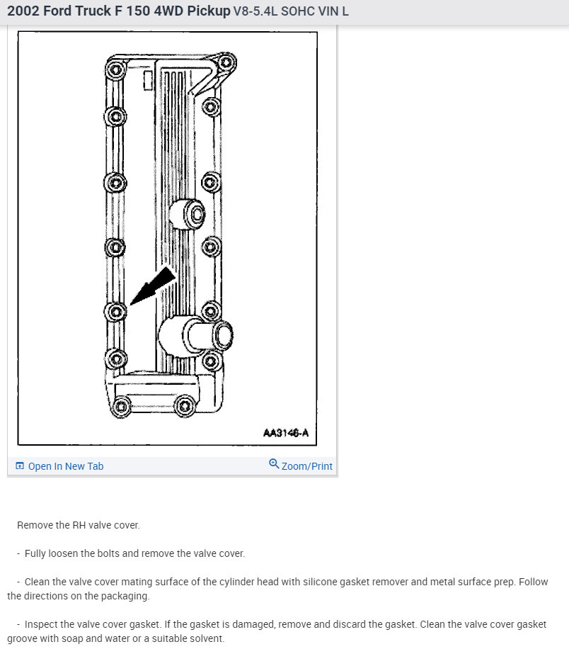

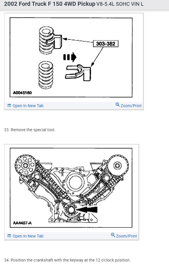

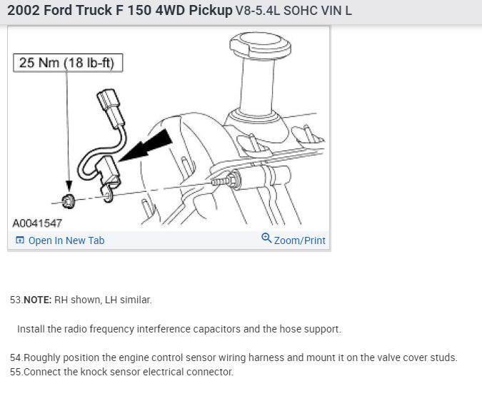

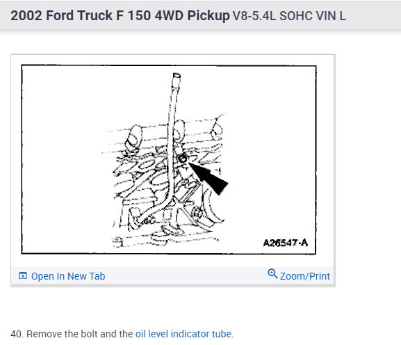

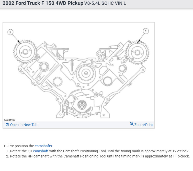

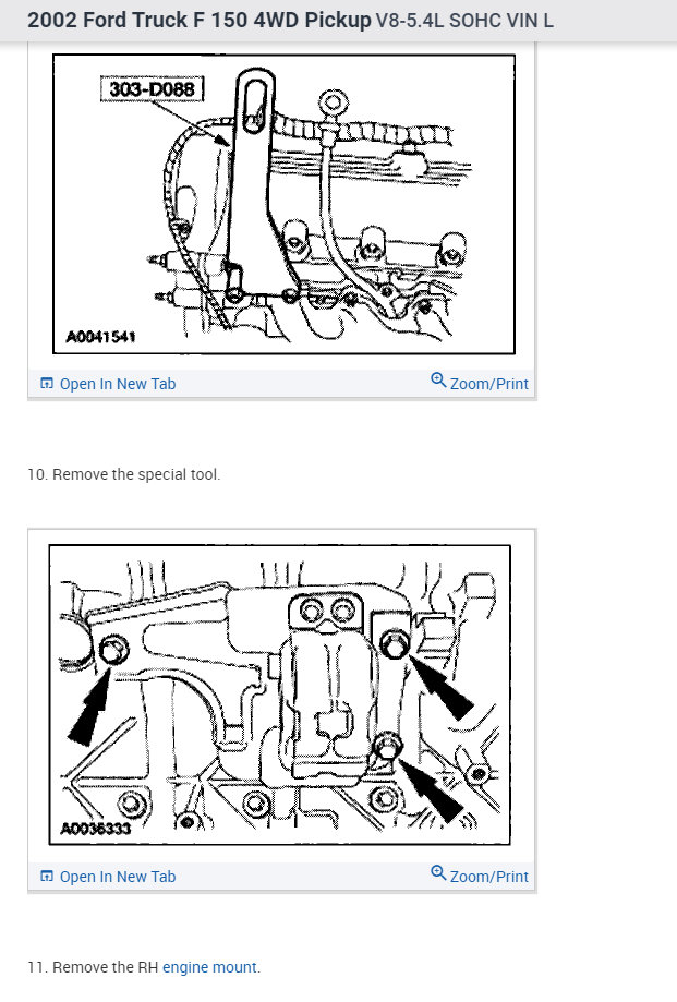

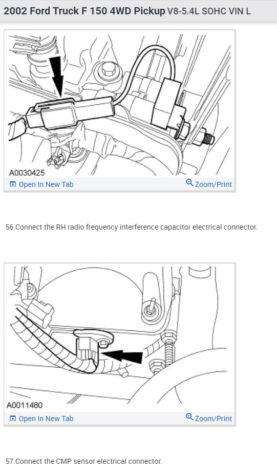

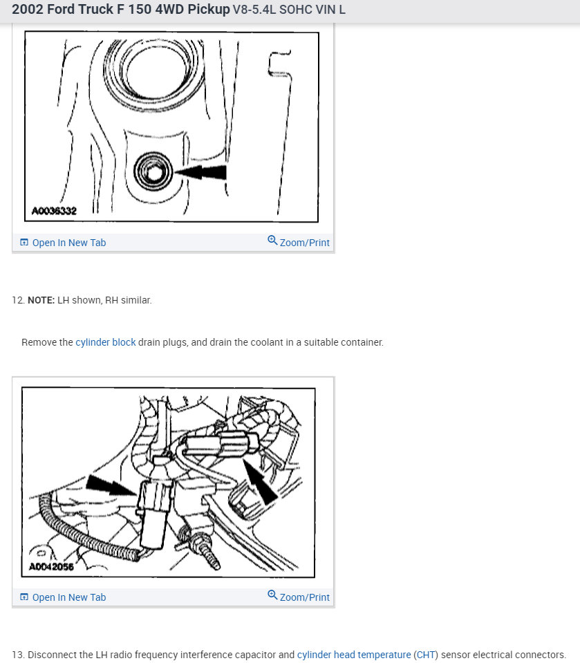

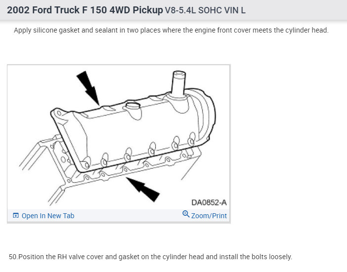

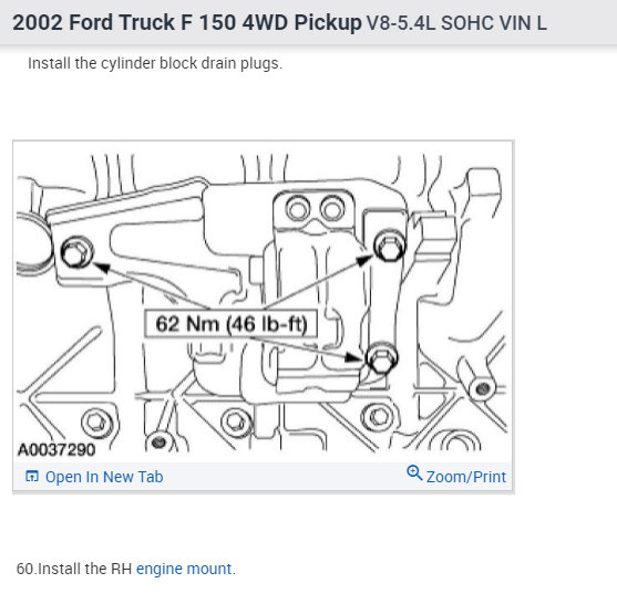

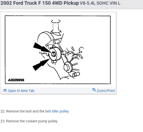

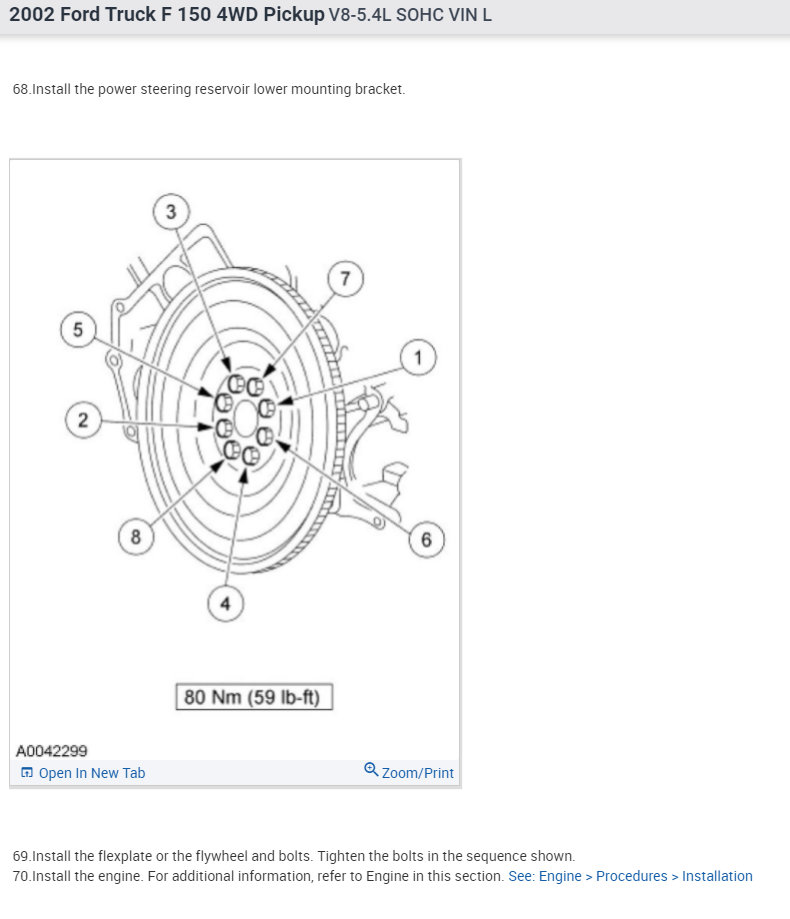

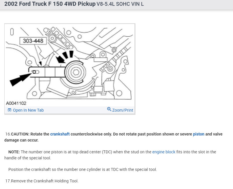

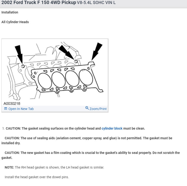

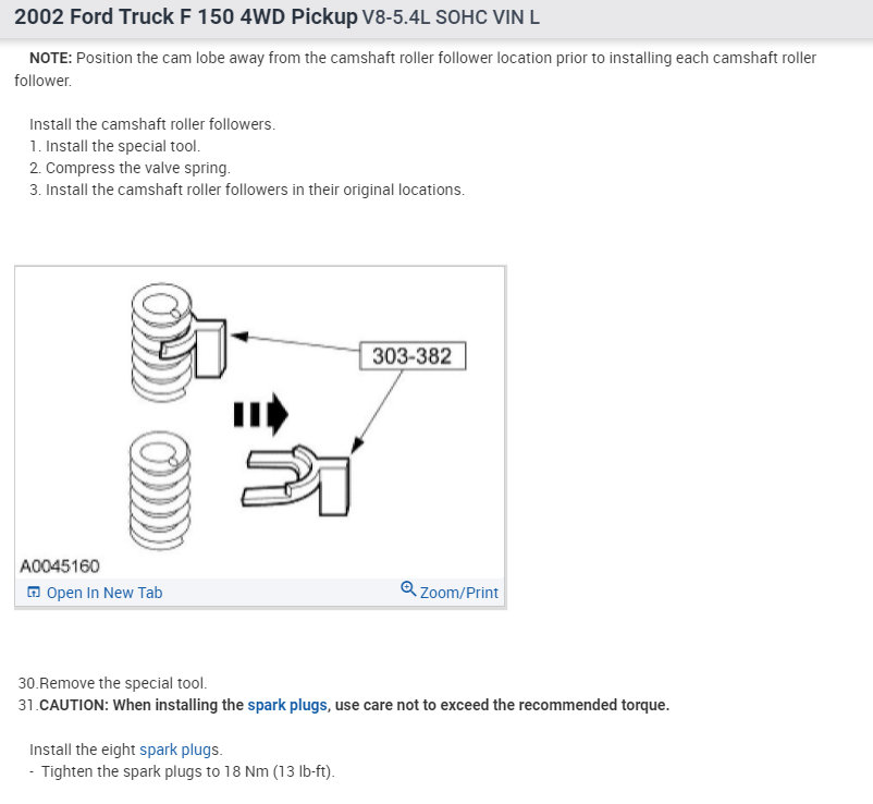

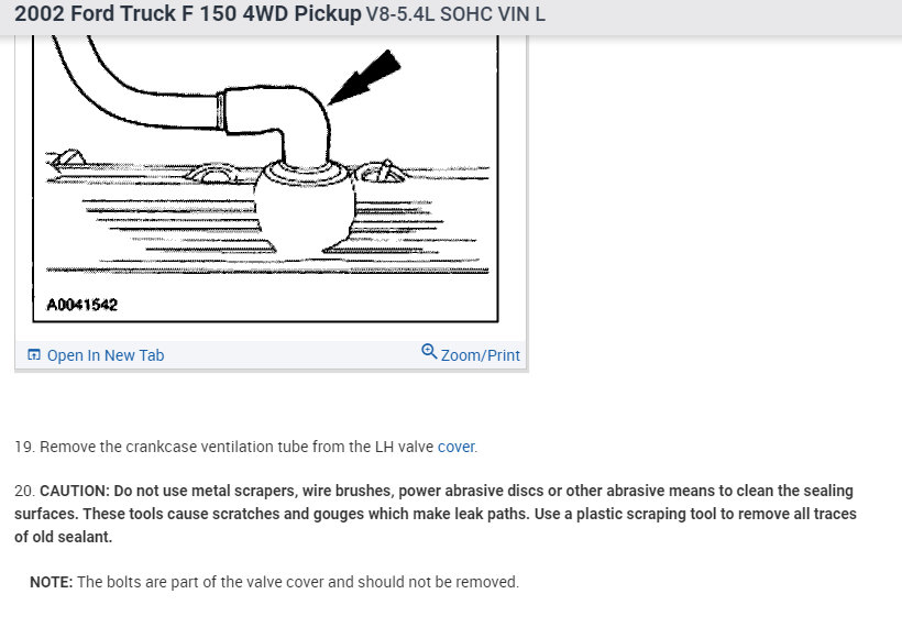

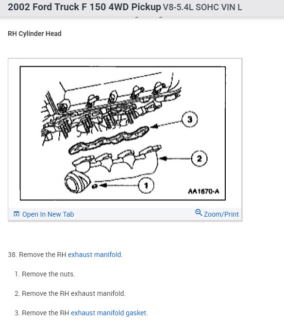

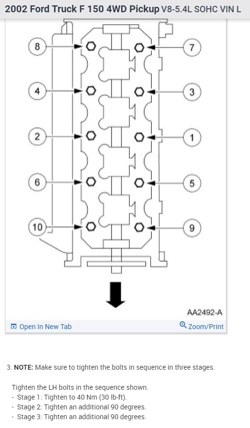

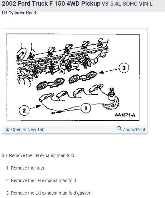

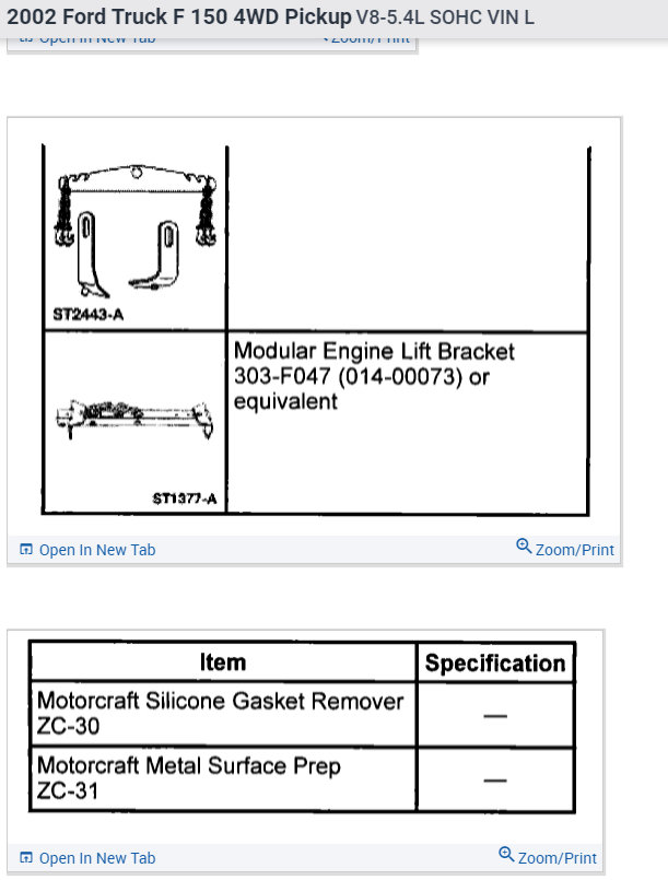

On this vehicle the book does call for the engine to be removed before removal of the cylinder heads. Might have clearance issue on the back.

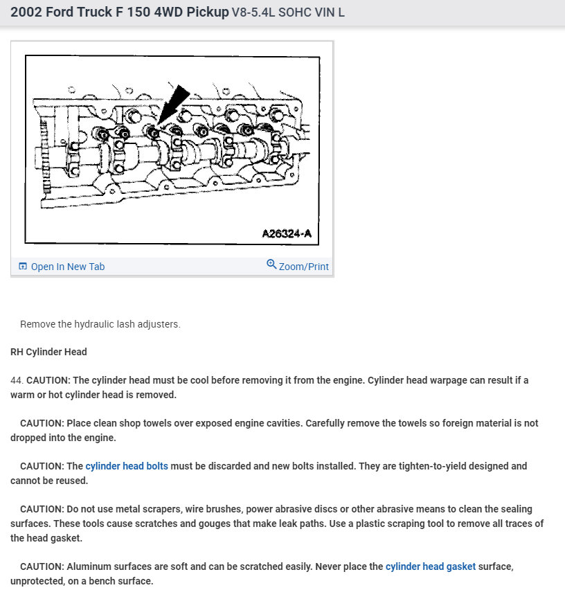

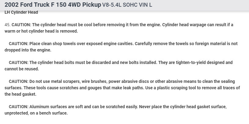

Also be sure to use new head bolts during the installation.

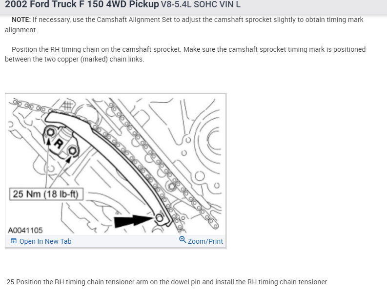

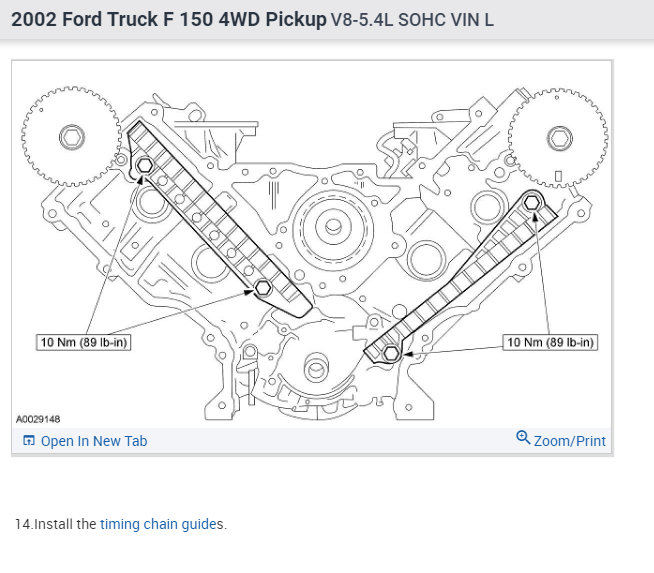

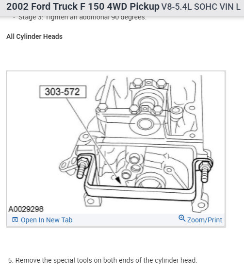

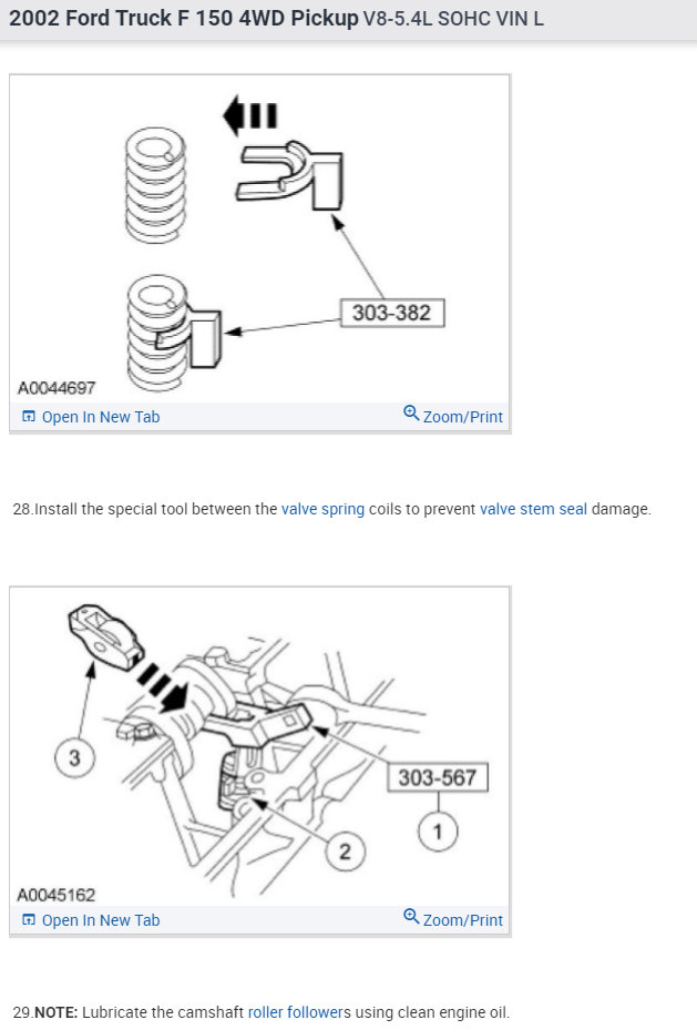

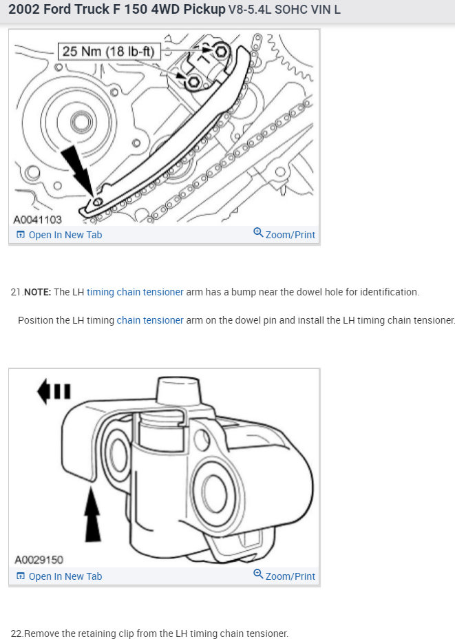

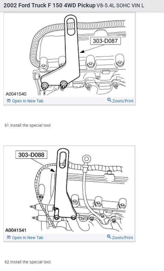

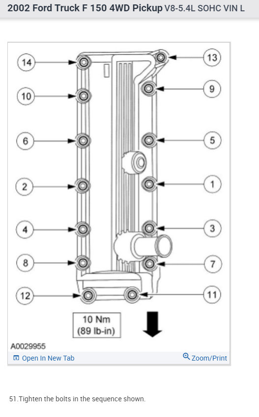

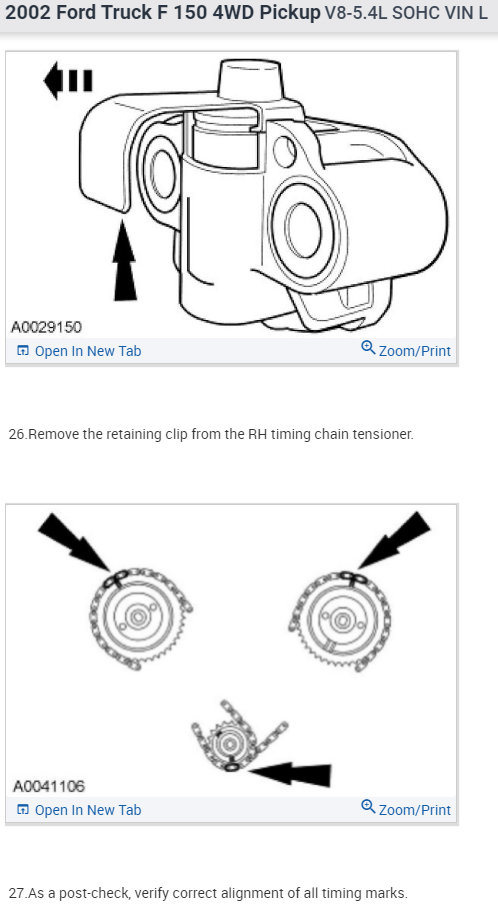

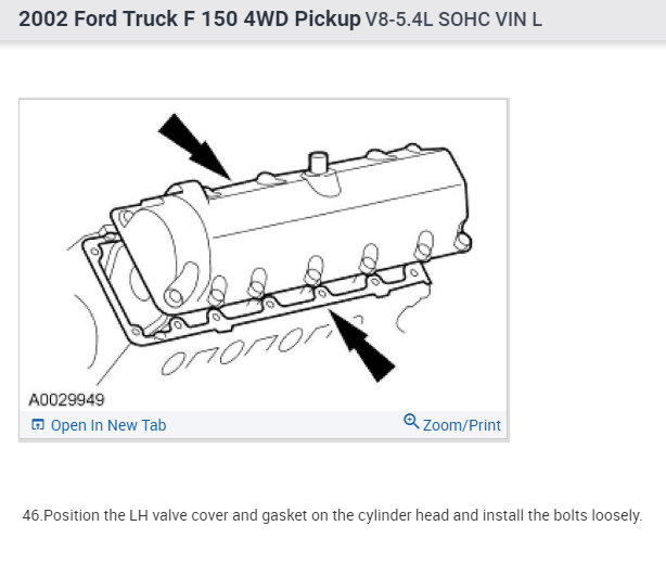

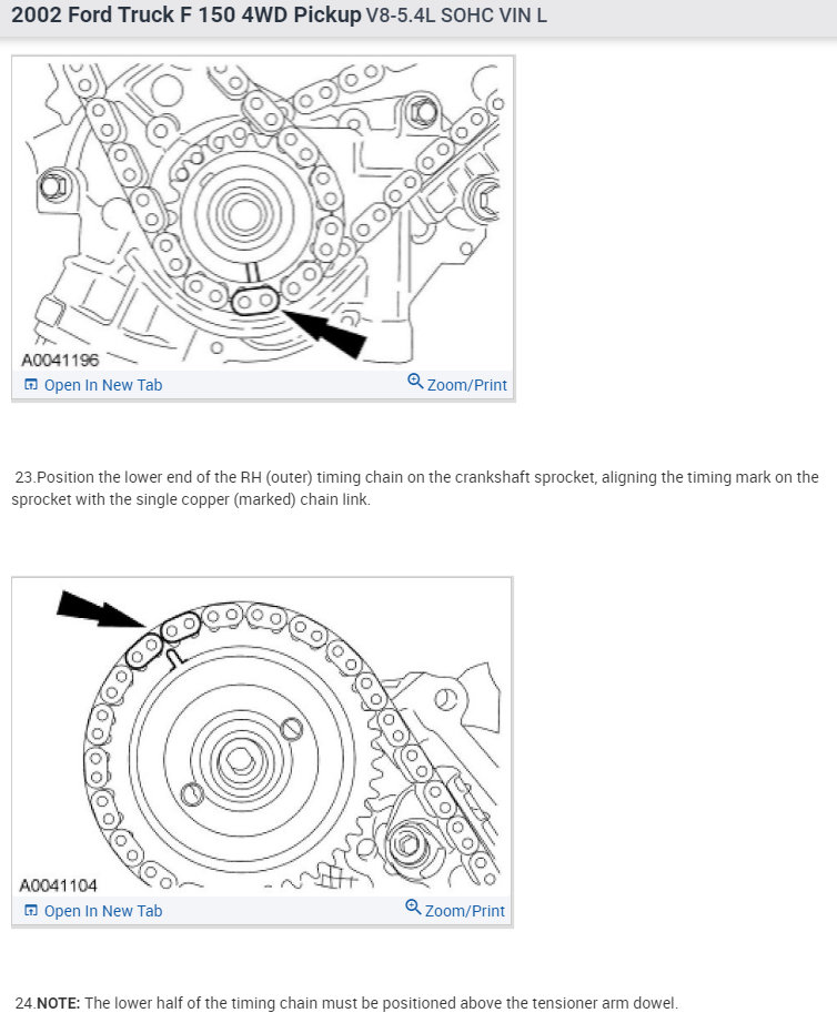

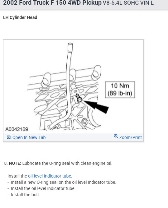

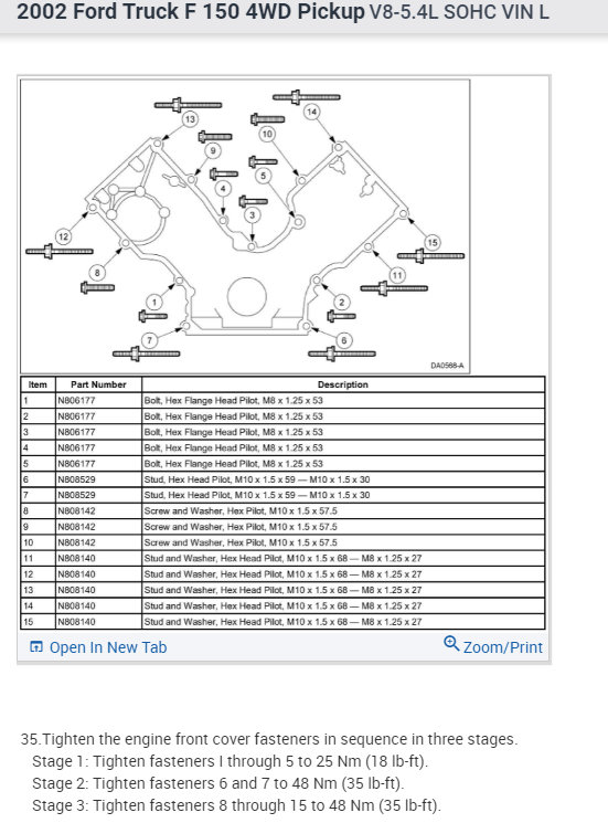

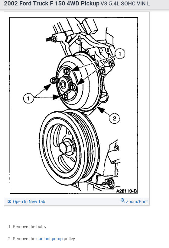

I have attached the complete replacement procedure below. Including all the torque specifications and the sequences.
Jan 11, 2022 at 3:04 PM
TOYPACIFIC
  • 159 POSTS
oh yes, i just noticed the clearance is very tight., plus i think it's going to be way easier working with the engine out anyway. Thank you for this step-by-step procedure. I will follow up once through with it..
