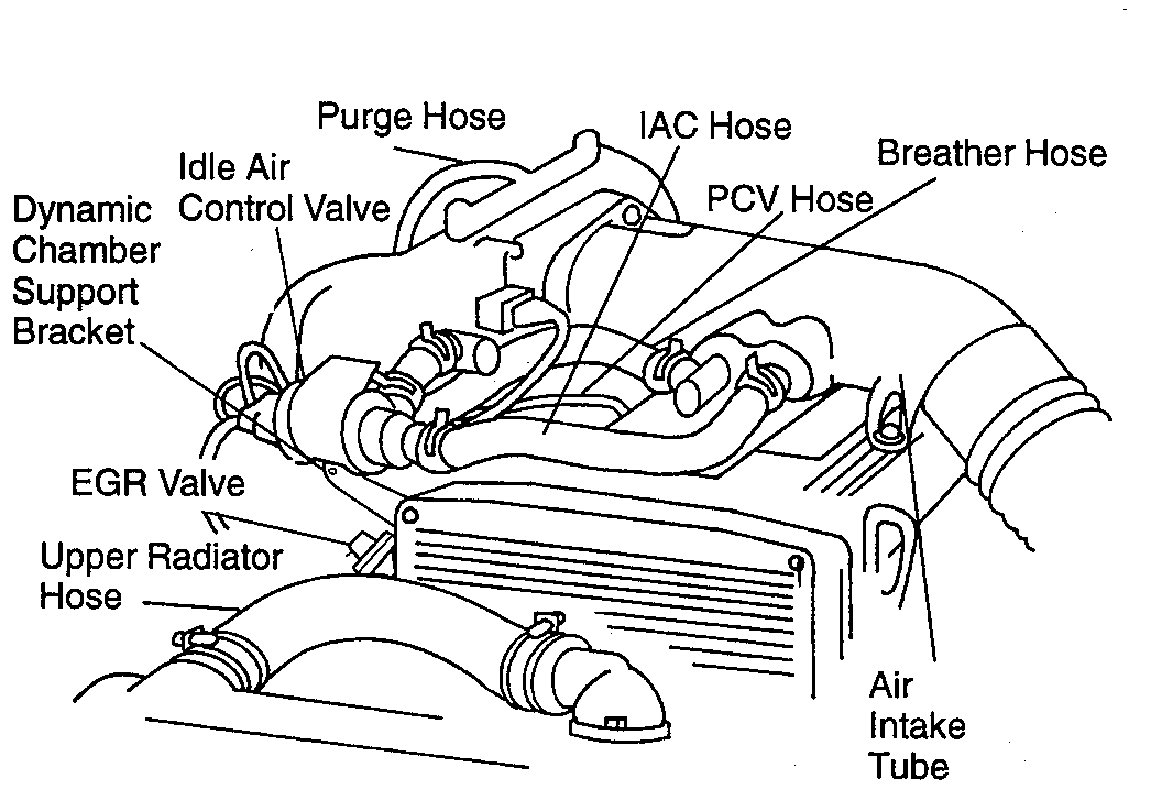

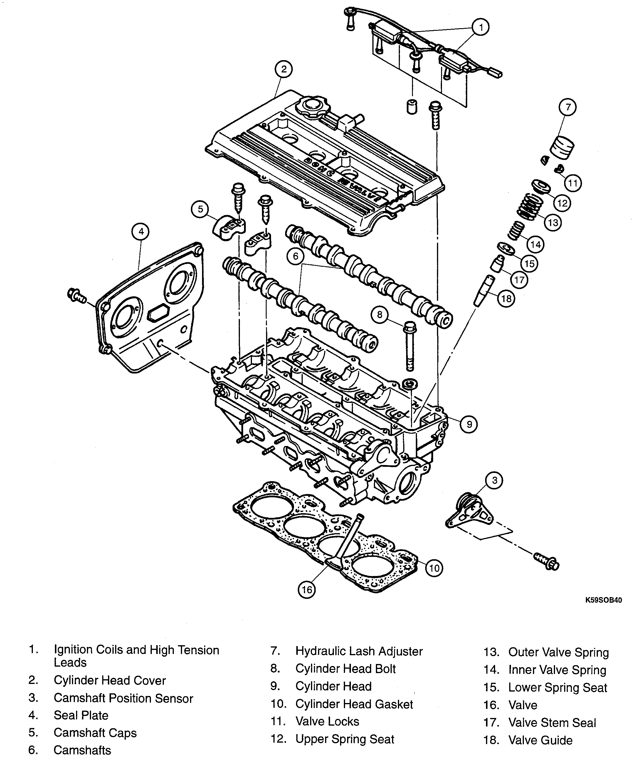

Here are the directions for replacing the head gasket. All attached pictures correlate with these directions.
_______________________
REMOVAL
1. Disconnect the negative battery cable.
2. Remove the cylinder head cover.
3. Remove the timing belt.

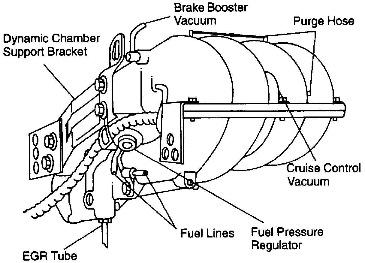

4. Remove the EGR solenoid connector located at the front of the dynamic chamber.
Fig. 4 Brake Booster Replacement
5. Remove the brake booster vacuum hose from the dynamic chamber.
6. Remove the fuel line from the pressure regulator and the return line located at the rear of the dynamic chamber.

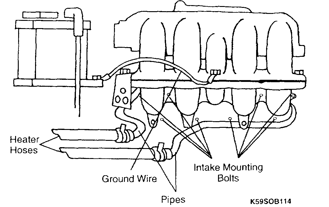

7. Remove the cruise control vacuum hose from the intake manifold.
8. Remove the engine-to-body ground wire from the intake manifold and the harness bracket below it.

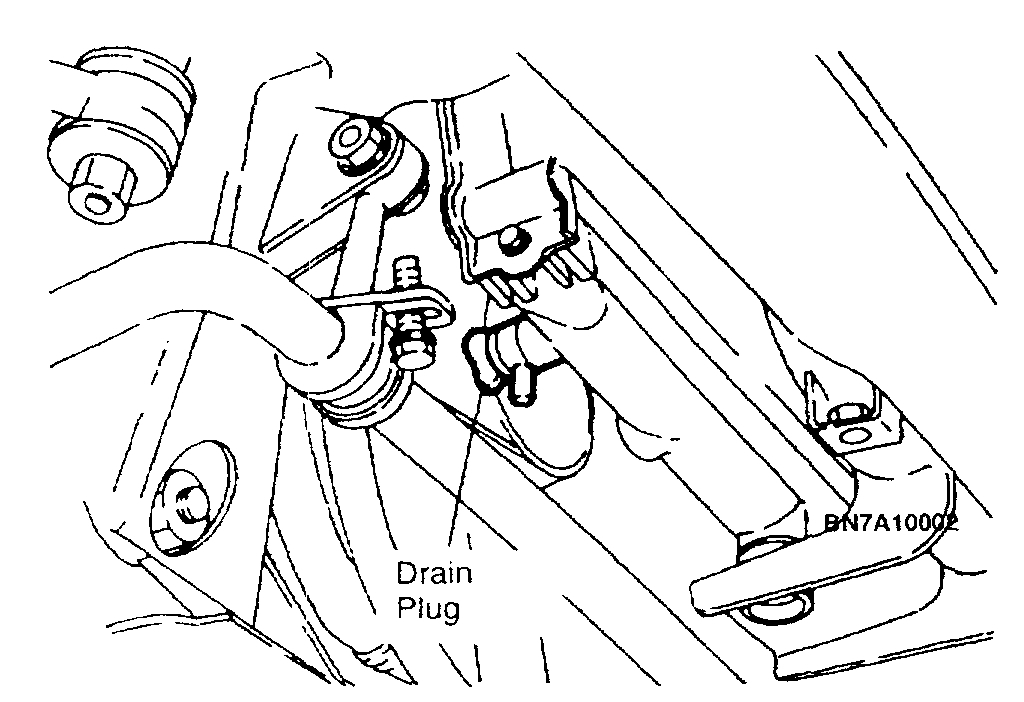

9. Remove the radiator cap.
10. Remove the radiator drain plug and drain the engine coolant into a suitable container.
11. Tighten the radiator drain plug.
12. Remove the vacuum line from the bottom of the EGR valve.
13. Remove the purge solenoid valve vacuum hose from the dynamic chamber.
14. Loosen the two clamps and disconnect the upper radiator hose.
15. Remove the three intake manifold support bracket bolts and bracket.

17. Remove the ten cylinder head bolts and carefully lift the cylinder head off the cylinder block with the intake and the exhaust manifolds attached.
18. Disconnect the three wire harness connectors on the back of the cylinder head and remove the cylinder head assembly from the vehicle.

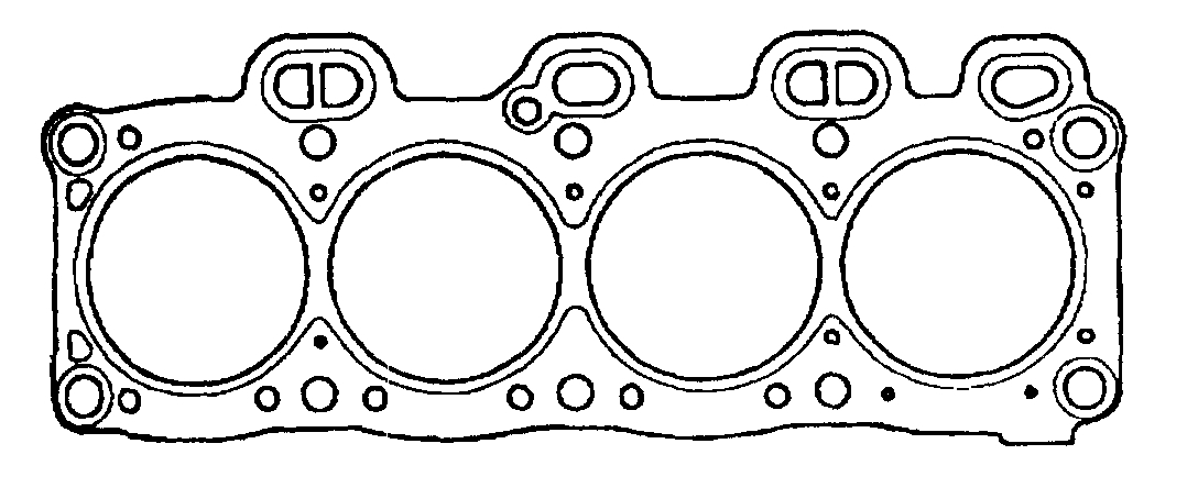

1. Place the new cylinder head gasket in position.

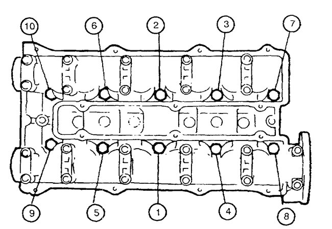

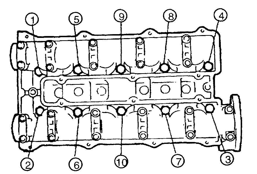

4. Install the ten cylinder head bolts.
Cylinder Head Bolt Tightening Sequence
5. Tighten the cylinder head bolts to specification. Follow the pattern shown, and tighten in 3 equal steps to 50-64 ft. lbs. (80-87 Nm).

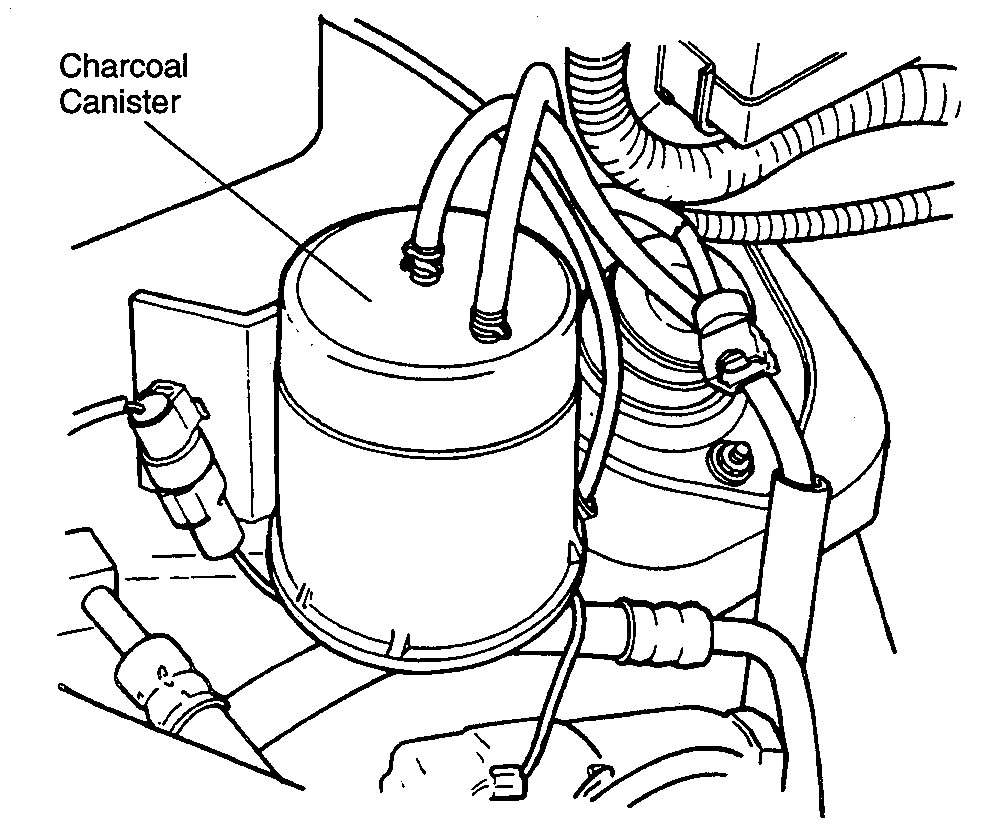

11. Install the vacuum hose from the intake manifold to the charcoal canister.
