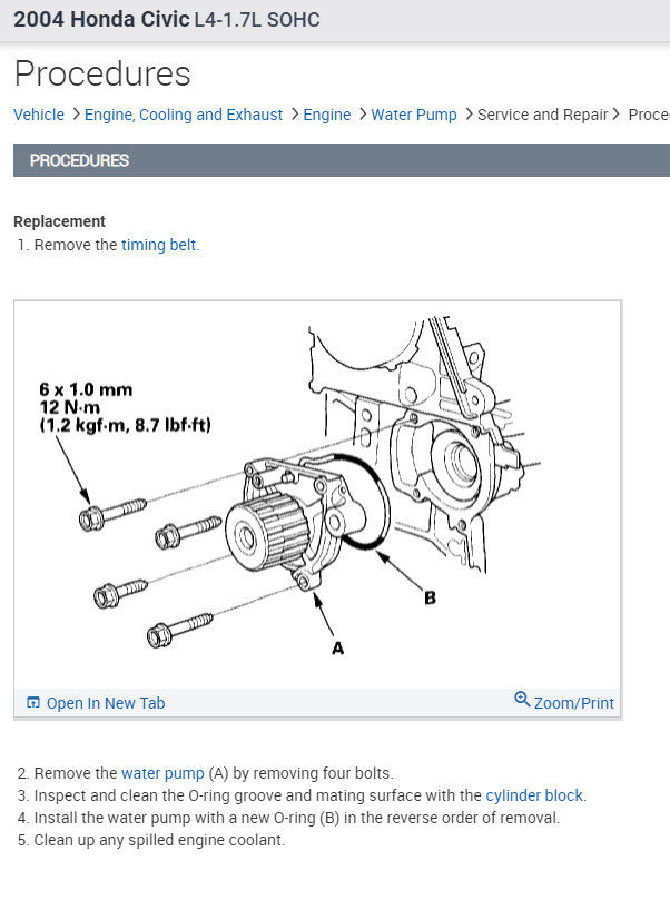

There is a leak under the water pump could it be from the head gasket or water pump?
2004 HONDA CIVIC
167,000 MILES
NETDALE
I have a leak under the water pump. Previously the engine overhand we had to replace the radiator.
The garage said that the head gasket was bad after they did a pressure test. Not sure if they noticed the leak. The car runs fine. No water in the oil. Leak under pump is minor. The level in radiator maintains level.

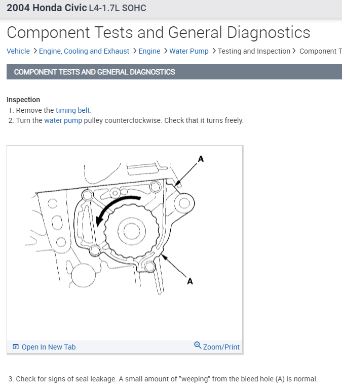

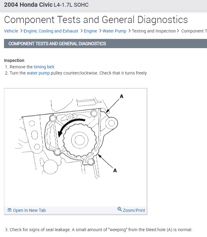

So, are you able to see where the leak is coming from? You want to make sure it is the water pump before replacement.
It is interesting that they did not mention the leak.
Keep in mind that on this vehicle the timing belt needs to be removed to replace the water pump.
