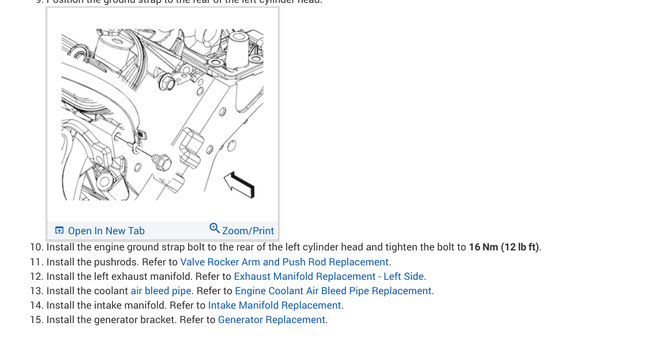

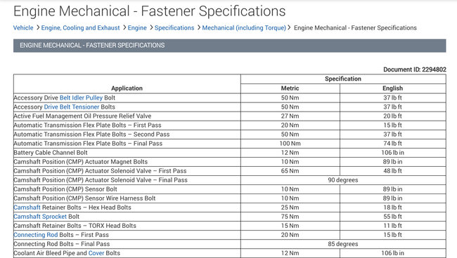

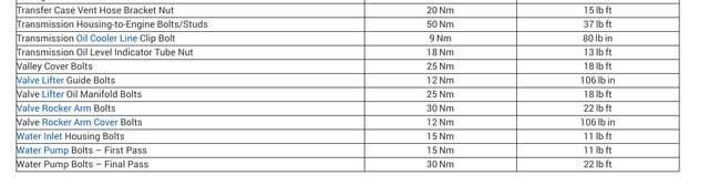

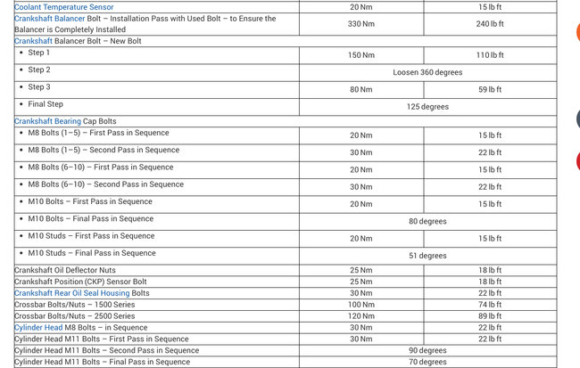

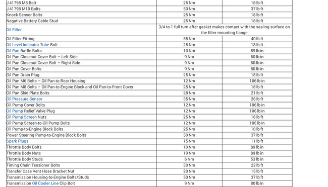

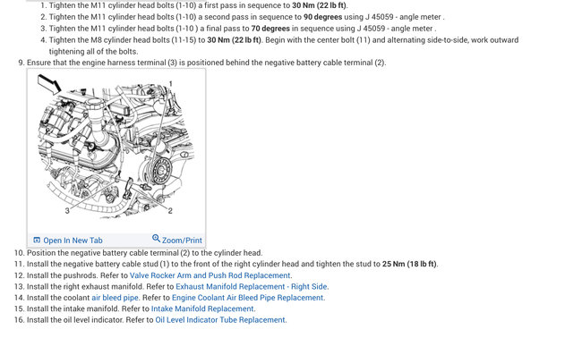

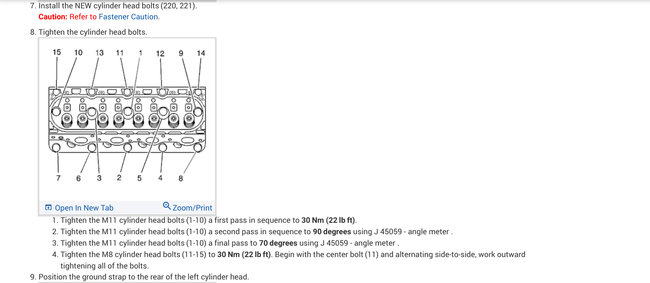

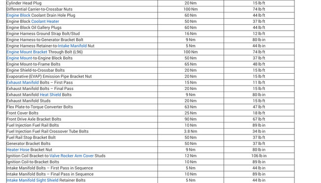

Hello, i need the diagram for the head gasket. Need to know how to tighten head bolt and torque spec 5.3 2012 Sierra silverado.
The lbs and degrees.
Jan 31, 2020 at 6:58 AM
SCGRANTURISMO
  • 4,897 POSTS
In the diagrams down below I have included the fastener specs for your vehicle's entire engine assembly. Please get back to us with how everything turns out, and I hope that this helps.
Thanks,
Alex
2CarPros
Jan 31, 2020 at 8:01 AM

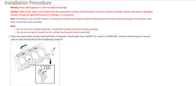

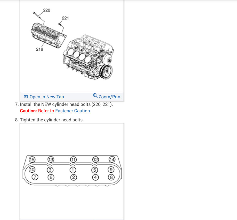

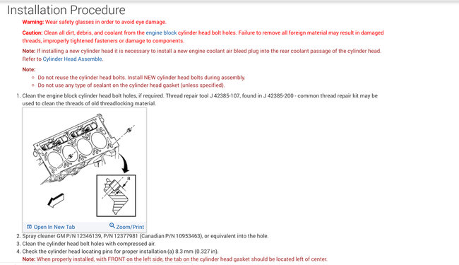

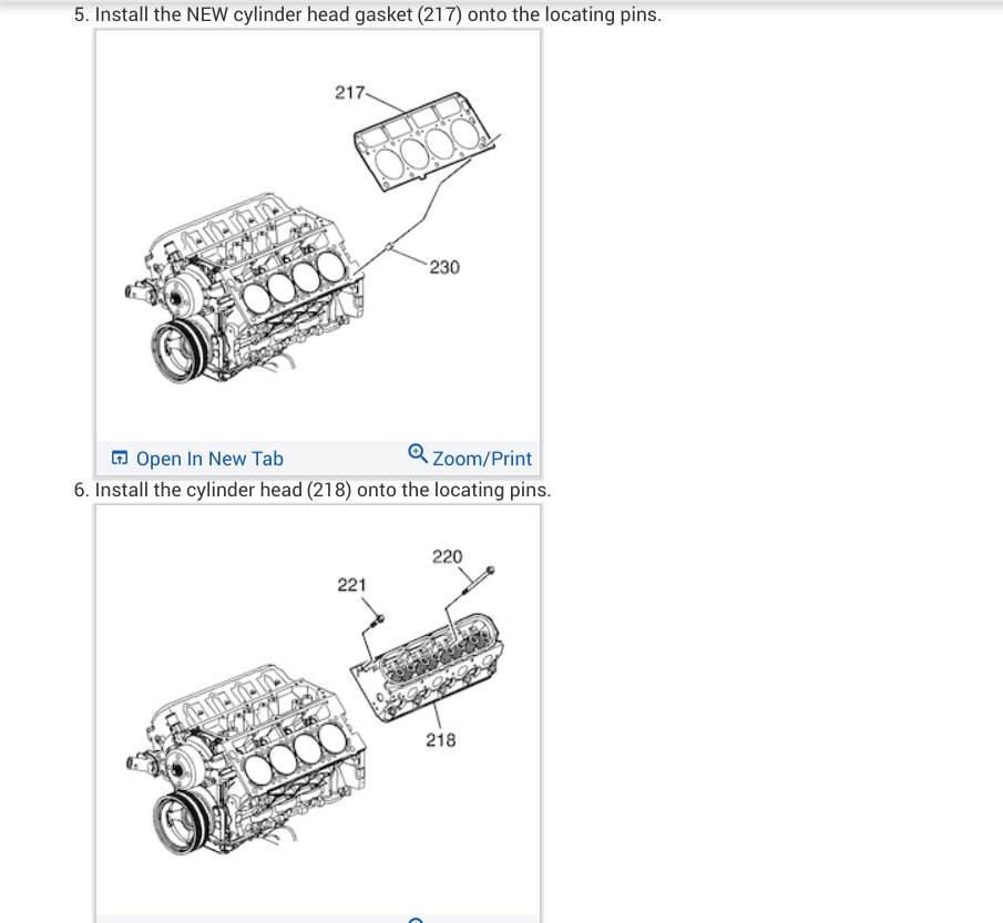

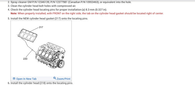

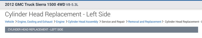

Do you have the diagram for the head gasket mounting?
Jan 31, 2020 at 9:56 AM
SCGRANTURISMO
  • 4,897 POSTS
Hello again,
I have included the instructions for the installation of both the left and right head gaskets on your vehicle in the diagrams down below. I hope that this helps. Please let us know how everything turns out.
Thanks,
Alex
2CarPros
