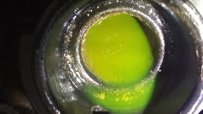

What is that cream color stuff?

By the way, a creamy substance in the coolant usually indicates there is oil mixing with it. That, in turn, usually indicates a bad head gasket. Make sure the motor oil is not contaminated.

Did you see the picture? I started it up some smoke then tried it a little and there was more smoke. Two days ago the radiator leaked out side tank.

I did see the picture of the coolant/creamy substance. Usually, when the two mix, it becomes a light tan color substance. Is the smoke from the exhaust? Is it white? Have you tried the tests in the link I attached?

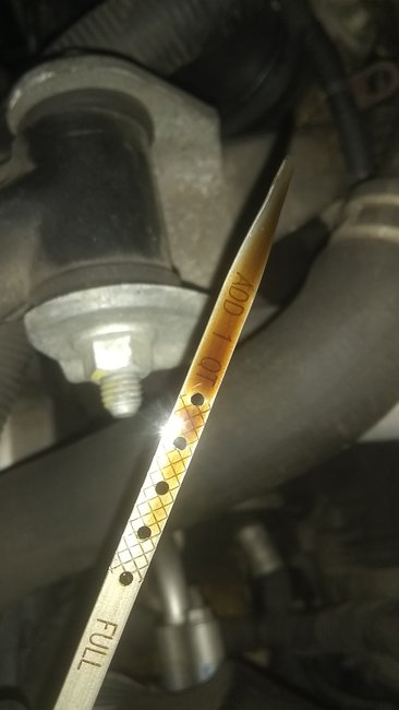

Oil on dipstick looks normal to me.
Sep 20, 2018 at 1:28 AM
  • 110,244 POSTS
The oil looks fine. The exhaust does not seem out of the ordinary, either. You could be getting oil into the cooling regardless. Did you check for air bubbles in the coolant when the engine was running?
