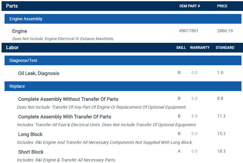

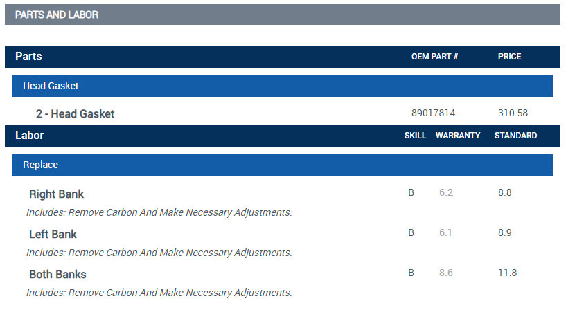

Is it a better idea to pull and swap out my engine with a used engine and cost wise save me time and money to swap engines than to replace and spend the time and money in tearing down and replacing the gasket? A friend suggested a engine swap instead instead snd for about $500.00 I can get a used motor to swap out the one with blown head gasket. What’s my best option that’s cheaper and time and labor saver for me?
Jun 20, 2021 at 11:44 PM
JOECALL
  • 6 POSTS
Hi Dillon,
I have attached the labor times for the engine replacement (11-15 hours) and the head gasket replacement (9-12 hours). If you can find a low mileage engine then it may be beneficial to replace the entire engine. If your replacement engine is 130,000 miles or higher i would consider repairing the engine you have. The higher mileage engine might require replacement gaskets much sooner than you would like. I personally would repair the engine I have so I know the age and condition of the head and intake gaskets.
