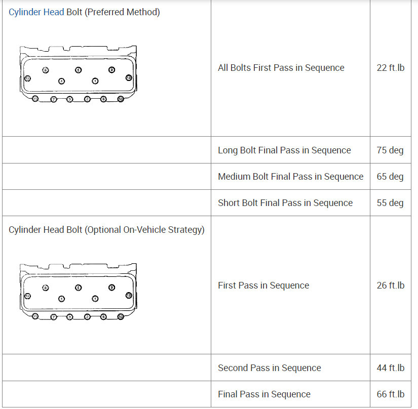

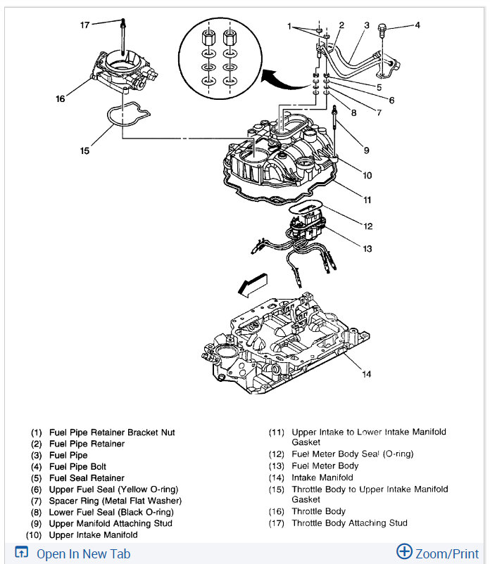

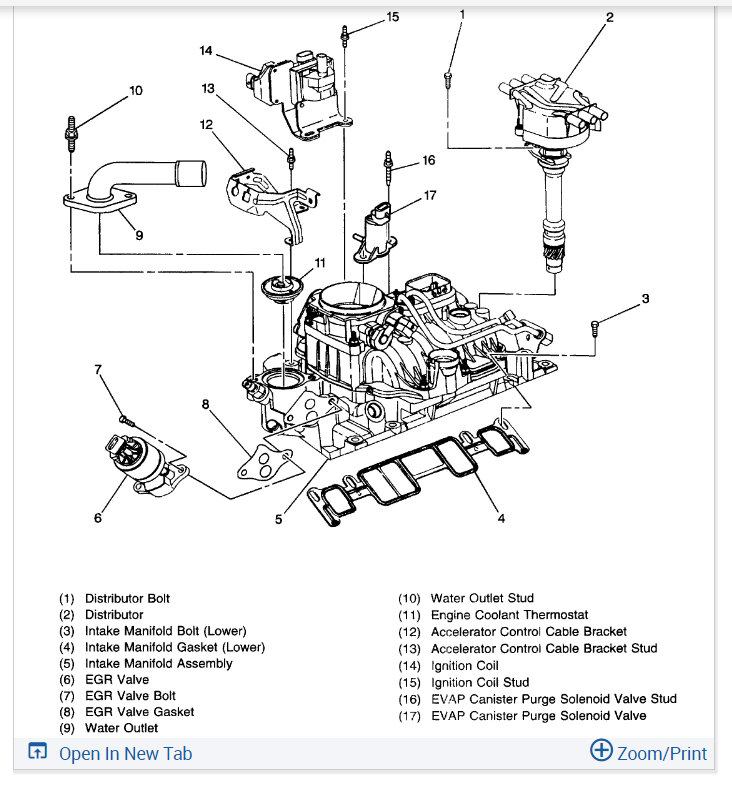

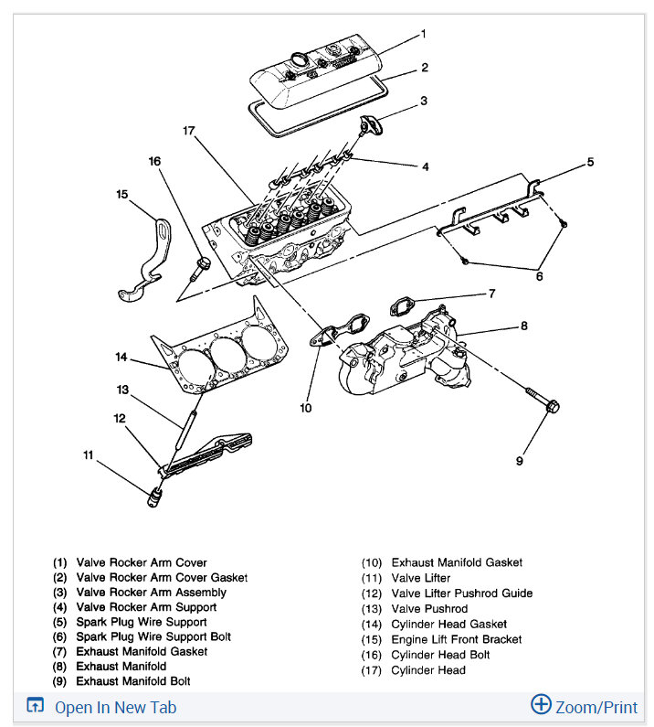

If you want to replace the head gaskets, I have included how to do the job with torque specs in the images below. Also, this guide may help as well:
