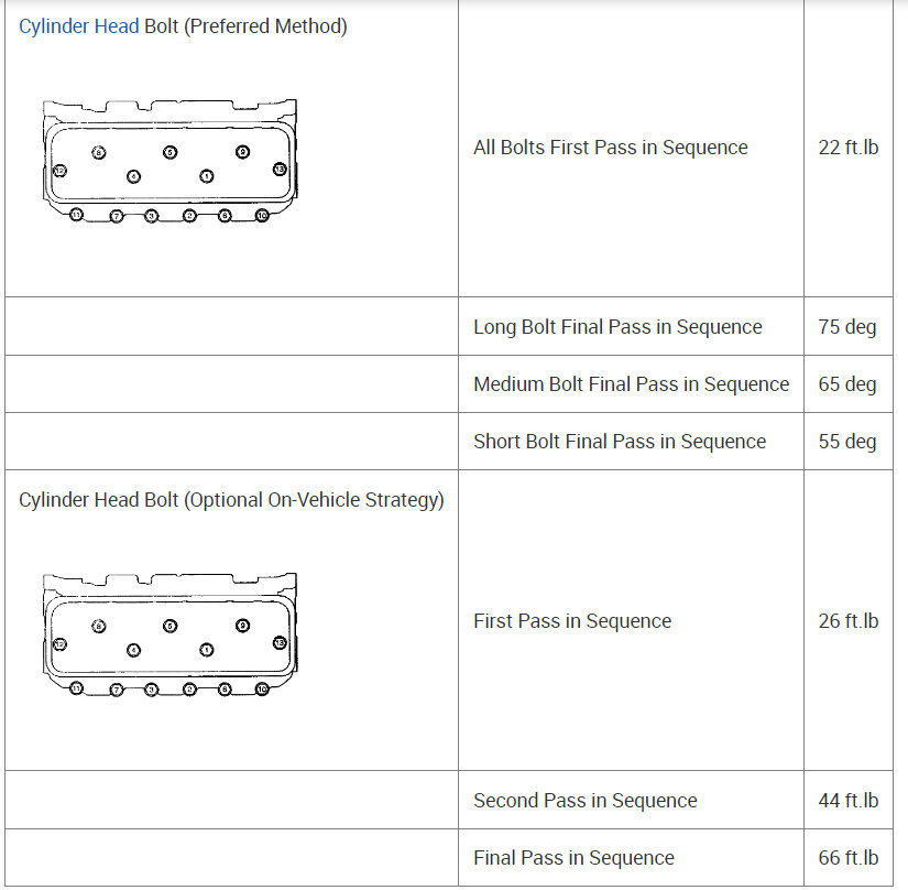

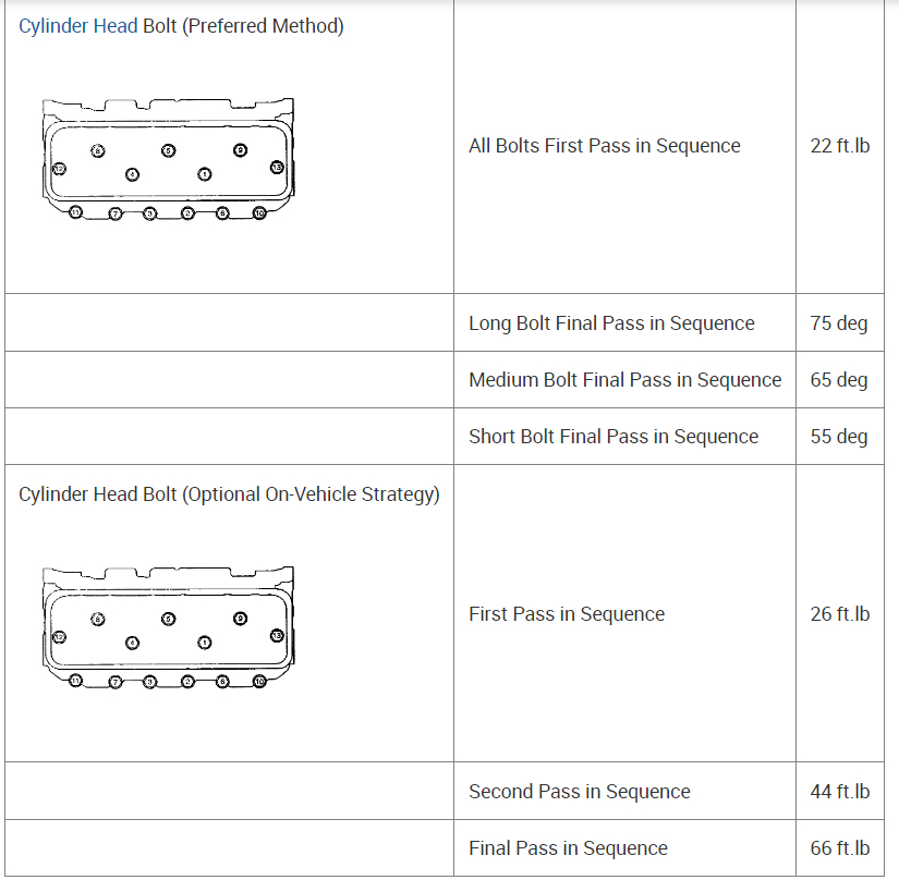

I have seen people use "blue devil" which seems to help in most cases, please go over this video to show you how:
https://youtu.be/Xi41RFMP8Ow?si=ekVXR1F495aomPtR

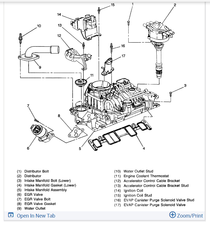

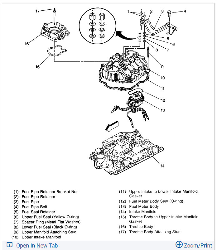

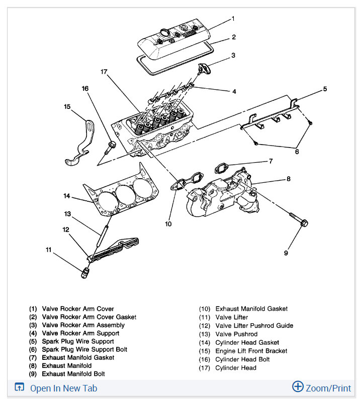

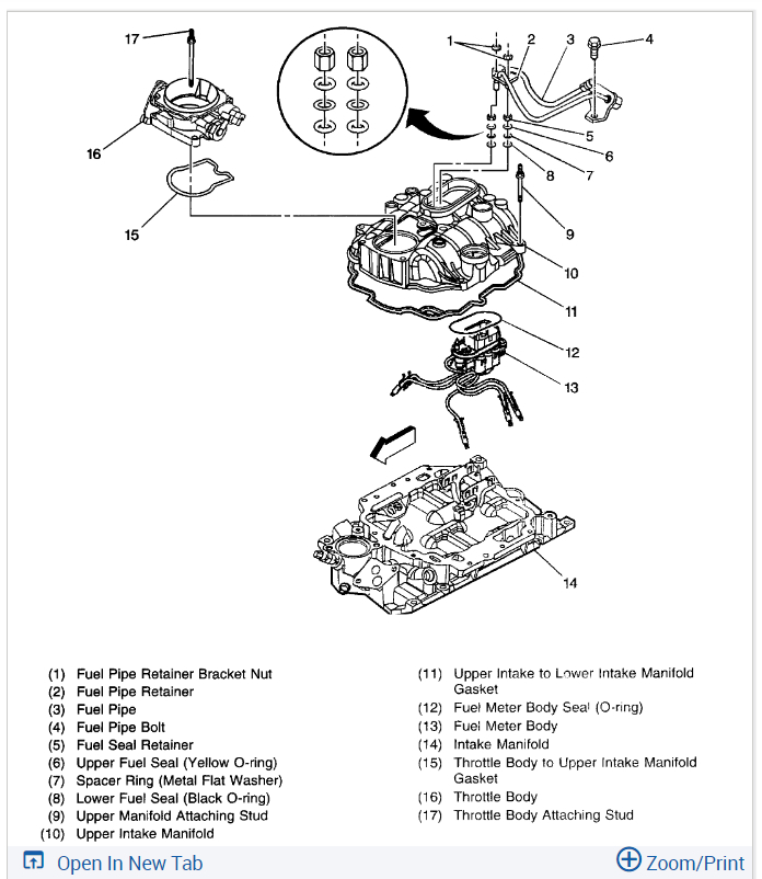

If you want to replace the head gaskets, I have included how to do the job with torque specs in the images below. Also, this guide may help as well:
https://www.2carpros.com/articles/coolantantifreeze-in-the-engine-oil
Please check out this guide as well to help walk you through the repair:
https://www.2carpros.com/articles/complete-guide-to-removing-and-installing-automotive-engine-cylinder-heads
