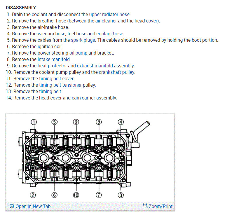

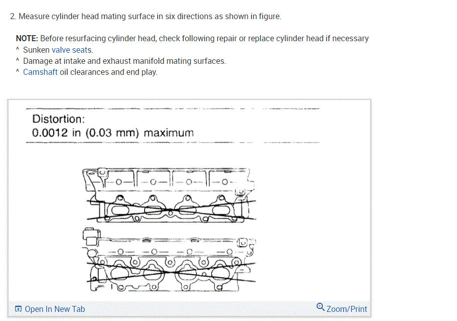

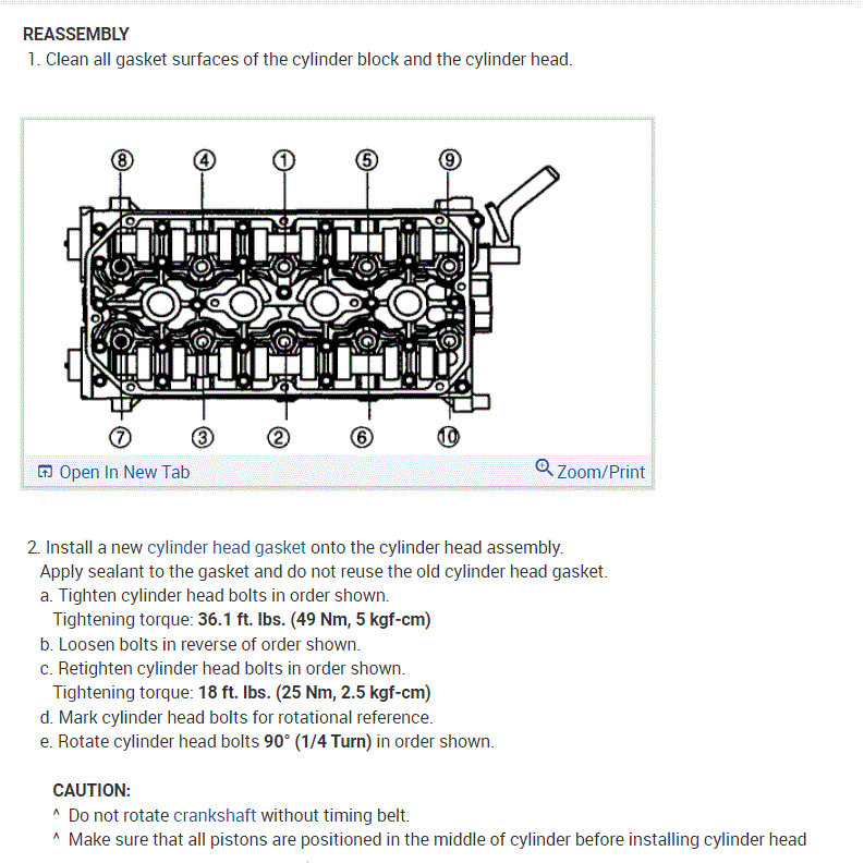

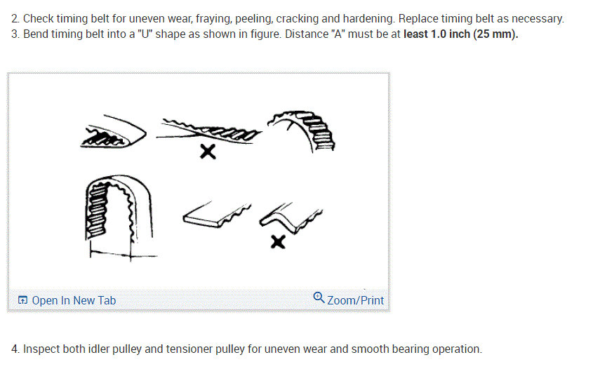

reassemble head gasket. I see assembly procedure do I put sealant on both sides of head gasket or only on one side ?
Mar 4, 2019 at 7:48 PM
  • 110,194 POSTS

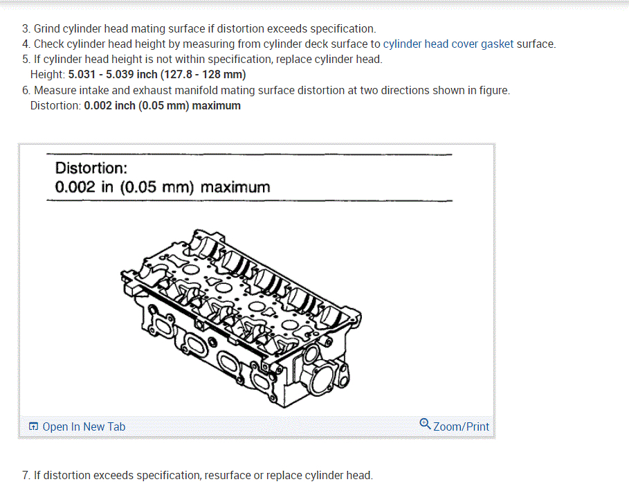

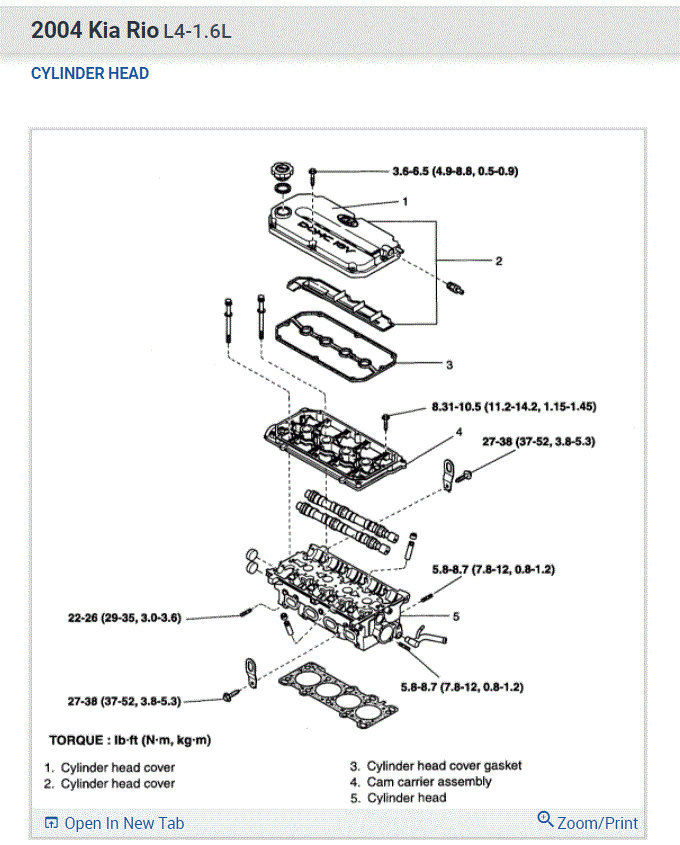

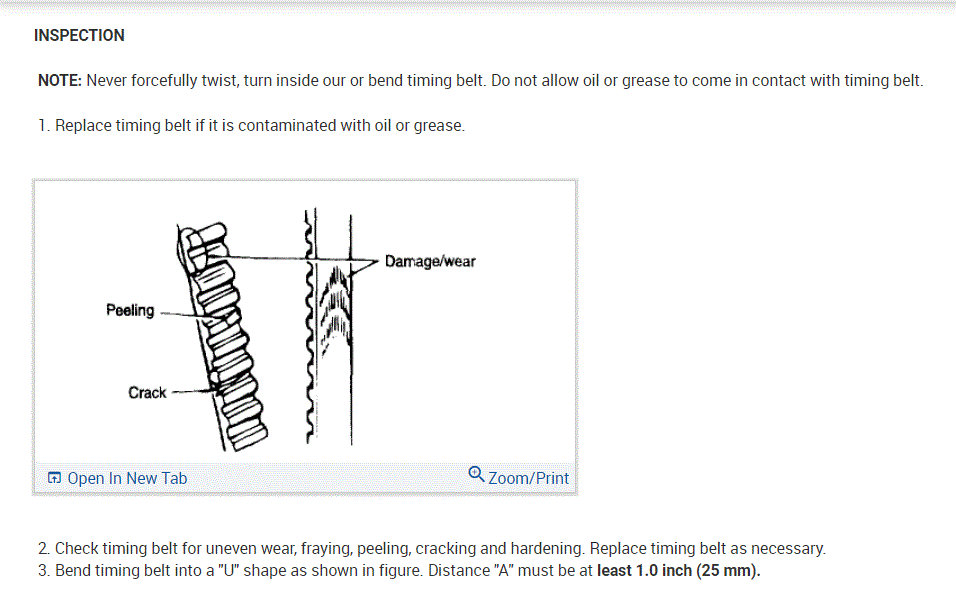

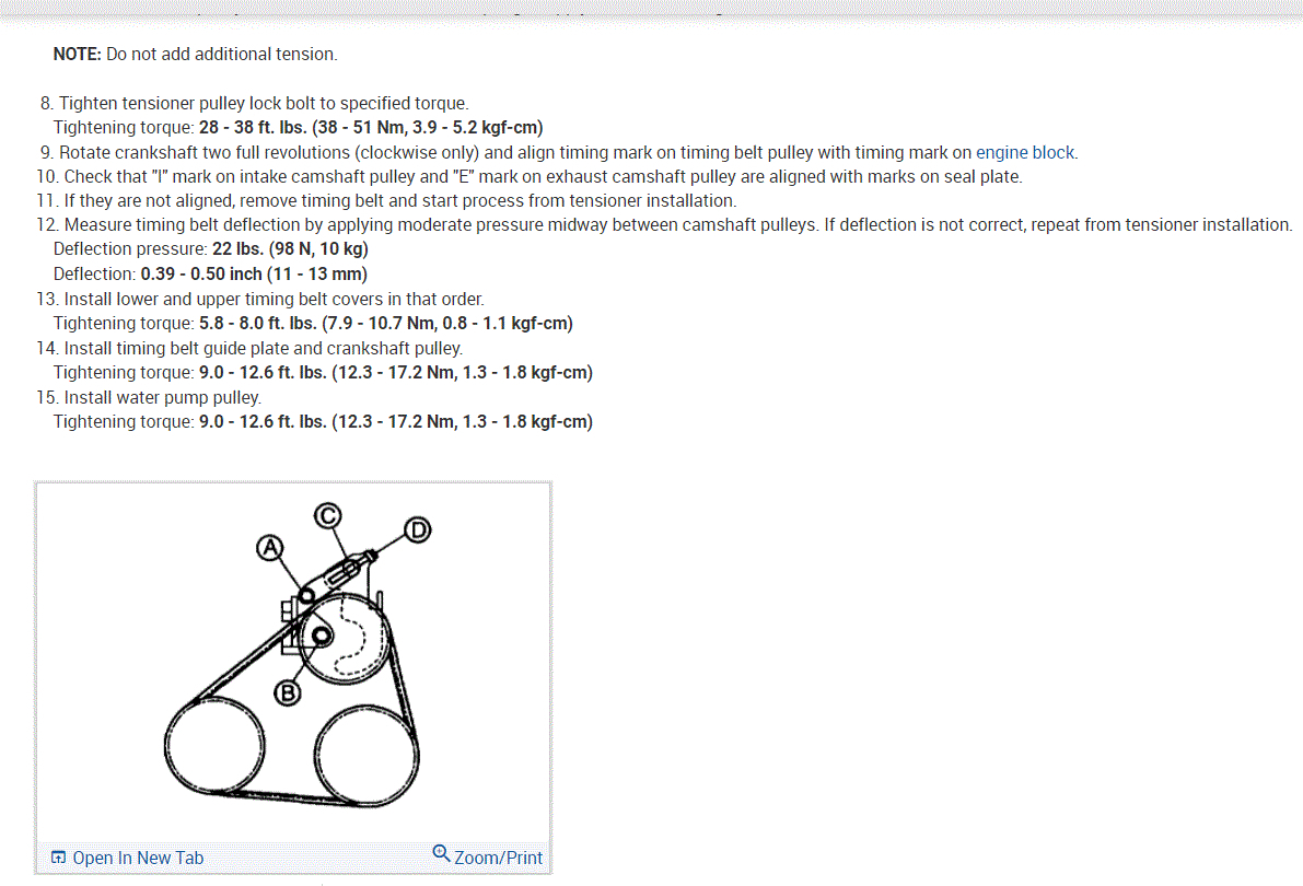

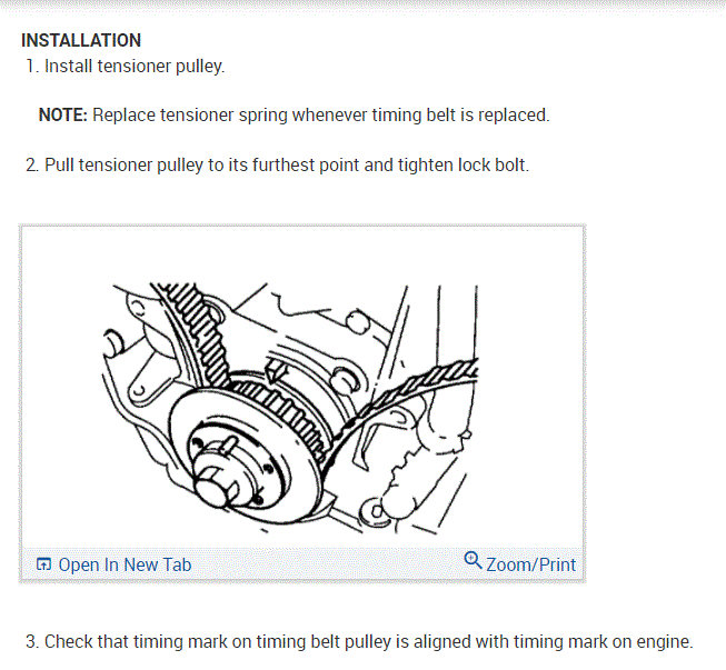

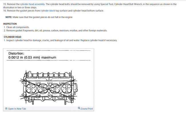

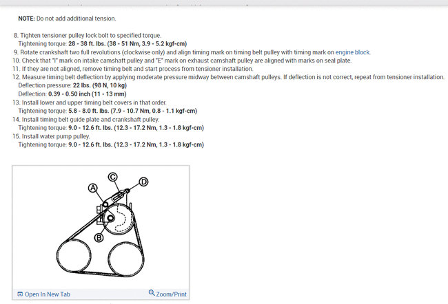

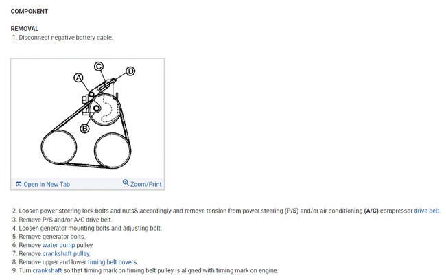

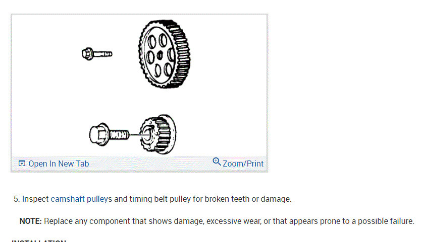

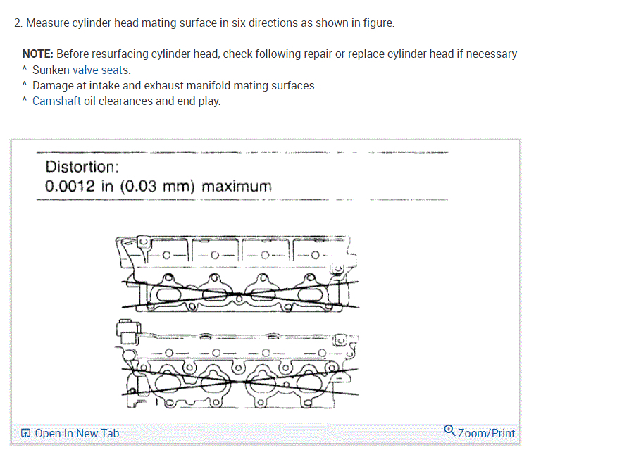

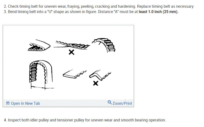

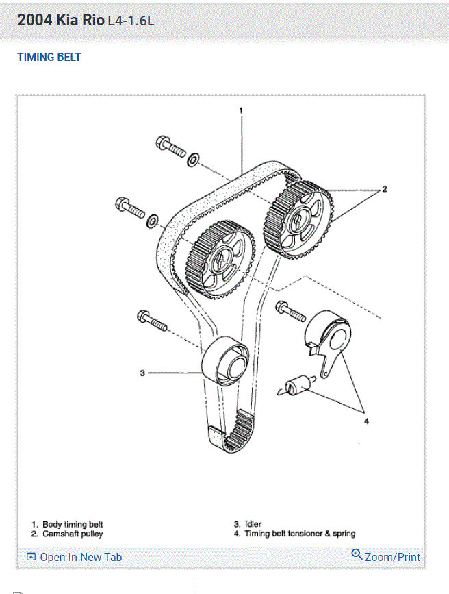

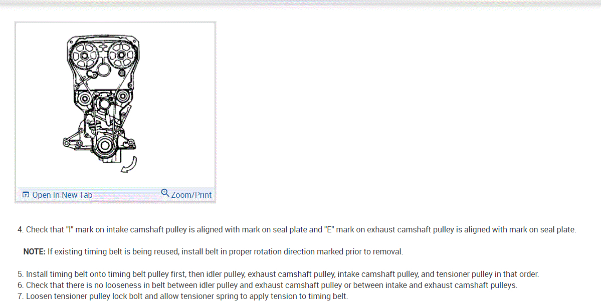

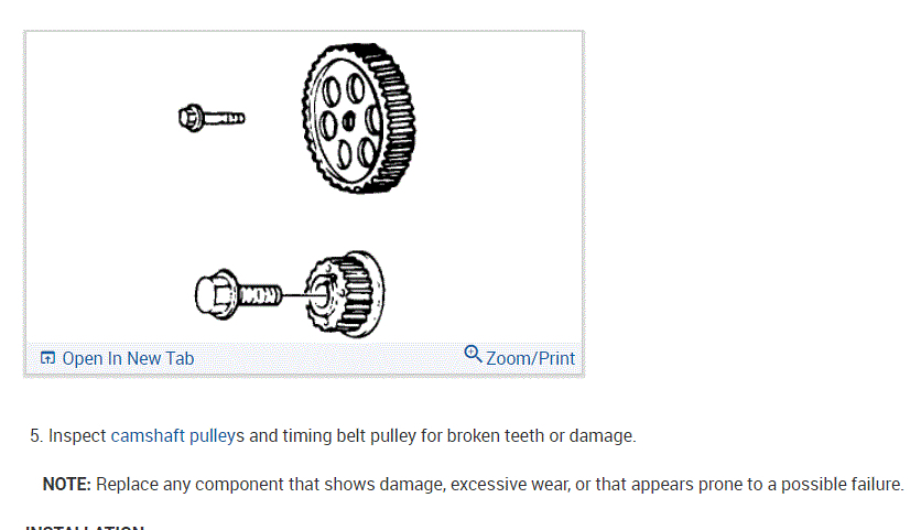

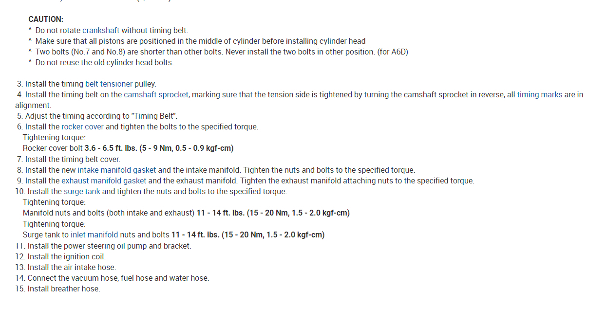

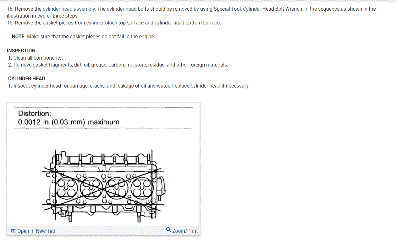

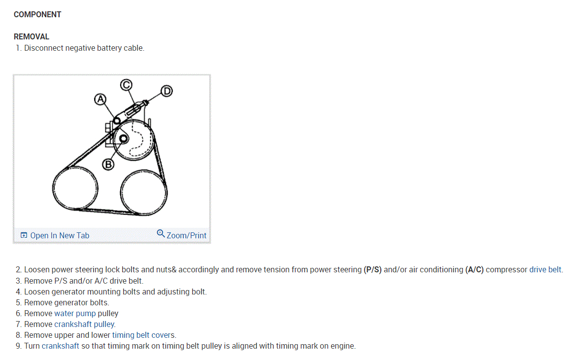

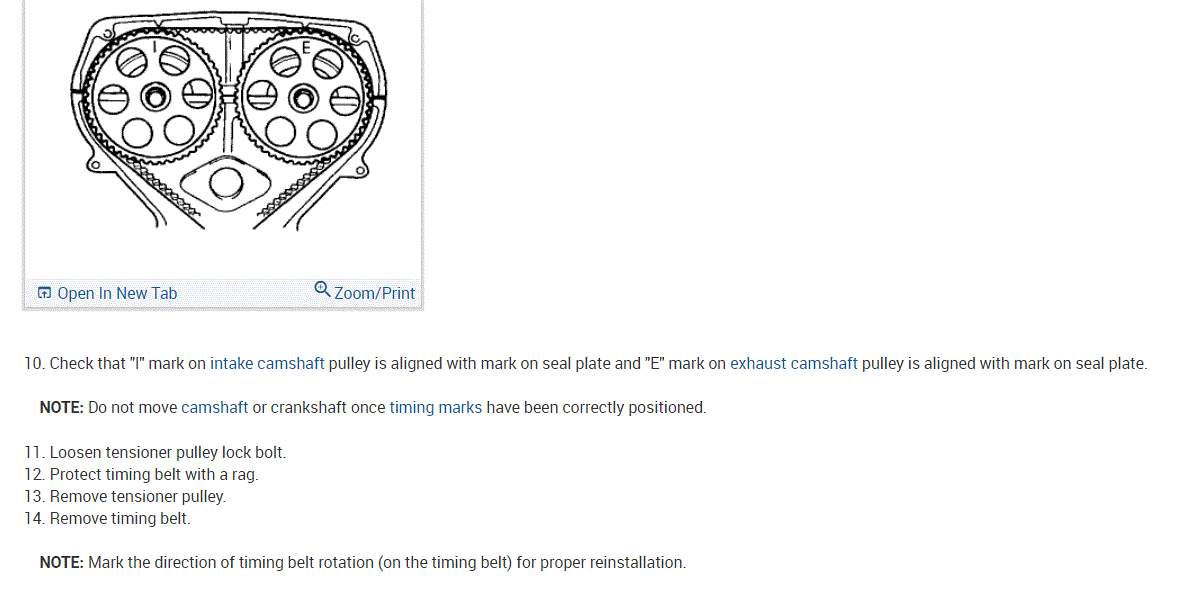

Replacing the head gasket requires the cylinder head to be removed as well as the timing belt. I am going to provide the directions for both simply because this is a good time to replace the belt since it will already be removed. Additionally, you will need to make sure the timing is done correctly.
If you look at the attachments below, they include the directions and pictures specific to your vehicle. The first directions are for the cylinder head. The second set of directions are for the timing belt. Note that the cylinder head directions include inspection. If you are sure there are no issues with the head, you will not need to remove the camshafts for inspection.
