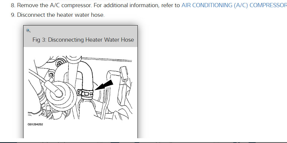

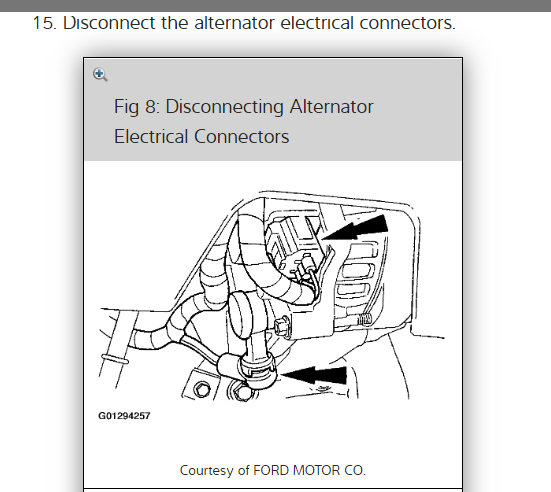

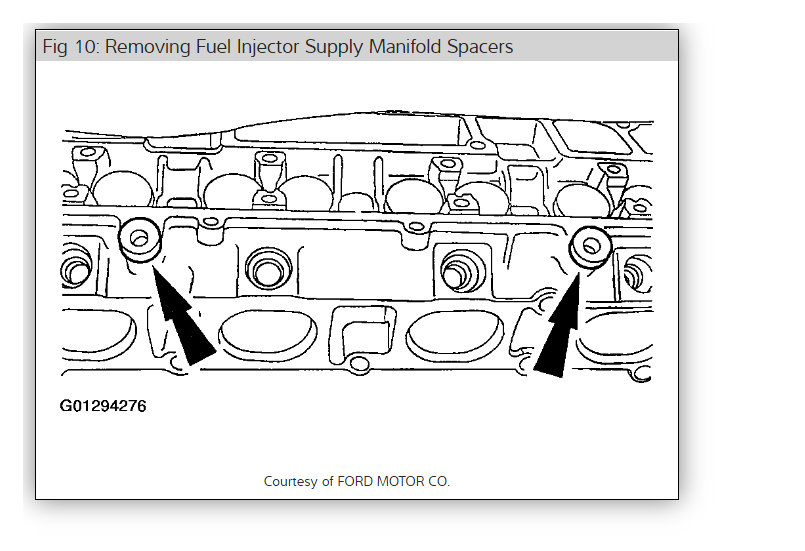

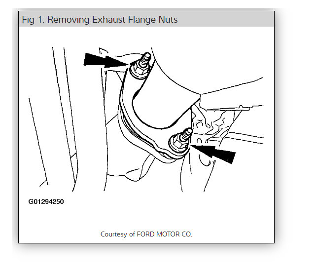

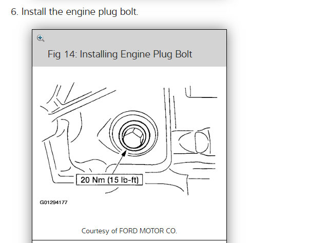

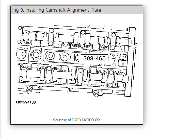

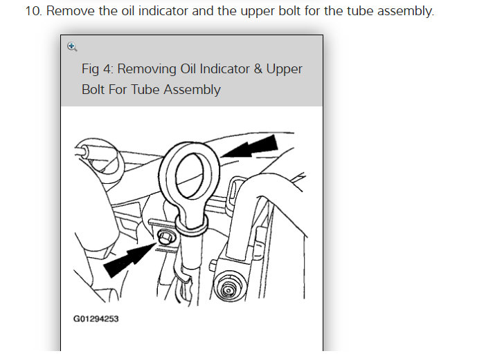

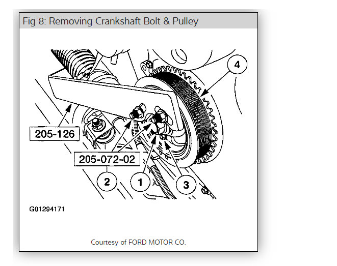

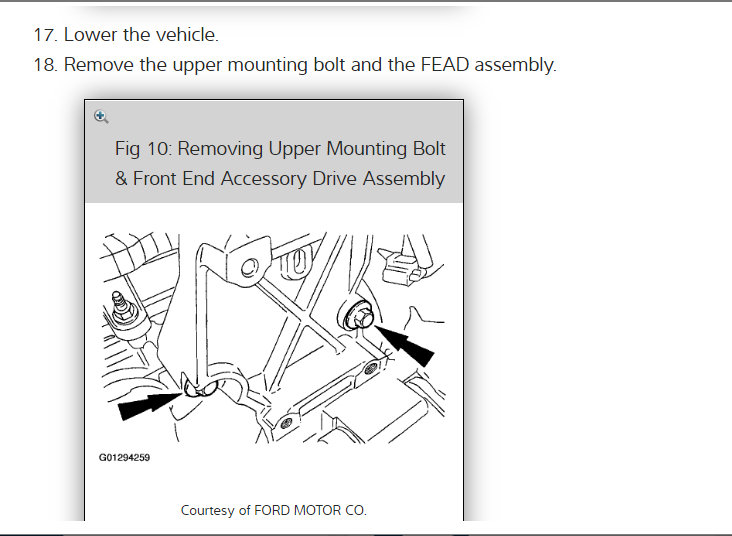

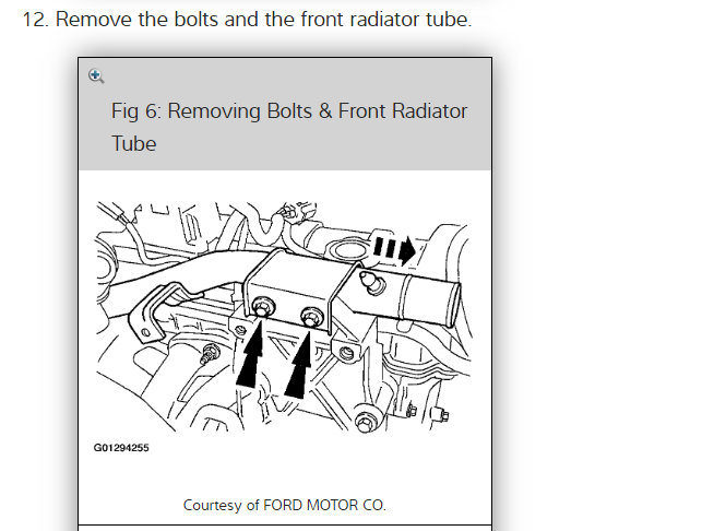

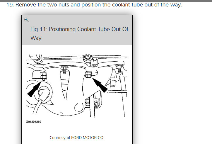

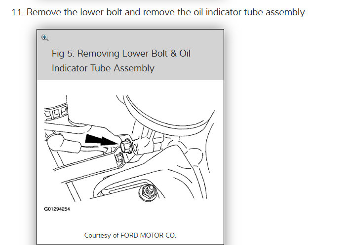

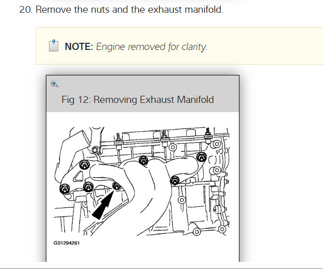

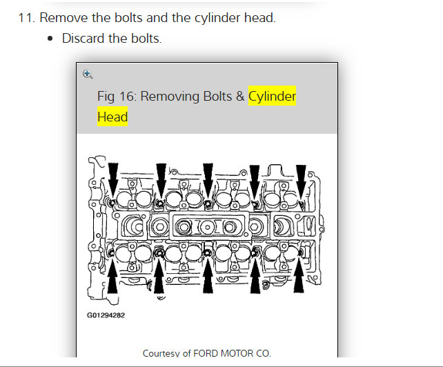

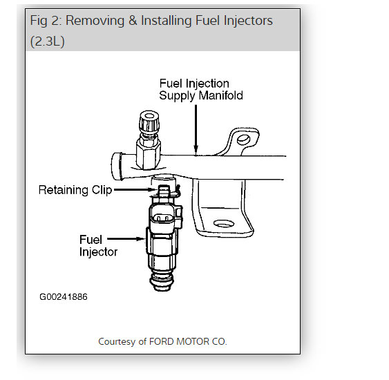

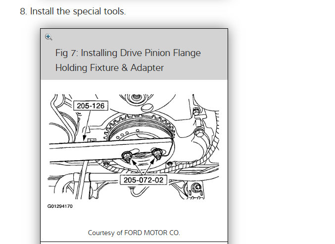

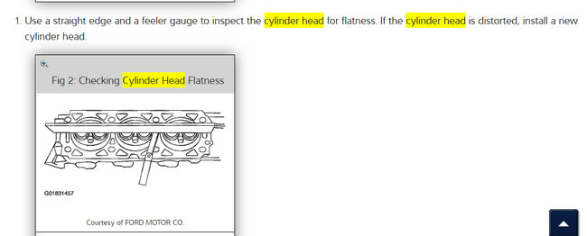

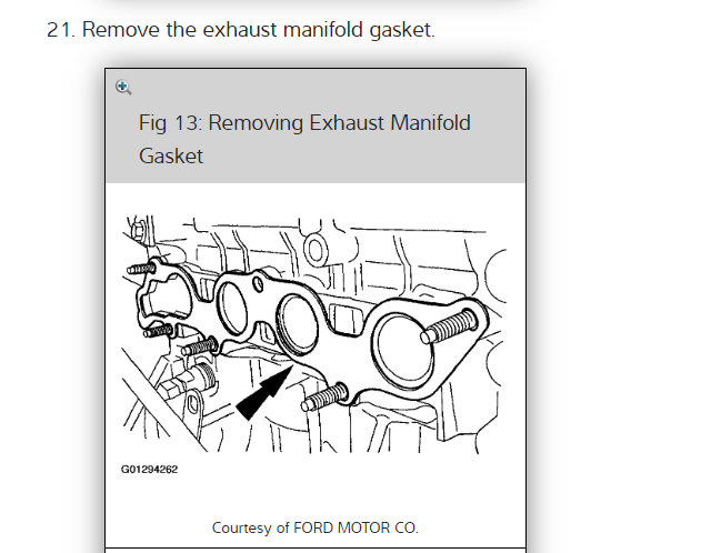

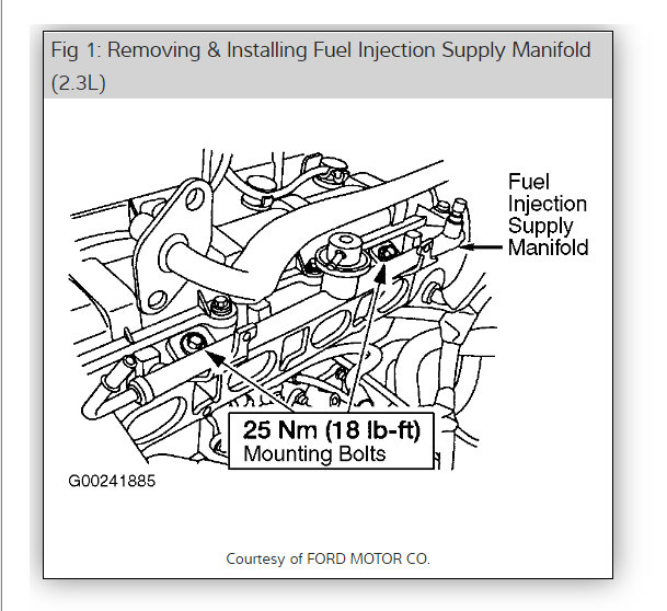

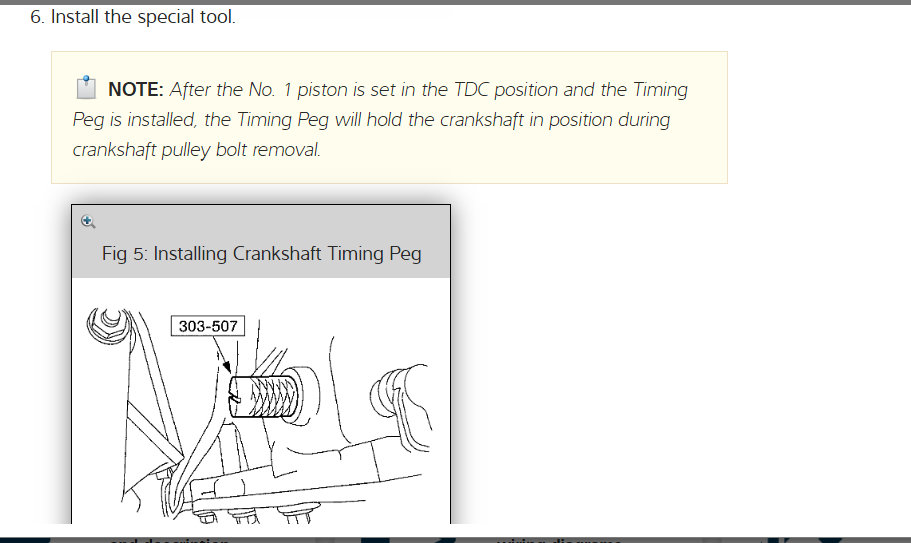

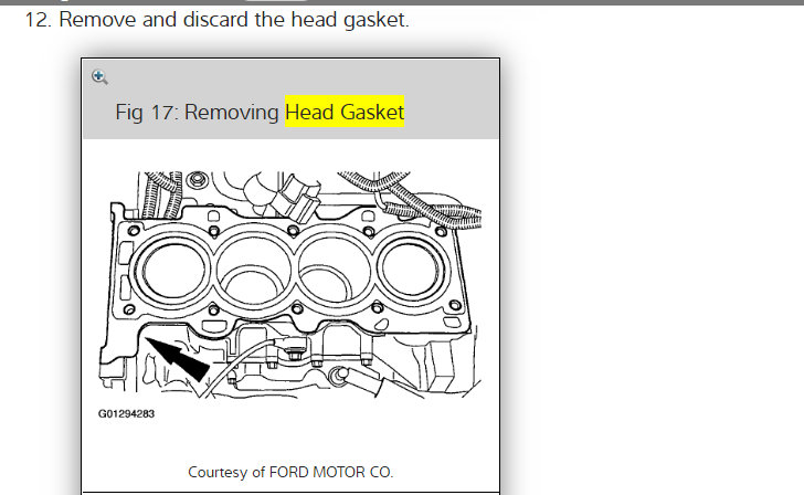

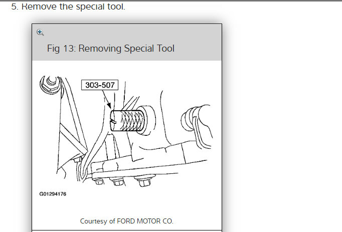

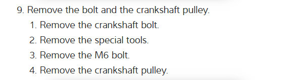

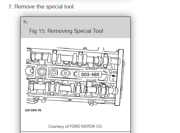

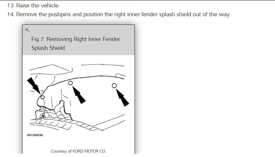

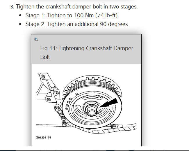

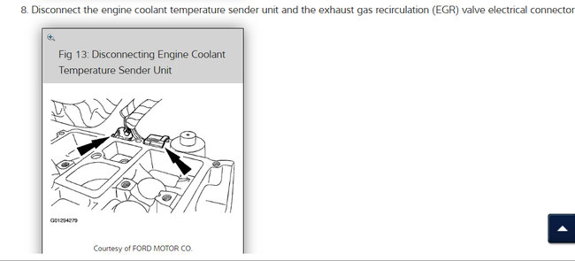

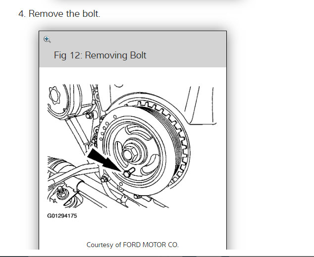

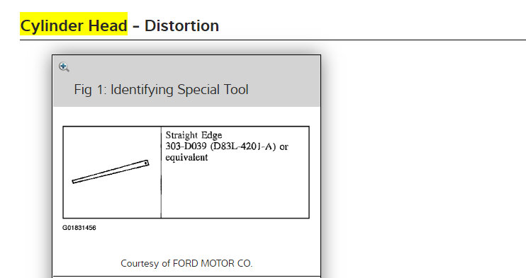

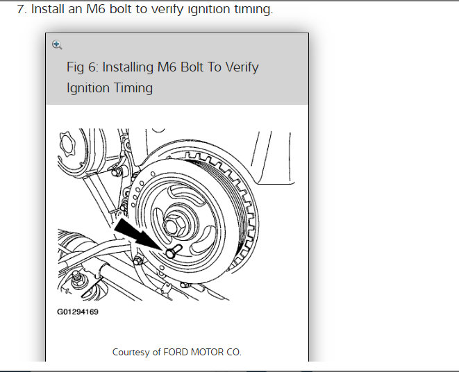

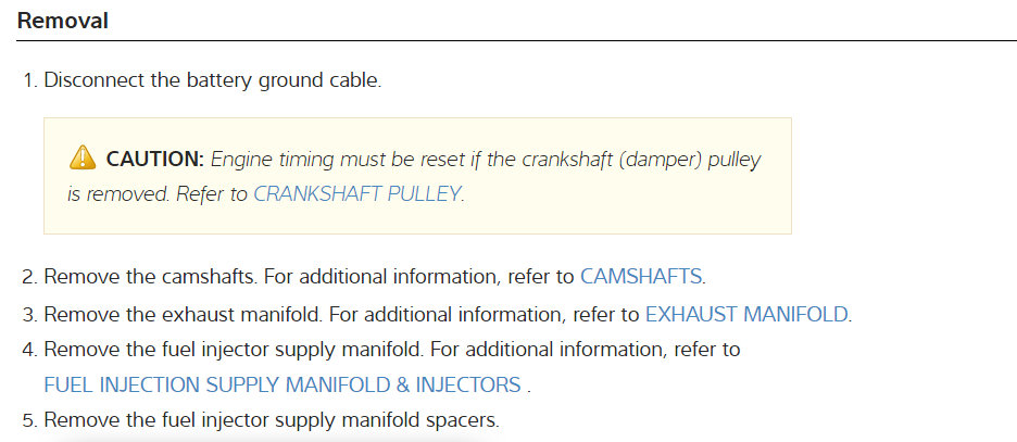

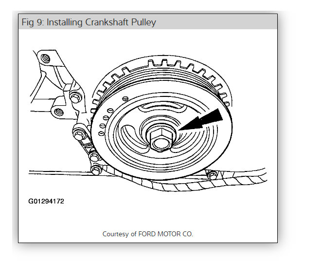

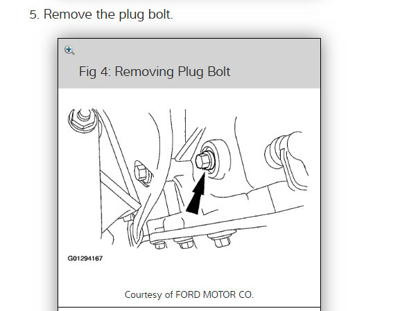

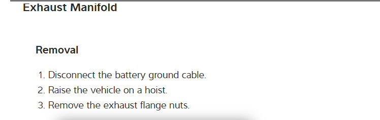

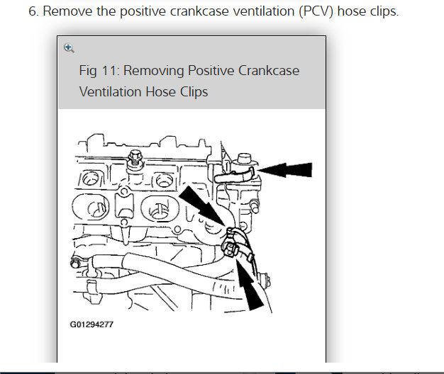

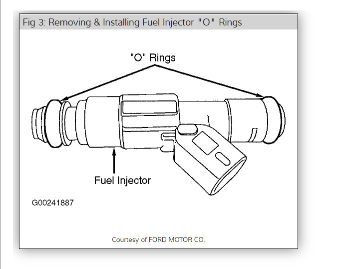

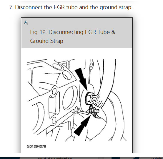

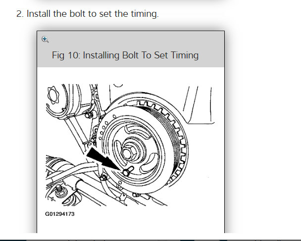

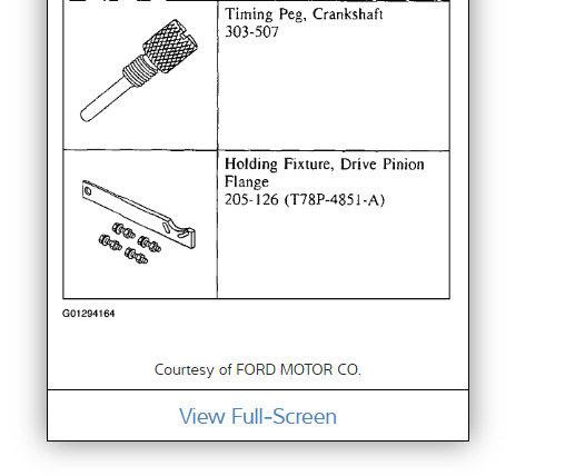

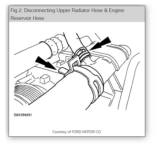

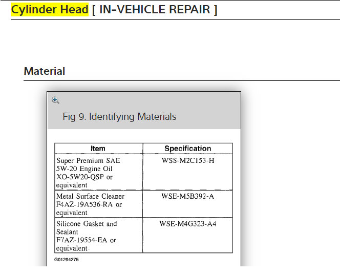

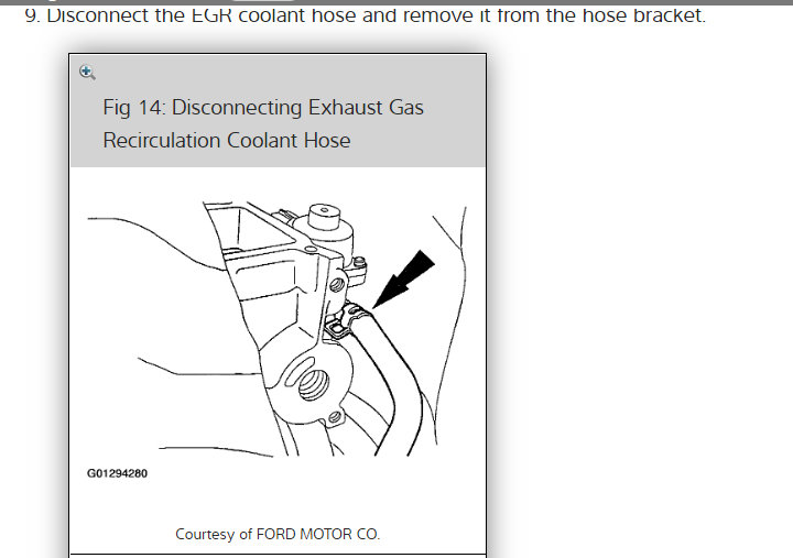

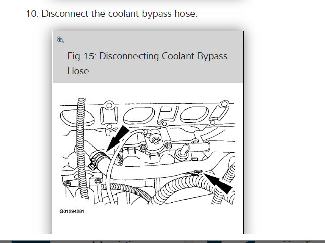

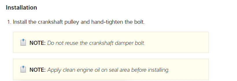

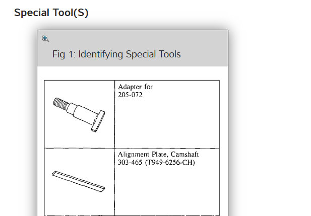

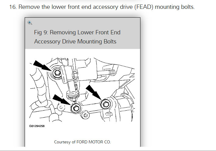

The instructions for changing your head gasket are in the diagrams down below. If there are no installation instructions they are the removal instructions in reverse.
Thanks,
Alex
2CarPros
