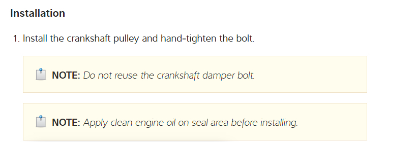

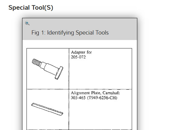

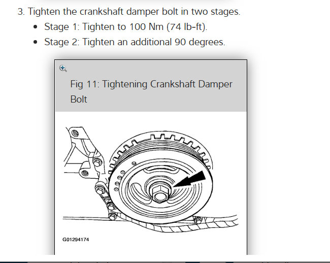

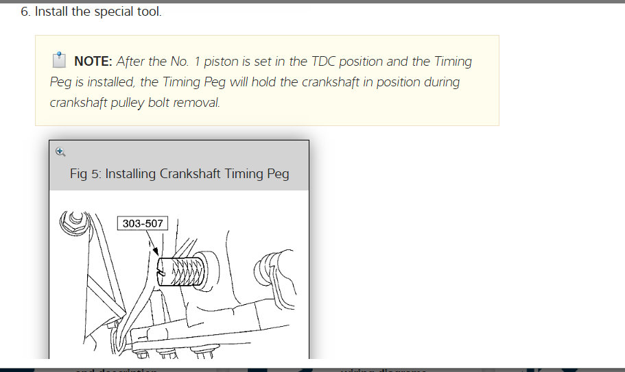

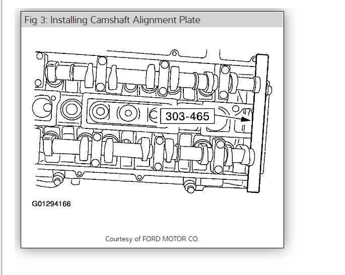

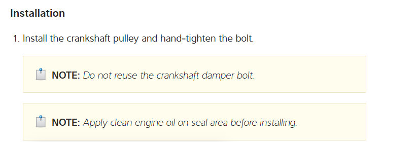

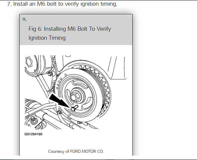

SCGRANTURISMO
  • 4,897 POSTS

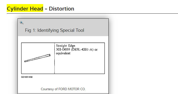

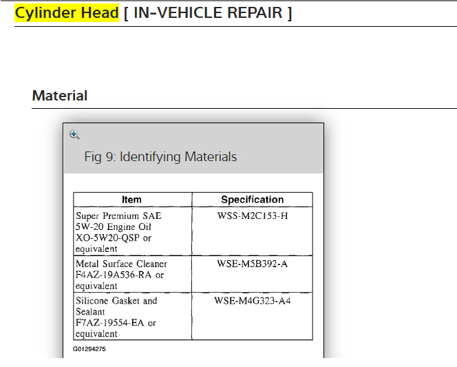

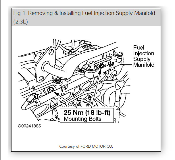

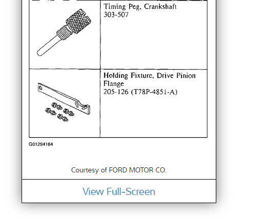

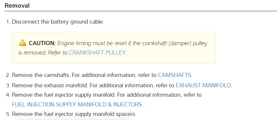

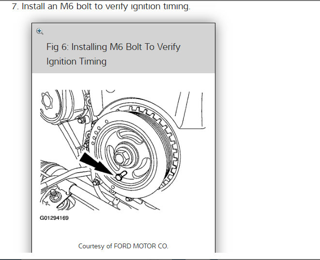

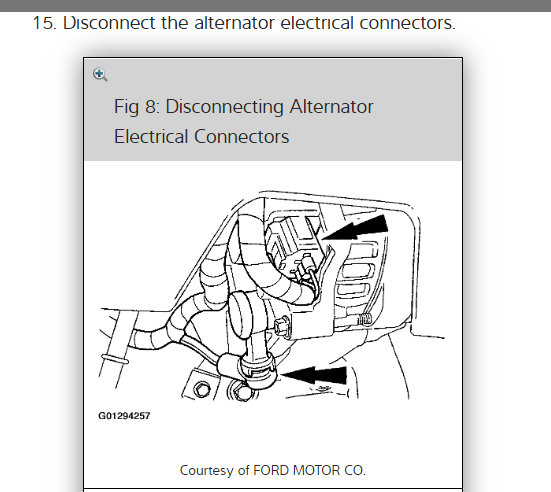

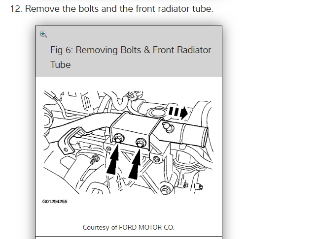

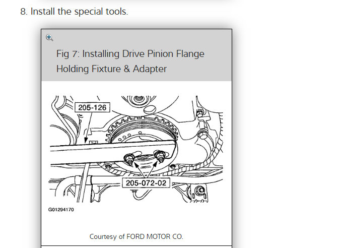

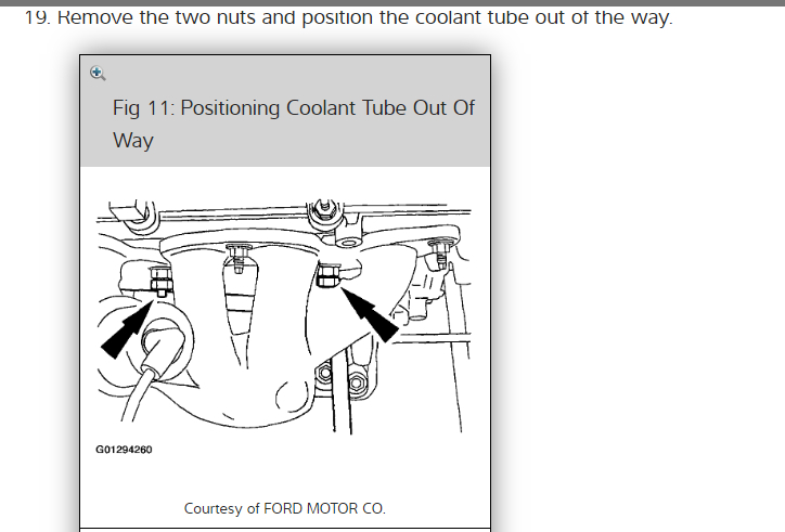

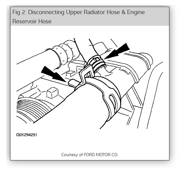

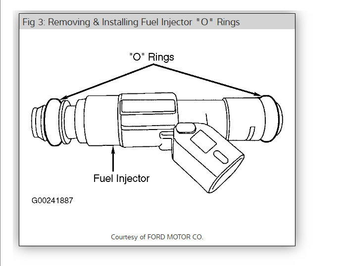

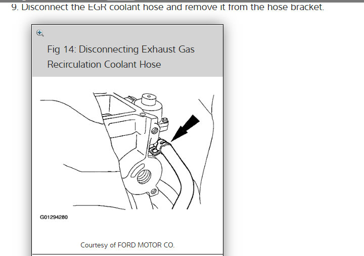

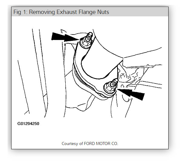

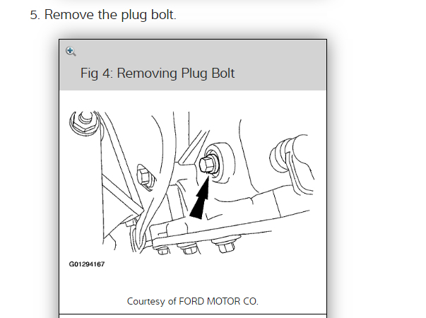

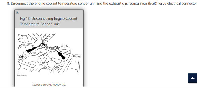

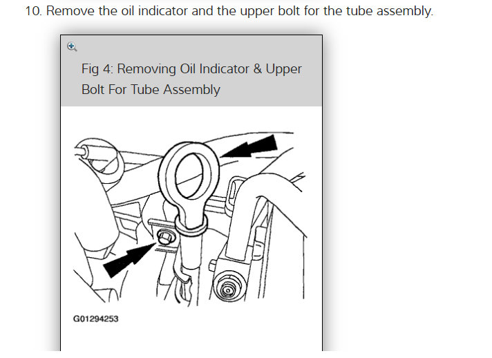

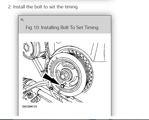

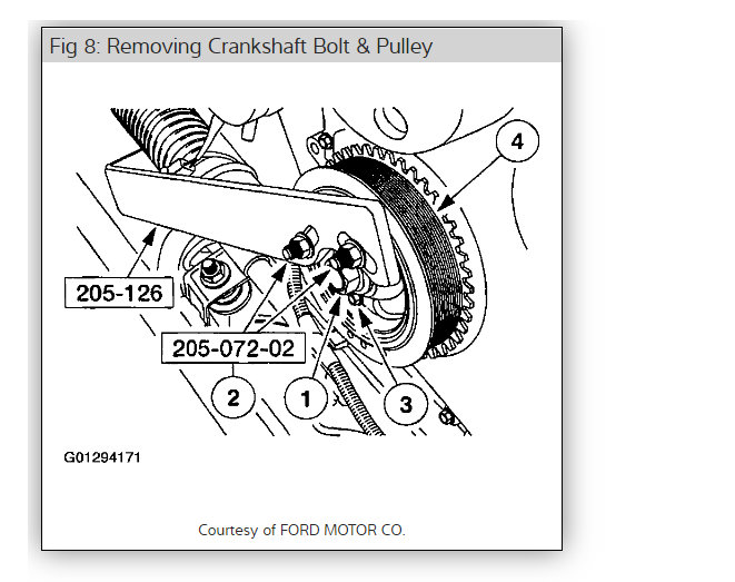

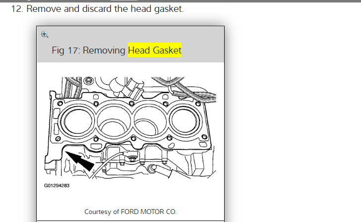

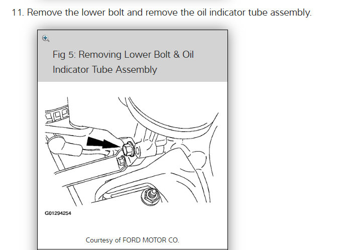

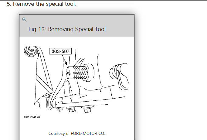

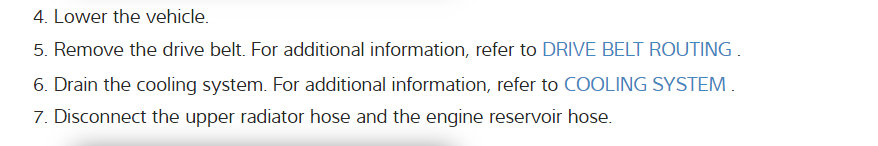

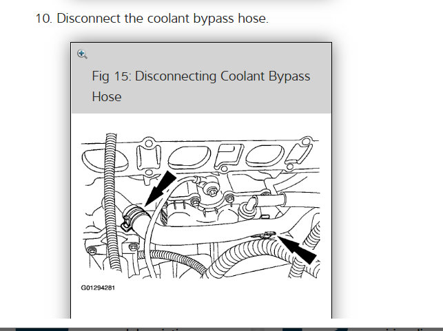

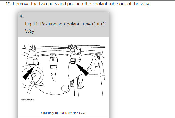

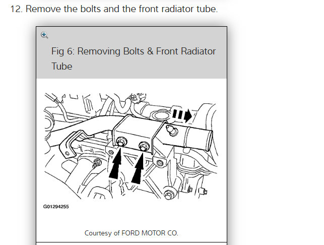

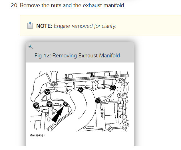

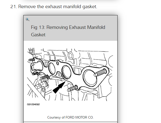

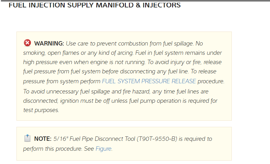

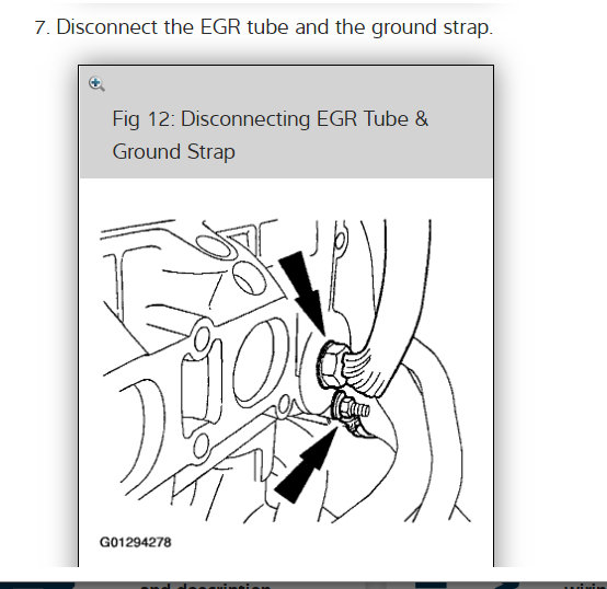

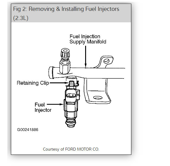

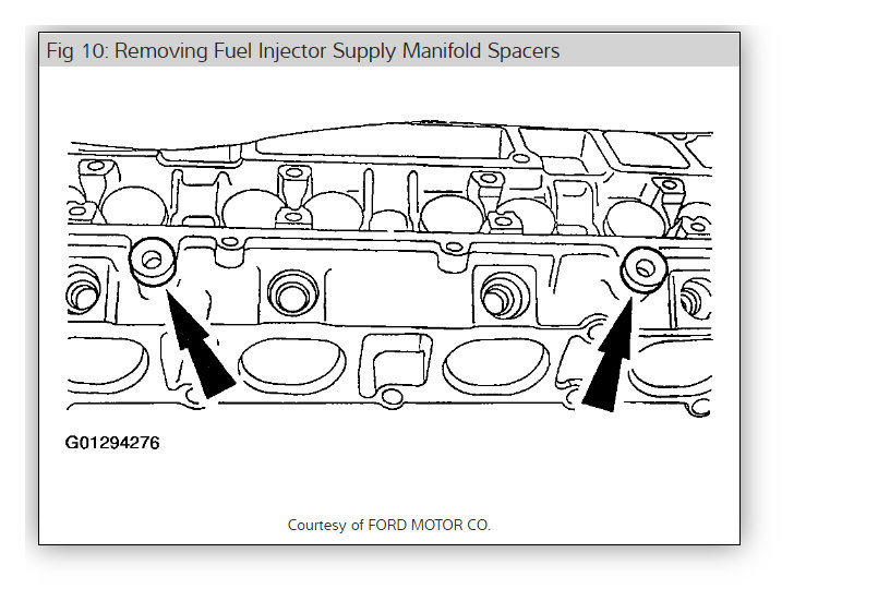

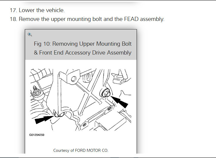

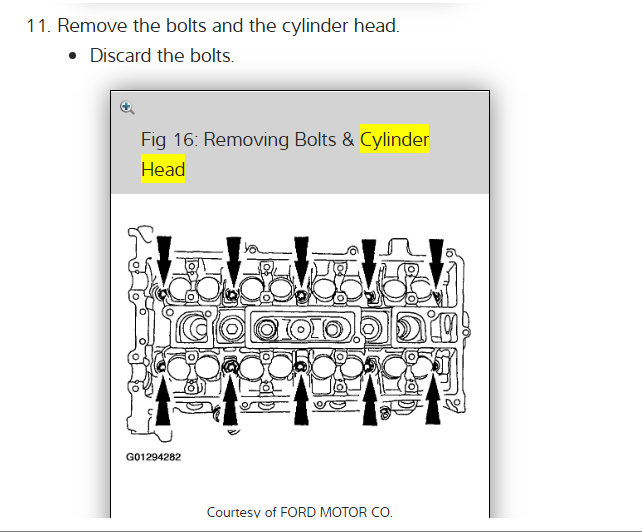

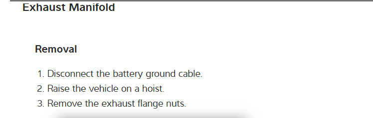

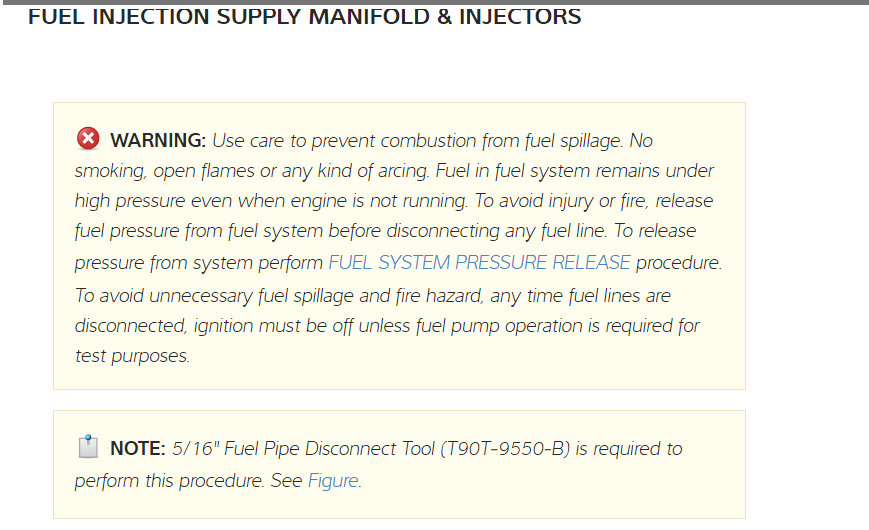

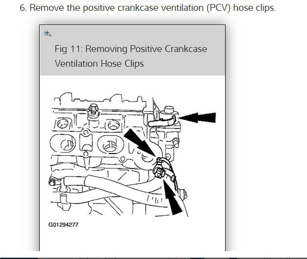

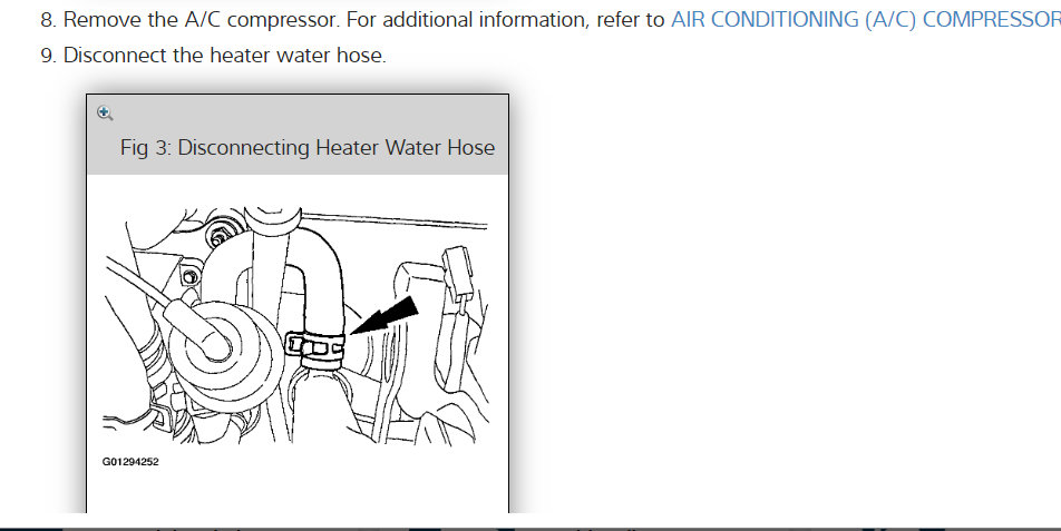

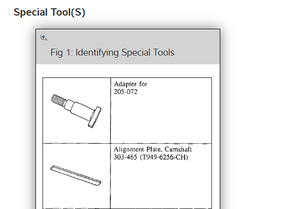

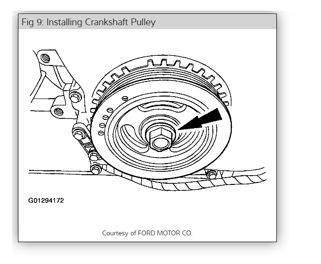

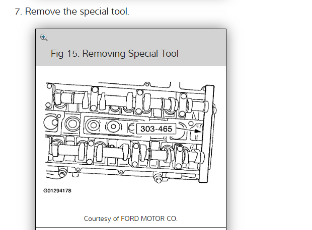

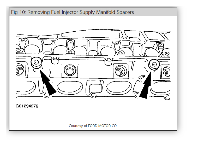

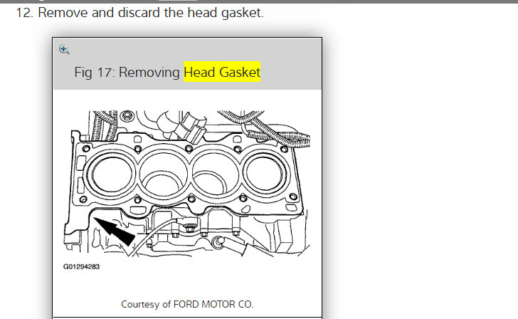

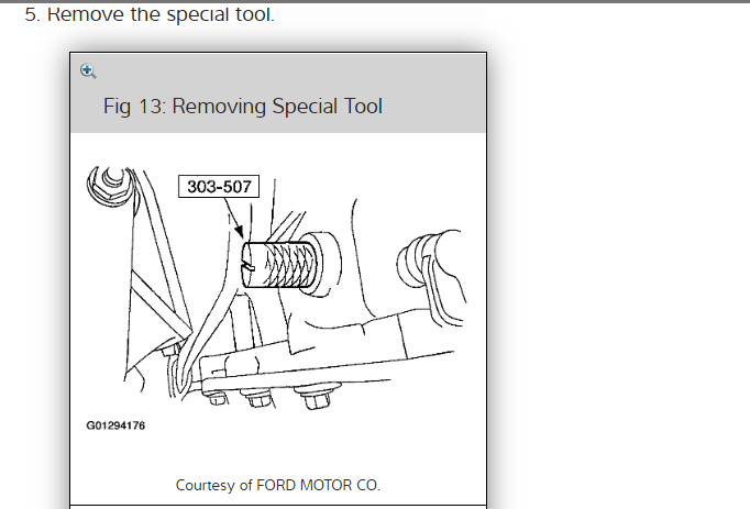

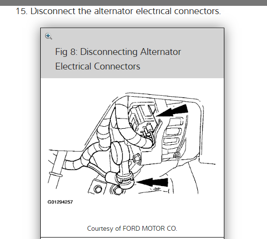

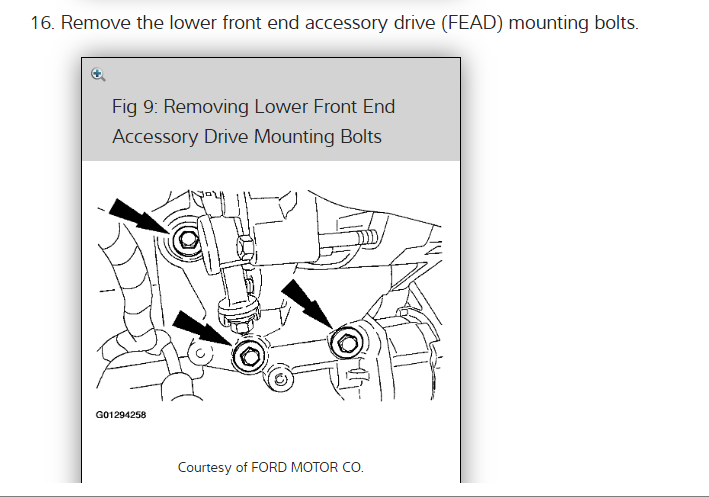

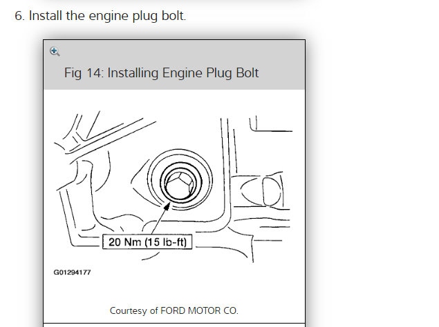

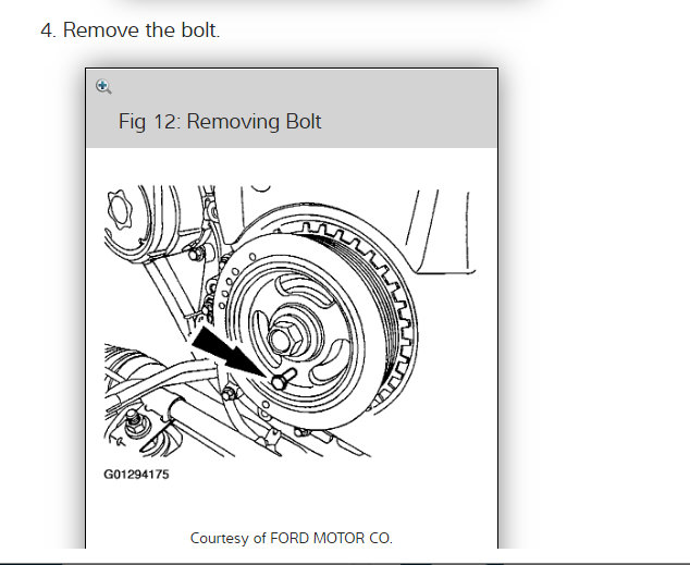

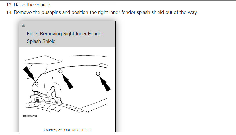

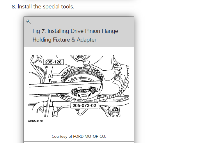

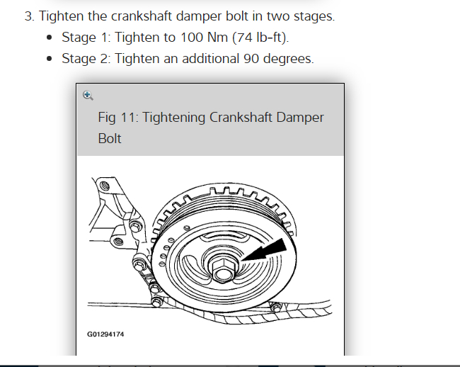

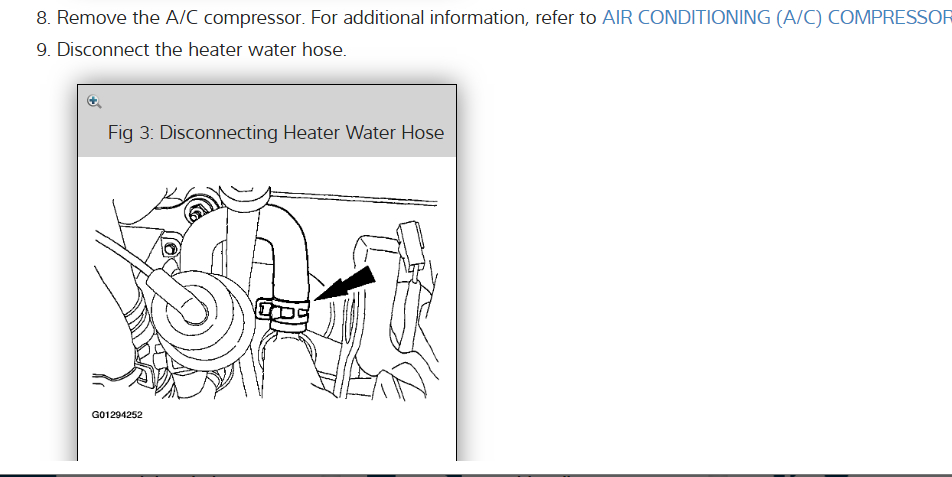

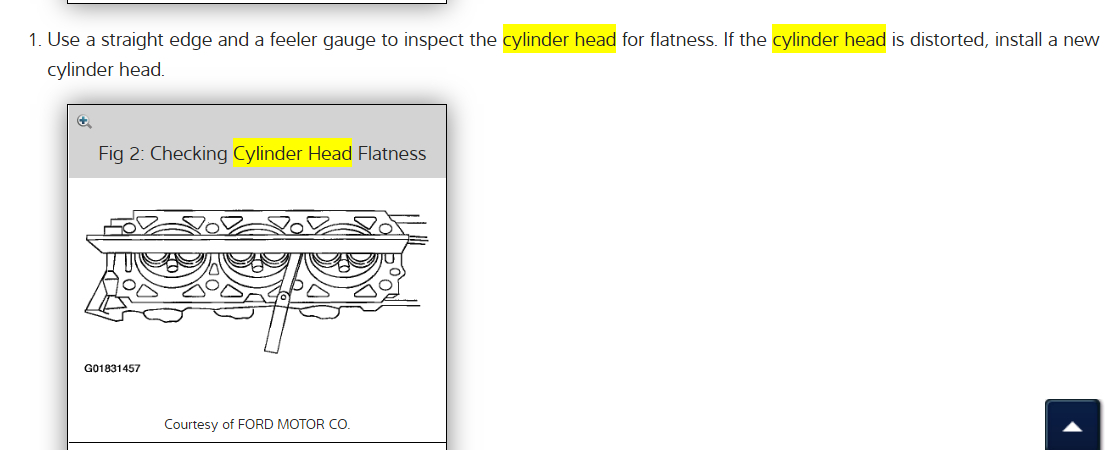

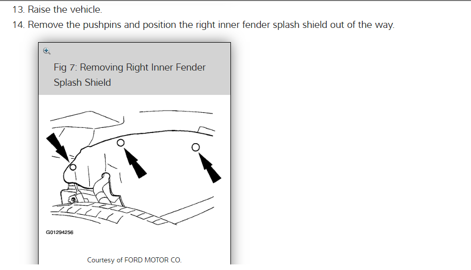

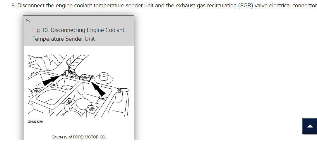

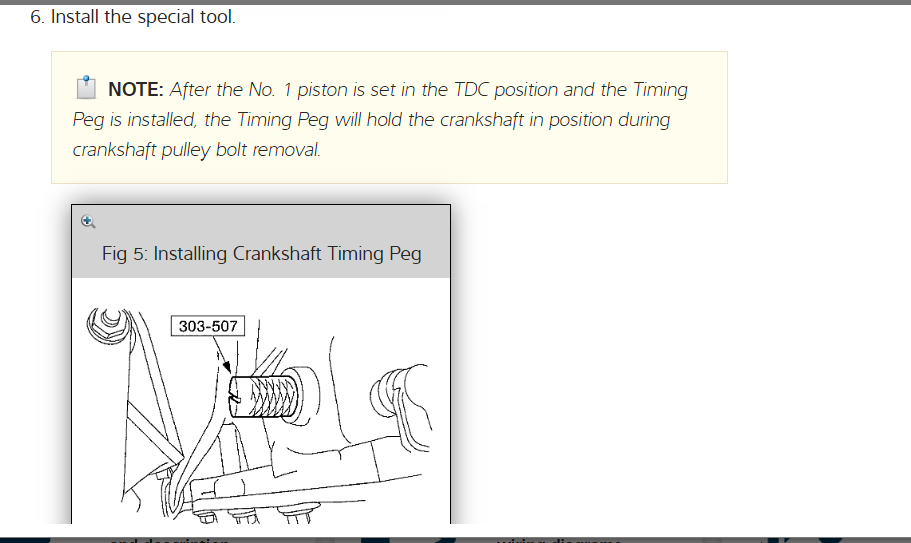

The instructions for changing your head gasket are in the diagrams down below. If there are no installation instructions they are the removal instructions in reverse.
Thanks,
Alex
2CarPros
