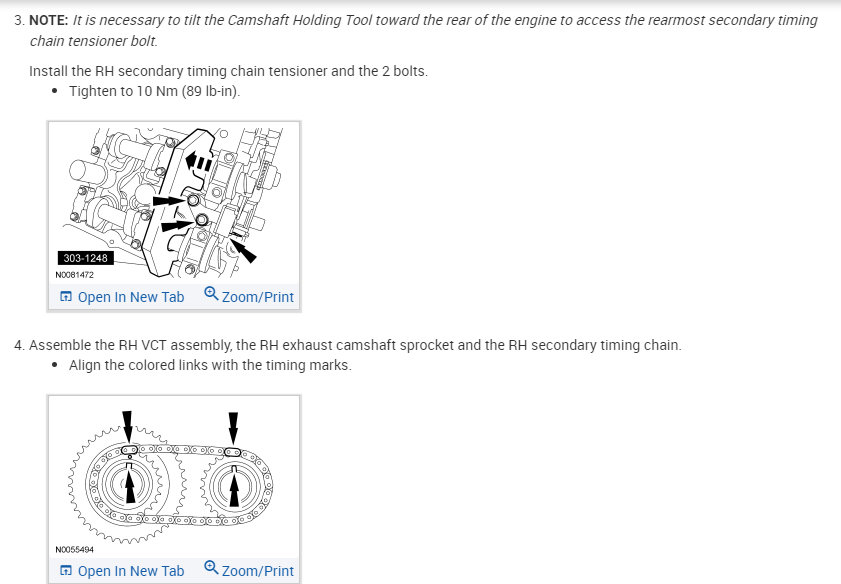

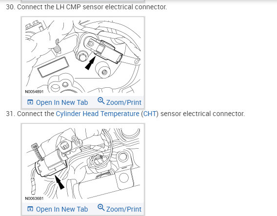

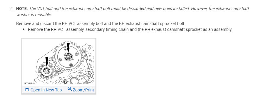

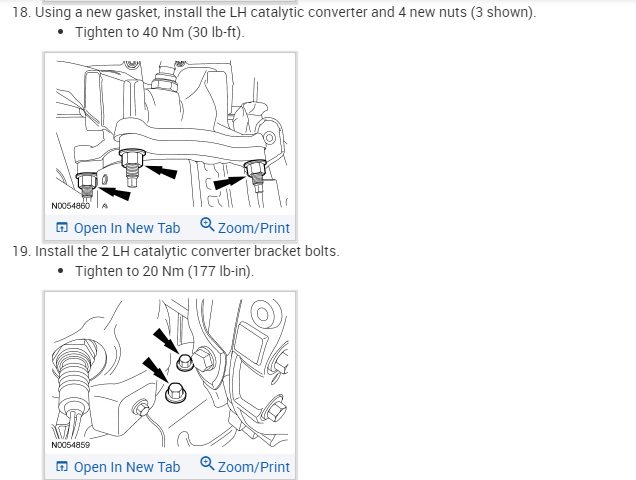

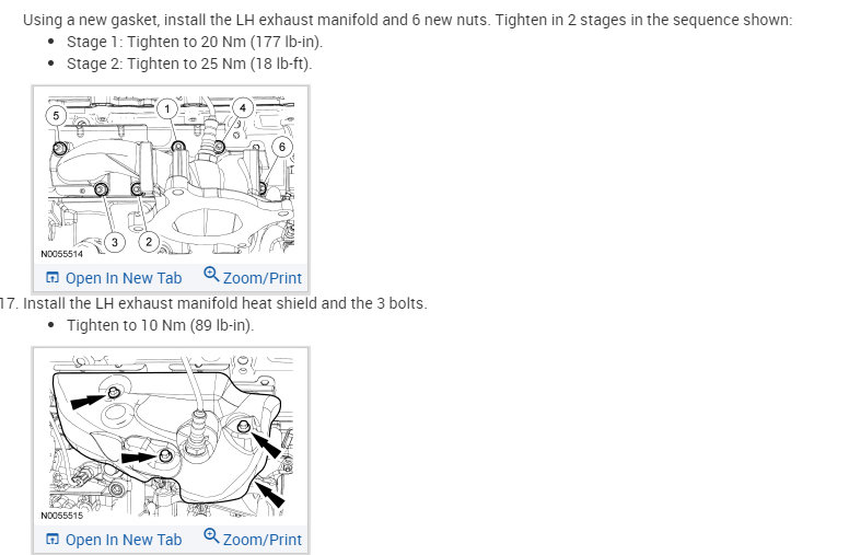

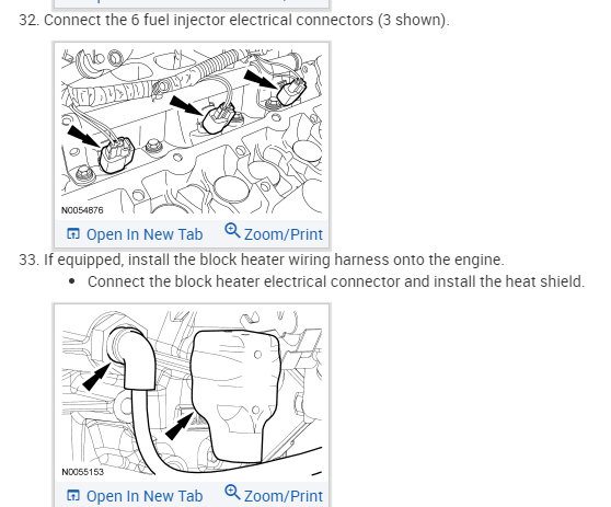

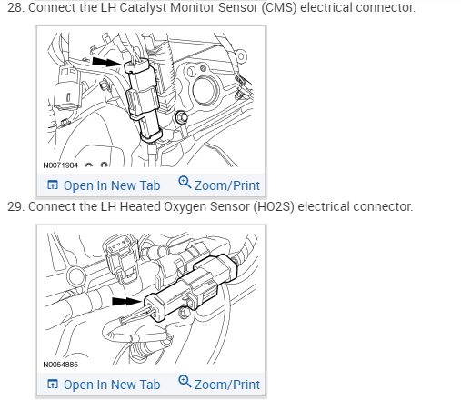

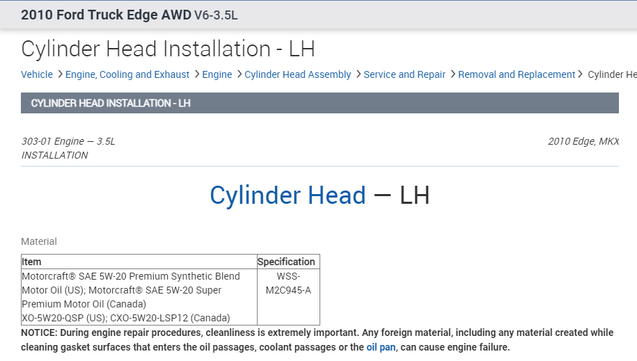

Wow, I never heard of that. No, you don't need to replace the rings. I have no idea where he heard about that. At least in 40 years, I never heard that and never replaced them.

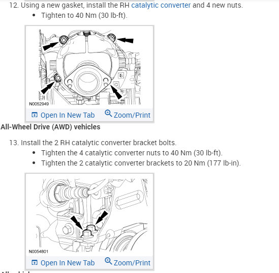

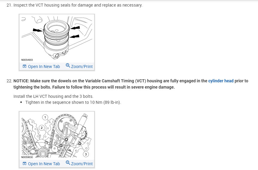

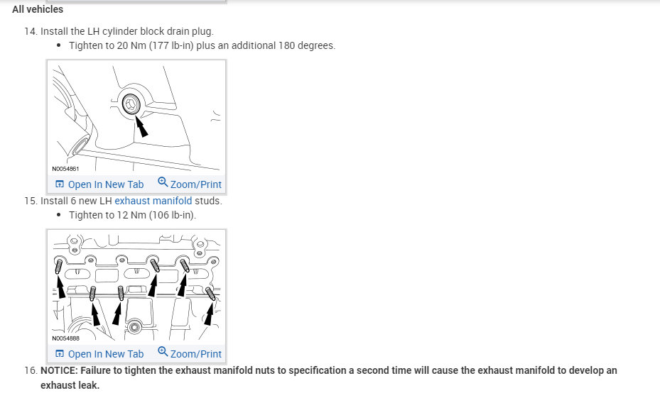

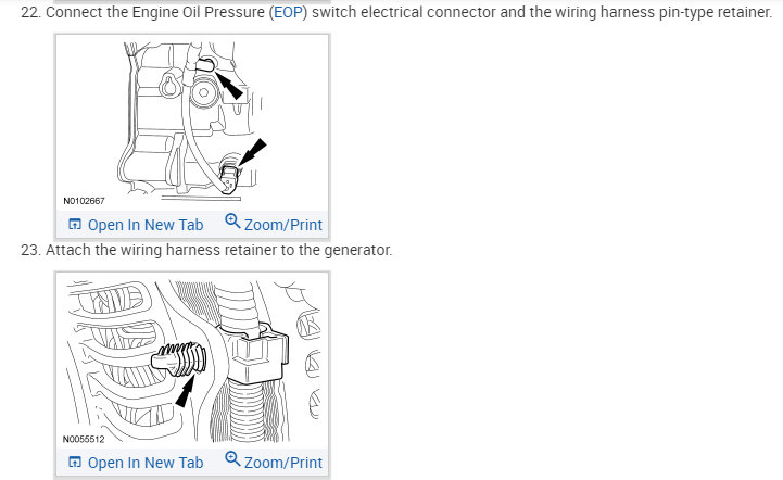

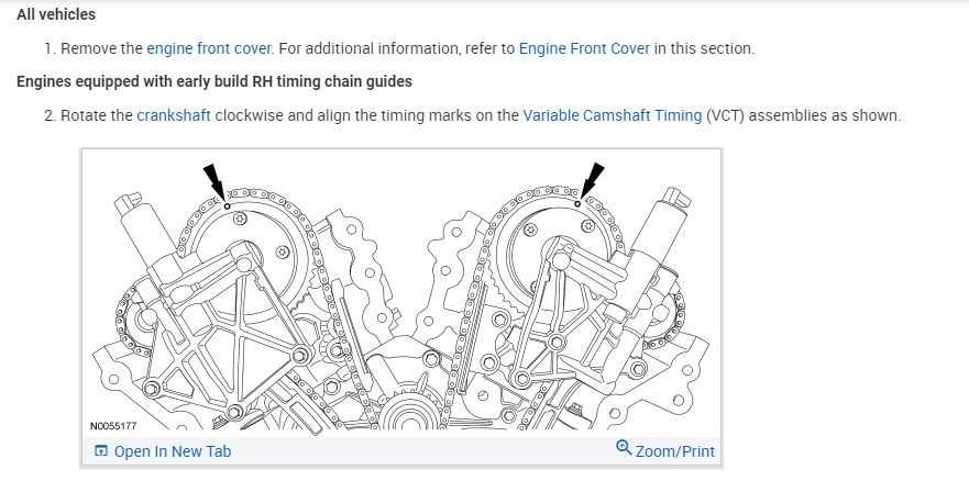

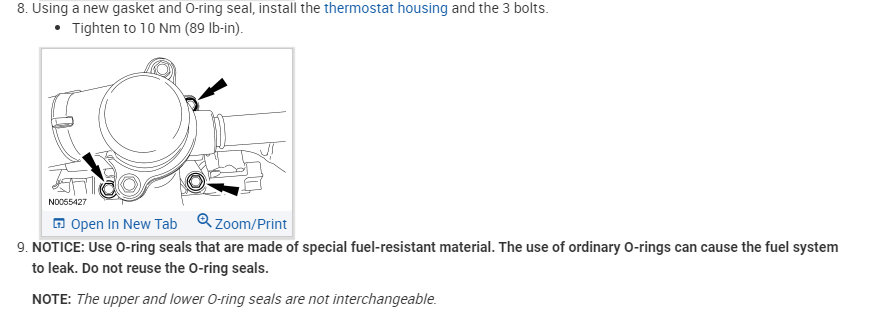

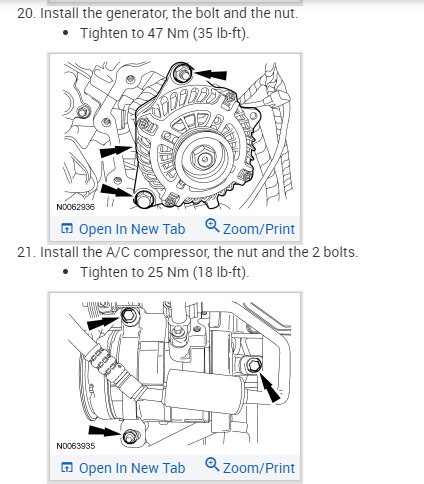

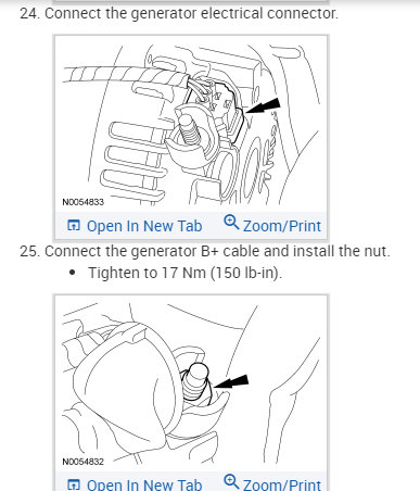

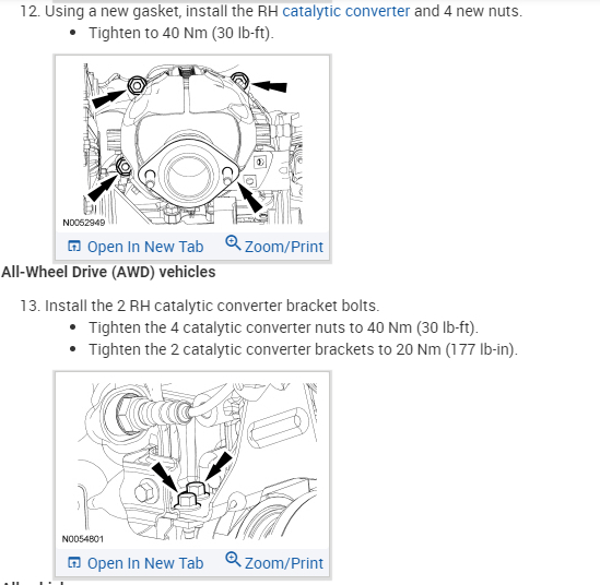

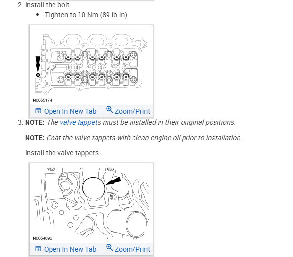

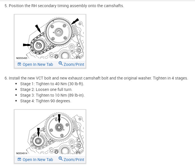

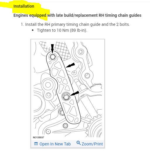

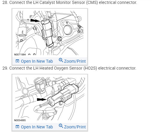

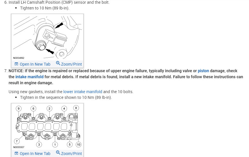

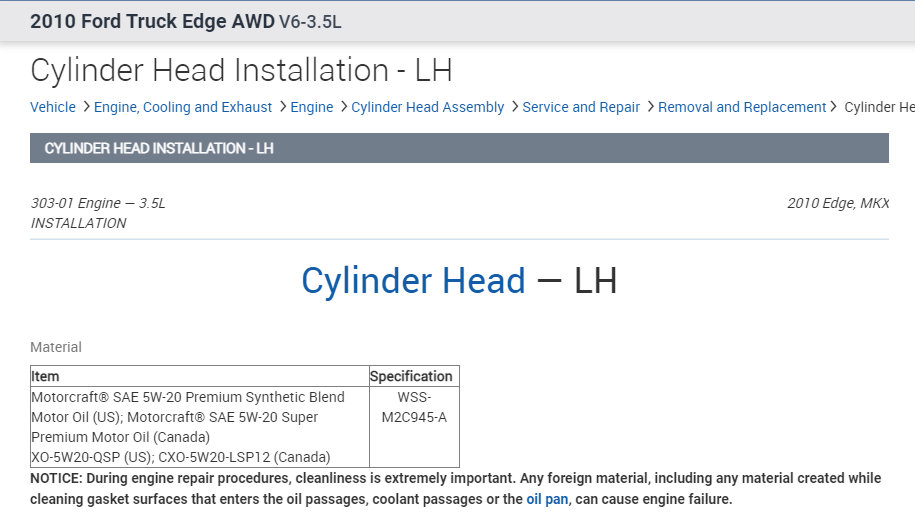

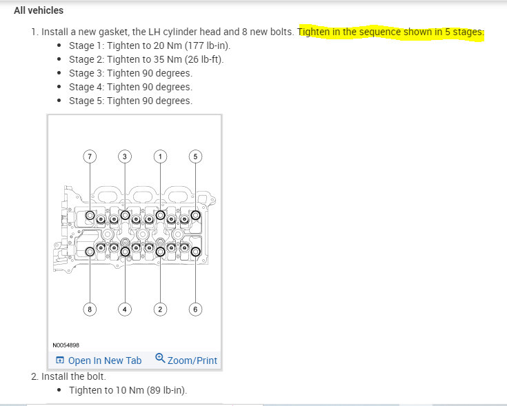

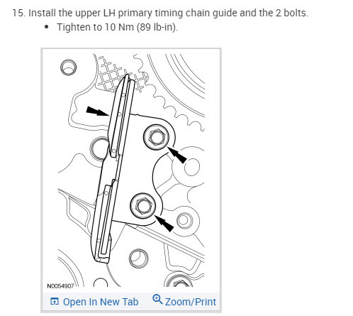

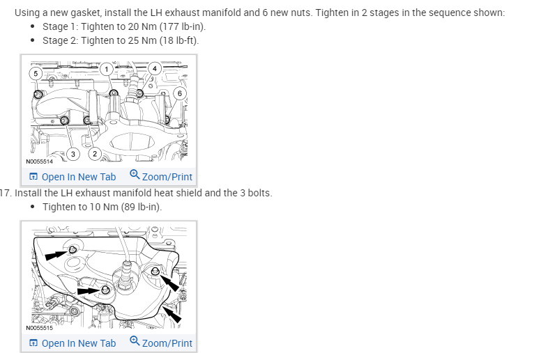

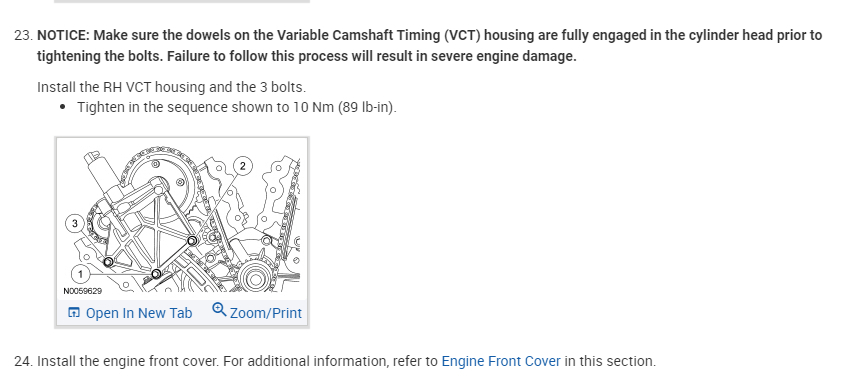

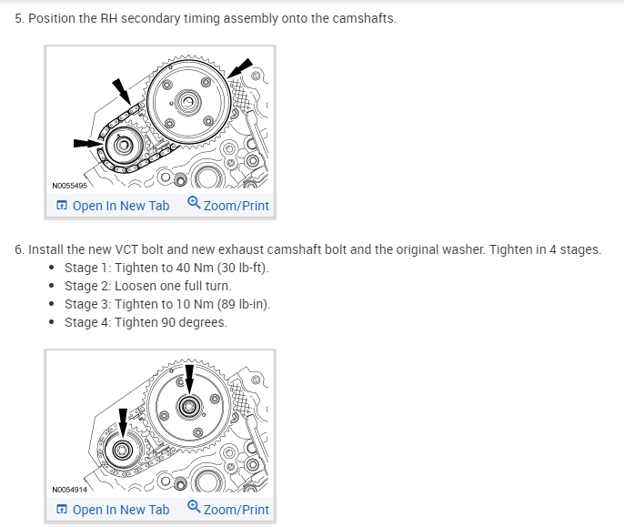

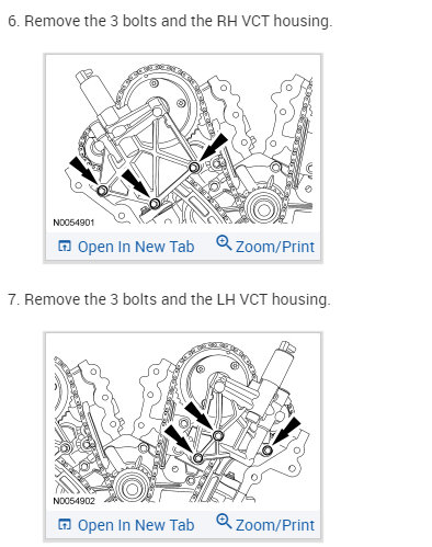

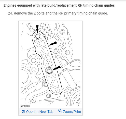

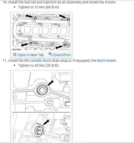

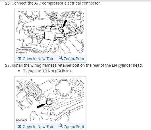

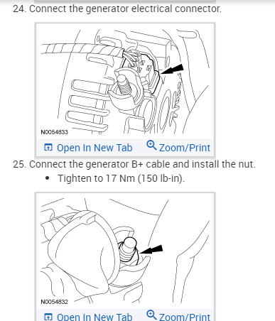

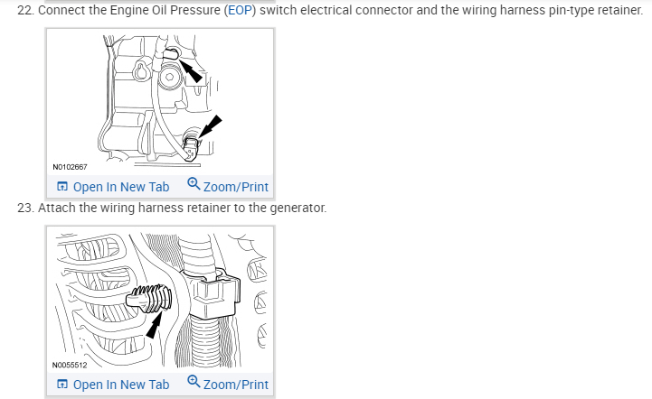

Since you are already into this, I am going to provide the directions for reinstalling the cylinder heads. Interestingly, the manual does one at a time and the directions are extensive, so please don't be overwhelmed when you see them.
Just a note, when you clean gasket surfaces on this engine, don't use something that can cut into the metal.
Also, I just went through the installation for the left cylinder head. When I went to the right side, it is basically the same info, so I'm not going to overwhelm you with that info unless you feel it's needed. The most important parts of the directions below are how to torque the heads and the specs.
If you need help with the timing chain, let me know.
Take care and let me know how things turn out for you or if I can help in any way.

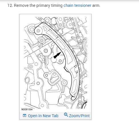

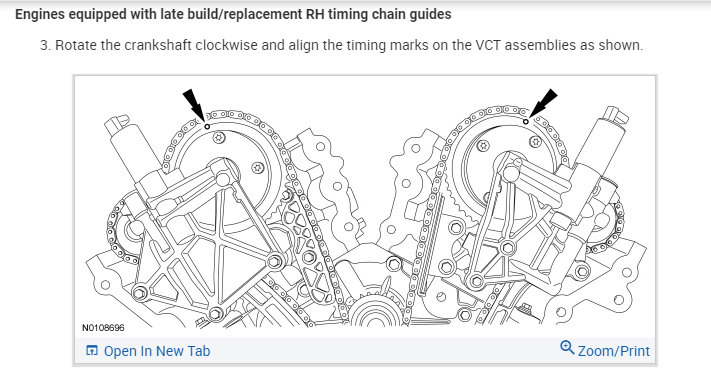

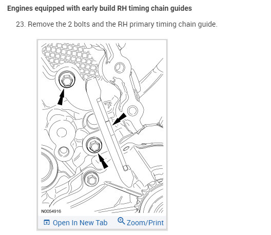

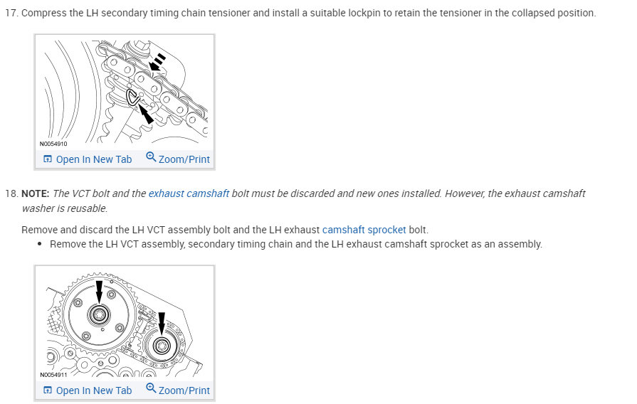

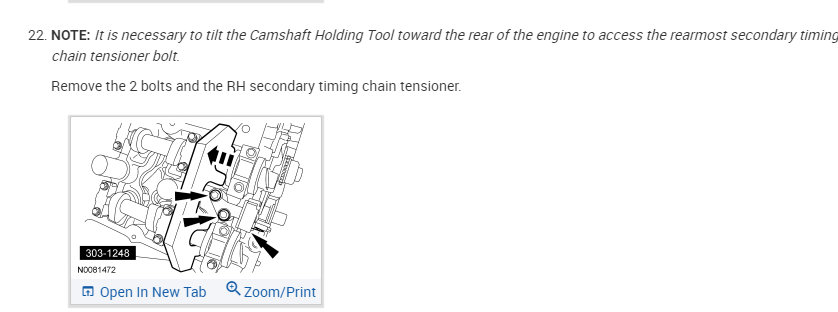

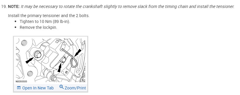

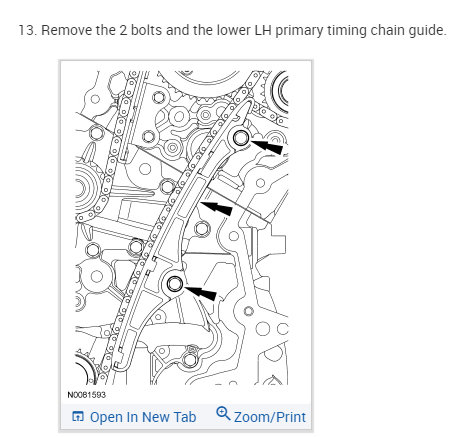

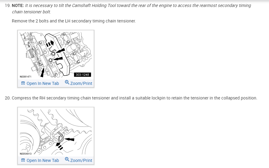

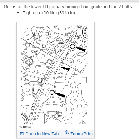

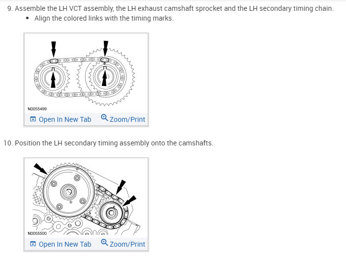

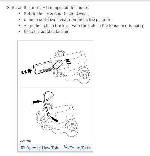

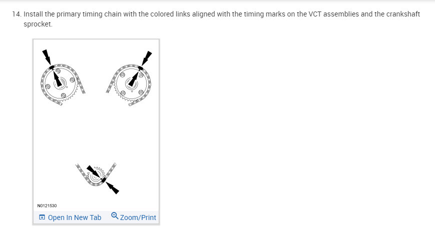

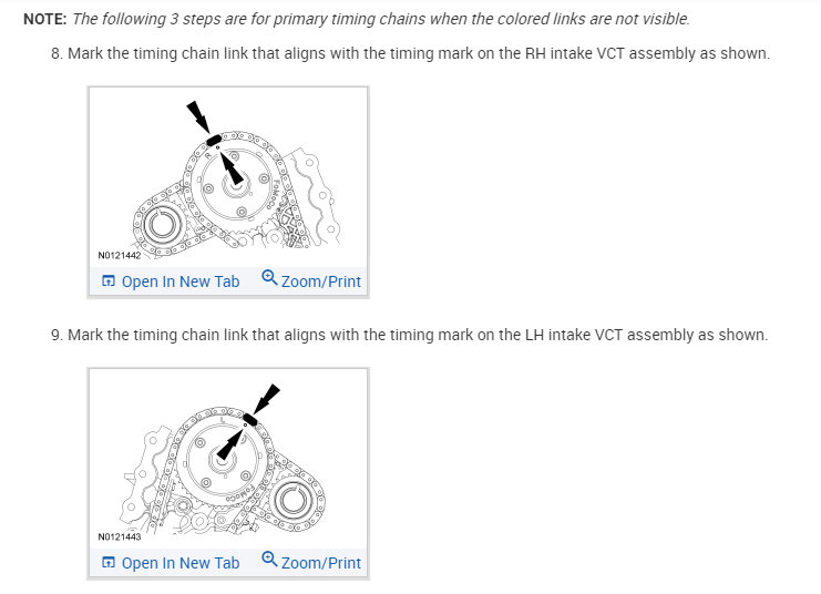

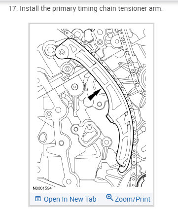

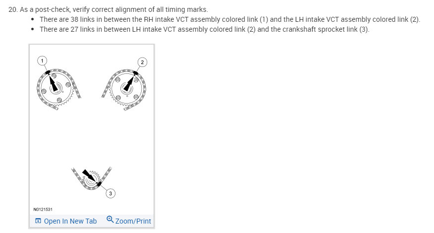

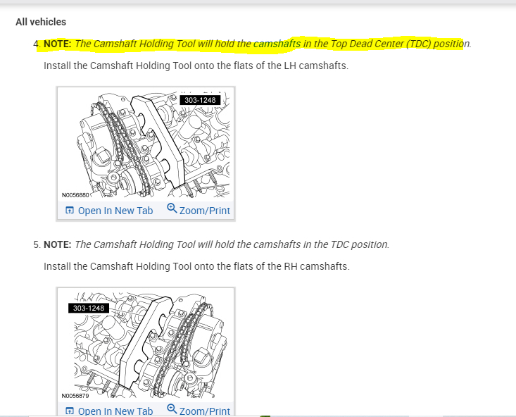

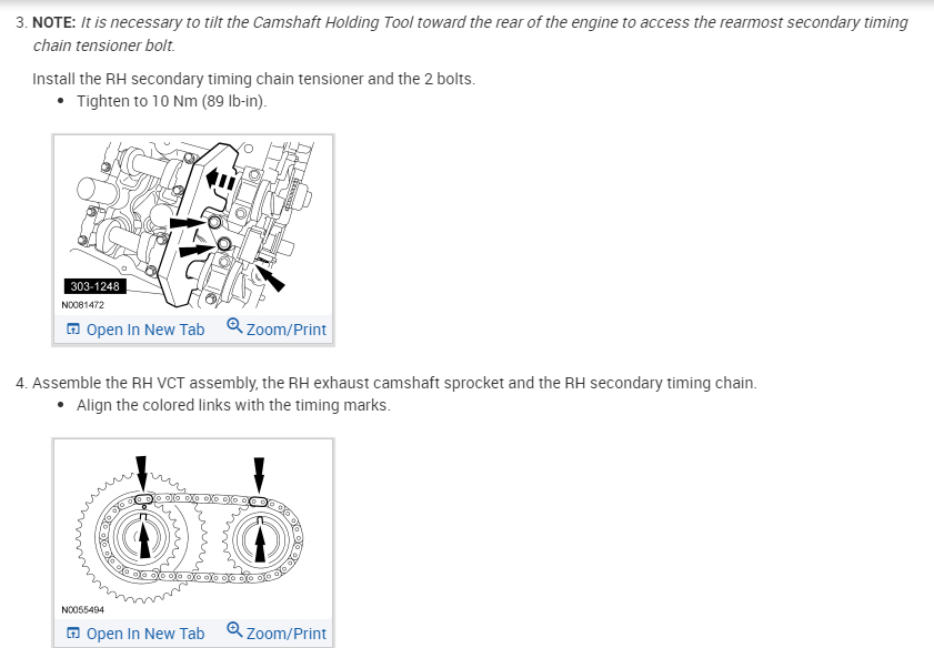

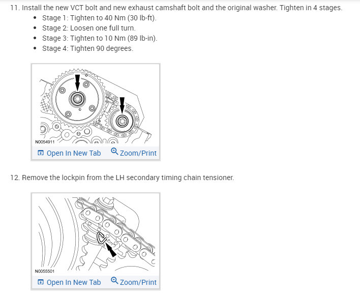

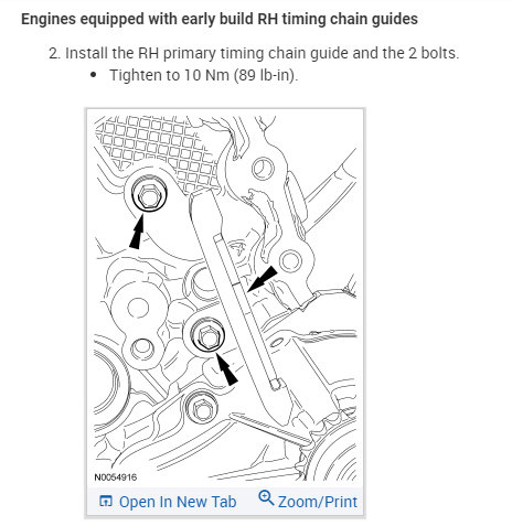

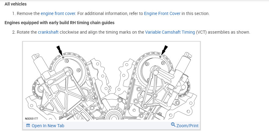

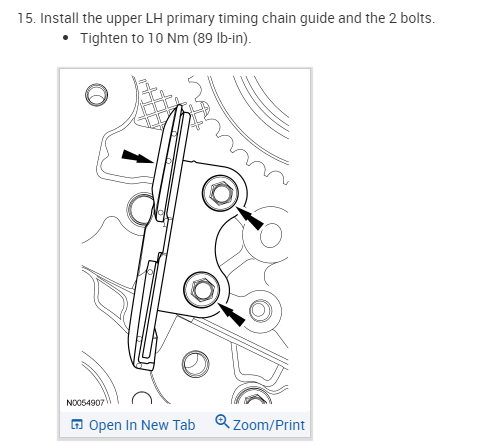

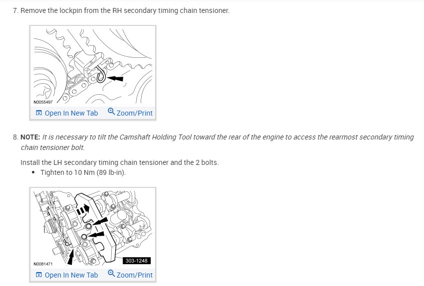

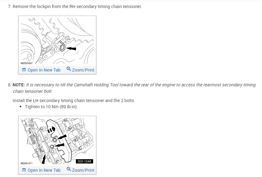

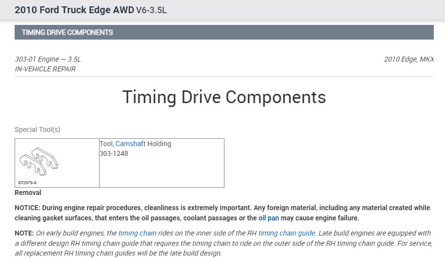

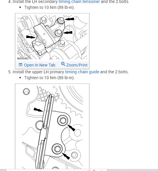

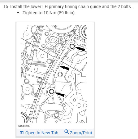

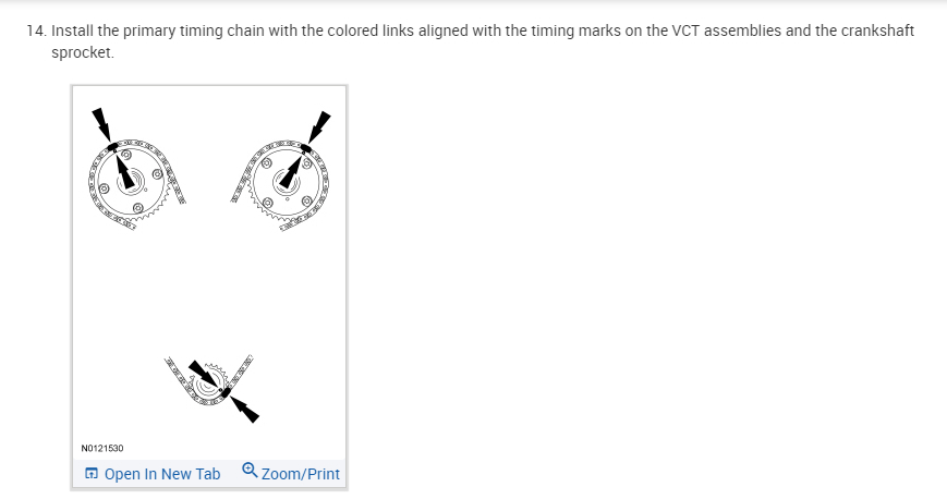

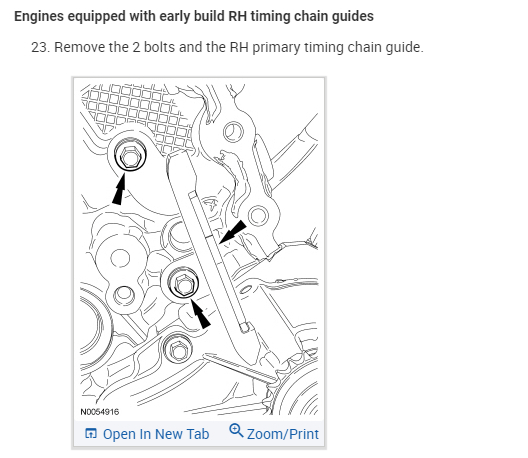

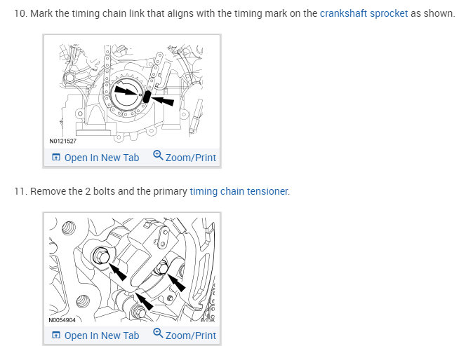

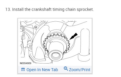

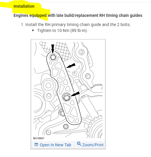

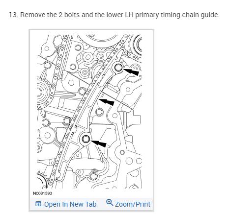

No problem, Aaron. Let me know how things turn out for you. Also, to get the timing chains on correctly will require a camshaft holding tool. Often times a part store will lend one to you.

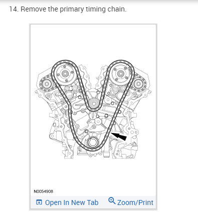

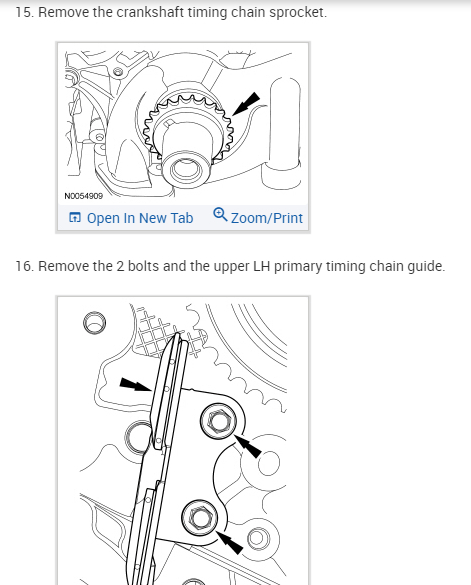

Aaron, I attached the directions for replacing the timing chain. It's a bit involved.
I hope this helps. Let me know if you have questions.
