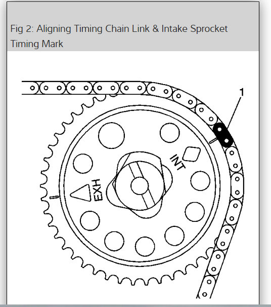

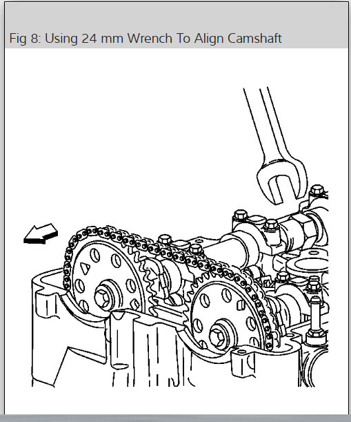

Have a 2.2 ecotec non VVT that is done and I found a 2.2 Ecotec same year, but this is a VVT. what are the possibility's to use the head from the old engine to replace the VVT head or there is a better solution to this? thanks
Apr 8, 2019 at 6:10 AM
SCGRANTURISMO
  • 4,897 POSTS
Yes, this will work. Just to understand, you are basically going to replace the short block in your vehicle. Is this correct?
Thanks,
Alex
2CarPros
Apr 8, 2019 at 10:17 AM
PEPEPANCHO

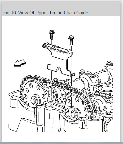

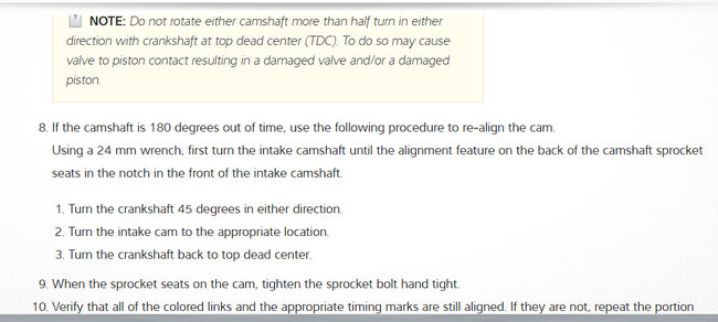

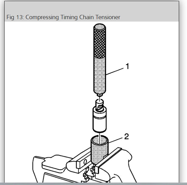

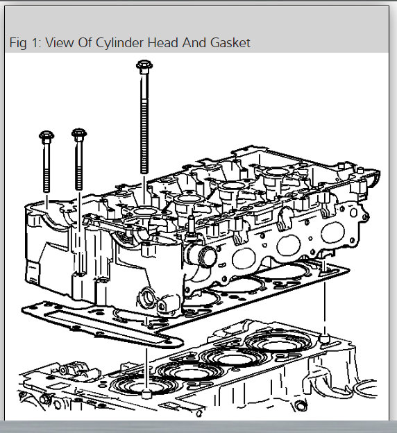

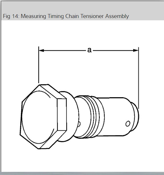

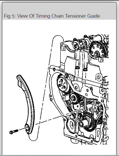

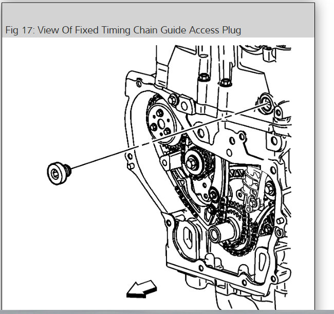

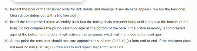

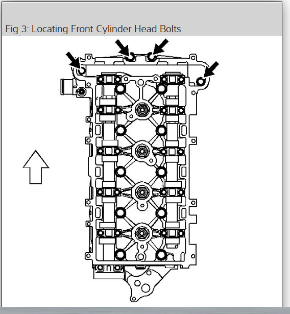

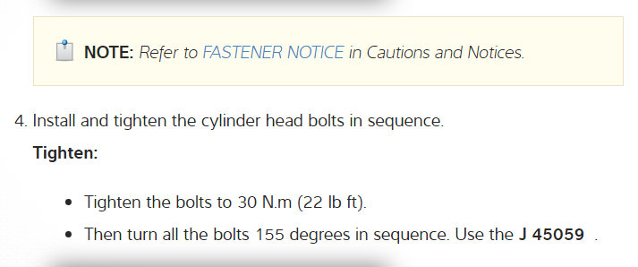

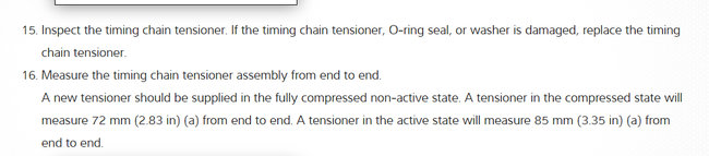

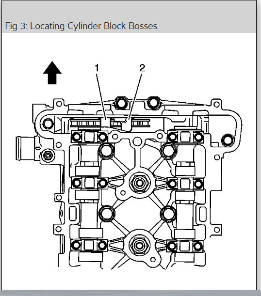

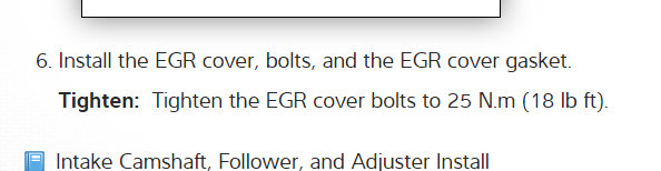

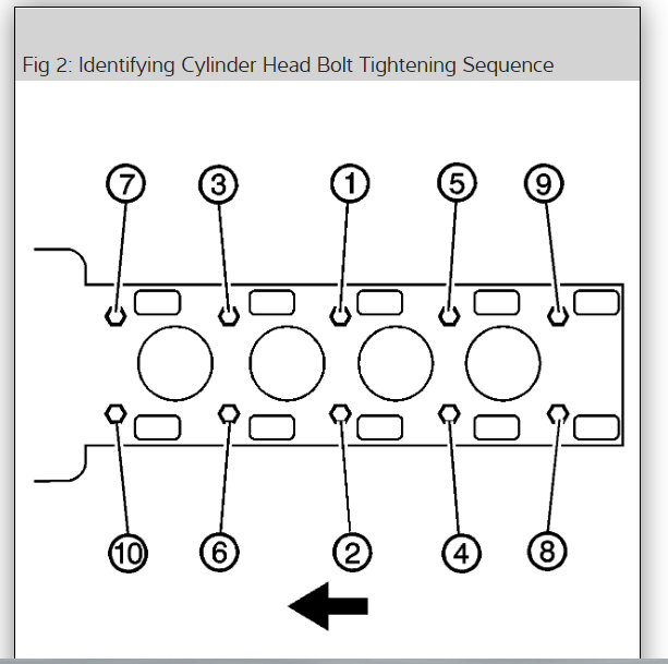

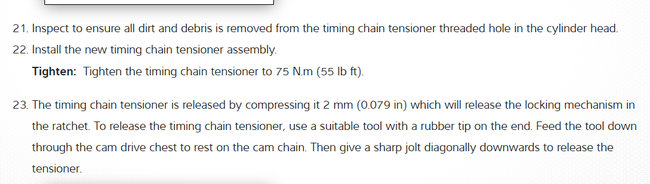

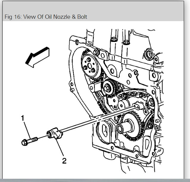

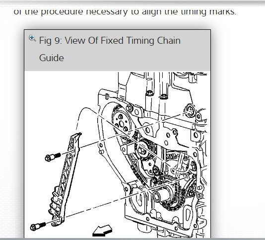

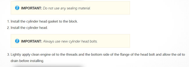

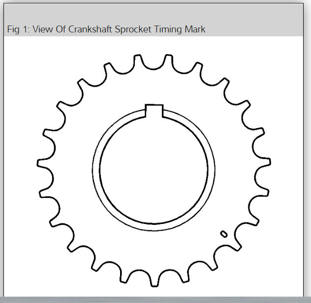

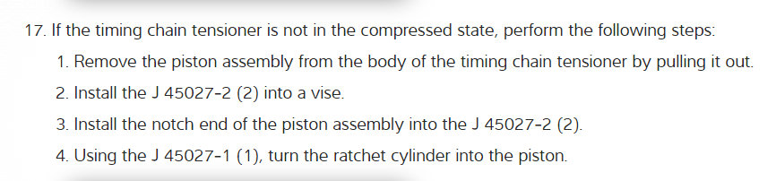

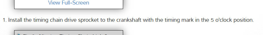

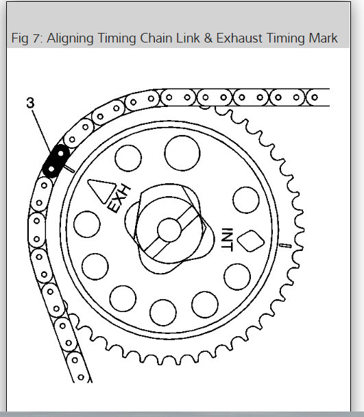

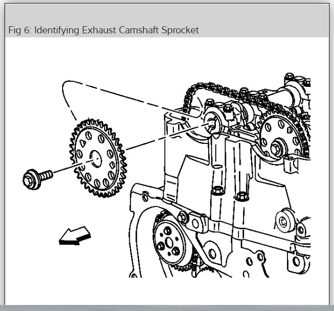

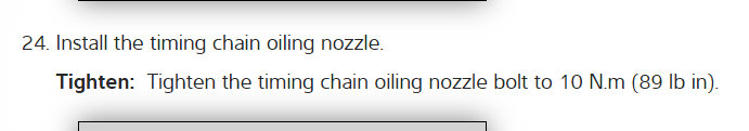

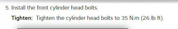

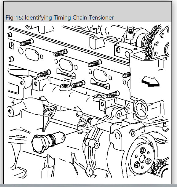

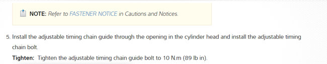

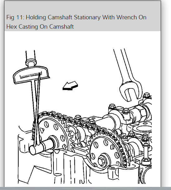

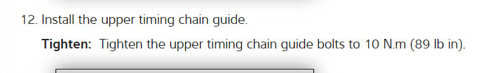

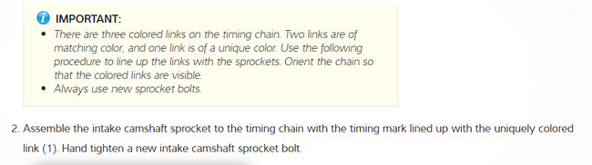

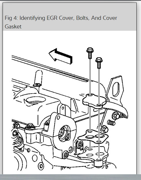

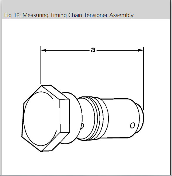

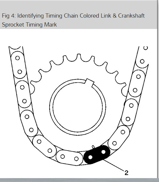

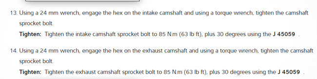

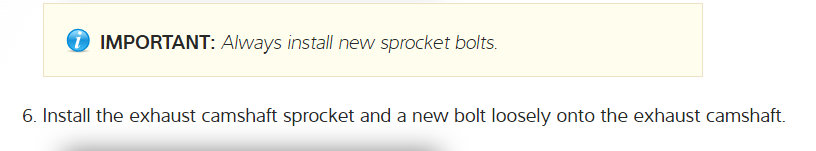

Hey what's up Alex, thank you for your answer and yes that is correct. Will be replacing the short block. one more thing if you can any particular website were I can get sequence,torque. For head and cam bolts as well a timing position please and thank you again.
Apr 8, 2019 at 1:40 PM
SCGRANTURISMO
  • 4,897 POSTS
I have included the information that you requested in the diagrams down below. Please feel free to ask should you have any other automotive questions.
