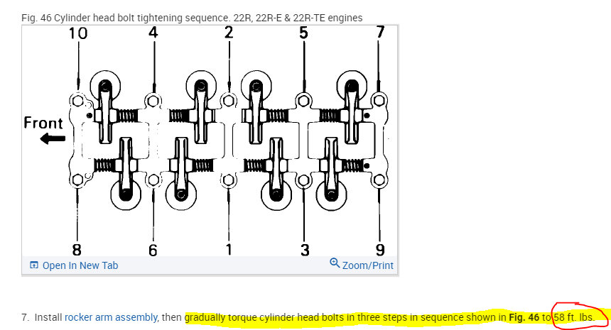

I just don't know how much in/lbs or ft/Lbs I have to apply to it.

When you tighten the bolts, you need to follow a specific sequence. Also, when you tighten them, you do it in three steps.
If you look below, I attached the directions which include the torque specs. Take care and let me know if you have questions.
See pic below.
