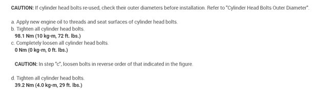

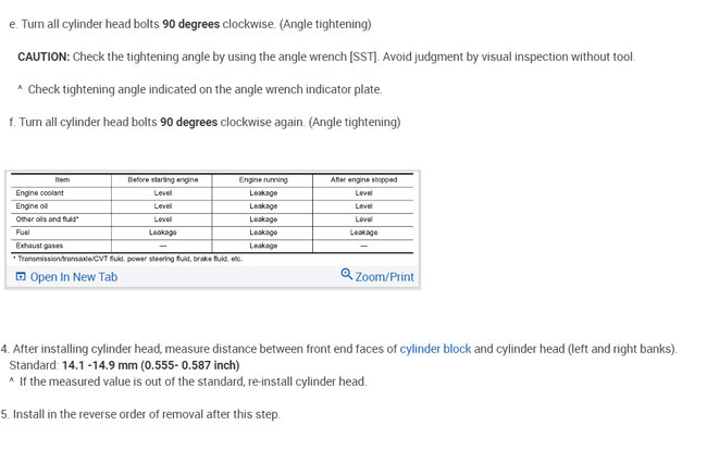

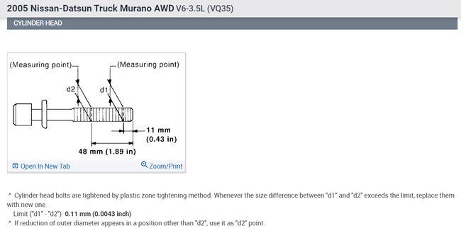

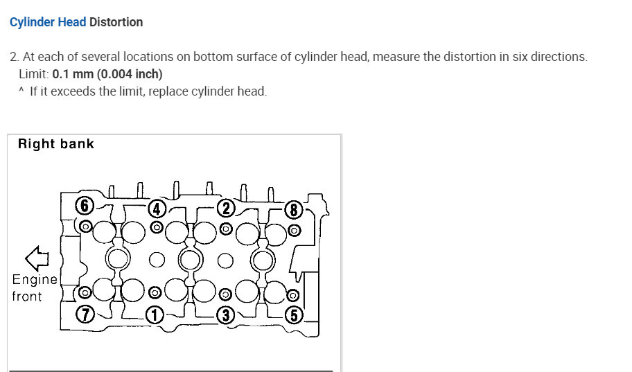

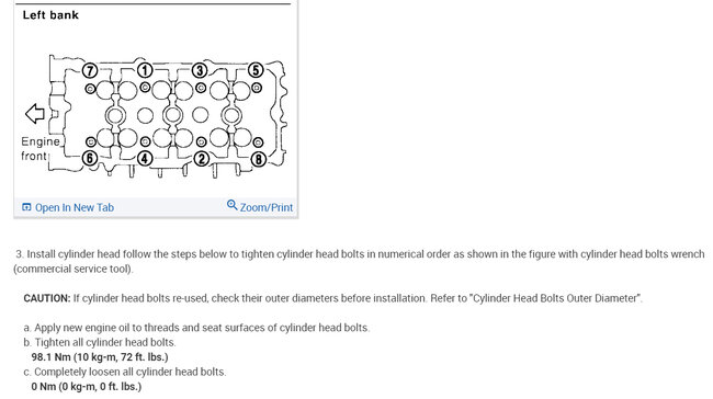

Head bolts torque specs needed?
Oct 2, 2022 at 9:12 PM
Experienced Mechanic
55,628 POSTS
Here is how you need to tighten the cylinder head bolts which you will need an angle torque wrench to do. Check out the images (below). Please let us know if you need anything else to get the problem fixed.
