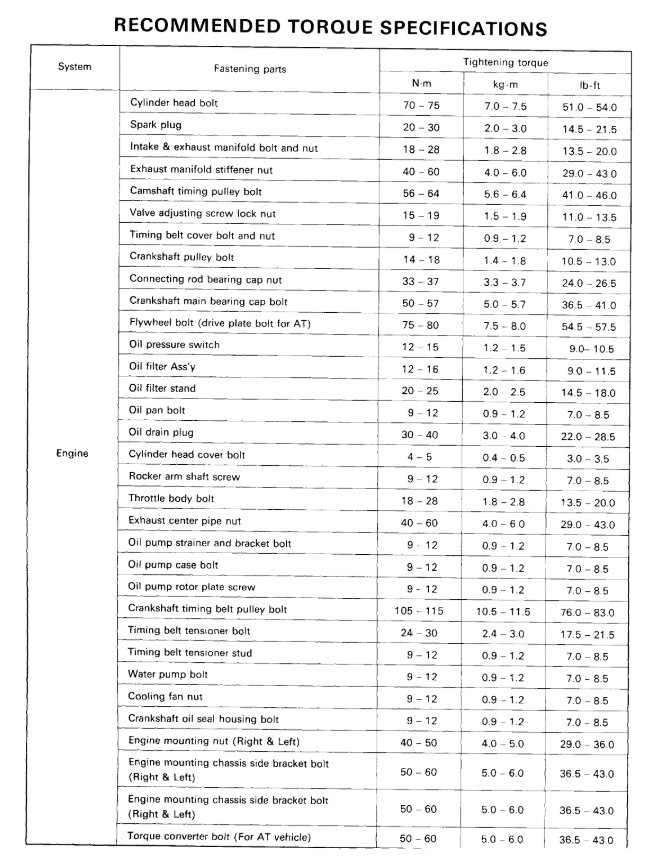

Are new head bolts required when installing new head gasket or just recommended?
Apr 24, 2017 at 2:24 AM
CARADIODOC
Experienced Mechanic
34,414 POSTS

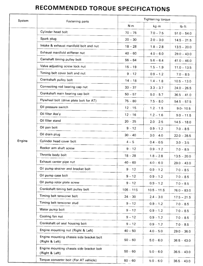

The cylinder head bolt toque is 51 to 54 Foot pounds here is a video that shows how to use a torque wrench with a complete engine torque guide below.
