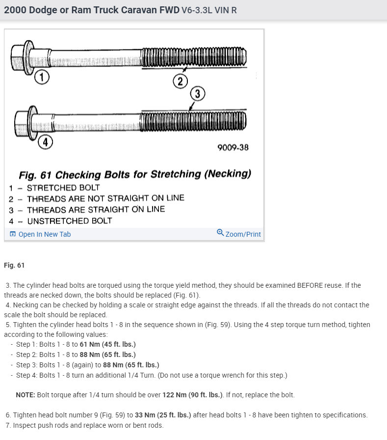

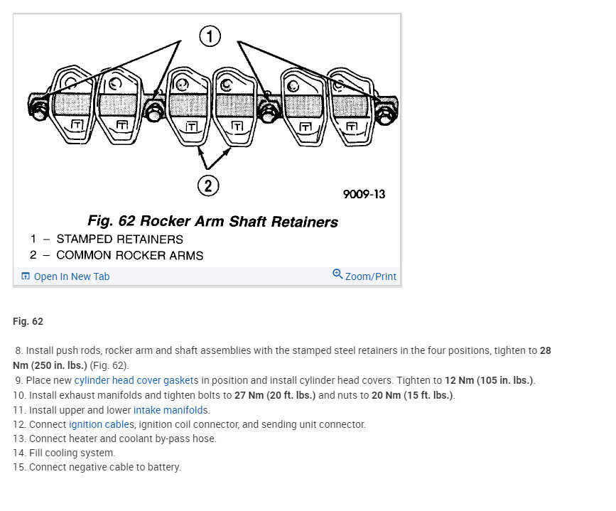

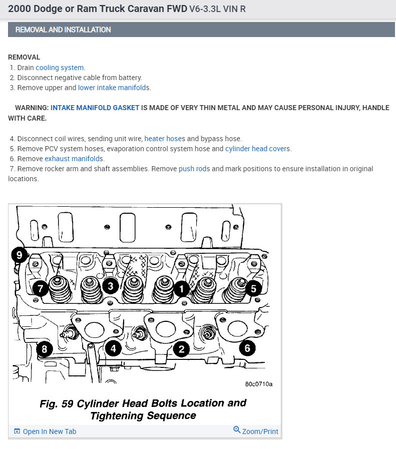

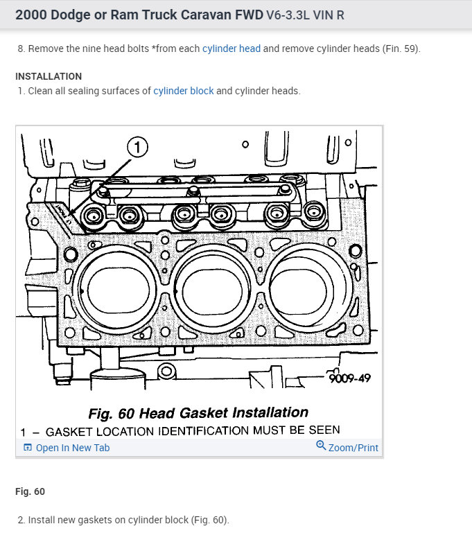

need head torque for the van listed above.

Please see attached for the torque specifications and instruction image #3. Check out the diagrams (Below). Let us know what happens and please upload pictures or videos of the problem.
