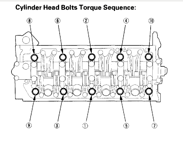

Head bolt tighten specs needed?
2002 HONDA CIVIC
245,000 MILES • 1.7L • 4 CYL • 2WD • MANUAL
JERRY CULWELL
What does the head bolts torq down to and sequence.

Hello Jerry,
Here is the cylinder head bolt tightening torque specs and the tightening sequence as well.
1st step torque: 20 Nm (2.0 kgf-cm, 14 ft. lbs.)
2nd step torque: 49 Nm (5.0 kgf-cm, 36 ft. lbs.)
3rd step torque: 67 Nm (6.8 kgf-cm, 49 ft. lbs.)
Check out the images (below). Let us know if you need anything else.
