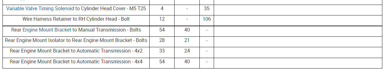

Head bolt specs needed
2012 JEEP WRANGLER
120,000 MILES • V6
ENGINE123

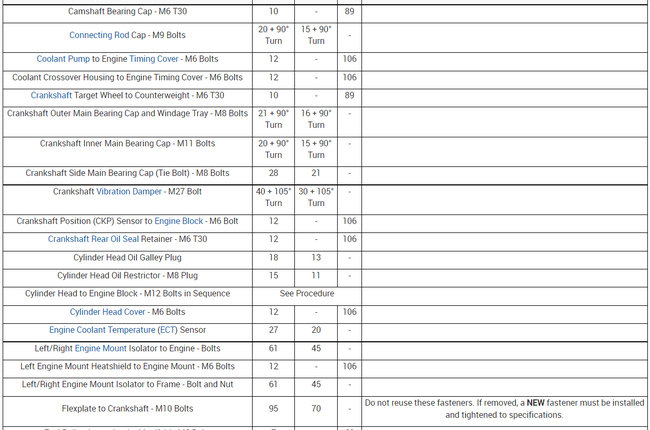

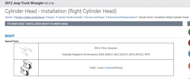

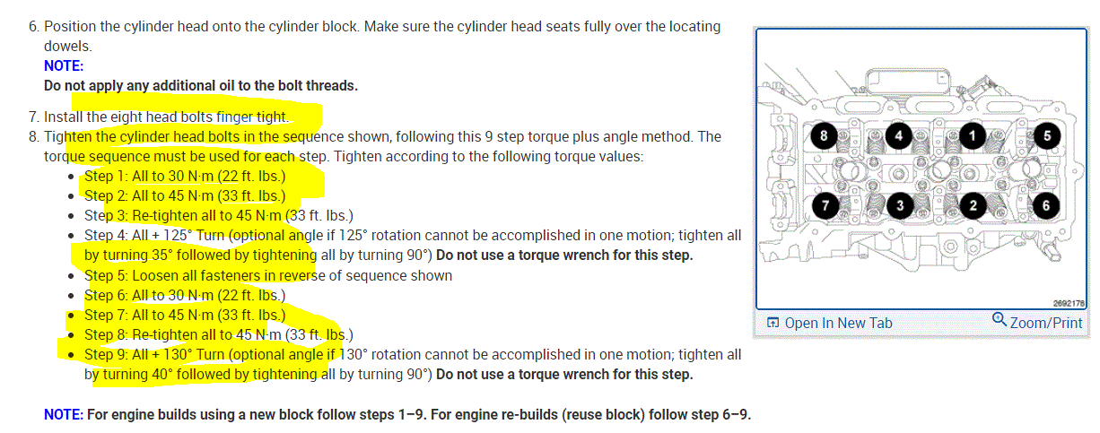

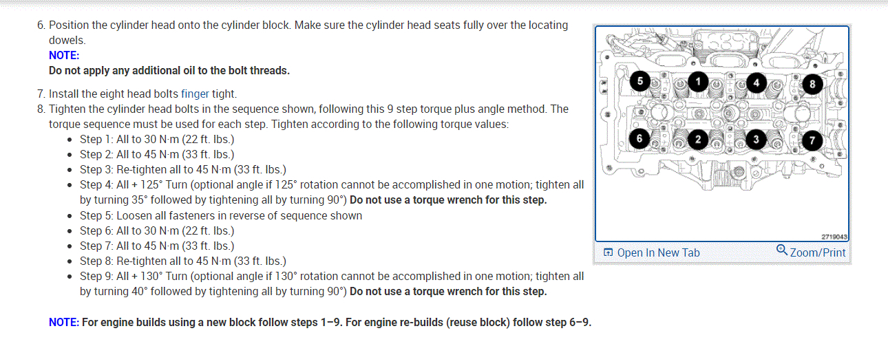

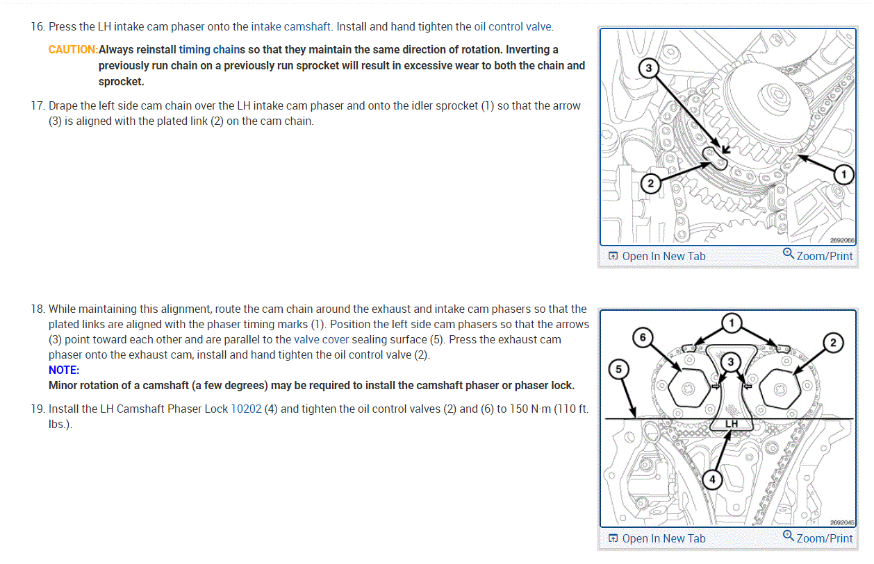

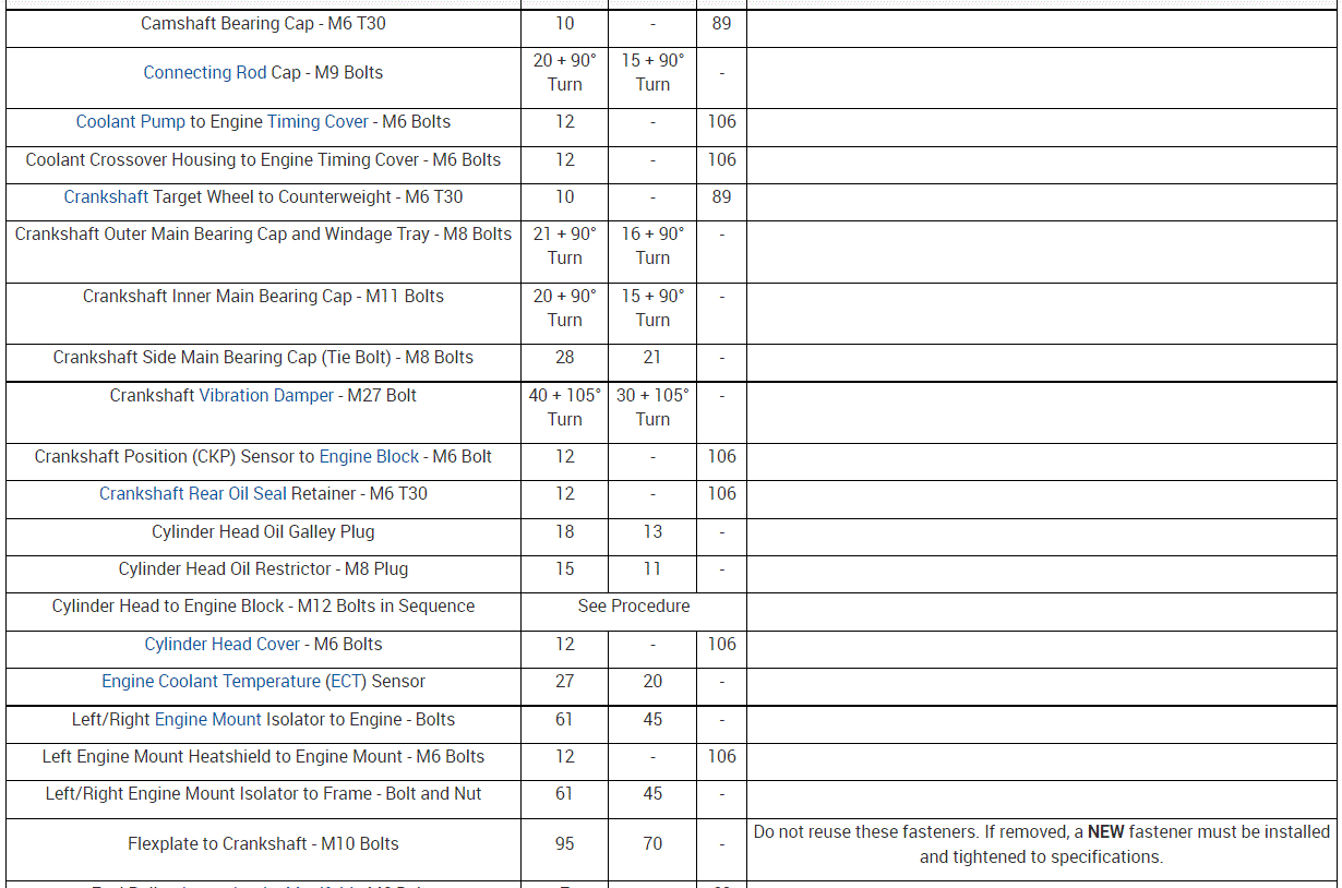

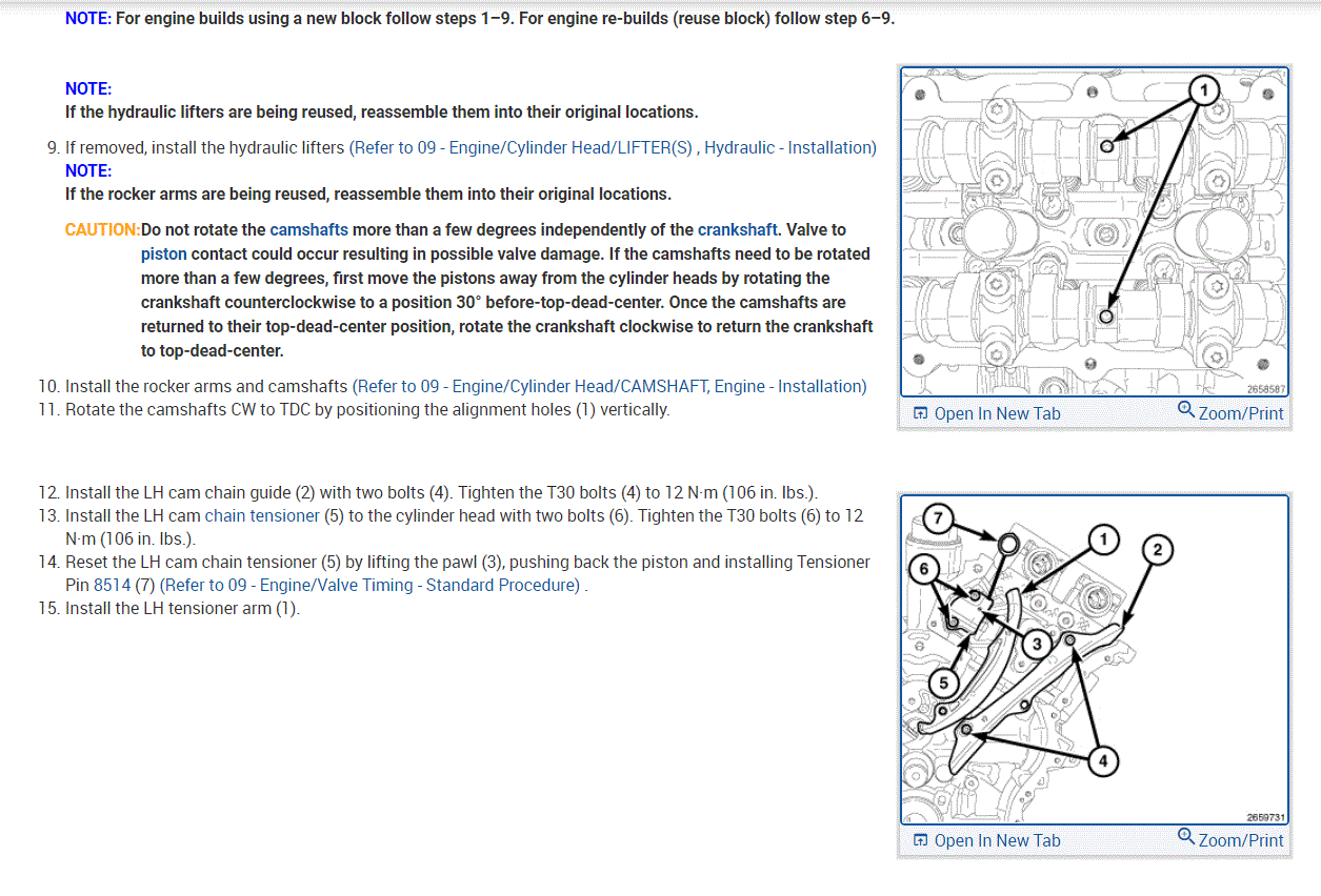

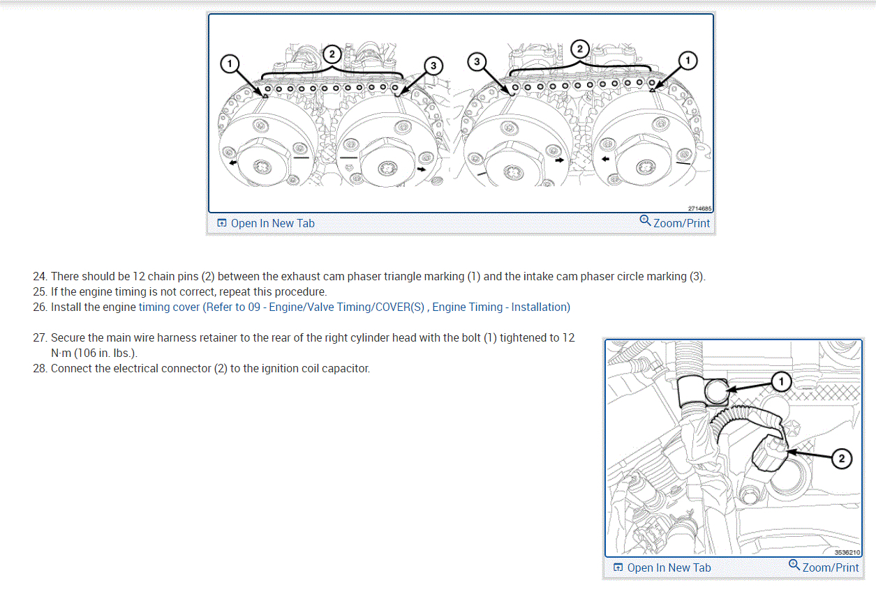

I need head bolt specs for the vehicle listed above 3.6.
Jul 4, 2021 at 11:42 AM
  • 110,240 POSTS

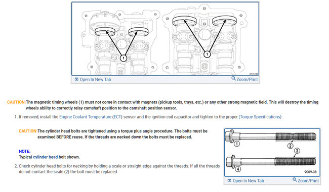

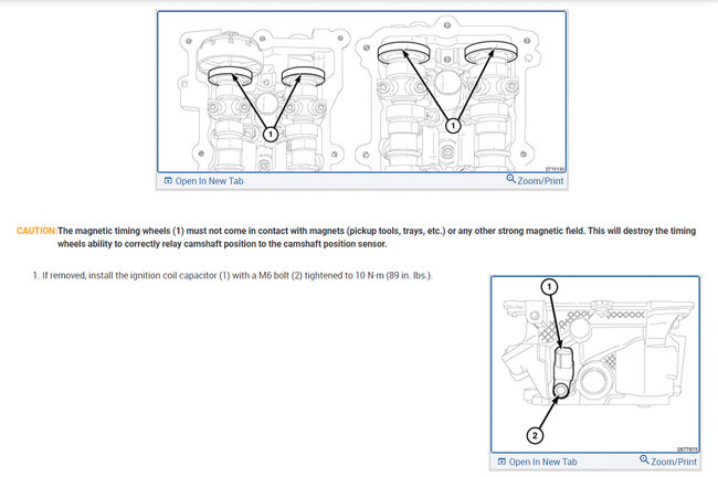

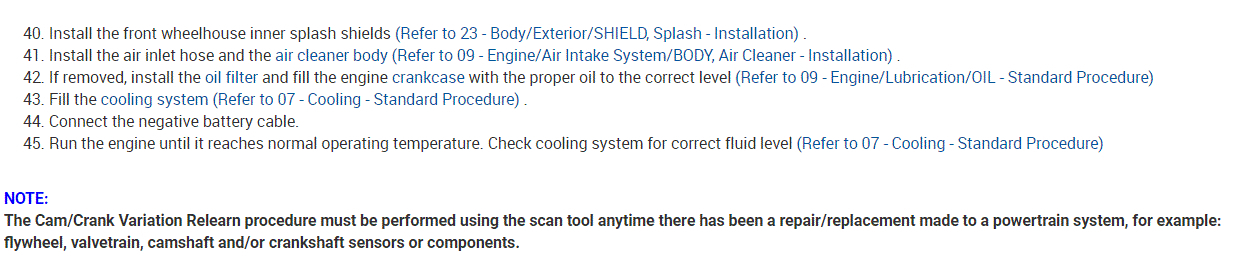

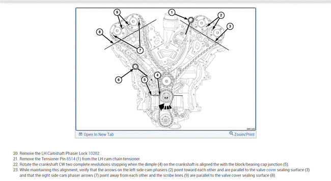

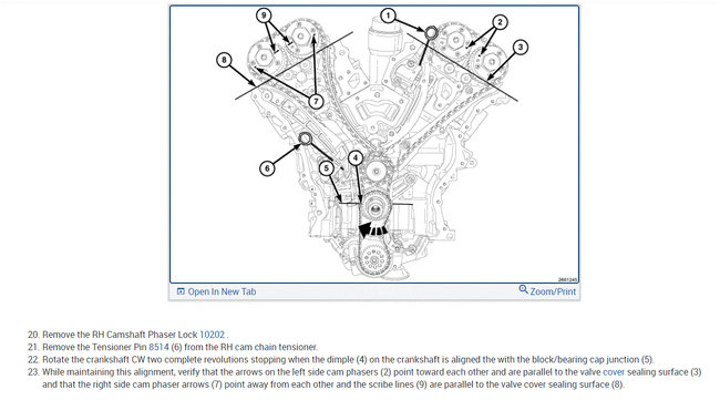

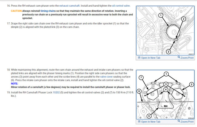

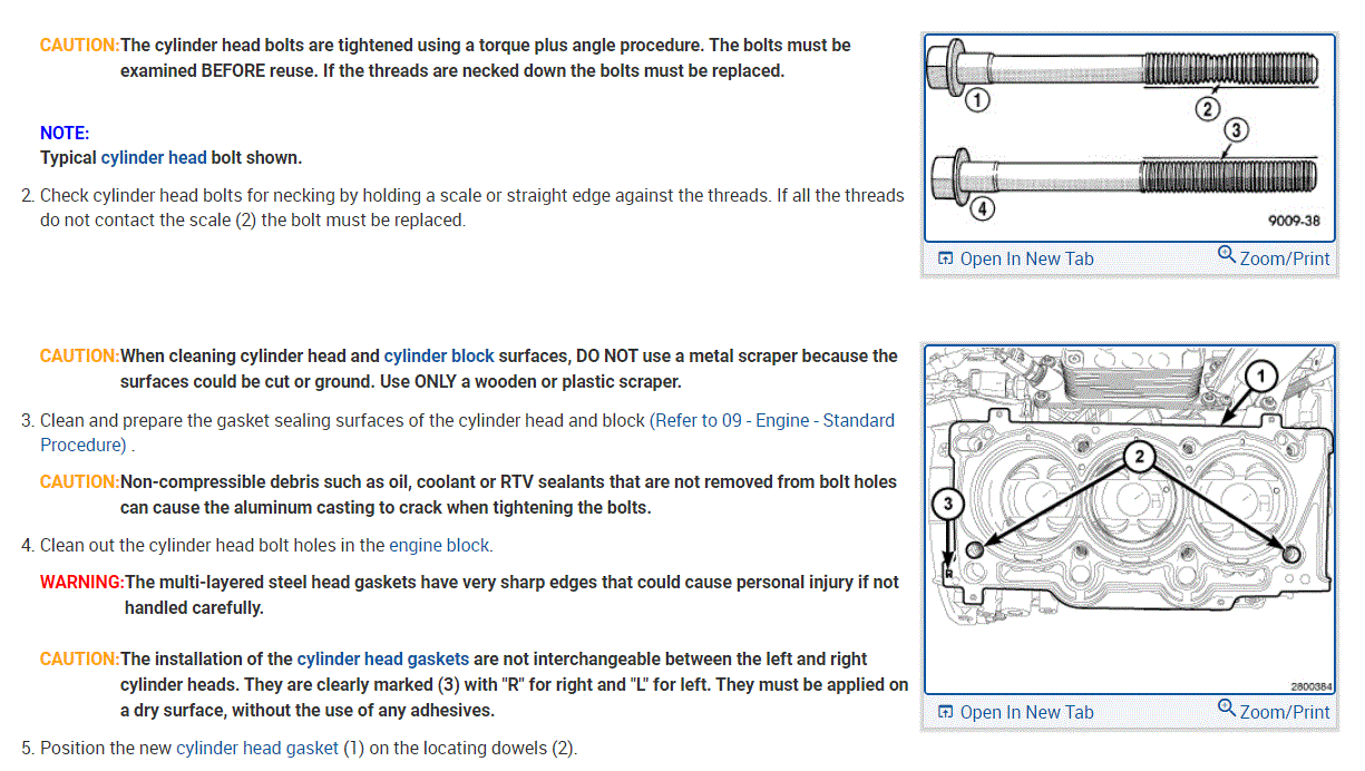

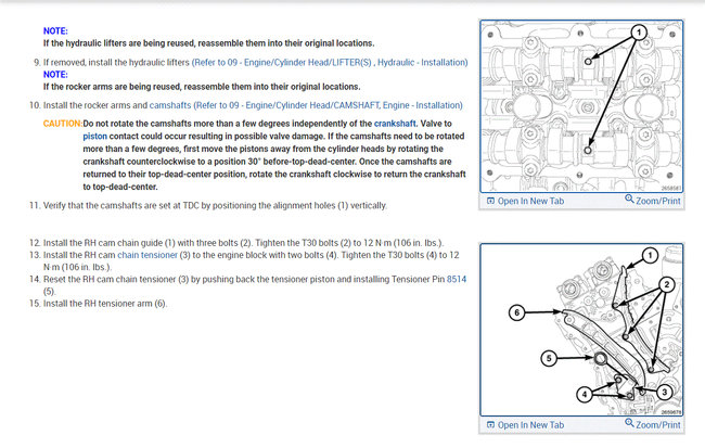

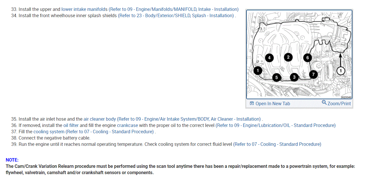

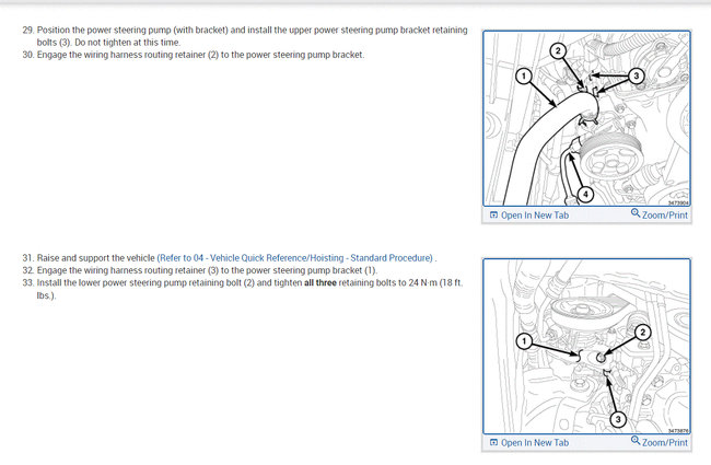

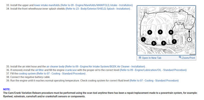

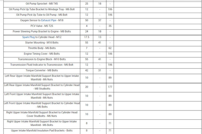

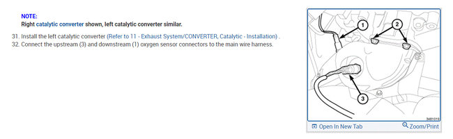

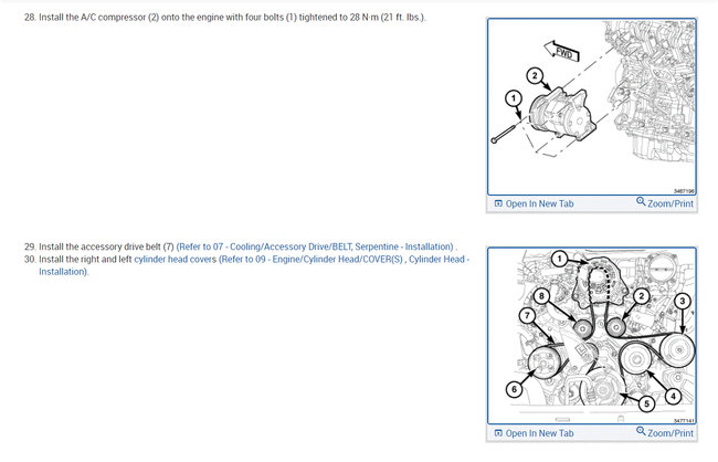

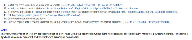

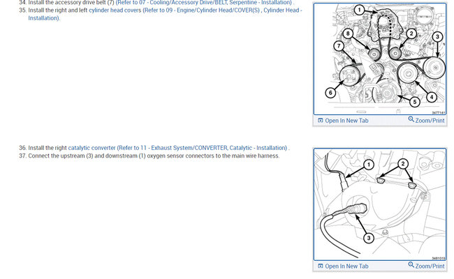

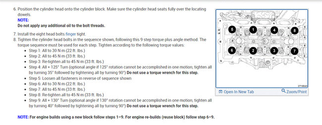

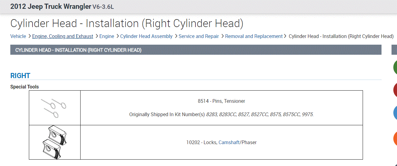

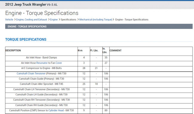

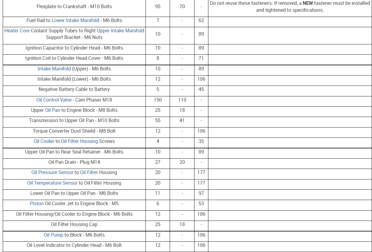

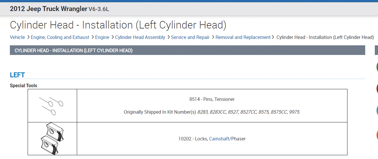

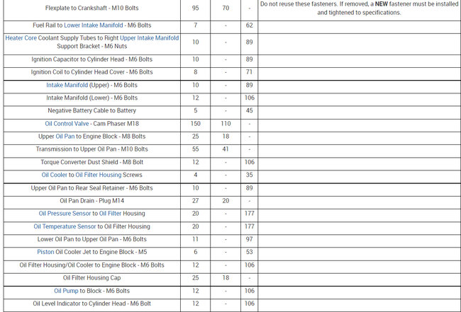

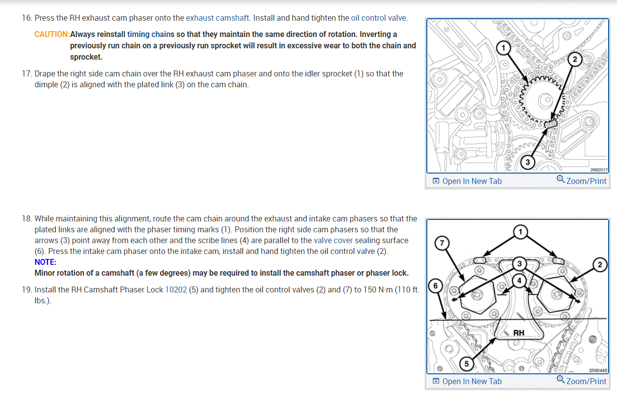

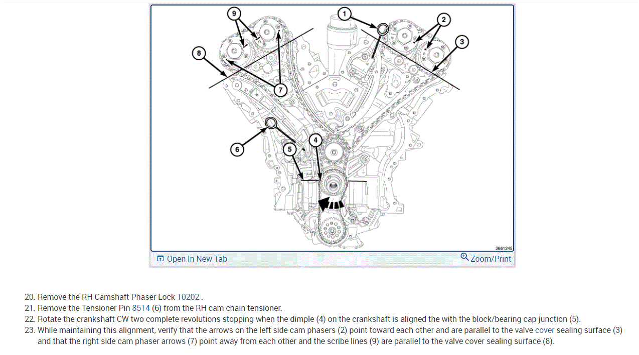

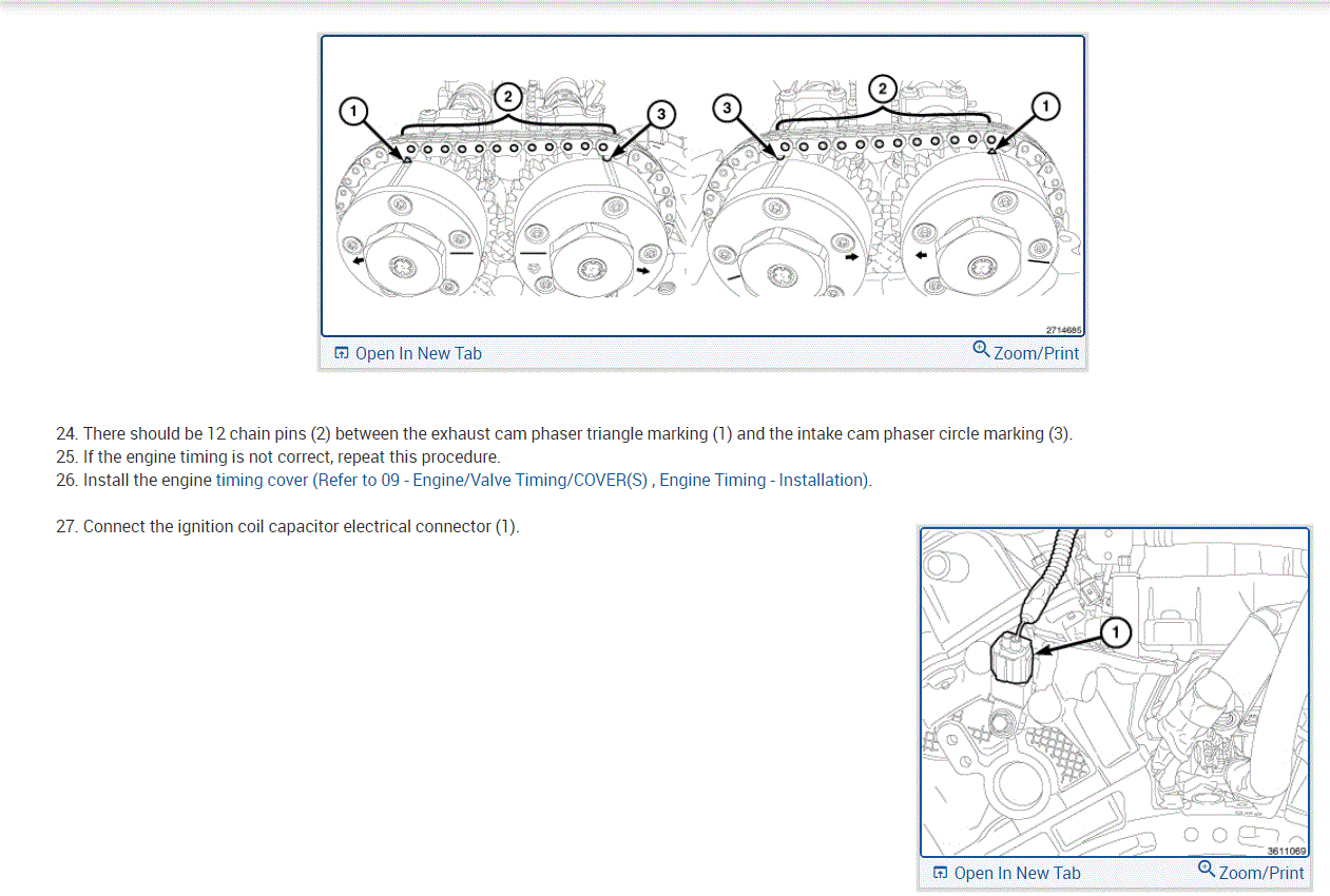

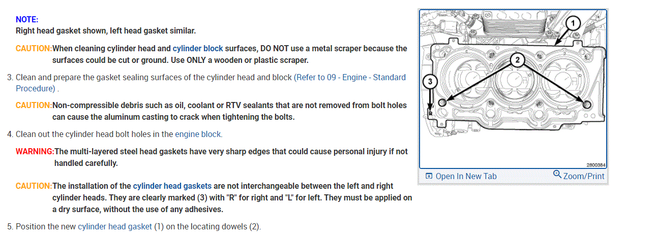

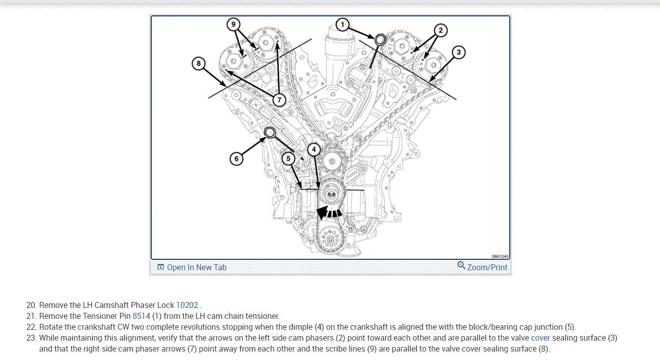

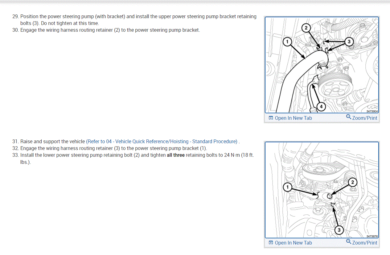

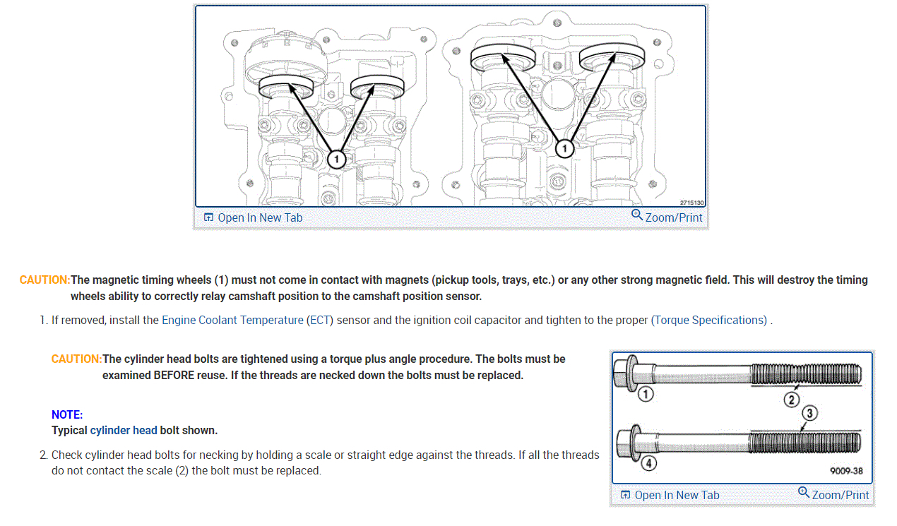

The first five pics below provide the torque specs for everything on the engine. The remaining pics are the directions for installing each cylinder head. Note that the torque specs are included in the directions and require a procedure to perform. There are a few steps.
Also, the directions from the manual are broken down by left and right sides.
