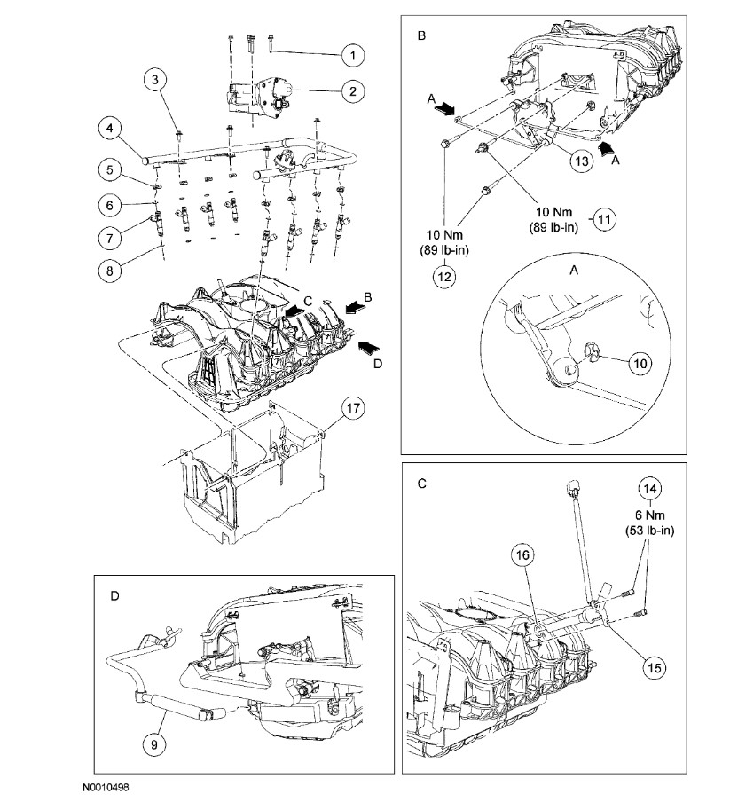

The check engine light on the dashboard has been on for a while. From the diagnostics done, it shows that one of the intake manifold valves is permanently open. My question is which part needs to be replaced?

What is the actual code that you found? That system uses a single motor that moves linkage under the cover to move the valves and the common issue is that the valve breaks.

Okay, that code shows that the actuator valve controller is stuck or the sensor is faulty. Testing it with a scan tool is easy as you can activate it and watch the valves move.
Because it's a Ford you might want to download a copy of the windows version of FORScan and buy the better dongle. With the extended license you can do as much with that tool as the factory scan tool.
However, for the DIY it can be easier to just swap the actuator as the test. To do that you remove the intake manifold and replace the actuator.
The torque specs are in the first image..
