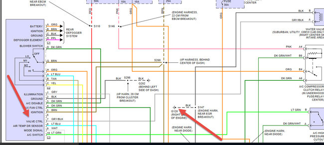

The heater control valve is not opening. There is no vacuum to it. There is vacuum to the HCV solenoid. The solenoid has ground but not power. I do not know which wire in the climate control unit in the dash should feed this, nor do I know if it is a direct feed, or if it goes somewhere else first. Fuse 12 is good. Suggestions and a good wiring diagram would be appreciated. Thank you.

are you sure this is a 1999 as it does not show any water valves or solenoids. has to be an earlier year as we do not show it on diagrams.

Yes, this is a 1999. my understanding is that there were two models that year (mid year split) and that this is the early half. I suspect that it would be the same as a 1998 model.

okay I found it , only on certain models I sent diagram. we do not have a vacuum diagram for it though. the gray wire is power to valve and black to ground on head. see picture. it may be a bad control but have you scanned it for codes?

I do not have any codes. The gray/black wire coming from the control unit does not have power on it. The original control unit did not have power on that circuit either, which is why I picked one up at the salvage yard. If it is a problem in the control unit, I suppose both could have the same problem.
