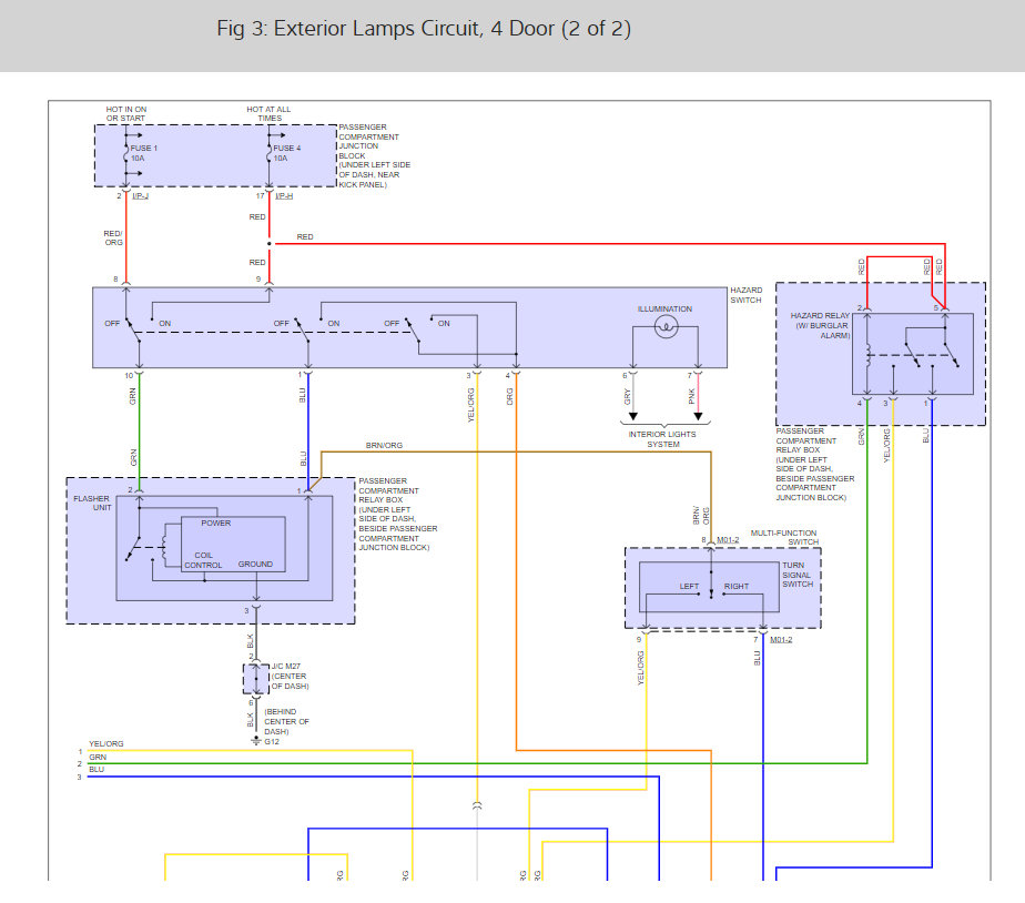

I checked the fuse and relays everything works. when I turn my left and right turn signal it does nothing. I press my hazard button it lights up on dash and works outside of car but if I use the signal itself it wont show in dash or outside of car. help?
Apr 17, 2019 at 10:37 AM
  • 55,797 POSTS

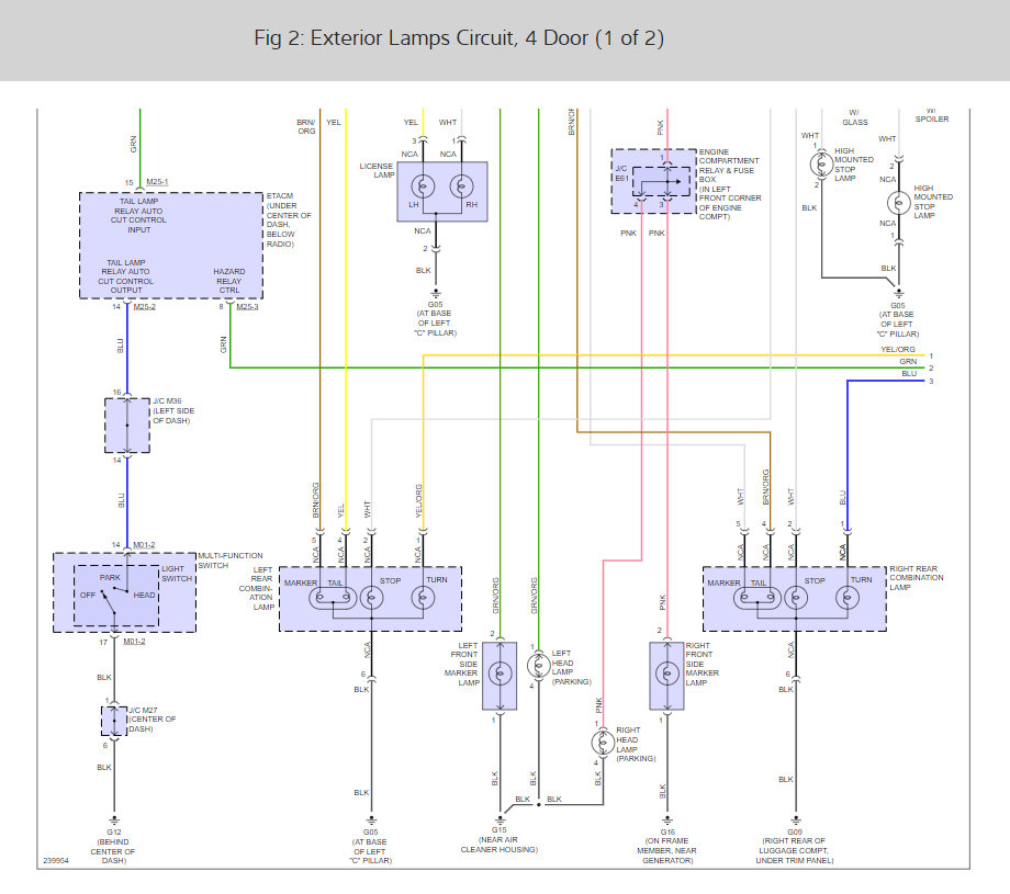

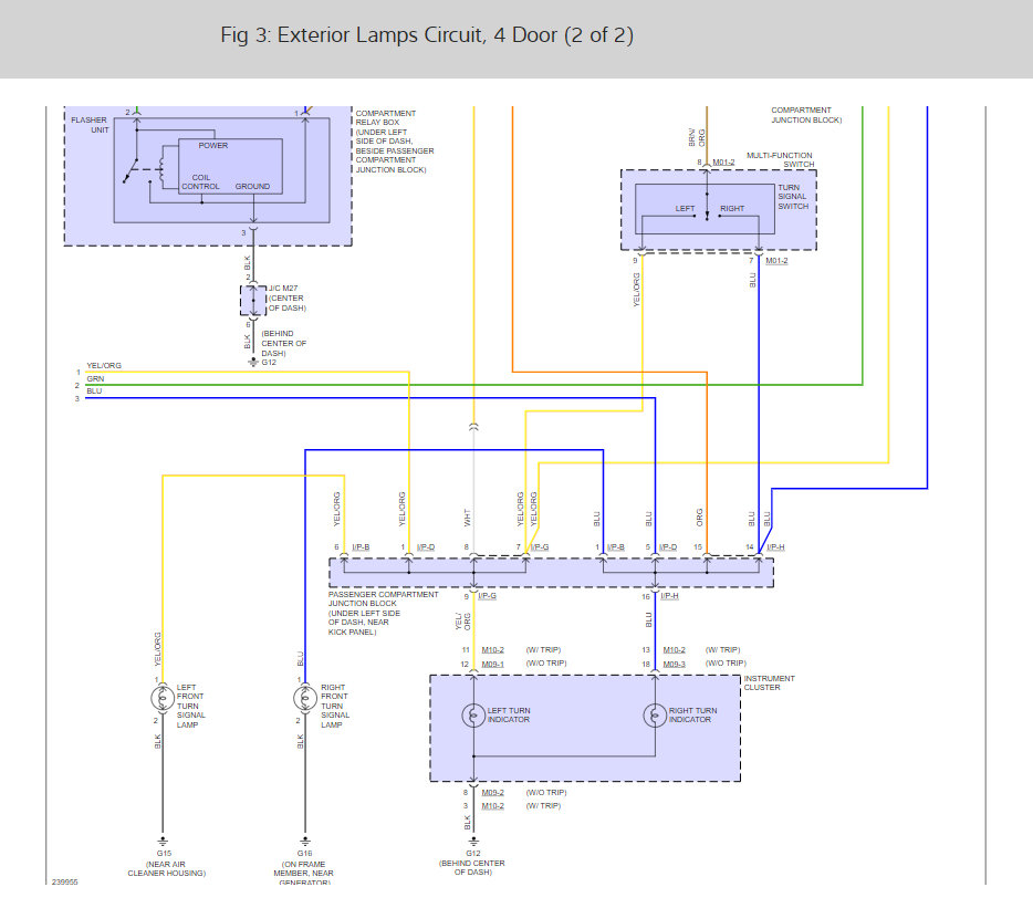

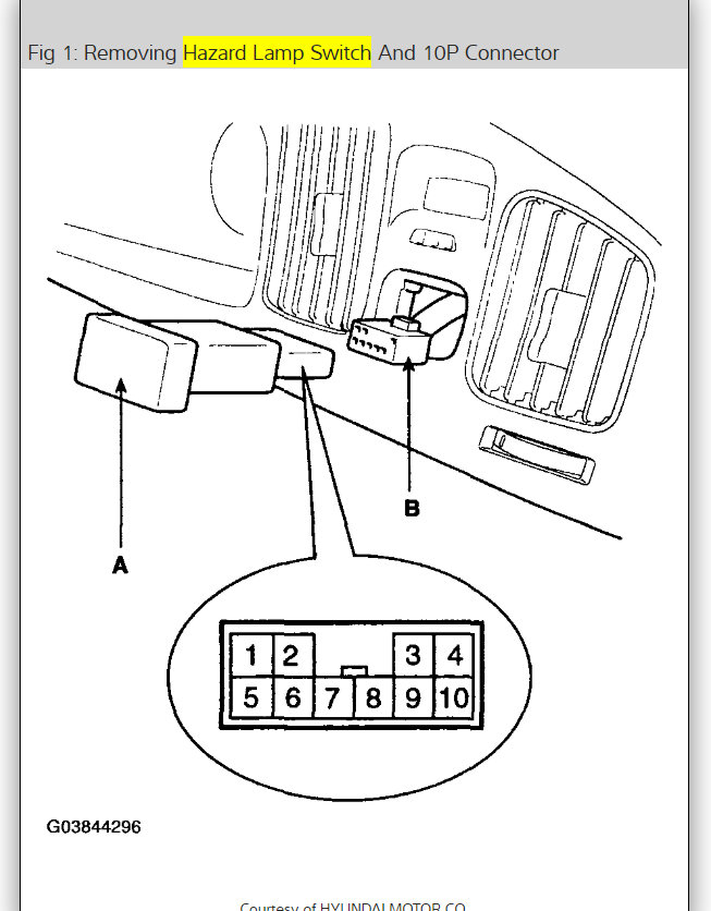

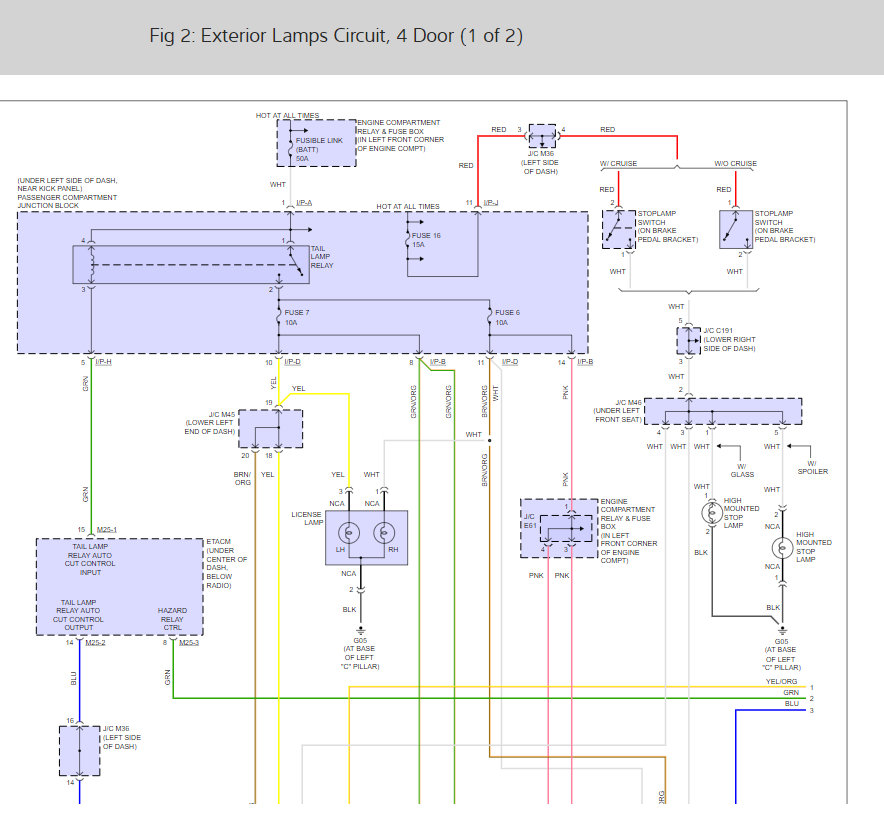

It sounds like the flasher unit has gone bad. To be sure here is a guide to help check for power and the blinker wiring diagrams so you can see how the system works with the flasher location as well below:
Apr 19, 2019 at 5:01 AM
DSAPIENZA94
Bought whole new flasher turn signal for Inside the car didn't fix the issue. maybe the multi-turn signal flasher unit?
Apr 19, 2019 at 6:29 AM
  • 55,797 POSTS
Lets check the system grounds and power supply use the wiring diagrams about and this guide to help check the connections.
