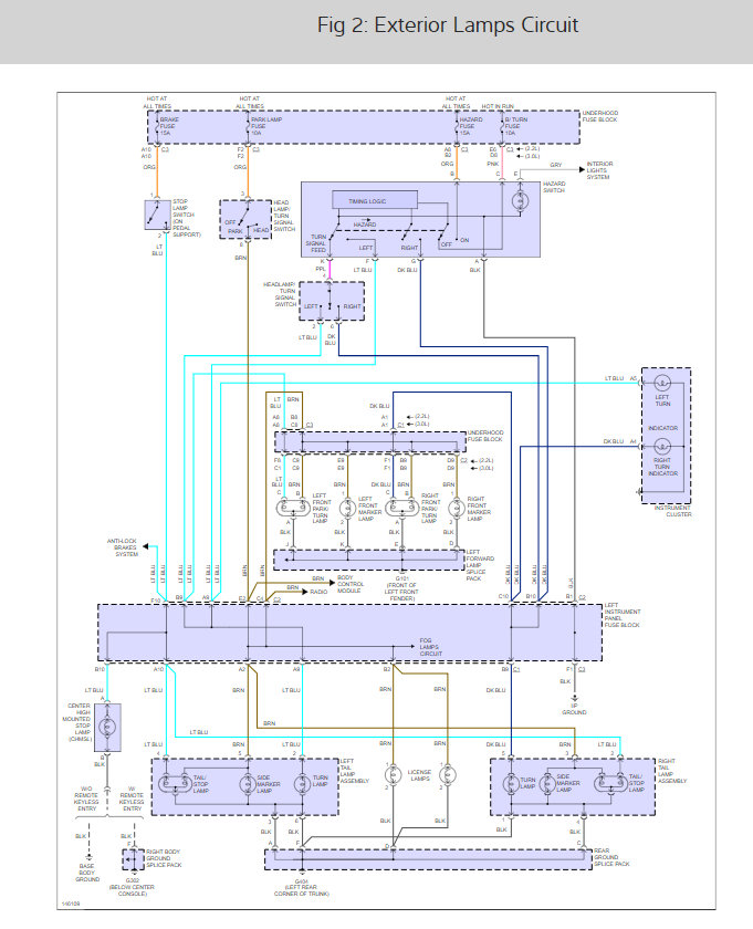

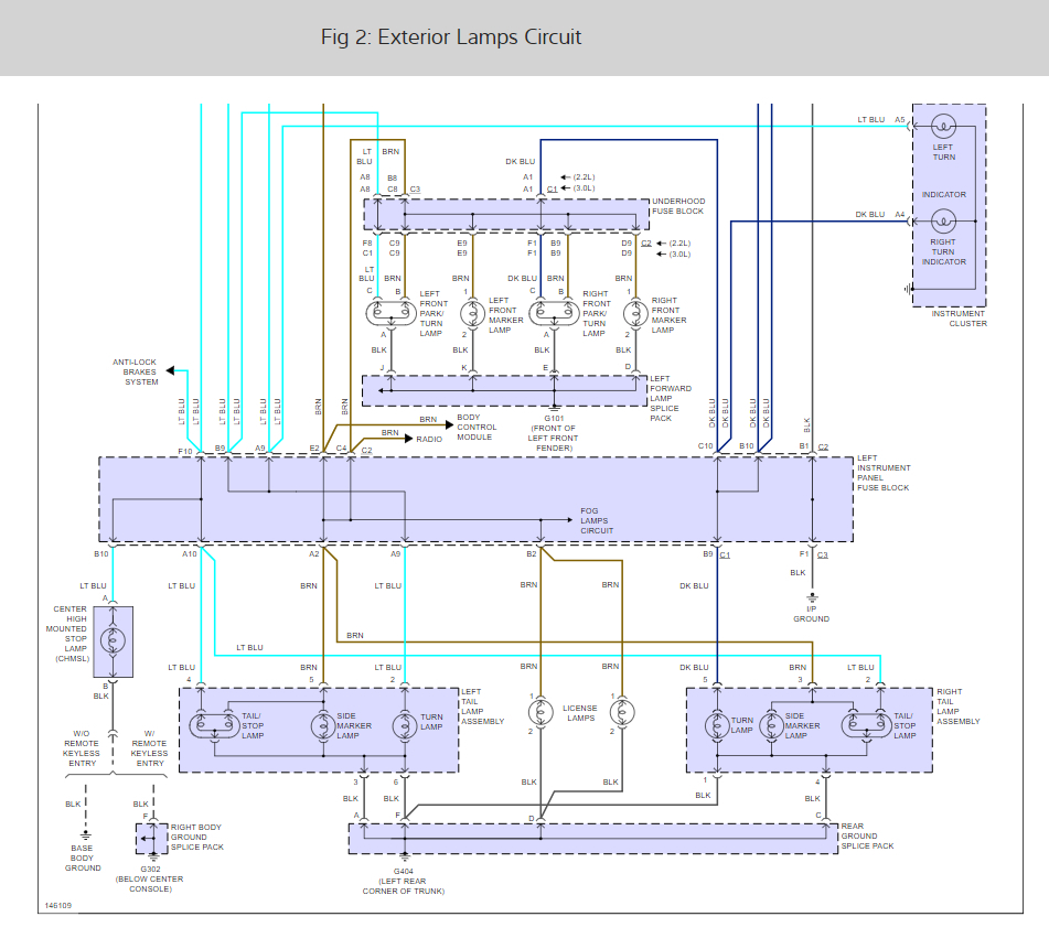

My turn signals work fine but when I turn hazards on I get nothing. Replaced switch and still same problem. Any suggestions?

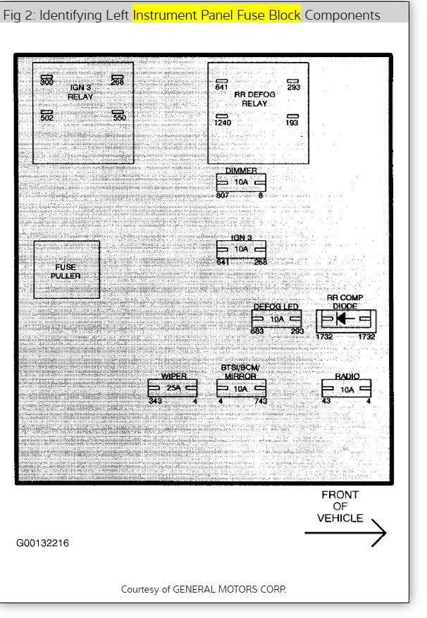

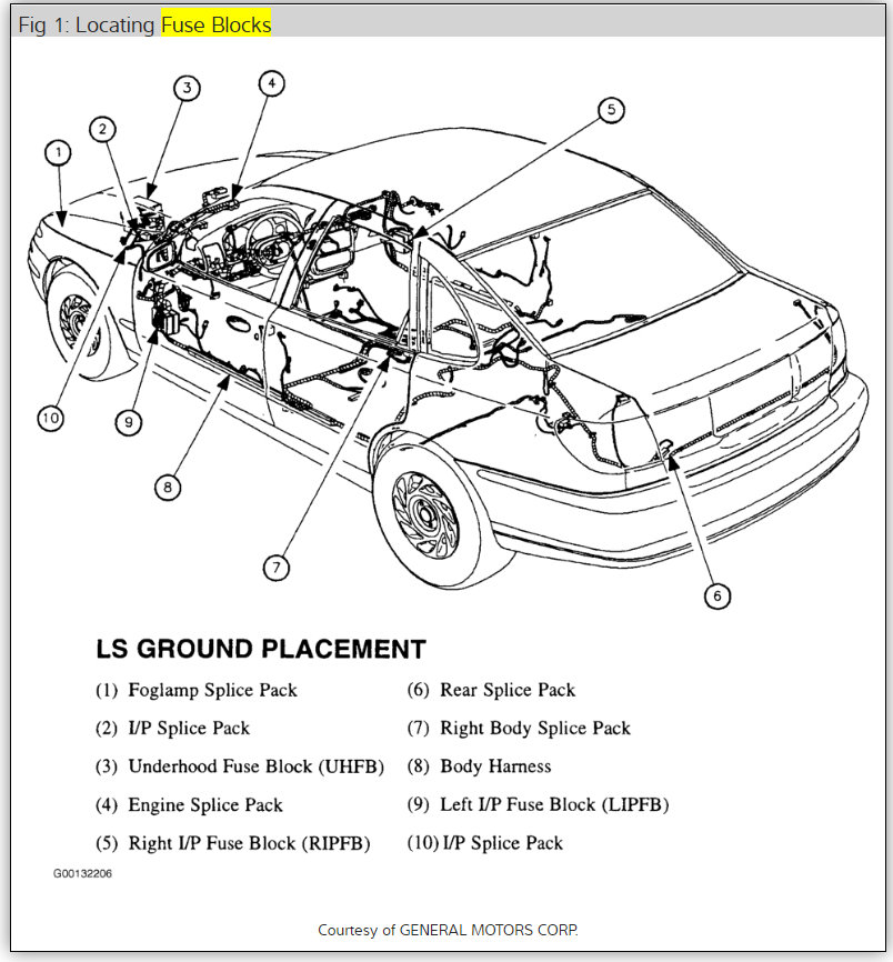

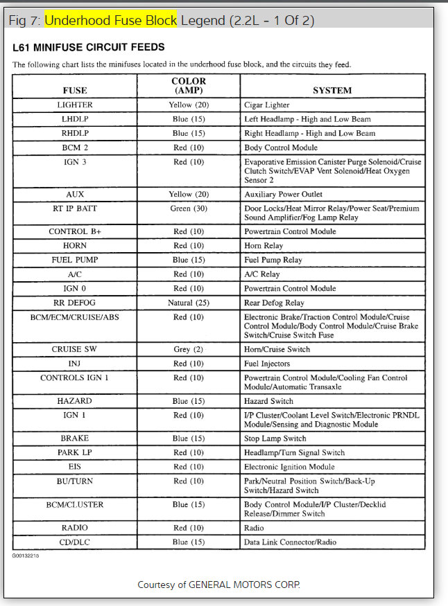

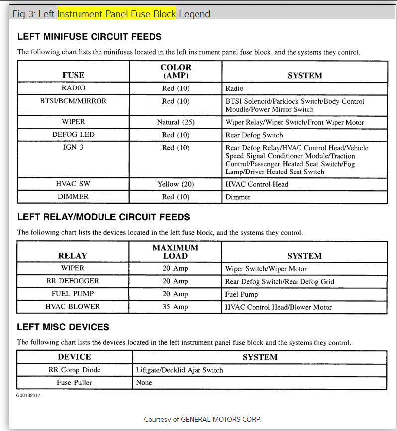

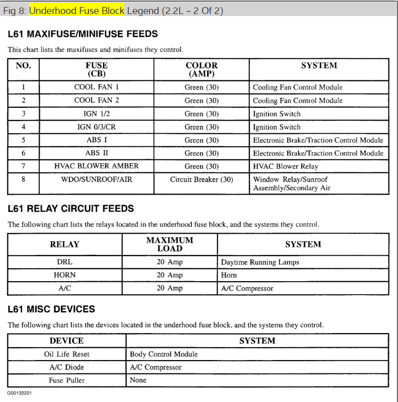

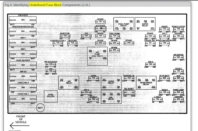

There is a hazard fuse in the under hood fuse panel I would check first. Here is a guide to help you:

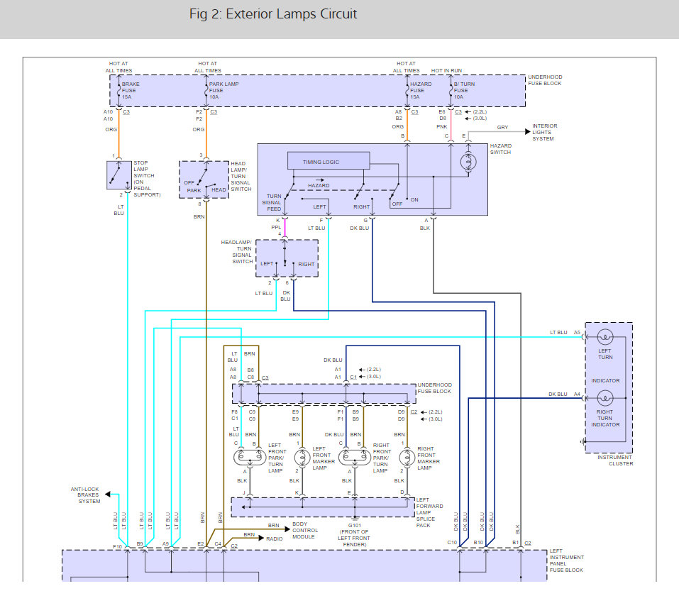

Here is the fuse panel locations and the wiring diagram so you can see how the system works. Check out the diagrams (below). Please let us know what happens.

Appreciate the reply. All fuse are good. I have inspected all wires from switch harness to fuse box. I have replaced switch with new one.
Here is what I have recently come across while trying to figure this out. I was pushing switch on and off while wiggling wires around and in the process of doing this I tried it real slow and when I pushed in about half way hazards came on, but when I continued to push all the way in no more hazards. Half way good all the way no good. Now again blinkers work no problem. Do you have an image of the wire colors and location on the connector? (example: black wire A2 purple wire E1)

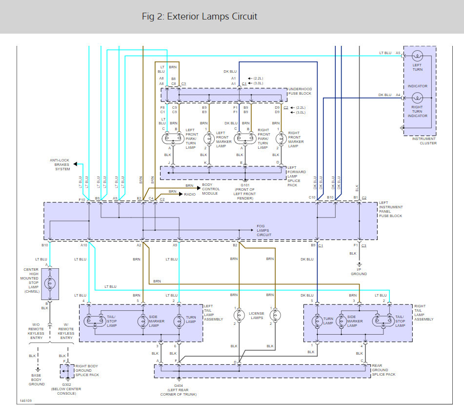

It sounds like the switch is bad but it is new. Have you confirmed power from all four sources? The wiring diagrams is above do you need a larger one? I can upload it here if you need it. :)

If you could upload larger image, that would be great.
What color are the wires regarding the power from the four sources?

No problem its what we are here for. Here is a larger image of the wiring diagram. Sorry two power sources pink and orange.
Check out the diagrams (below). Please let us know what you find.
