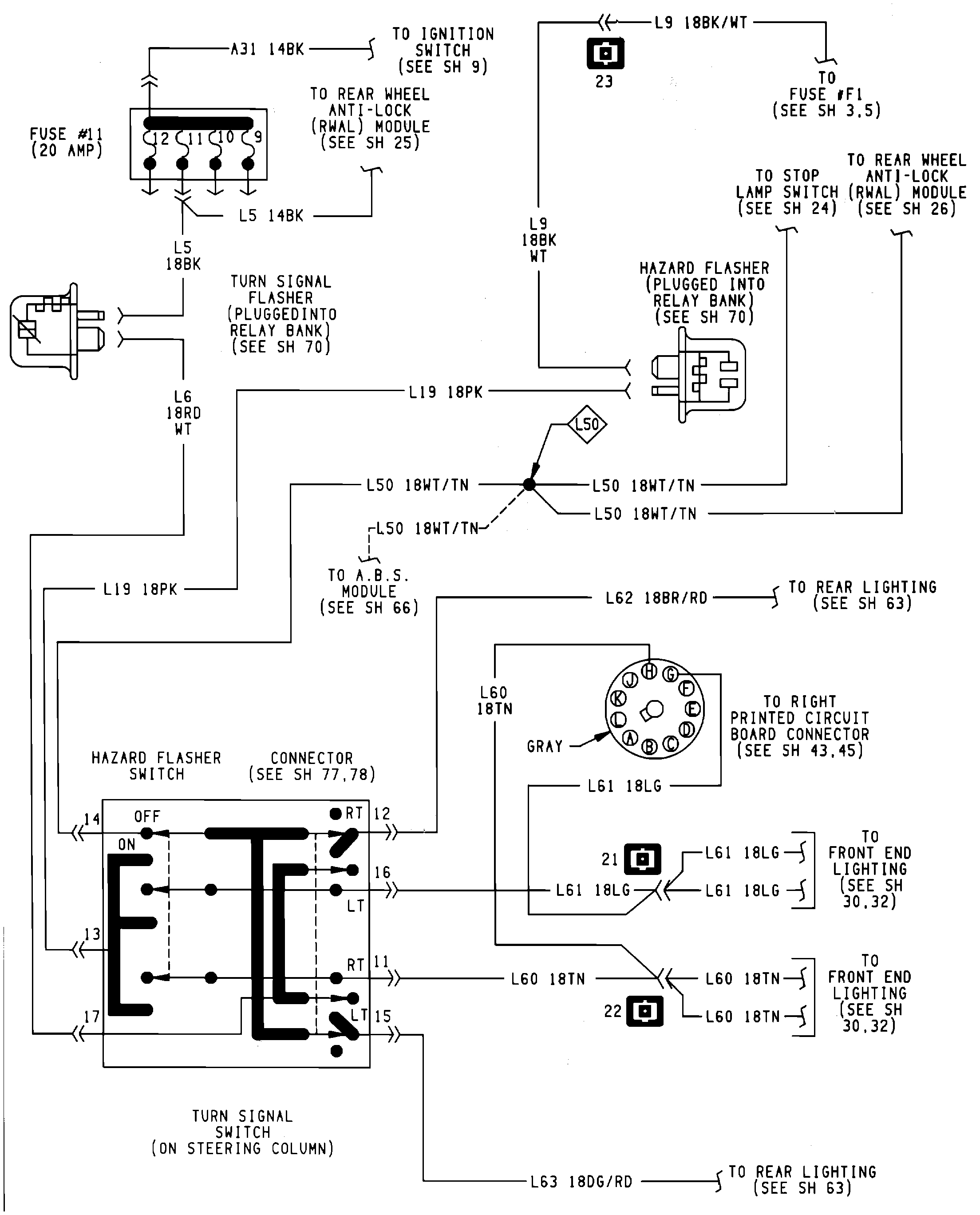

Hazards lights not working
1993 DODGE DAKOTA
129,000 MILES • 3.9L • V6 • 2WD • AUTOMATIC
SID LANSDELL
Checked all fuses, replaced headlamp, ignition and turn signal switch, replaced brake light switch and checked grounds.

On this vehicle, there are two flashers. One is for the signals and the other the hazard flashers. Both flashers are located under the dash on the driver's side in the fuse/relay panel. Have you tried replacing it? See the attached wiring schematic.
Let me know if that helps.

No power at flasher. the blinkers and everything else is working properly. help

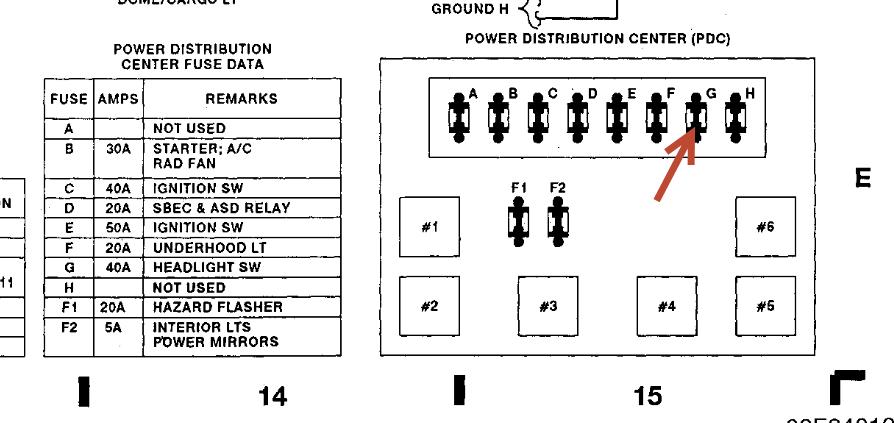

I have a 1992 dodge Dakota. The headlights brake lights and the hazard lights do not work, although both front and back turn signals work. How do I check or replace the wiring? I am also looking for the cheapest and quickest route to do this. Should I do this myself or take it to a auto body shop or the dodge dealership?
Mar 21, 2019 at 6:48 PM (Merged)
HMAC300
  • 48,601 POSTS
check fuse G inpower dist center underhood first. if it blows again tehn you'll hav eot check for a short on wiring or switch

ive checked the fuse and its not blown how do i go about checking for a short

it's a good chance your switch is bad then , see if the switch gets power and if it does then see if when you turn it on it sends power out. if it does then you need to check those wires. also check to see if headlight is burnt out it will get power. oneother thing if this has a floor dimmer switch disconnect it and see if the headlights work they get corroded and will on ly let like high beams work.

No power at hazard flasher power to turn signal switch from headlight switch but not out. new turn signal has been installed. my brake pedal switch relay has six wires on it. where do they go to? the hazard flasher is separate from turn signal flasher. please help
Mar 21, 2019 at 7:13 PM
GREGTS
Hazard sw is built into turn signal sw.and has separate fuse ,fuse has power but to to hazard sw has power from headlight to turn signals they all work but no hazards lights
