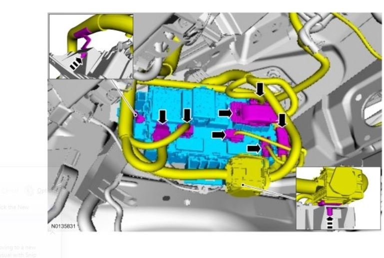

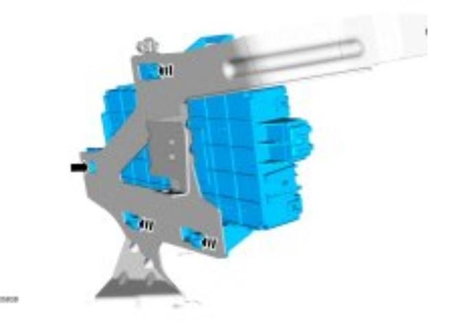

BCM
1. Connect a battery charger. Refer to Section 414-01 See: Battery > Removal and Replacement > Battery.
2. NOTE: This step is necessary only if the BCM (Body Control Module) is being replaced.
Upload the module configuration information from the BCM (Body Control Module). Refer to Section 418-01 See: Information Bus > Testing and Inspection.
3. Remove the steering column opening trim panel. refer to Instrument Cluster / Carrier &/or Interior Moulding / Trim.
4. Disconnect the 7 BCM (Body Control Module) electrical connectors and remove the 2 harness pushpins from the BCM (Body Control Module).
5. Lift the BCM (Body Control Module) release tab (away from the BCM (Body Control Module) bracket), slide the BCM (Body Control Module) to the left and remove.
