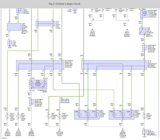

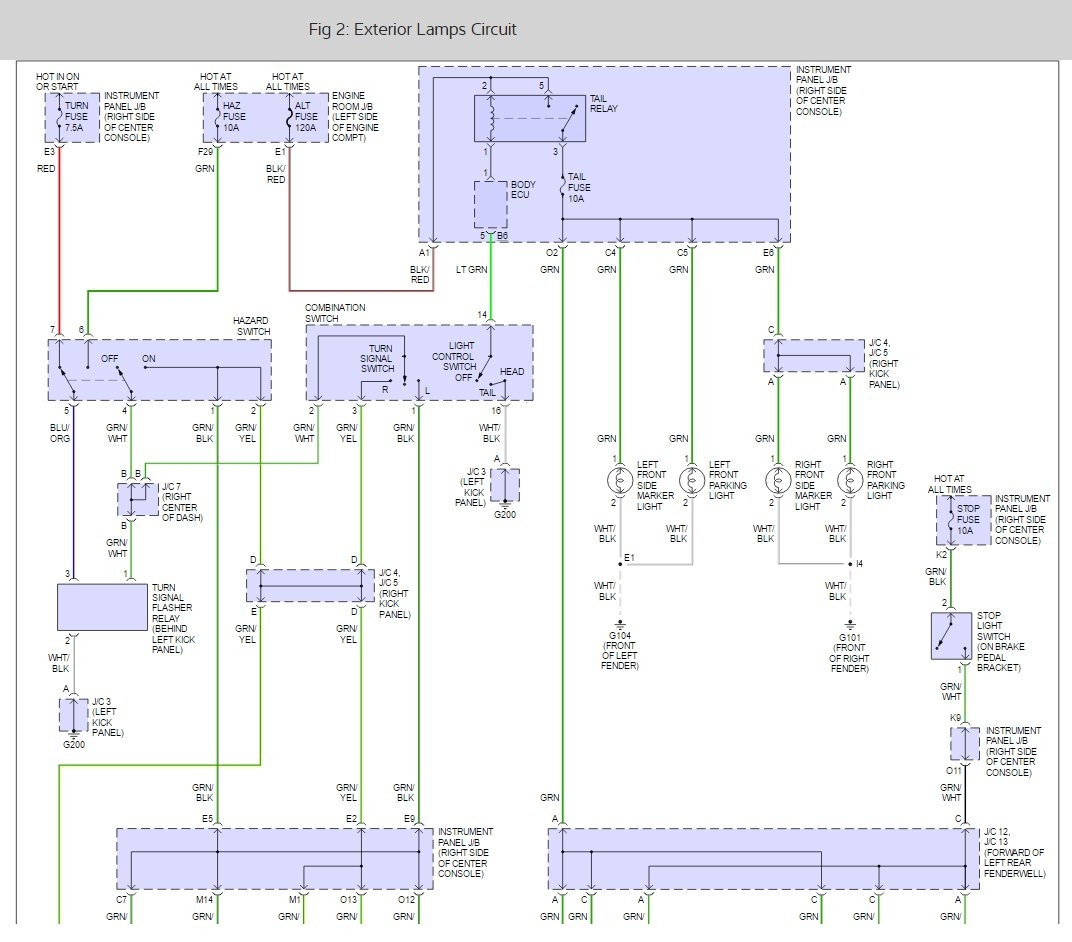

Need to bypass hazard light switch so turn signal work on my Toyota Opa. please help

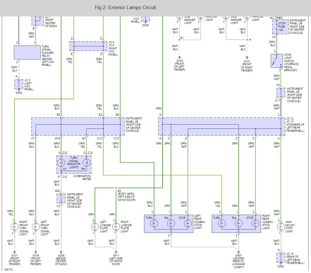

I founds these hazard and turn signal wiring diagrams for you.
Please let me know if you need anything else to get the problem fixed.
