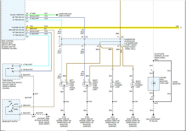

Flashing hazard lights would not turn off
2007 BUICK TERRAZA
150,000 MILES • 2.0L • 6 CYL • 2WD • AUTOMATIC
JHANOVER63
The hazard lights started to flash and wouldn't shut off. They flashed until the battery ran down.
Jun 15, 2021 at 6:40 AM
  • 110,194 POSTS

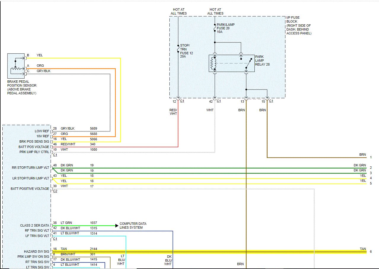

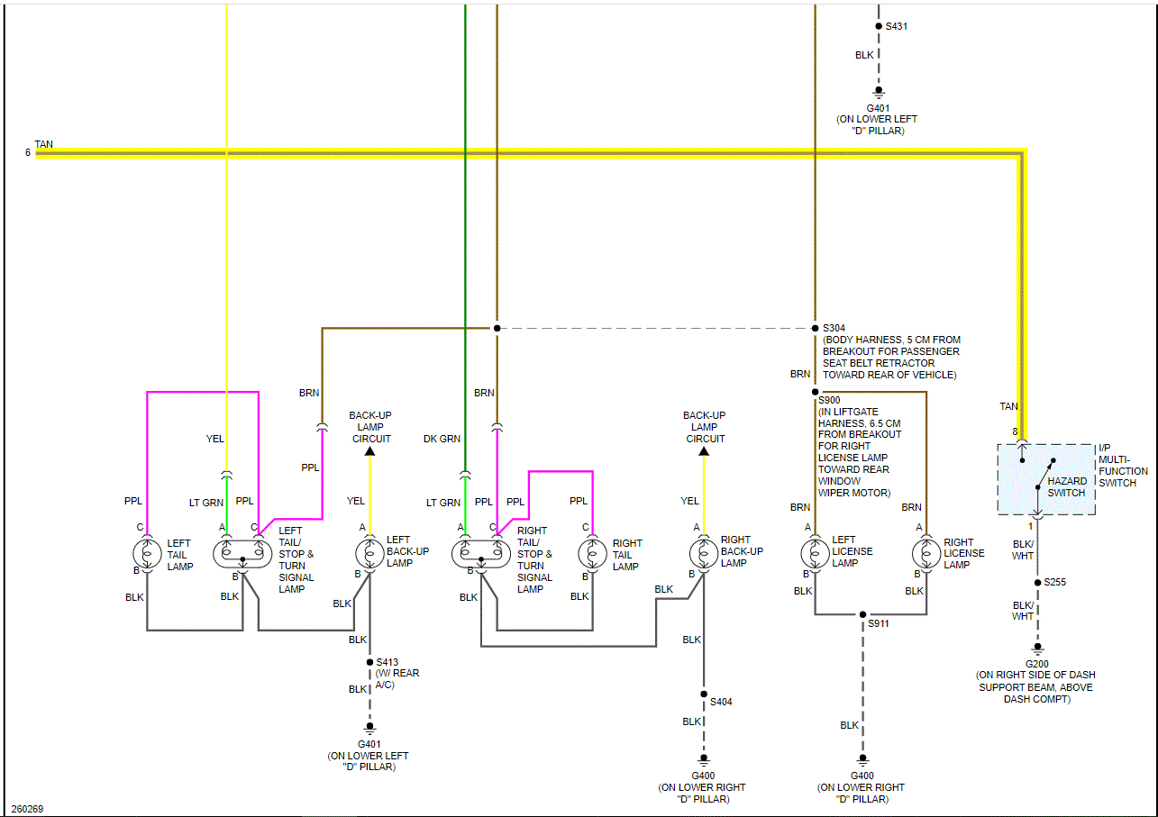

I reviewed the wiring schematic and attached them below. Either we have a short to ground, via the tan wire I highlighted, the switch itself has failed and is shorted to ground, or there is an internal fault in the body control module.
What I would suggest is to do would be to disconnect the hazard switch to see if they turn off. If they do, chances are the switch itself is bad.
Here is a link that explains how to check wiring. I thought it may be helpful to you.
