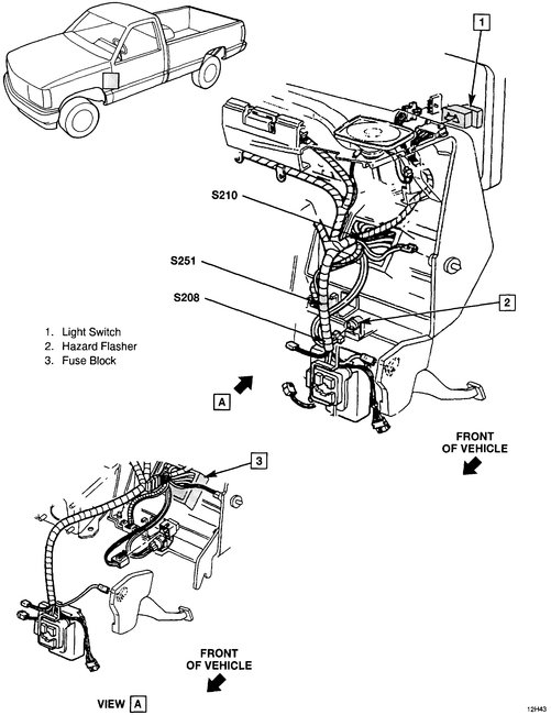

Turn signals do work. i put in new heavy duty flasher, no hazard lights, turn signals work. I was told there is another flasher for hazard lights. I cannot locate I think there is just one flasher unit that works turn and hazard, probably hazard switch on column. is there 1 or 2 flashers on the truck listed above 350 engine?

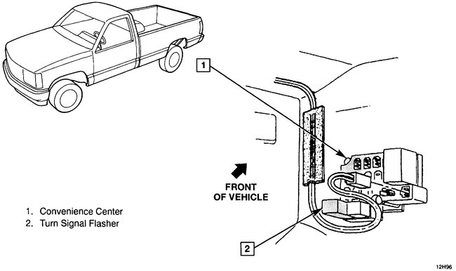

There are two flashers. One is for the signal and the other the hazard. I attached two pictures. Picture 1 shows the hazard flasher location and picture 2 is the turn signal flasher.

Thanks, found it
