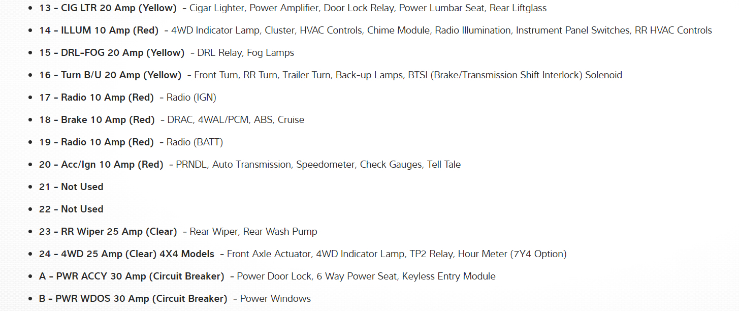

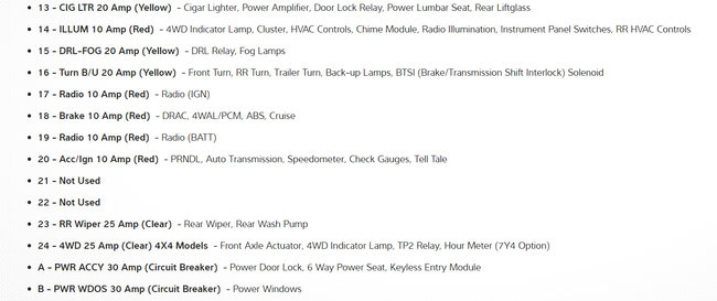

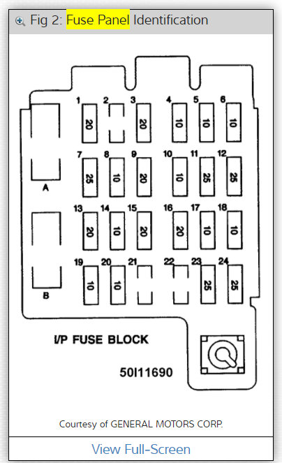

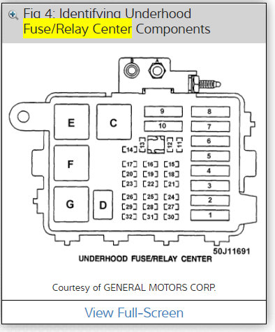

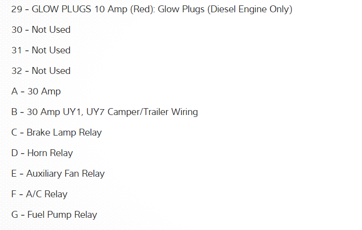

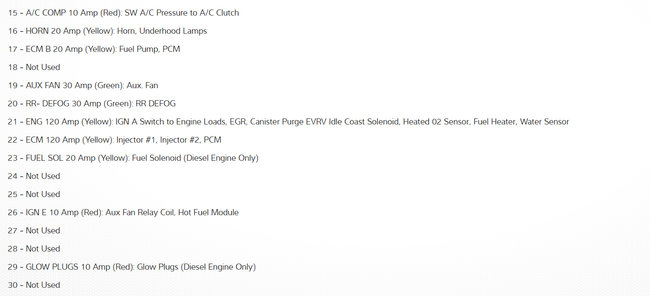

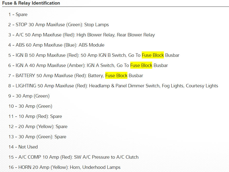

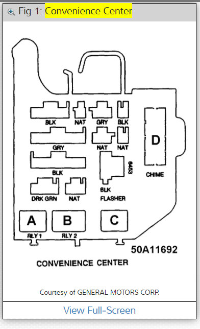

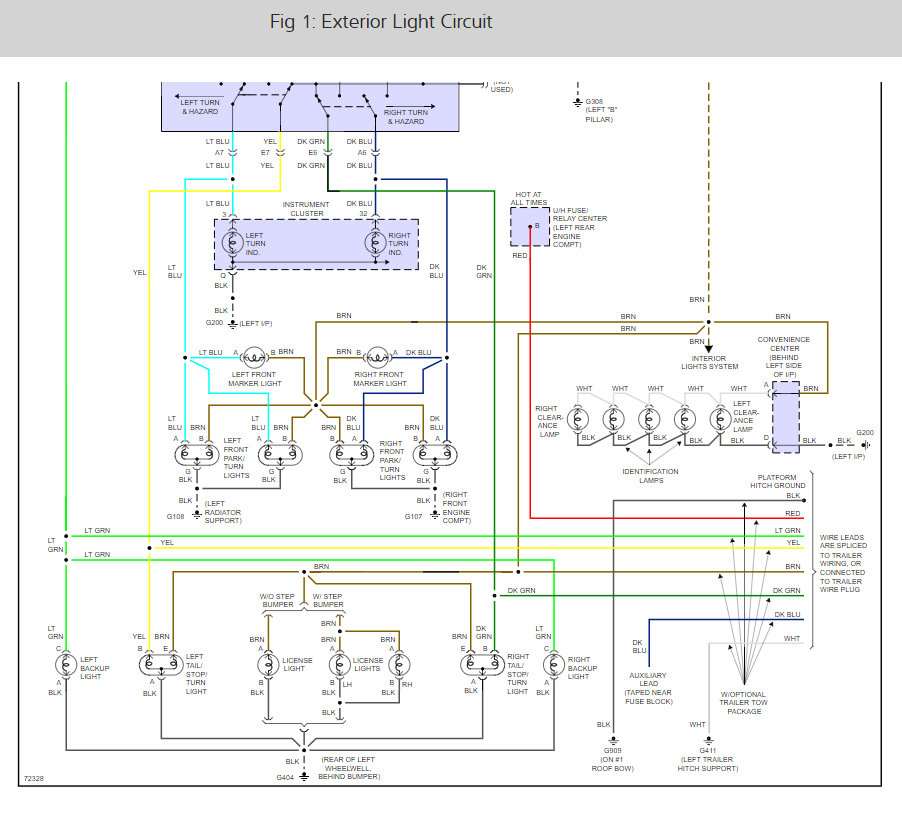

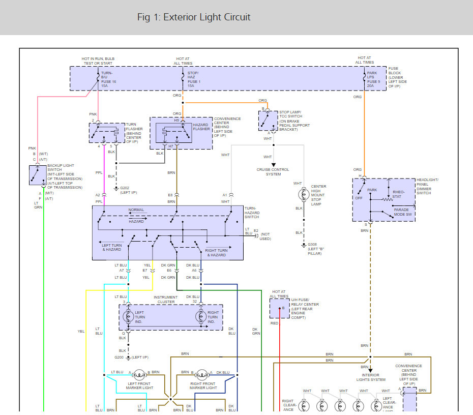

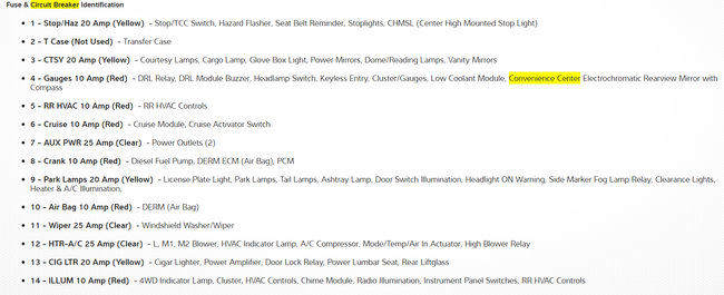

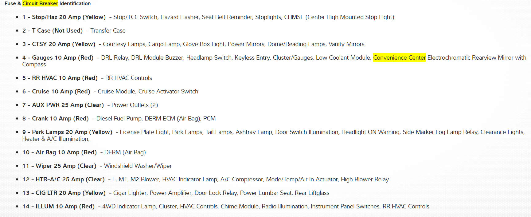

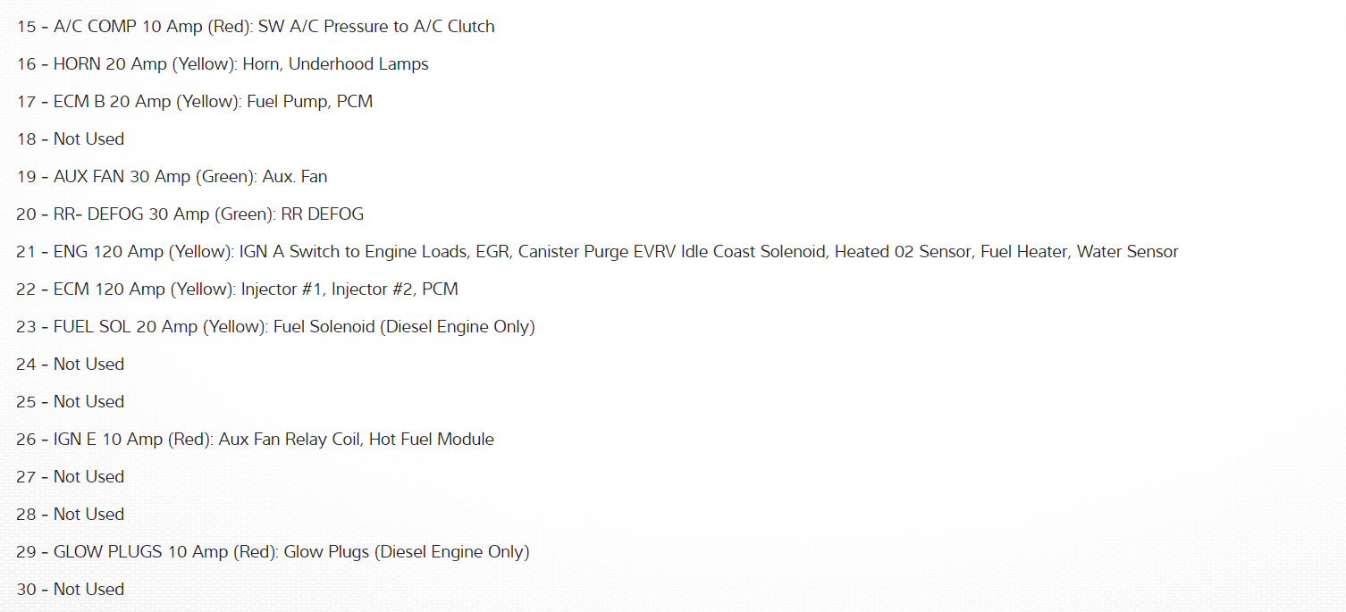

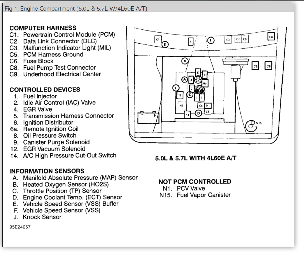

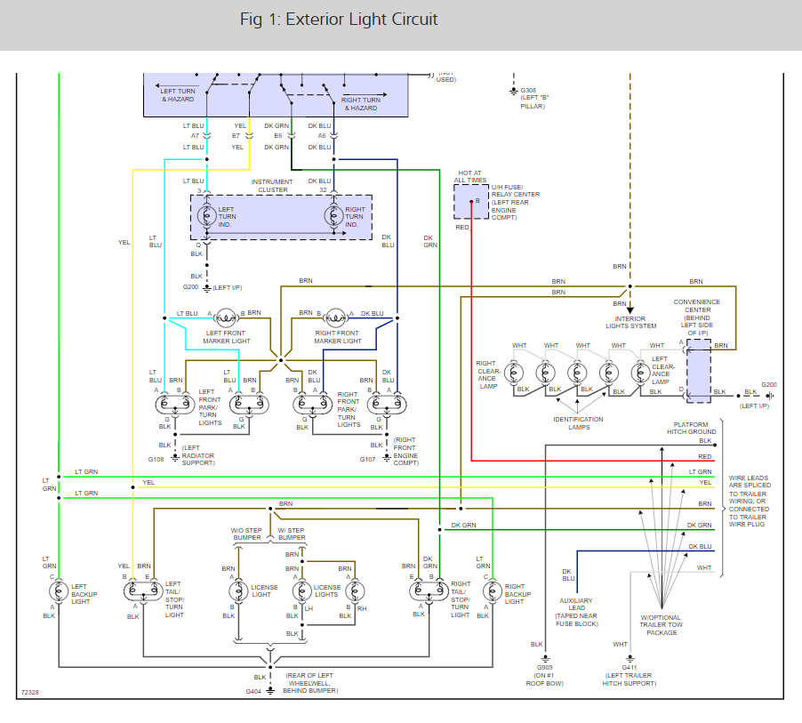

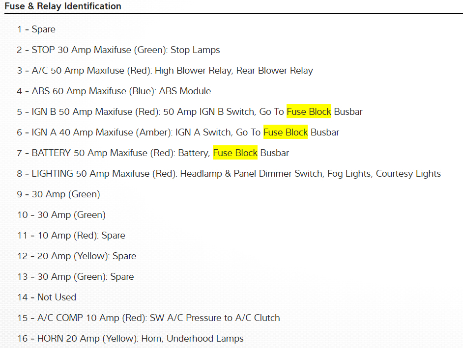

it sounds like you have a fuse #1 or 16 that is out. Can we start by checking these?
Below are diagrams to help us get the job done.
