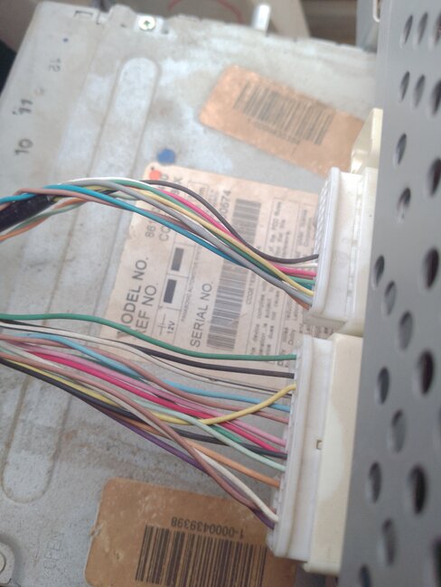

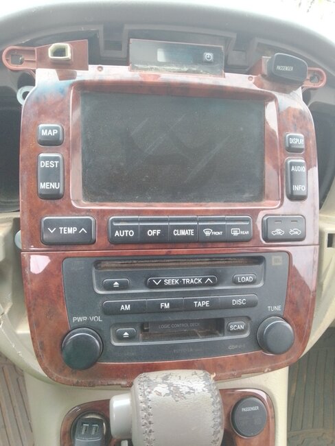

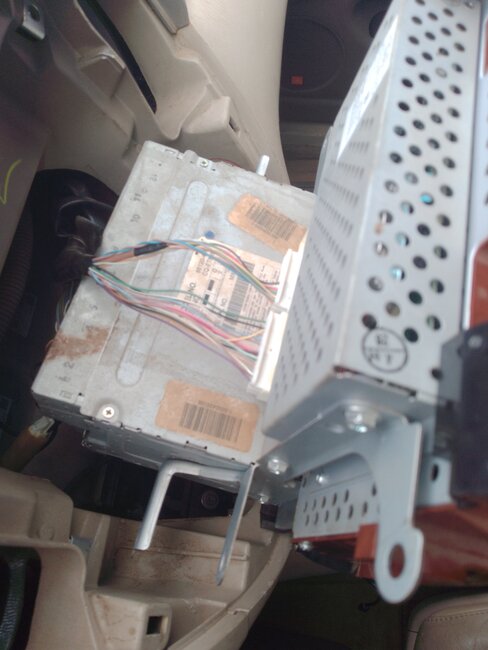

The hazard fuse is okay, I wanted to test the hazard switch but when I removed it. It was assembly. I don't know how to test it and there are two red wires on the connectors, if I have to use the wire diagram.

From the picture that I sent, it seems that the vehicle that I am working on is without navigation, if I am right?
Then from the guide, does it mean that if the switch is bad, the A/C assembly will be replaced, or can the hazard switch be replaced alone?
Sep 5, 2023 at 1:37 PM
  • 110,241 POSTS
You should be able to replace only the switch. It has been a while since I've seen one of these, but the switch should be separate.

From the A10 has two connectors. which of the connectors, will be tested for?

I mean two different connectors entered the A/C assembly. Which of the two shall we test for?
Sep 7, 2023 at 1:00 PM
  • 110,241 POSTS
See pics below. When determining pins, turn the connector in the same direction as indicated in the pic.
Let me know if that is what is needed.
