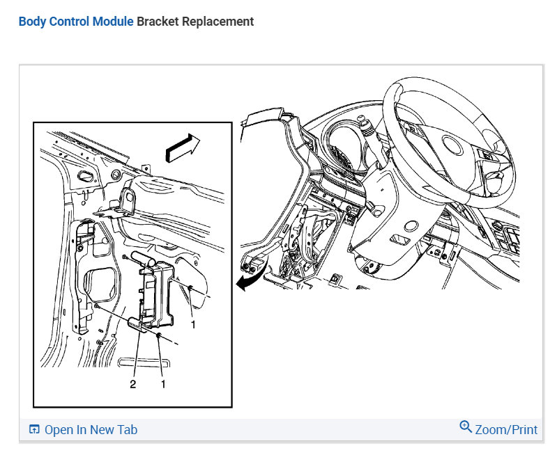

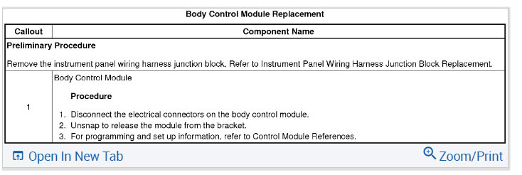

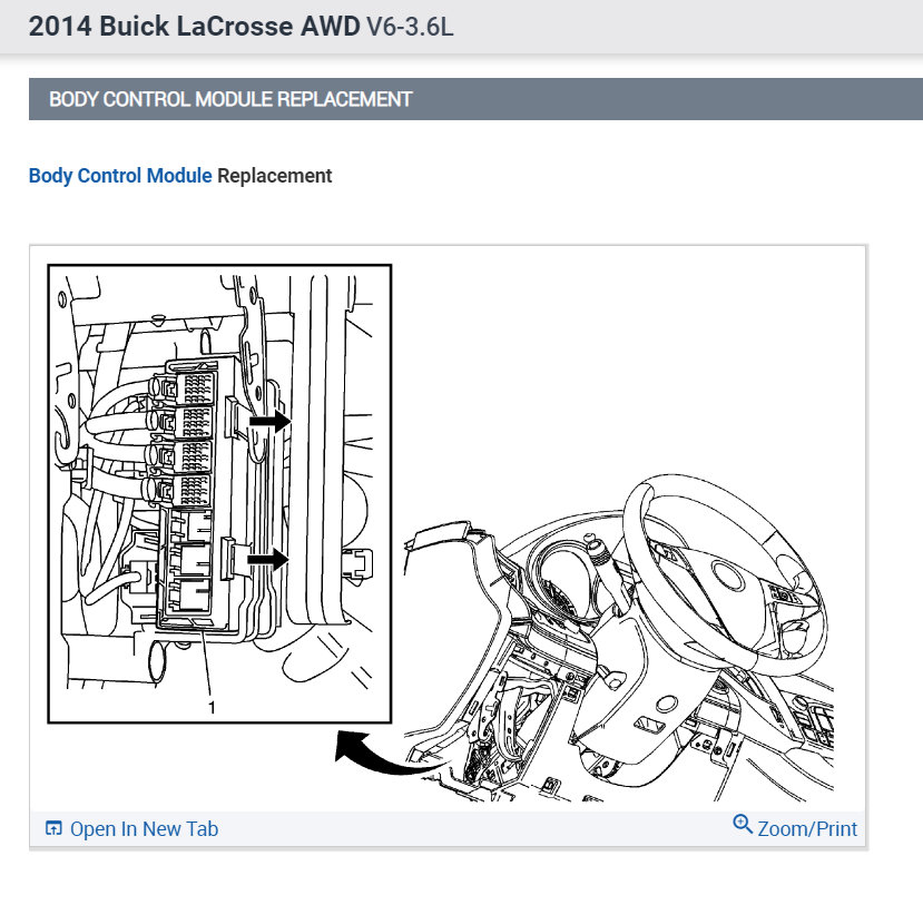

Yep, it sounds like the BCM is going out. To be sure let's do a CAN scan which is the future of automotive repair you can get a CAN scanner from Amazon for about $30.00. here is a video to show you how and a link to a scanner from Amazon. I have left instructions on how to change out the BCM in the diagrams below.

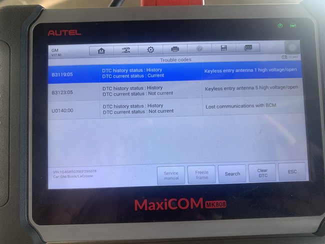

Okay, thank you for this information. After having the car scanned the code:
U0140 - Lost communications with BCM.
I attached the image below so that you can see what displayed. Also, is there a way I can get the model/part number for my BCM without having to remove it first?
Jun 29, 2022 at 11:24 AM
  • 55,865 POSTS
Nice work on the scan.
Body Control Module - 13580698 - $198.37 OEM
Please let me know what happens.

So, update so far, I took the LaCrosse to my Auto Technician for the BCM issue. He then informed me what is causing the BCM to malfunction is my passenger side headlight. That headlight is no good and was wired poorly interfering with the power from BCM. After scanning the car and the checking the BCM, all the codes were coming clear except for the power interference of the bad headlight wiring/receptor (if I am remembering exactly.) So, I will purchase the new headlight and let you know what happens moving forward.

Update so far: After installing the new headlight, the BCM was still having issues and has to be replaced along with my under-hood Fuse Box. So, I'm just awaiting delivery of those parts and take it for installation. I will let you know anything further.
